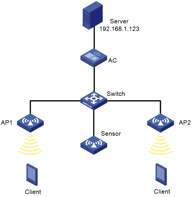

As shown in Figure 1, AP 1 and AP 2 provide wireless services for clients through SSID abc. Enable WLAN probe on the sensor to monitor the WLAN and report the detected device information to the server.
Figure 1 Network diagram

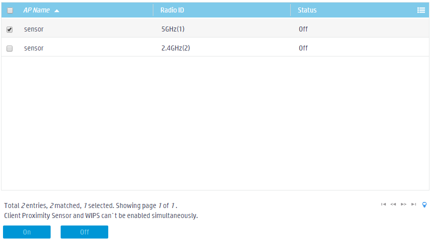

1.     Click the Network View tab at the bottom of the page.
2.     From the navigation pane, select Wireless Configuration > Client Proximity Sensor.
3.     Select AP sensor, and then click On.
Figure 2 Enabling sensor

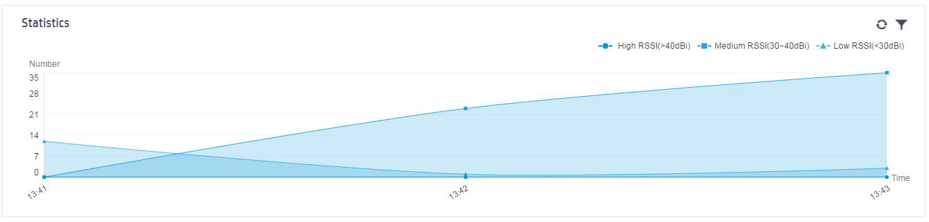

2.     From the navigation pane, select Monitoring > Client Proximity Sensor, and then view the relevant information shown in the Statistics area.
Figure 3 Verifying sensor configuration
