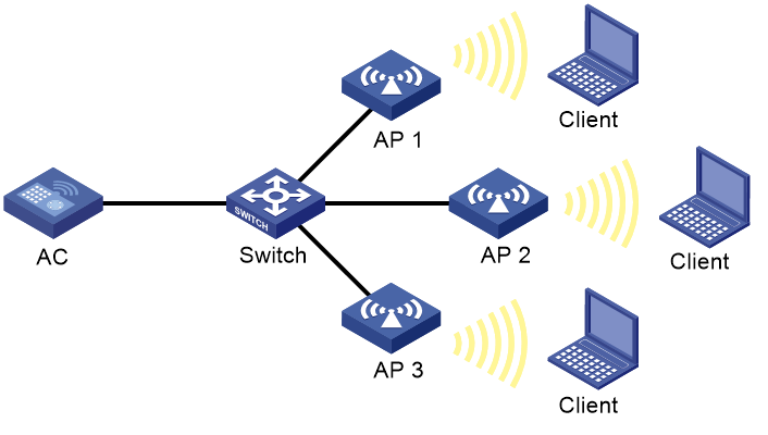

As shown in Figure 1, configure auto-DFS for the system to adjust radio channels when a channel adjustment trigger condition is met. Add radio 1 of AP 1 to an RRM holddown group to avoid frequent channel adjustments.
Figure 1 Network diagram

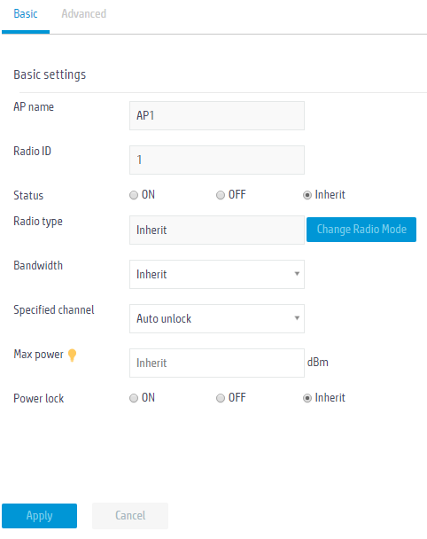

1.     Click the Network View tab at the bottom of the page.
2.     From the navigation pane, select Wireless Configuration > Radio Management.
3.     Click the More icon  in the upper right corner of the Radios for all APs area.
4.     Click the Edit icon  for AP 1 and select Auto unlock from the Specified channel list.
Figure 2 Enabling auto channel selection
5.     Repeat the previous steps to enable auto channel selection for AP 2 and AP 3.

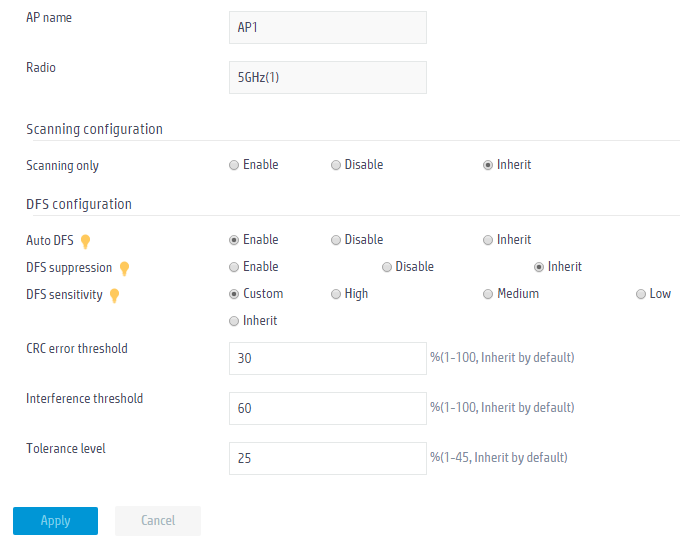

4.     Click the Edit icon  for AP 1 and configure auto DFS as follows:
¡     Enable auto DFS.
¡     Set the DFS sensitivity to Custom.
¡     Set the CRC error threshold, interference threshold, and tolerance level to 30, 60, and 25, respectively.
¡     Retain the default settings for the other fields.
¡     Click Apply.
Figure 3 Configuring auto DFS
5.     Repeat the previous steps to configure auto DFS for AP 2 and AP 3.
