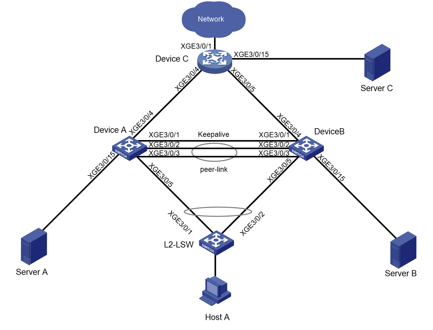

M-LAG and Mirroring Configuration Example (Campus)
As shown in Figure 1:
· Device A and Device B form an M-LAG system. L2-LSW accesses the M-LAG system through M-LAG interfaces.
· Device A and Device B act as dual-active gateways for Host A through M-LAG.
· Device A and Device B are connected to uplink device Device C through equal-cost routes.
Configure the network as follows to meet the server access requirements of users:
· Host A and the network can communicate through both IPv4 and IPv6.
· Traffic between Host A and the network is mirrored to Server A, Server B, and Server C.
· When a link between the two M-LAG member devices fails, the servers can still communicate.

Analysis
· Host A connects to the network through two uplinks. Configure the IP address of VLAN 100 as the gateway address.
· Server A, Server B, and Server C act as mirroring servers.
· Configure an OSPF/OSPFv3 neighbor between Device A and Device B, which is used as the failover link for Layer 3 remote mirrored traffic and normal traffic.
· The network is configured with both IPv4 and IPv6 settings.
All the devices were started with the factory default configuration. When you are working on a live network, make sure the existing configuration does not conflict with the following configuration.
VLAN flow mirroring and global flow mirroring support only inbound mirroring.
A peer-link interface cannot act as the monitor port.

Configuring the Layer 3 link connecting the M-LAG member devices
Device A |
Device B |
Description |
Remarks |
router id 3.3.3.3 |
router id 4.4.4.4 |
Configure a router ID. |
N/A |
ospf 1 |
ospf 1 |

Configuring the M-LAG dual-active gateways
Device A |
Device B |
Description |
Remarks |
vlan 100 |
vlan 100 |
Create VLAN 100. |
N/A |

Configuring the interconnect links between the M-LAG system and the uplink device Device C
Device A |
Device B |
Description |
interface Ten-gigabitethernetE 3/0/4 |
Enter Ethernet interface view. |
port link-mode route |
Configure the interface as a Layer 3 interface. |

Configuring uplink device Device C
Procedure summary
· Configuring the interconnect links between the uplink device Device C and the M-LAG member devices
· Configuring the interconnect link between the uplink device Device C and the network
· Configuring the interconnect link between the uplink device Device C and the mirroring server
Device C |
Description |
router id 5.5.5.5 |
ospf 1 |
Enable OSPF. |
import-route direct |
Redistribute direct routes. |
Device C |
Description |
interface Ten-gigabitethernetE 3/0/1 |
Configuring the interface as a Layer 3 interface. |
ip address 22.1.1.1 255.255.255.0 |
Assign an IPv4 address to the interface. |
Device C |
Description |
vlan 2 |
Create a VLAN. |
quit |
Return to system view. |
interface Ten-gigabitethernetE 3/0/15 |
port access vlan 2 |
Assign the interface to VLAN 2 as an access port. |
quit |
interface Vlan-interface2 |
Create VLAN interface 2, which is used to connect with the mirroring server. |
ip address 2.1.1.1 255.255.255.0 |
Configure an IPv4 address. |
quit |
Configuring downlink device L2-LSW
Procedure summary
· Configuring the interconnect links between the downlink device L2-LSW and the M-LAG member devices
· Configuring the interconnect link between the downlink device Device D and the host
L2-LSW |
Description |
vlan 100 |
Create a VLAN. |
quit |
interface bridge-aggregation 2 |
Create the Ethernet aggregate interface connecting to M-LAG member devices. |
link-aggregation mode dynamic |
Configure the aggregate interface to operate in dynamic mode. |
quit |
interface Range Ten-gigabitethernetE 3/0/1 to Ten-gigabitethernetE 3/0/2 |
Enter the view of the physical interfaces connecting the L2-LSWt o M-LAG member devices. |
port link-aggregation group 2 |
Assign the interfaces to an aggregation group. |
quit |
Enter Ethernet aggregate interface view. |
port access vlan 100 |
Assign the interfaces to VLAN 100. |
quit |
lldp global enable |
Enable LLDP globally. |

Configure traffic mirroring
Procedure summary
· Configure local port mirroring
· Configure local flow mirroring
· Configure local flow mirroring to mirror traffic on all interfaces in a VLAN
· Configure local flow mirroring to mirror traffic on all interfaces on the device
· Configure port mirroring ERSPAN
· Configure flow mirroring ERSPAN
Device A |
Device B |
Description |
mirroring-group 1 local |
Configuring a local port mirroring group. |
mirroring-group 1 mirroring-port Ten-GigabitEthernet 3/0/5 both |
Configure the source ports for local mirroring. |
mirroring-group 1 mirror-port Ten-GigabitEthernet 3/0/15 |
Configure the mirroring destination port. |
Device A |
Device B |
Description |
acl number 3000 |
acl number 3000 |
Create ACL 3000. |
rule permit tcp source 100.1.1.100 0.0.0.0 |
Configure an ACL rule for inbound traffic. |
quit |
quit |
Return to system view |
acl ipv6 number 3000 |
Create IPv6 ACL 3001. |
rule permit tcp source 100::100 128 |
Configure an IPv6 ACL rule for inbound traffic. |
quit |
quit |
traffic classifier test-ipv4-in |
Create a QoS traffic class for inbound IPv4 traffic. |
if-match acl 3000 |
if-match acl 3000 |
Use ACL 3000 as the match criterion. |
quit |
quit |
traffic classifier test-ipv6-in |
Create a traffic class for inbound IPv6 traffic. |
if-match acl ipv6 3000 |
quit |
quit |
traffic behavior mir |
Create a traffic behavior. |
mirror-to interface Ten-gigabitethernet 3/0/15 |
Configure an action of mirroring traffic to the mirroring server. |
quit |
quit |
qos policy test-in |
Create a QoS policy. |
classifier test-ipv4-in behavior mir |
Associate the traffic class with the traffic behavior for IPv4 traffic. |
classifier test-ipv6-in behavior mir |
Associate the traffic class with the traffic behavior for IPv6 traffic. |
quit |
quit |
qos vlan-policy test-in vlan 100 inbound |
Apply the QoS policy to the inbound direction of the VLAN. |
Device A |
Device B |
Description |
acl number 3000 |
acl number 3000 |
Create ACL 3000. |
quit |
quit |
quit |
quit |
if-match acl 3000 |
if-match acl 3000 |
quit |
quit |
quit |
quit |
Configure a traffic behavior. |
quit |
quit |
qos apply policy test-in global inbound |
Apply the QoS policy to the inbound direction globally. |
Device A |
Device B |
Description |
service-loopback group 1 type tunnel |
Create service loopback group 1, and specify the tunnel service for the group. |
interface Ten-gigabitethernet 3/0/8 |
Enter interface view. The interface can be any interface that has not been used. |
port service-loopback group 1 |
Assign Ten-GigabitEthernet 3/0/8 to service loopback group 1. |
quit |
quit |
interface tunnel 1 mode gre |
Create tunnel interface Tunnel 1 that operates in GRE mode. |
ip address 50.1.1.1 24 |
ip address 50.2.1.1 24 |
Configure an IP address. |
source LoopBack0 |
source LoopBack0 |
Configure a source IP address for Tunnel 1. |
destination 5.5.5.5 |
Configure a destination IP address for Tunnel 1. |
quit |
quit |
Create a local mirroring group. |
Configure Ten-GigabitEthernet 3/0/5 as a source port of local mirroring group 1. |
mirroring-group 1 monitor-port tunnel 1 |
Configure Tunnel 1 as the monitor port of local mirroring group 1. |
Device C |
Description |
Enter the view of Ten-GigabitEthernet 3/0/8. The interface can be any interface that has not been used. |
quit |
Create GRE tunnel interface 1. |
ip address 50.1.1.2 24 |
source LoopBack0 |
destination 3.3.3.3 |
quit |
interface tunnel 2 mode gre |
Create tunnel interface Tunnel 2 that operates in GRE mode. |
ip address 50.2.1.2 24 |
source LoopBack0 |
Configure a source IP address for Tunnel 2. |
destination 4.4.4.4 |
Configure a destination IP address for Tunnel 2. |
quit |
mirroring-group 1 mirroring-port Ten-GigabitEthernet 3/0/4 Ten-GigabitEthernet 3/0/5 inbound |
Configure Ten-GigabitEthernet 3/0/4 and Ten-GigabitEthernet 3/0/5 as source ports of local mirroring group 1. |
mirroring-group 1 monitor-port Ten-GigabitEthernet 3/0/15 |
Configure Ten-GigabitEthernet 3/0/15 as the monitor port of local mirroring group 1. |
acl number 3000 |
To prevent GRE mirrored packets from being used for other purposes, use ACLs to filter them. |
rule deny gre source 3.3.3.3 0 destination 5.5.5.5 0 |
Configure a rule to match GRE mirrored packets. |
rule deny gre source 4.4.4.4 0 destination 5.5.5.5 0 |
quit |
interface range Ten-gigabitethernet 3/0/4 to Ten-gigabitethernet 3/0/5 |
Enter the view of the source ports. |
packet-filter 3000 inbound |
Apply ACL 3000 to the inbound direction of the interfaces. |
quit |
Device A |
Device B |
Description |
acl number 3000 |
acl number 3000 |
Create ACL 3000. |
quit |
quit |
acl number 3001 |
acl number 3001 |
Create ACL 3001. |
rule permit tcp destination 100.1.1.100 0.0.0.0 |
Configure an ACL rule for outbound traffic. |
quit |
quit |
quit |
quit |
acl ipv6 number 3001 |
rule permit tcp destination 100::100 128 |
Configure an IPv6 ACL rule for outbound traffic. |
quit |
quit |
Create a QoS traffic class for inbound traffic. |
if-match acl 3000 |
if-match acl 3000 |
quit |
quit |
traffic classifier test-ipv4-out |
Configure a traffic class for outbound IPv4 traffic. |
if-match acl 3001 |
if-match acl 3001 |
Use ACL 3001 as the match criterion. |
quit |
quit |
quit |
quit |
traffic classifier test-ipv6-out |
Create a traffic class for outbound IPv6 traffic. |
if-match acl ipv6 3001 |
quit |
quit |
Createa traffic behavior. |
mirror-to interface destination-ip 2.1.1.2 source-ip 3.3.3.3 |
mirror-to interface destination-ip 2.1.1.2 source-ip 4.4.4.4 |
Mirror traffic to mirroring servers. |
quit |
quit |
quit |
quit |
qos policy test-out |
Create a QoS policy for outbound traffic. |
classifier test-ipv4-out behavior mir |
classifier test-ipv6-out behavior mir |
Quit |
quit |
interface Ten-gigabitethernet 3/0/5 |
Enter the view of the source port. |
qos apply policy test-in inbound |

Traffic forwarding models
About the traffic model
The traffic model contains the following information:
· ID—Traffic ID, in O-X-XXX format. The first segment (O) represents overlay traffic. The second segment (X) represents the IP version (4 for IPv4 and 6 for Ipv6). The third segment (XXX) represents a unique number for the traffic.
· Type—Traffic type, such as known unicast/IPv4 and unicast/L2.
· Direction—Traffic direction, such as inter-leaf east-west traffic and north-west traffic.
· Forwarding path—Nodes that underlay traffic traverses.
· Simulation method—Traffic simulation method. Testers are used to simulate the patterns of traffic on the network set up in this example.
· Simulation traffic load—The network can be tested under light load (fewer than 1000 simulation traffic flows) or heavy load (more than 1000 simulation traffic flows).
Traffic
No. |
Type |
Direction |
Forwarding path |
Traffic simulation |
Load |
Traffic direction to firewalls/LB |
Remarks |
O-4-001 |
Known unicast/IPv4 |
N/A |
HostA-DeviceA/B-Device C-Network |
Tester |
Light |
N/A |
When the uplink interface fails, remote mirroring traffic and normal traffic can be forwarded through the Layer 3 link between M-LAG member devices. |
O-4-002 |
N/A |
Network-Device C-Device A/B-HostA |
Tester |
Light |
N/A |
O-6-001 |
Known unicast/IPv6 |
N/A |
Tester |
Light |
N/A |
O-6-002 |
N/A |
Network-Device c-Device A/B-HostA |
Tester |
Light |
N/A |
Testing network convergence upon single points of failure

Verifying the M-LAG system state
# Display summary information about the peer-link interface and M-LAG interfaces. The peer-link interface is in up state.
<Device A>display m-lag summary
Flags: A -- Aggregate interface down, B -- No peer M-LAG interface configured
C -- Configuration consistency check failed
Peer-link interface: BAGG1
Peer-link interface state (cause): UP
Keepalive link state (cause): UP
M-LAG interface information
M-LAG IF M-LAG group Local state (cause) Peer state Remaining down time(s)
BAGG2 1 UP UP -
<Device B>display m-lag summary
BAGG2 1 UP UP -
# Display M-LAG keepalive packet statistics. The keepalive packet sending and receiving states are both successful.
<Device A>display m-lag keepalive
Neighbor keepalive link status (cause): Up
Neighbor is alive for: 590 s 830 ms
Keepalive packet transmission status:
Sent: Successful
Received: Successful
Last received keepalive packet information:
Source IP address: 21.1.1.2
Time: 2022/08/01 15:53:17
Action: Accept
M-LAG keepalive parameters:
Destination IP address: 21.1.1.2
Source IP address: 21.1.1.1
Keepalive UDP port : 6400
Keepalive VPN name : N/A
Keepalive interval : 1000 ms
Keepalive timeout : 5 sec
Keepalive hold time: 3 sec
<Device A>
<Device B>disp m-lag keepalive
Neighbor is alive for: 650 s 238 ms
Sent: Successful
Time: 2022/08/01 15:59:11
Action: Accept
Destination IP address: 21.1.1.1
# Display M-LAG role information. Device A is the secondary device, and Device B is the primary device.
<Device A>display m-lag role
Effective role information
Factors Local Peer
Effective role Secondary Primary
Initial role None Primary
MAD DOWN state Yes No
Health level 3 0
Role priority 32768 32768
Bridge MAC 0cda-41c5-aab0 0000-fc00-c7fb
Effective role trigger: Peer link calculation
Effective role reason: Single None role
Configured role information
Factors Local Peer
Configured role Secondary Primary
<Device B>disp m-lag role
Factors Local Peer
Effective role Primary Secondary
Initial role Primary None
MAD DOWN state No Yes
Health level 0 3
Bridge MAC 0000-fc00-c7fb 0cda-41c5-aab0
Factors Local Peer
Configured role Primary Secondary

Verifying the global local flow mirroring configuration
# Verify the global flow mirroring SPAN configuration on a device, for example, on Device A.
[Device A]display qos policy global inbound
Direction: Inbound
Policy: test-in
Classifier: test-ipv4-in
Operator: AND
Rule(s) :
If-match acl 3000
Behavior: mir
Mirroring:
Mirror to the interface: Ten-GigabitEthernet3/0/15
Classifier: test-ipv6-in
Operator: AND
Rule(s) :
If-match acl ipv6 3000
Behavior: mir
Mirroring:
Verifying the Layer 3 remote port mirroring (ERSPAN) configuration.
# Verify the Layer 3 remote port mirroring (ERSPAN) configuration on Device A.
[Device A]display mirroring-group 1
Mirroring group 1:
Type: Local
Status: Active
Mirroring port:
Ten-GigabitEthernet3/0/5 Both
Monitor port: Tunnel1
[Device A]display interface Tunnel 1
Tunnel1
Current state: UP
Line protocol state: UP
Description: Tunnel1 Interface
Bandwidth: 64 kbps
Maximum transmission unit: 1476
Internet address: 50.1.1.1/24 (Primary)
Tunnel source 3.3.3.3 (LoopBack0), destination 5.5.5.5
Tunnel keepalive disabled
Tunnel TTL 255
Tunnel protocol/transport GRE/IP
GRE key disabled
Checksumming of GRE packets disabled
Last clearing of counters: Never
Last 5 seconds input rate: 0 bytes/sec, 0 bits/sec, 0 packets/sec
Last 5 seconds output rate: 0 bytes/sec, 0 bits/sec, 0 packets/sec
Input: 0 packets, 0 bytes, 0 drops
Output: 0 packets, 0 bytes, 0 drops
# Verify the Layer 3 remote port mirroring (ERSPAN) configuration on Device C.
[Device C]display mirroring-group 1
Mirroring group 1:
Type: Local
Status: Active
Mirroring port:
Ten-GigabitEthernet3/0/4 Inbound
Ten-GigabitEthernet3/0/5 Inbound
Monitor port: Ten-GigabitEthernet3/0/15
[Device C]display interface Tunnel 1
Tunnel1
Current state: UP
Bandwidth: 64 kbps
Internet address: 50.1.1.2/24 (primary)
Tunnel source 5.5.5.5 (LoopBack0), destination 3.3.3.3
Tunnel TTL 255
GRE key disabled
Last 300 seconds input rate: 0 bytes/sec, 0 bits/sec, 0 packets/sec
Last 300 seconds output rate: 0 bytes/sec, 0 bits/sec, 0 packets/sec
Input: 128712 packets, 16243280 bytes, 2 drops
Verifying the flow mirroring ERSPAN configuration
# Verify the flow mirroring ERSPAN configuration on a device, for example, on Device A.
[Device A]display qos policy interface Ten-GigabitEthernet 3/0/5
Interface: Ten-GigabitEthernet3/0/5
Direction: Inbound
Policy: test-in
Operator: AND
Rule(s) :
If-match acl 3000
Behavior: mir
Mirroring:
Mirror to the interface: Ten-GigabitEthernet3/0/4(dynamic)
Encapsulation: Destination IP address 2.1.1.2
Source IP address 3.3.3.3
Destination-MAC 00e0-fc00-5128
Operator: AND
Rule(s) :
Behavior: mir
Mirroring:
Direction: Outbound
Policy: test-out
Classifier: test-ipv4-out
Operator: AND
Rule(s) :
If-match acl 3001
Behavior: mir
Mirroring:
Classifier: test-ipv6-out
Operator: AND
Rule(s) :
If-match acl ipv6 3001
Behavior: mir
Mirroring:
