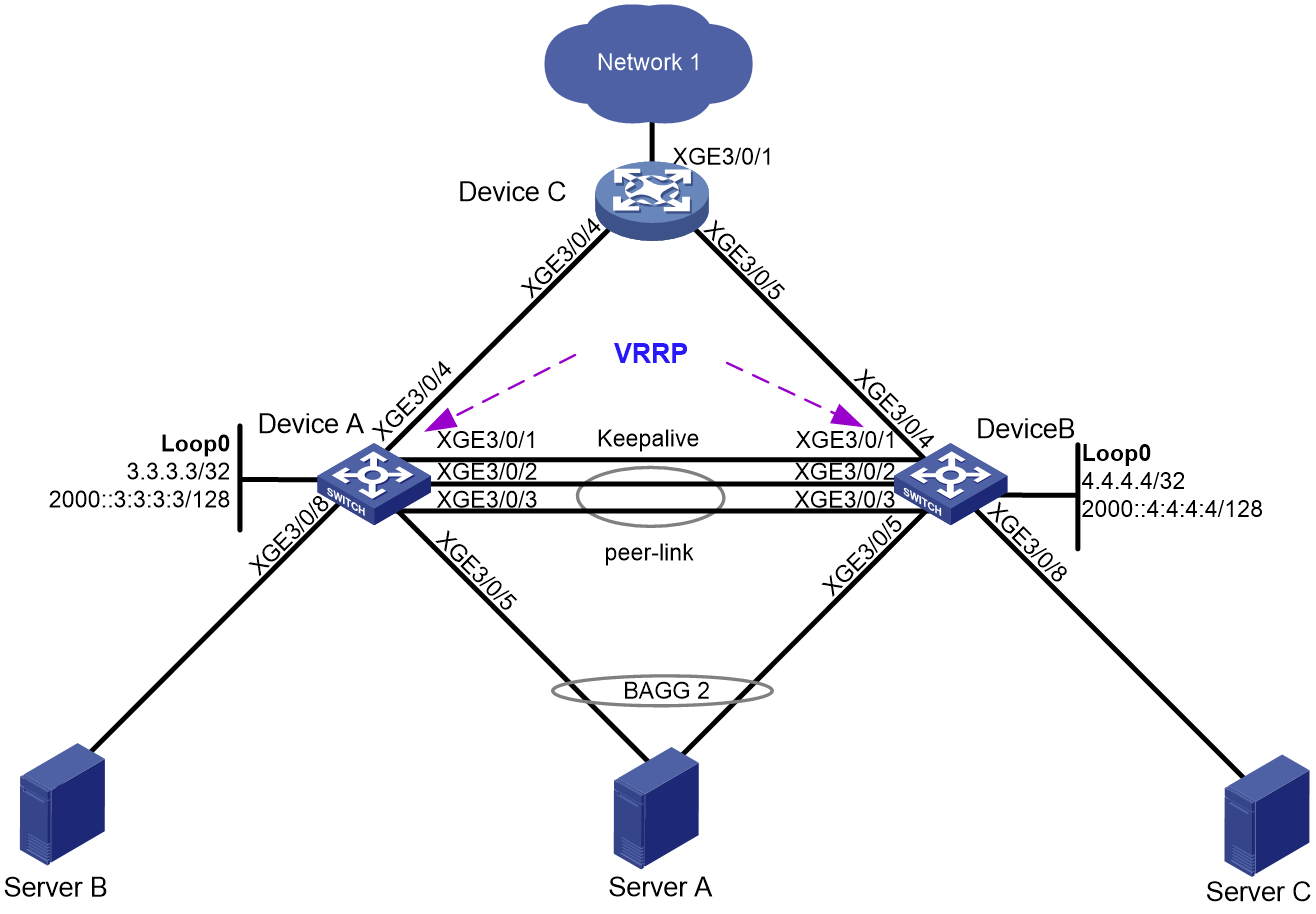

As shown in Figure 1:
·     Device A and Device B form an M-LAG system. Server A is connected to the M-LAG system through M-LAG interfaces.
·     Device A and Device B provide VRRP access for Server A.
·     Device A and Device B are connected to uplink device Device A through ECMP routes.
·     Server B and Server A are in the same network segment and connected to the network with a single uplink. Server C is in a different network segment from Server A and also connected to the network with a single uplink.
User requirements:
·     Server A, Server B, and Server C have IPv4 and IPv6 dual-stack connectivity between them.
·     Server A, Server B, and Server C have IPv4 and IPv6 dual-stack connectivity with the network.
·     When a link between the two M-LAG member devices fails, the servers can still communicate.
Figure 1 Network diagram
Device
Interface
IP addresses
Remarks
Device A:
LoopBack 0
3.3.3.3/32
2000::3:3:3:3/128
Loopback interface address.
Router ID.
XGE 3/0/8
N/A
Server B
Single-homed interface.
XGE 3/0/5
N/A
Server A
M-LAG device interface.
XGE 3/0/4
32.1.1.1/24
32::1/64
Device C: XGE 3/0/4
XGE 3/0/1
21.1.1.1/24
Device B: XGE 3/0/1
Keepalive link
XGE 3/0/2
N/A
Device B: XGE 3/0/2
The interface is used as the peer link interface.
XGE 3/0/3
N/A
Device B: XGE 3/0/3
Vlan 100
100.1.1.1/24
100::1/64
VRRP gateway.
Vlan 101
101.1.1.1/24
101::1/64
Interface of the Layer 3 link connecting the two M-LAG member devices, which is used for forwarding east-west traffic or allowing north-south traffic to escape.
Device B:
LoopBack 0
4.4.4.4/32
2000::4:4:4:4/128
Router ID.
XGE 3/0/8
200.1.1.1/24
200::1/64
Server C
XGE 3/0/5
N/A
Server A
XGE 3/0/4
33.1.1.1/24
33::1/64
Device C: XGE 3/0/5
XGE 3/0/1
21.1.1.2/24
Device A: XGE 3/0/1
Keepalive link
XGE 3/0/2
N/A
Device A: XGE 3/0/2
XGE 3/0/3
N/A
Device A: XGE 3/0/3
Vlan 100
100.1.1.2/24
100::2/64
VRRP gateway.
Vlan 101
101.1.1.2/24
101::2/64
Device C:
XGE 3/0/1
22.1.1.1/24
22::1/64
Network 1
XGE 3/0/4
32.1.1.2/24
32::2/64
Device A: XGE 3/0/4
XGE 3/0/5
33.1.1.2/24
33::2/64
Device B: XGE 3/0/4
Server A
N/A
100.1.1.11/24
100::11/64
Device A: XGE 3/0/5
Device B: XGE 3/0/5
Server B
N/A
100.1.1.12/24
100::12/64
Device A: XGE 3/0/8
Server C
N/A
200.1.1.11/24
200::11/64
Device B: XGE 3/0/8
Network 1
N/A
22.1.1.11/24
22::11/64
Device C: XGE 3/0/1

interface bridge-aggregation 2
Create Layer 2 aggregate interface Bridge-Aggregation 2, and enter its view.
port link-type trunk
Set the link type of the Layer 2 aggregate interface to trunk.
port trunk permit vlan 100
Assign the interface to VLAN 100.
undo port trunk permit vlan 1
Remove the interface from VLAN 1.
Return to system view.
interface vlan-interface 100
Create VLAN-interface 100.
ip address 100.1.1.1 24
ip address 100.1.1.2 24
Assign an IPv4 address to VLAN-interface 100.
vrrp vrid 1 virtual-ip 100.1.1.100
Create IPv4 VRRP group 1, and configure virtual IP address 100.1.1.100 for the VRRP group.
vrrp vrid 1 priority 200
N/A
Configure the priority of the device in VRRP group 1.
This configuration ensures that Device A can become the master.
ipv6 address 100::1 64
ipv6 address 100::2 64
Assign an IPv6 address to VLAN-interface 100.
ipv6 address fe80:100::1 link-local
ipv6 address fe80:100::2 link-local
Assign an IPv6 link-local address to VLAN-interface 100.
vrrp ipv6 vrid 1 virtual-ip fe80:100::100 link-local
Create IPv6 VRRP group 1, and configure virtual IPv6 address fe80:100::100 for IPv6 VRRP group 1.
vrrp ipv6 vrid 1 virtual-ip 100::100
Create IPv6 VRRP group 1, and configure virtual IPv6 address 100::100 for IPv6 VRRP group 1.
vrrp ipv6 vrid 1 priority 200
N/A
Configure the priority of the device in IPv6 VRRP group 1 to 200.
m-lag mad exclude interface Vlan-interface100
Configure M-LAG MAD to not shut down VLAN-interface 100.
This configuration avoids traffic interruption caused by ARP/ND entry synchronization failure when the VLAN interface is in M-LAG MAD DOWN state.
Configuring the links between the M-LAG member devices and uplink device Device C
Device A
Device B
Description
Remarks
vlan 32
vlan 33
Create a VLAN.
interface Ten-gigabitethernet 3/0/4
Enter interface view.
port access vlan 32
port access vlan 33
Assign the access port to the specified VLAN.
interface vlan-interface 32
interface vlan-interface 33
Create a VLAN interface.
ip address 32.1.1.1 24
ip address 33.1.1.1 24
Configure an IP address for the VLAN interface.
ospf 1 area 0
ospf 1 area 0
Enable OSPF on the interface.
ipv6 address 32::1 64
ipv6 address 33::1 64
ospfv3 1 area 0
ospfv3 1 area 0
Enable OSPFv3 on the interface.
Configuring single-homed interface of the M-LAG member devices
Device A
Device B
Description
Remarks
N/A
vlan 200
Create a VLAN.
N/A
interface ten-gigabitethernet 3/0/8
Configure the single-homed interface of Server B and Server C.
port access vlan 100
port access vlan 200
N/A
interface vlan-interface 200
N/A
ip address 200.1.1.1 24
N/A
ipv6 address 200::1 64
Configure an IPv6 address for the VLAN interface.
N/A
Configuring uplink device Device C
Procedure summary
·     Configuring the links between uplink device Device C and M-LAG member devices
·     Configuring the links between uplink device Device C and the network
Device C
Description
Remarks
undo stp global enable
Disable STP globally.
vlan 32 33
Create a VLAN.
interface Ten-gigabitethernetE 3/0/4
port access vlan 32
Assign the interface on Device C connected to Device A to VLAN 32.
interface Ten-gigabitethernetE 3/0/5
port access vlan 33
Assign the interface on Device C connected to Device B to VLAN 33.
router id 5.5.5.5
Configure a router ID.
ospf 1
Configure OSPF to implement IPv4 network connectivity between M-LAG member devices.
import-route direct
Redistribute direct routes.
area 0
Configure area 0.
Return to OSPF view.
ospfv3 1
Enable OSPFv3.
router-id 5.5.5.5
import-route direct
area 0
Configure area 0.
Return to OSPFv3 view.
interface loopback 0
Create a loopback interface.
ip address 5.5.5.5 255.255.255.255
Configure an IPv4 address for the loopback interface.
ospf 1 area 0
Enable OSPF for the loopback interface.
ipv6 address 2000::5:5:5:5/128
Configure an IPv6 address for the loopback interface.
ospfv3 1 area 0
Enable OSPFv3 for the loopback interface.
N/A
Create VLAN-interface 32.
ip address 32.1.1.2 24
Configure an IPv4 address for the VLAN interface.
ospf 1 area 0
Enable OSPF for the VLAN interface.
ipv6 address 32::2 64
ospfv3 1 area 0
Enable OSPFv3 for the VLAN interface.
Create VLAN-interface 33.
ip address 33.1.1.2 24
ospf 1 area 0
ipv6 address 33::2 64
ospfv3 1 area 0
Device C
Description
Remarks
vlan 22
Create VLAN 22.
interface Ten-gigabitethernet 3/0/1
port access vlan 22
Assign the interface on Device C connected to the external network to VLAN 22.
interface vlan-interface 22
Create VLAN-interface 22.
ip address 22.1.1.1 24
ipv6 address 22::1 64
Traffic model
About the traffic model
The traffic model contains the following information:
·     ID—Traffic ID, in O-X-XXX format. The first segment (O) represents overlay traffic. The second segment (X) represents the IP version (4 for IPv4 and 6 for IPv6). The third segment (XXX) represents a unique number for the traffic.
·     Type—Traffic type, such as known unicast/IPv4 and unicast/L2.
·     Direction—Traffic direction, such as inter-leaf east-west traffic and north-south traffic.
·     Path—The nodes that the traffic traverses from the source to the destination.
·     Simulation method—Traffic simulation method. Testers are used to simulate the patterns of traffic on the network set up in this example.
·     Simulation traffic load—The network can be tested under light load (fewer than 1000 simulation traffic flows) or heavy load (more than 1000 simulation traffic flows).
·     Traffic direction to firewalls/LBs—No firewalls or LBs are used in this example, or traffic is directed to firewalls or LBs through PBR, M-LAG+VRRP, or static routing.
Traffic
ID
Type
Direction
Path
Simulation method
Remarks
O-4-001
Known unicast/IPv4
North-south traffic
ServerA-DeviceA&B-DeviceC-Network1
Tester
Light
N/A
When the uplink interface fails, traffic is forwarded along the Layer 3 link between M-LAG member devices.
O-4-002
Known unicast/IPv4
North-south traffic
ServerB-DeviceA-DeviceC-Network1
Tester
Light
N/A
O-4-003
Known unicast/IPv4
North-south traffic
ServerC-DeviceB-DeviceC-Network1
Tester
Light
N/A
O-4-004
Known unicast/IPv4
East-west traffic
ServerA-DeviceA&B-DeviceA-ServerB
Tester
Light
N/A
O-4-005
Known unicast/IPv4
East-west traffic
ServerA-DeviceA&B-DeviceB-ServerC
Tester
Light
N/A
O-4-006
Known unicast/IPv4
East-west traffic
ServerB-DeviceA-DeviceB-ServerC
Tester
Light
N/A
O-6-001
Known unicast/IPv6
North-south traffic
Tester
Light
N/A
O-6-002
Known unicast/IPv6
North-south traffic
Tester
Light
N/A
O-6-003
Known unicast/IPv6
North-south traffic
Tester
Light
N/A
O-6-004
Known unicast/IPv4
East-west traffic
Tester
Light
N/A
O-6-005
Known unicast/IPv4
East-west traffic
Tester
Light
N/A
O-6-006
Known unicast/IPv4
East-west traffic
Tester
Light
N/A
Convergence performance test results
Failure test results
