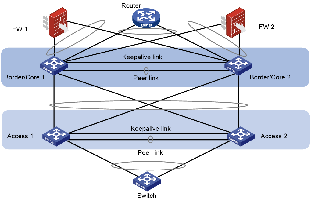

M-LAG network planning schemes
M-LAG is supported in large, medium, and small campus networks. M-LAG deployment for campus networks does not include EVPN configuration. For EVPN M-LAG deployment, see M-LAG + VXLAN Distributed Gateway Network Configuration Example (Ethernet Aggregate Link as Peer Link) (Campus) and M-LAG + EVPN VXLAN Centralized Gateway Network Configuration Example (Ethernet Aggregate Link as Peer Link) (Campus). Border devices in different scales of the campus networks redistribute routes for external communication. The configuration schemes are suitable for small network, and you can select a scheme as needed.

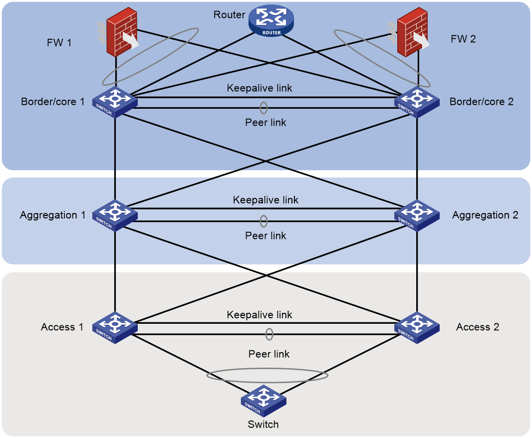

M-LAG in large campus networks
In a large campus network, M-LAG systems are deployed at the following tiers:
·     Access—The access devices in M-LAG systems act as user gateways.
·     Aggregation.
·     Border/Core.
Equal-cost multi-path (ECMP) routes are configured as follows:
·     Between the aggregation and access tiers.
·     Betewen the core and aggregation tiers.
·     Betewen the external routers and border gateways.
Firewalls are interconnected with border gateways by using multichassis link aggregations.
Figure 1 M-LAG in a large campus network

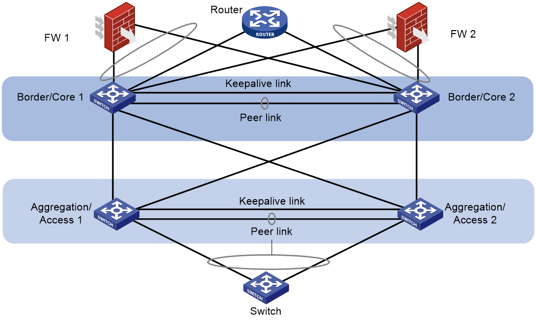

M-LAG in medium campus networks
In a medium campus network, M-LAG systems are deployed at the following tiers:
·     Access/aggregation—The aggregation devices in M-LAG systems act as user gateways.
·     Border/Core.
·     Between the core and aggregation tiers.
·     Between the external routers and border gateways.
Firewalls are interconnected with border gateways by using multichassis link aggregations of M-LAG.
Figure 2 M-LAG in a medium campus network

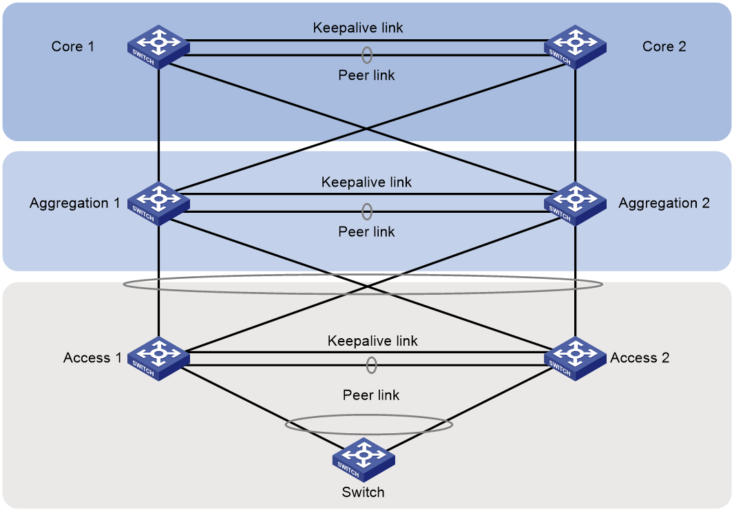

M-LAG in small campus networks
In a small campus network, M-LAG systems are deployed at the following tiers:
·     Access.
·     Border/Core—The core devices in M-LAG systems act as user gateways.
M-LAG is used to set up multichassis link aggregations as follows:
·     Between the core and access tiers.
·     Between the firewalls and the border devices.
Figure 3 M-LAG in a small campus network

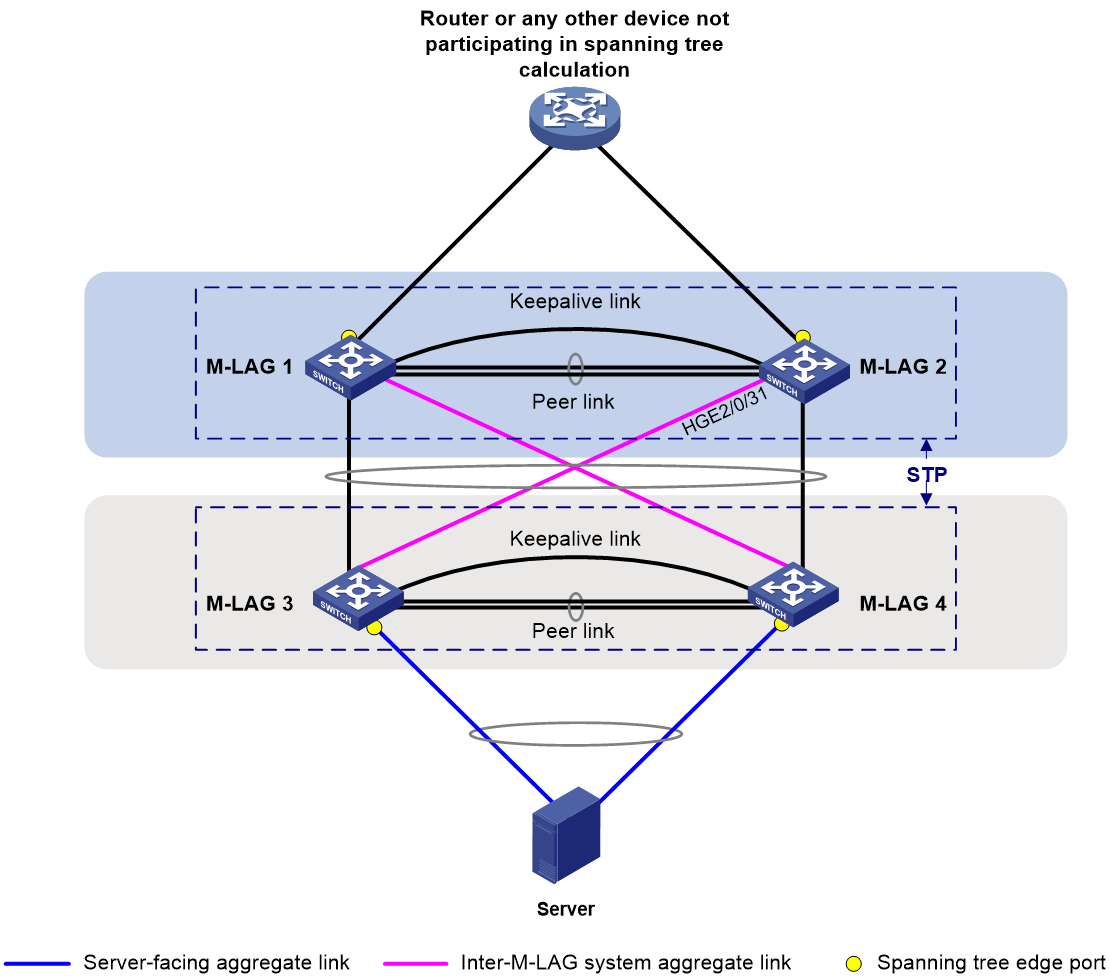

M-LAG and spanning tree
You can use M-LAG in conjunction with spanning tree to remove loops, as shown in Figure 4 and Table 2. If PVST is configured, the M-LAG member devices running PVST must be interoperable with third-party devices running Rapid PVST or PVST. If MSTP is configured, this restriction does not apply.
Figure 4 Network diagram
Table 2 Deployment schemes
Scenario
Solution
Commands
Due to an M-LAG system split, misconnection, or misconfiguration, traffic is sent between two member ports of the same aggregation group over the peer link, which creates a loop.
Enable spanning tree on the M-LAG member devices.
stp global enable (system view)
undo stp enable (Interface view)
A new device added to the network preempts the root bridge role, and network flapping occurs as a result.
Configure the M-LAG member devices in the upstream M-LAG system as root bridges and enable root guard on them.
stp root primary (system view)
stp root-protection (Interface view)
The M-LAG member devices are attacked by using TC-BPDUs and flush MAC address entries frequently, which causes network flapping, high CPU usage, and transient floods.
Enable the TC-BPDU guard feature on the M-LAG member devices.
stp tc-protection (system view)
On an M-LAG member device, an interface cannot recognize BPDUs after its physical state changes.
Configure an interface as an edge port if its peer port does not support or run spanning tree protocols.

Peer-link interfaces of the M-LAG system do not participate in spanning tree calculation.
The M-LAG member devices still use the M-LAG system MAC address after the M-LAG system splits, which will cause spanning tree calculation issues. To avoid the issues, enable M-LAG standalone mode on the M-LAG member devices before the M-LAG system splits.

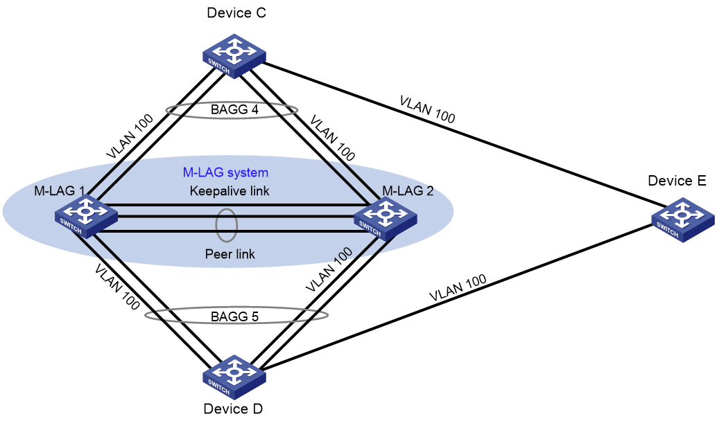

M-LAG and loop detection
A device detects loops by sending detection frames and then checking whether these frames return to any interface on the device. If they do, the device considers that the interface is on a looped link.
You can use M-LAG in conjunction with loop detection to remove loops and notify users to check the network environment, as shown in Figure 5. On M-LAG 1 and M-LAG 2, globally enable loop detection for VLAN 100 or enable loop detection for VLAN 100 on M-LAG interfaces. Device C, the M-LAG system, Device D, and Device E form a physical loop. M-LAG 1 and M-LAG 2 can detect loops on BAGG 4 and BAGG 5 and remove the loops according to the configured loop detection processing mode.
Make sure the M-LAG member devices in an M-LAG system have consistent loop detection configuration.
Figure 5 Network diagram

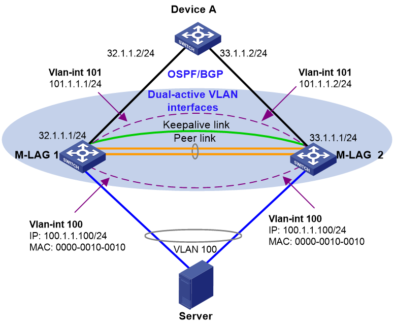

Dual-active VLAN interfaces
Configure VLAN interfaces as redundant gateways on both M-LAG member devices, as shown in Figure 6 and Table 4.
Figure 6 Network diagram
Table 4 Configuration tasks
Tasks
Forwarding
·     VLAN interface configuration:
a.     Create a gateway VLAN interface on each M-LAG member device for the same VLAN.
b.     Assign the same IP address and MAC address to the gateway VLAN interfaces.
c.     Create a VLAN interface on each M-LAG member device for another VLAN, assign the peer-link interfaces to this VLAN, and assign a unique IP address from the same subnet to each of the VLAN interfaces.
The M-LAG member devices use those VLAN interfaces to forward traffic between them when a link to the upstream device is failed.
·     Use Layer 3 interfaces to connect the M-LAG member devices to the upstream device, and configure ECMP routes for load sharing across the uplinks.
·     Layer 3 traffic sent by the user-side endpoints is forwarded to the dual-active gateways.
·     Downstream traffic from the external network to the user-side endpoints is distributed to M-LAG member devices based on ECMP routes. The M-LAG member devices forward the traffic to the user-side endpoints according to the local ARP or ND information.

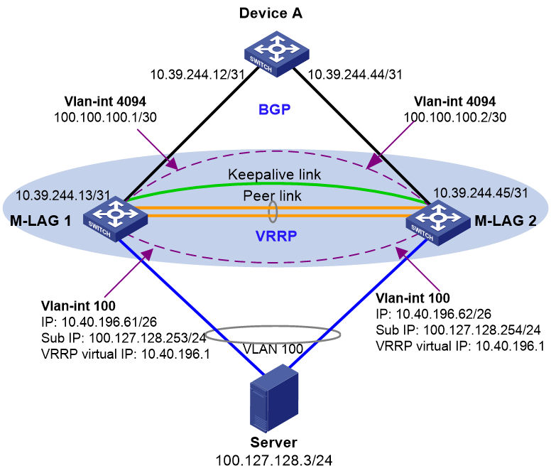

VRRP gateways
Network model
You can configure VRRP groups on an M-LAG system to provide gateway services for the attached endpoints, as shown in Figure 7 and Table 5.
Figure 7 Network diagram
Table 5 Configuration tasks
Tasks
Forwarding
·     Configure a VRRP group on the M-LAG member devices and use the VRRP virtual IP address as the gateway for the attached endpoints.
a.     Create a VLAN interface for the VLAN where the M-LAG interface resides on each M-LAG member device.
b.     Assign a unique primary IP address from one subnet to each of the VLAN interfaces.
·     Set up a Layer 3 connection over the peer link between the M-LAG member devices.
The M-LAG member devices use the Layer 3 connection to forward traffic between them when a link to the upstream device is failed.
·     For the Layer 3 traffic sent by the endpoints, the VRRP gateways on both M-LAG member devices can perform forwarding.
·     For the external traffic destined for the endpoints, the M-LAG member devices make forwarding decisions based on local ARP and ND entries.
·     Traffic is load shard acorss the uplinks and downlinks.
If you use M-LAG and VRRP together, make sure the keepalive hold timer is shorter than the interval at which the VRRP master sends VRRP advertisements. Violation of this restriction might cause a VRRP master/backup switchover to occur before peer link failure is acknowledged. To set the interval at which the VRRP master sends VRRP advertisements, use the vrrp vrid timer advertise command or the vrrp ipv6 vrid timer advertise command. To set the keepalive hold timer, use the m-lag keepalive hold-time command.
To avoid frequent master/backup switchovers, configure the routers in a VRRP group to operate in non-preemptive mode.

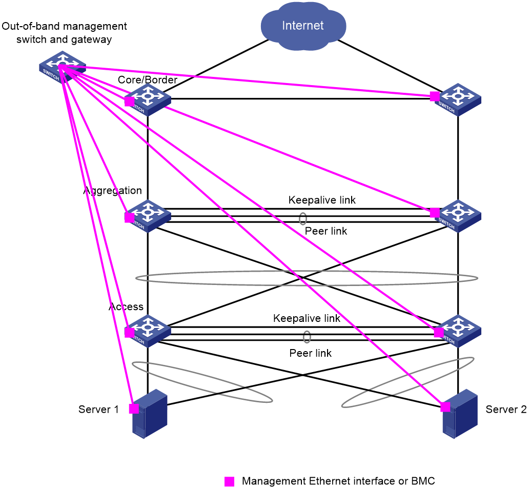

Management network design
As a best practice to prevent forwarding faults from interrupting device management, use management Ethernet interfaces to connect devices to a management network for out-of-band management. Table 6 shows the number of management Ethernet interfaces on the campus devices.
In an M-LAG system, all management Ethernet interfaces on both M-LAG member devices are available. You need to manage the M-LAG member devices separately.
Table 6 Number of management Ethernet interfaces on campus devices
Devices providing two or more management Ethernet interfaces
Devices providing one management Ethernet interface
·     S12500G-AF series
·     S10500 series
·     S10500X series
·     S7500E series
·     S7500X series
·     S7600E-X series
·     S7600-X series
·     S7600 series
·     S6550XE-HI series
·     S6525XE-HI series
·     S6520X-EI
·     S6520X-HI
·     S5590-HI
·     S5590-EI
·     S5560X-HI
·     S5560X-EI
Figure 8 shows the management network topology for a campus network. The border, core, aggregation, and acess devices are attached to the out-of-band management switch by using management Ethernet interfaces. The switch provides gateway services.
Figure 8 Out-of-band management

High availability schemes
Figure 9 and Table 7 show the high availability schemes for an M-LAG network.
Figure 9 Network diagram
Table 7 M-LAG high availability schemes
Scenario
Impact
M-LAG device failure
·     When an M-LAG member device restarts, traffic is switched to its M-LAG peer.
·     After the restarted M-LAG member device joins the M-LAG system, the following events occur:
a.     The peer link comes up.
b.     The M-LAG peer sends its MAC address entries and ARP entries over the peer link to the restarted M-LAG member device.
c.     The restarted M-LAG member device brings up the member ports of the M-LAG interfaces when the data restoration interval set by using the m-lag restore-delay command expires.
d.     The restarted M-LAG member device brings up all service interfaces after forwarding entries are refreshed for all interfaces.
N/A
Service module falure
If the uplink or downlinks are connected to different service modules on an M-LAG member device, when a service module fails, traffic will switch to the other service modules. If no available links are present on the other service modules, the traffic will be processed by the M-LAG peer.
If an M-LAG member device have multiple service modules or interface expansion modules, connect the uplinks and downlinks to different service modules or interface expansion modules. Make sure the uplinks or downlinks are not connected to multiple modules.
ECMP link failure
·     If the link between Aggregation 1 and Core 1 fails, uplink traffic is switched to Core 2.
·     If all links between Aggregation 1 and the core devices are down, traffic is sent over the peer link to Aggregation 2.
N/A
Multichassis aggregate link failure
·     The switch is duamhomed to the access devices. If a member link of the multichassis aggregate link fails, traffic is switched to the other member link. When the failed member link recovers, traffic is switched back to it.
·     If the link between Access 1 and Aggergation 1 fails, uplink traffic is switched to Aggergation 2.
·     If all links between Access 1 and the aggregation devices are down, traffic is sent over the peer link to Access 2.
Keepalive link failure
Keepalive link failure does not affect traffic forwarding. This link is used for multi-active collision detection only when a device or the peer link fails.
Exclude the interfaces used for keepalive detection from the shutdown action by M-LAG MAD.
Peer link failure
·     The secondary aggregation device places its uplink and downlink interfaces in M-LAG MAD DOWN state to switch traffic to the other aggregation device.
·     After the peer link recovers, the interfaces in M-LAG MAD DOWN state are brought up after the data restoration interval set by using the m-lag restore-delay command expires. Then, traffic is switched back to the secondary aggregation device.
Use interfaces from multiple modules or submodules to set up the peer link.
Concurrent peer link and keepalive link failures
If the keepalive link goes down before the peer link goes down, the following events occur:
1.     The M-LAG member devices are placed in M-LAG standalone mode.
2.     Only one M-LAG member device has selected aggregation member ports and forwards traffic.
If the peer link goes down before the keepalive link goes down, the following events occur:
1.     When the peer link does down, the secondary M-LAG member device places its interfaces in M-LAG MAD DOWN state.
2.     When the keepalive link goes down, the secondary M-LAG member device brings up its interfaces in M-LAG MAD DOWN state.
The M-LAG member devices are placed in M-LAG standalone mode. Only one M-LAG member device has selected aggregation member ports and forwards traffic.
·     Enable M-LAG standalone mode on the leaf devices by using the m-lag standalone enable command.
·     Configure the LACP system ID by using one of the following methods:
¡     Execute the lacp system-mac and lacp system-priority commands in system view.
¡     Execute the port lacp system-mac and port lacp system-priority commands in Layer 2 aggregate interface view.
