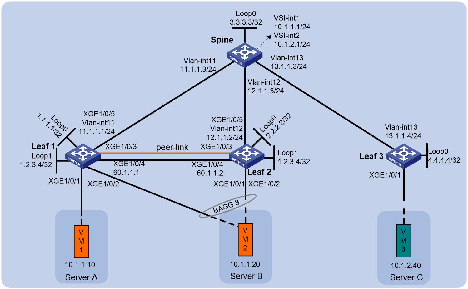

Example: Configuring an M-LAG + EVPN VXLAN centralized gateway network (Ethernet aggregate link as peer link) (campus)
As shown in Figure 1:
· Leaf 1 and Leaf 2 form an M-LAG system, and they use an Ethernet aggregate link as the peer link.
· Server A is single-homed to Leaf 1, and Server B is connected to the M-LAG system through M-LAG interfaces.
· Leaf 1 and Leaf 2 are connected to the uplink device Spine through Equal-Cost Multi-Path (ECMP) routes.
· Spine is a centralized EVPN gateway connected to the Wide Area Network (WAN). It also serves as a route reflector (RR) and reflects routes between Leaf 1, Leaf 2, and Leaf 3.
Configure the network to meet the following requirements:
· Server A and Server B belong to VXLAN 10, and Server C belongs to VXLAN 20. Server A, Server B, and Server C communicate with each other through the centralized EVPN gateway.
· When a link fails between the two M-LAG member devices, Server A, Server B, and Server C can still communicate with each other.

Applicable product matrix
NOTE: In addition to running an applicable software version, you must also install the most recent patch, if any. |
Devices |
Software versions |
S10500, S10500X, S7600, S7600-X, S7600E-X, S7500X, S7500E |
R7625 and later |
S12500G-AF |
R7625 and later |
Analysis
· Leaf 1 and Leaf 2 act as M-LAG member devices, and an Ethernet aggregate link acts as the peer link.
· Leaf 1 and Leaf 2 are connected to the uplink device Spine through ECMP routes.
· Configure OSPF neighbors on the peer link between Leaf 1 and Leaf 2 to connect the single-homed services. The peer link also acts as a backup path for the network side and single-homed services.
· On the overlay, both IPv4 and IPv6 network settings exist.
All devices in this example were started with the factory default configuration. When you are working on a live network, make sure you understand the potential impact of every command on your network.
The primary and secondary M-LAG member devices must deploy different uplink VLAN interfaces to avoid loops. As a best practice, disable the spanning tree protocol on the interfaces when making sure no physical loops exist.
On the primary and secondary M-LAG member devices, the frame match criteria of the dynamic ACs on the peer link must be the same.
· Solution 1: Use the l2vpn m-lag peer-link ac-match-rule vxlan-mapping command to enable the device to create frame match criteria based on VXLAN IDs for the dynamic ACs on the peer link.
If an M-LAG system uses an Ethernet aggregate link as the peer link, each member device creates a dynamic AC on the peer link when an AC (Ethernet service instance) is configured on a site-facing interface. The dynamic AC and the site-facing AC have the same frame match criteria and VSI mapping. If two site-facing ACs on different interfaces have the same frame match criteria but different VSI mappings, the dynamic ACs created for the site-facing ACs will conflict with each other on the peer link. Use this command to resolve the preceding issue.
· Solution 2: Create an AC on the peer link interface based on the frame match criteria of the site-facing Ethernet service instance.
You do not need to configure other settings. This solution is used by default.

Create VSI instance vpna. |
N/A |
vxlan 10 |
vxlan 10 |
Configure VXLAN 10. |
N/A |
arp suppression enable |
Configure ARP suppression. |
N/A |
evpn encapsulation vxlan |
Create an EVPN instance. |
N/A |
route-distinguisher auto |
Configure the device to automatically generate an RD for the EVPN instance. |
N/A |
vpn-target auto |
vpn-target auto |
Configure the device to automatically generate an RT for the EVPN instance. |
N/A |
quit |
quit |
Return to VSI view. |
N/A |
quit |
quit |
Return to system view. |
N/A |
bgp 200 |
bgp 200 |
Enter BGP view. |
N/A |
peer 3.3.3.3 as-number 200 |
Configure a BGP peer. |
N/A |
peer 3.3.3.3 connect-interface loopback 0 |
Specify a source interface for establishing TCP connections to a BGP peer. |
N/A |
address-family l2vpn evpn |
Configure BGP to advertise EVPN routes. |
N/A |
peer 3.3.3.3 enable |
Enable a BGP EVPN peer. |
N/A |
quit |
quit |
Return to BGP view. |
N/A |
quit |
quit |
N/A |
interface Ten-gigabitethernet 1/0/2 |
N/A |
Single-homed interface. |
N/A |
service-instance 1000 |
N/A |
Create Ethernet service instance 1000 on the interface connecting to the server. |
N/A |
encapsulation s-vid 2 |
N/A |
Configure the instance to match data frames of VLAN 2. |
N/A |
xconnect vsi vpna |
N/A |
Map Ethernet service instance 1000 to VSI vpna. |
N/A |
quit |
N/A |
N/A |
interface bridge-aggregation 3 |
Enter Ethernet aggregate interface view. |
N/A |
N/A |
encapsulation s-vid 3 |
Configure the instance to match data frames of VLAN 3. |
N/A |
xconnect vsi vpna |
xconnect vsi vpna |
N/A |
quit |
quit |
N/A |
m-lag mad exclude interface loopback 0 |
Exclude all VXLAN interfaces from the shutdown action by M-LAG MAD. |
N/A |
m-lag mad exclude interface vlan-interface 11 |
m-lag mad exclude interface vlan-interface 12 |
N/A |
Configuring the uplink device Leaf 3
Procedure summary
Configuring EVPN VXLAN
Leaf 3 |
Description |
Remarks |
l2vpn enable |
Enable L2VPN. |
N/A |
vsi vpnb |
Create VSI instance vpnb. |
N/A |
vxlan 20 |
Create VXLAN 20. |
N/A |
Create an EVPN instance in VSI instance vpnb. |
N/A |
N/A |
vpn-target auto |
N/A |
quit |
N/A |
quit |
N/A |
bgp 200 |
Enter BGP view. |
N/A |
N/A |
N/A |
Enter L2VPN EVPN view. |
N/A |
N/A |
quit |
N/A |
quit |
N/A |
interface Ten-gigabitethernet1/0/3 |
Enter Ethernet interface view. |
N/A |
N/A |
encapsulation s-vid 4 |
Configure the instance to match data frames of VLAN 4. |
N/A |
xconnect vsi vpnb |
Map Ethernet service instance 1000 to VSI vpnb. |
N/A |
quit |
N/A |
Configuring the gateway device Spine
Procedure summary
Spine |
Description |
Remarks |
l2vpn enable |
Enable L2VPN. |
N/A |
vxlan tunnel mac-learning disable |
Disable remote MAC address learning for VXLANs. This setting avoids the conflict between automatically learned MAC address entries and MAC address entries advertised through BGP EVPN. |
N/A |
vsi vpna |
N/A |
vxlan 10 |
N/A |
N/A |
N/A |
vpn-target auto |
N/A |
quit |
N/A |
quit |
N/A |
vsi vpnb |
N/A |
vxlan 20 |
Configure VXLAN 20. |
N/A |
N/A |
N/A |
vpn-target auto |
N/A |
quit |
N/A |
quit |
N/A |
bgp 200 |
Enter BGP view. |
N/A |
group evpn |
Configure a BGP EVPN group |
N/A |
peer 1.1.1.1 group evpn |
N/A |
peer 2.2.2.2 group evpn |
N/A |
peer 4.4.4.4 group evpn |
N/A |
peer evpn as-number 200 |
Configure an AS number for the BGP EVPN group |
N/A |
peer evpn connect-interface loopback 0 |
Specify a source interface for establishing TCP connections to a BGP EVPN group. |
N/A |
N/A |
peer evpn enable |
Enable the BGP EVPN group. |
N/A |
undo policy vpn-target |
Disable route target filtering for BGP EVPN routes. |
N/A |
peer evpn reflect-client |
Configure BGP to reflect EVPN routes. |
N/A |
quit |
N/A |
quit |
N/A |
interface vsi-interface 1 |
Create VSI-interface 1. |
N/A |
ip address 10.1.1.1 255.255.255.0 |
Configure an IP address, which is to be used as the gateway address of the servers in VXLAN 10. |
N/A |
Ipv6 address 10::1 64 |
Configure an IPv6 address, which is to be used as the gateway address of the servers in VXLAN 10. |
N/A |
quit |
N/A |
interface vsi-interface 2 |
Create VSI-interface 2. |
N/A |
ip address 10.1.2.1 255.255.255.0 |
Configure an IP address, which is to be used as the gateway address of the servers in VXLAN 20. |
N/A |
Ipv6 address 11::1 64 |
Configure an IPv6 address, which is to be used as the gateway address of the servers in VXLAN 20. |
N/A |
quit |
N/A |
vsi vpna |
Enter VSI view. |
N/A |
gateway vsi-interface 1 |
Specify VSI-interface 1 as the gateway interface for the VSI of VXLAN 10. |
N/A |
quit |
N/A |
vsi vpnb |
Enter VSI view. |
N/A |
gateway vsi-interface 2 |
Specify VSI-interface 2 as the gateway interface for the VSI of VXLAN 20. |
N/A |
quit |
N/A |
Traffic model
About the traffic model
The traffic model contains the following information:
· ID—Traffic ID, in O-X-XXX format. The first segment (O) represents overlay traffic. The second segment (X) represents the IP version (4 for IPv4 and 6 for IPv6). The third segment (XXX) represents a unique number for the traffic.
· Type—Traffic type, such as known unicast/IPv4 and unicast/L2.
· Direction—Traffic direction, such as inter-leaf east-west traffic and north-south traffic.
· Path—The nodes that the traffic traverses from the source to the destination.
· Simulation method—Traffic simulation method. Testers are used to simulate the patterns of traffic on the network set up in this example.
· Simulation traffic load—The network can be tested under light load (fewer than 1000 simulation traffic flows) or heavy load (more than 1000 simulation traffic flows).
· Traffic direction to firewalls/LBs—No firewalls or LBs are used in this example, or traffic is directed to firewalls or LBs through PBR, M-LAG+VRRP, or static routing.
Overlay traffic
ID |
Type |
Direction |
Path |
Simulation method |
Simulation traffic load |
Traffic direction to firewalls/LBs |
Remarks |
O-4-001 |
Known unicast/IPv4 |
Inter-leaf east-west traffic |
Server A-Leaf 1-Spine-Leaf 3-Server C |
Tester |
Light |
N/A |
When the uplink interface fails, traffic is forwarded along the Layer 3 link between M-LAG member devices |
O-4-002 |
Server B-Leaf 1/2-Spine-Leaf 3-Server C |
Tester |
Light |
N/A |
N/A |
O-6-001 |
Known unicast/IPv6 |
ServerA-Leaf 1-Spine-Leaf 3-Server C |
Tester |
Light |
N/A |
O-6-002 |
Tester |
Light |
N/A |
N/A |

2. Verify the M-LAG system configuration.
# Verify EVPN routing information on node Leaf 1.
[Leaf 1] display bgp l2vpn evpn
BGP local router ID is 1.2.3.4
Status codes: * - valid, > - best, d - dampened, h - history,
s - suppressed, S - stale, i - internal, e - external
a - additional-path
Origin: i - IGP, e - EGP, ? - incomplete
Total number of routes from all PEs: 5
Route distinguisher: 1:100
Total number of routes: 5
* > Network : [2][0][48][0800-2700-400e][0][0.0.0.0]/104
NextHop : 1.2.3.4 LocPrf : 100
PrefVal : 32768 OutLabel : NULL
MED : 0
Path/Ogn: i
* >i Network : [2][0][48][46b2-aea0-0101][0][0.0.0.0]/104
NextHop : 3.3.3.3 LocPrf : 100
PrefVal : 0 OutLabel : NULL
MED : 0
Path/Ogn: i
* > Network : [2][0][48][ac1e-24e3-0201][0][0.0.0.0]/104
MED : 0
Path/Ogn: i
* >i Network : [3][0][32][1.2.3.4]/80
MED : 0
Path/Ogn: i
* >i Network : [3][0][32][3.3.3.3]/80
MED : 0
Path/Ogn: i
[Leaf 1] display interface tunnel
Tunnel0
Current state: UP
Line protocol state: UP
Description: Tunnel0 Interface
Bandwidth: 64 kbps
Maximum transmission unit: 1464
Internet protocol processing: Disabled
Output queue - Urgent queuing: Size/Length/Discards 0/100/0
Output queue - Protocol queuing: Size/Length/Discards 0/500/0
Output queue - FIFO queuing: Size/Length/Discards 0/75/0
Last clearing of counters: Never
Tunnel source 1.2.3.4, destination 3.3.3.3
Tunnel protocol/transport UDP_VXLAN/IP
Last 300 seconds input rate: 0 bytes/sec, 0 bits/sec, 0 packets/sec
Last 300 seconds output rate: 0 bytes/sec, 0 bits/sec, 0 packets/sec
Input: 0 packets, 0 bytes, 0 drops
Output: 0 packets, 0 bytes, 0 drops
# View the VSI information on Leaf 1 to verify that ACs are automatically created on the peer link and they are associated with VSIs.
[Leaf 1] display l2vpn vsi verbose
VSI Name: vpna
VSI Index : 1
VSI State : Up
MTU : 1500
Bandwidth : Unlimited
Broadcast Restrain : Unlimited
Multicast Restrain : Unlimited
Unknown Unicast Restrain: Unlimited
MAC Learning : Enabled
MAC Table Limit : -
MAC Learning rate : -
Drop Unknown : -
Flooding : Enabled
Statistics : Disabled
VXLAN ID : 10
Tunnels:
Tunnel Name Link ID State Type Flood proxy
Tunnel0 0x5000000 UP Auto Disabled
ACs:
AC Link ID State Type
XGE1/0/1 srv1000 0 Up Manual
BAGG1 srv2 1 Up Dynamic (M-LAG)
BAGG3 srv1000 2 Up Manual
3. Verify that Server A/Server B can communicate with Server C.
4. Verify that traffic can still be forwarded between Server B and Server C when the downlink M-LAG member interface of Leaf 1 or Leaf 2 fails.
Transient packet loss might occur during the switchover process.
5. Verify that traffic can still be forwarded between Server A/Server B and Server C when the uplink interface of Leaf 1 or Leaf 2 fails.
