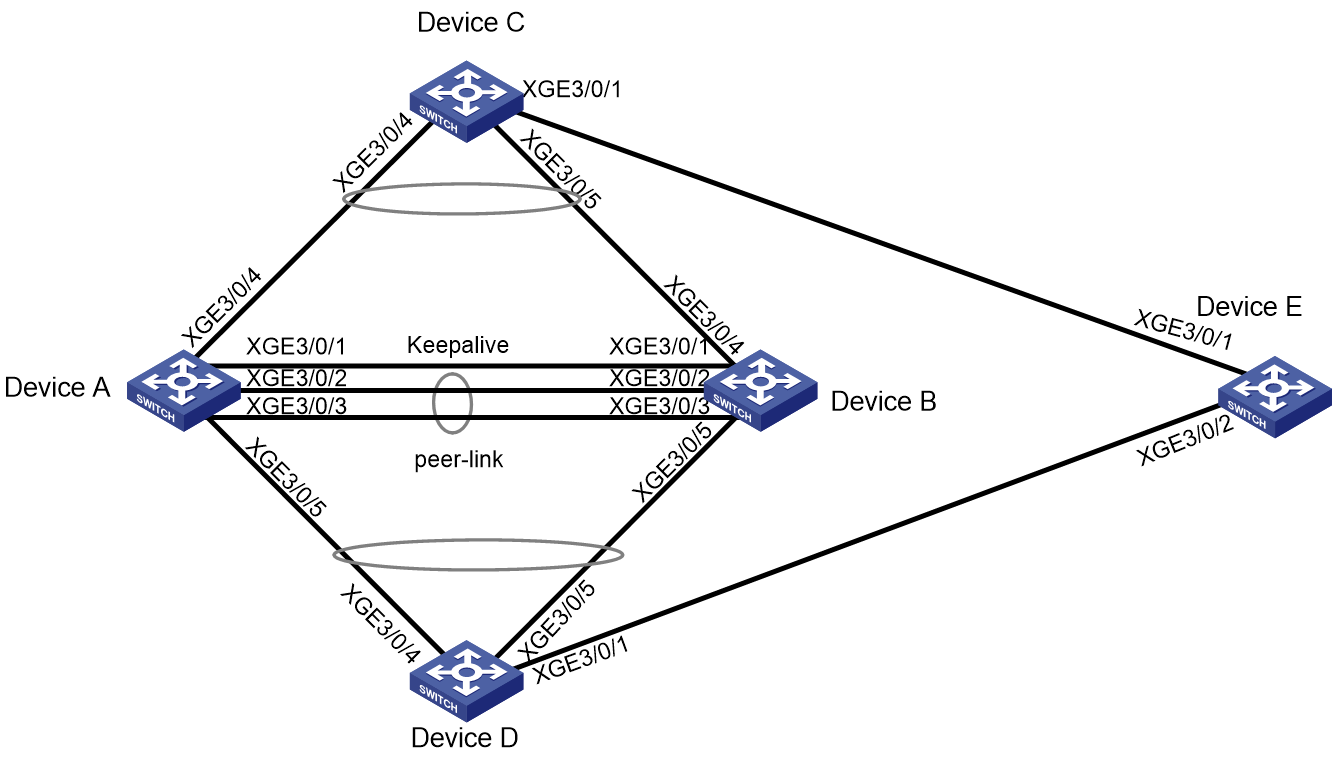

As shown in Figure 1:
· Device A and Device B form an M-LAG system. Device C and Device D access the M-LAG system through M-LAG interfaces.
· Device E is connected to Device C and Device D.
Configure loop detection on the M-LAG system to meet the following requirements:
· Automatically shuts down the interface on which
a loop is detected.
Generates a log as a notification.
Device |
Interface |
IP address |
Remarks |

Analysis
· Configure Device A and Device B to form an M-LAG system. Assign the uplink interfaces to an M-LAG group connecting to Device C, and the downlink interfaces to another M-LAG group connecting to Device D.
· Enable loop detection on Device A and Device B.
· Disable the spanning tree feature globally.
All the devices were started with the factory default configuration. When you are working on a live network, make sure you understand the potential impact of every command on your network.

Configure Device C/Device D
Procedure summary
· Configuring the interconnect links between Device C/Device D and the LAG devices
· Configuring the interconnect links between Device C/Device D and Device E
· Disabling the spanning tree feature globally on Device C/Device D
Device C |
Device D |
Description |
Remarks |
vlan 100 |
vlan 100 |
Create a VLAN. |
N/A |
quit |
quit |
Return to system view. |
N/A |
interface bridge-aggregation 4 |
interface bridge-aggregation 5 |
Create the Ethernet aggregate interface connecting to M-LAG devices. |
N/A |
link-aggregation mode dynamic |
Configure the aggregate interface to operate in dynamic mode. |
N/A |
quit |
quit |
N/A |
interface range Ten-gigabitethernet 3/0/4 Ten-gigabitethernet 3/0/5 |
Enter the view of the physical interfaces connecting the M-LAG system to Device C. |
N/A |
port link-aggregation group 4 |
port link-aggregation group 5 |
Assign interfaces to an aggregation group. |
N/A |
quit |
quit |
N/A |
Enter Ethernet aggregate interface view. |
N/A |
port link-type trunk |
Set the link type of the Layer 2 aggregate interface (Bridge-Aggregation 4) to trunk. |
N/A |
port trunk permit vlan 100 |
Assign the interface to VLAN 100. |
N/A |
undo port trunk permit vlan 1 |
Remove the interface from VLAN 1. |
N/A |
quit |
quit |
N/A |
Device C |
Device D |
Description |
Remarks |
interface Ten-gigabitethernet 3/0/1 |
Enter Ethernet interface view. |
N/A |
Set the link type of the interface to trunk. |
N/A |
Assign Ten-gigabitethernet 3/0/1 (which connects Device C/Device D to Device E) to VLAN 100. |
N/A |
N/A |
quit |
quit |
N/A |
Device C |
Device D |
Description |
Remarks |
undo stp global enable |
Disable the spanning tree feature globally. |
To simulate the loop occurrence. |
Configure Device E
Procedure summary
· Configuring the interconnect links between Device E and Device C/Device D
· Disabling the spanning tree feature globally on Device E
Device E |
Description |
Remarks |
vlan 100 |
Create a VLAN. |
N/A |
quit |
N/A |
interface range Ten-gigabitethernet 3/0/1 Ten-gigabitethernet 3/0/2 |
Enter the view of the Ethernet interface range. |
N/A |
N/A |
N/A |
N/A |
quit |
N/A |
Device E |
Description |
Remarks |
Traffic model
This document provides configuration examples of the loop detection feature. The traffic model has no practical significance when a loop exists.
Convergence performance test results
For more information, see "Traffic model."

Verifying the loop detection function
After configuration, verify that Device A detects loops on Bridge-Aggregation 4 and Bridge-Aggregation 5 within a loop detection interval and prints the following system logs:
[DeviceA]
%... DeviceA LPDT/4/LPDT_LOOPED: A loop was detected on Bridge-Aggregation4.
%... DeviceA LPDT/4/LPDT_VLAN_LOOPED: A loop was detected on Bridge-Aggregation4 in VLAN 100.
%... DeviceA LPDT/4/LPDT_LOOPED: A loop was detected on Bridge-Aggregation5.
%... DeviceA LPDT/4/LPDT_VLAN_LOOPED: A loop was detected on Bridge-Aggregation5 in VLAN 100.
%...DeviceA LPDT/5/LPDT_VLAN_RECOVERED: A loop was removed on Bridge-Aggregation4 in VLAN 100.
%... DeviceA LPDT/5/LPDT_RECOVERED: All loops were removed on Bridge-Aggregation4.
%... DeviceA LPDT/5/LPDT_VLAN_RECOVERED: A loop was removed on Bridge-Aggregation5 in VLAN 100.
%... DeviceA LPDT/5/LPDT_RECOVERED: All loops were removed on Bridge-Aggregation5.
Use the display loopback-detection command to display the loop detection configuration and status on Device A.
# Display the loop detection configuration and status on Device A.
[DeviceA] display loopback-detection
Loop detection is enabled.
Global loop detection interval is 35 second(s).
Loop is detected on following interfaces:
Interface Action mode VLANs/VSI
Bridge-Aggregation4 Shutdown 100
Bridge-Aggregation5 Shutdown 100
The output shows the following information:
· Device A detected loops on Bridge-Aggregation 4 and Bridge-Aggregation 5 within a loop detection interval.
· Loops on Bridge-Aggregation 4 and Bridge-Aggregation 5 were removed. Use the display interface command to display status of Bridge-Aggregation 4 and Bridge-Aggregation 5.
# Display information about Bridge-Aggregation 4 on Device A.
[DeviceA] display interface Bridge-Aggregation 4
Bridge-Aggregation4
The interface has assigned a M-LAG group.
Current state: DOWN (Loopback detection down)
# Display information about Bridge-Aggregation 5 on Device A.
[DeviceA] display interface Bridge-Aggregation 5
Bridge-Aggregation5
The output shows that Bridge-Aggregation 4 and Bridge-Aggregation 5 have been shut down by loop detection.
Verifying the loop detection function upon failures of interfaces on Device A/Device B connecting Device C/Device D
Disconnect the interfaces on Device A connecting Device C/Device D to verify that the loop detection function operates correctly. (Results are the same as those in step 2.)
