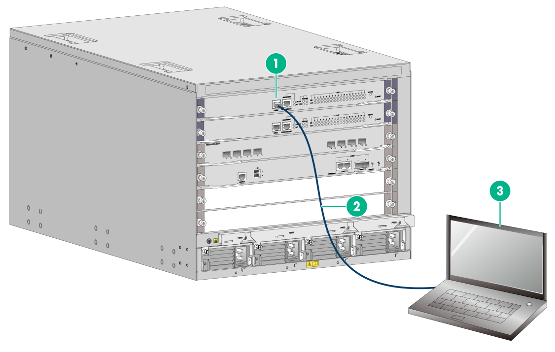

Connecting a DB9-to-RJ45 console cable
1.     Prepare a console cable and a configuration terminal.
¡     Console cable8-core console cable with a crimped RJ-45 connector at one end and a DB-9 female connector at the other end.
¡     Configuration terminal—Terminal with a serial port such as a PC.
2.     Plug the DB-9 female connector of the console cable to the serial port on the PC.
3.     Plug the RJ-45 connector of the console cable to the console port on the gateway.
·     The serial ports on PCs do not support hot swapping. To connect a PC to an operating gateway, first connect the PC end. To disconnect a PC from an operating gateway, first disconnect the gateway end.
·     When the PC does not have an RS-232 port but only a USB port, use a USB to RS-232 converter to connect the USB port to the console cable and install the corresponding driver program correctly.
Figure 1 Setting up the configuration environment (M9006)
(1) Console port
(2) Console cable
(3) Configuration terminal
