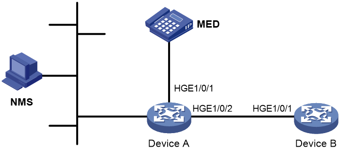

LLDP exchanges packets between neighbor agents and creates and maintains neighbor information for them. Figure 1 shows the neighbor relationships for these LLDP agents.
Figure 1 LLDP neighbor relationships
The types of supported LLDP agents vary with the bridge mode in which LLDP operates. LLDP supports the following bridge modes: customer bridge (CB) and service bridge (SB).
·     Customer bridge mode—LLDP supports nearest bridge agent, nearest non-TPMR bridge agent, and nearest customer bridge agent. LLDP processes the LLDP frames with destination MAC addresses for these agents and transparently transmits the LLDP frames with other destination MAC addresses in VLANs.
·     Service bridge mode—LLDP supports nearest bridge agent and nearest non-TPMR bridge agent. LLDP processes the LLDP frames with destination MAC addresses for these agents and transparently transmits the LLDP frames with other destination MAC addresses in VLANs.

Example: Configuring basic LLDP functions
As shown in Figure 5, enable LLDP globally on Device A and Device B to perform the following tasks:
·     Monitor the link between Device A and Device B on the NMS.
·     Monitor the link between Device A and the MED device on the NMS.
Figure 5 Network diagram
By default, interfaces on the device are in ADM or Administratively Down state. To have an interface operate, you must use the undo shutdown command to enable that interface.
