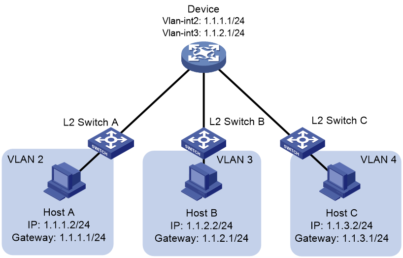

As shown in Figure 2, Host A is in VLAN 2, Host B is in VLAN 3, and Host C is in VLAN 4. For Host A and Host B to communicate with each other, perform the following tasks:
1. Specify 1.1.1.1/24 and 1.1.2.1/24 as the gateway IP address for Host A and Host B, respectively.
2. On the device, create VLAN-interface 2 and configure the IP address as 1.1.1.1/24, which is the same as the gateway address of Host A. Create VLAN-interface 3 and configure the IP address as 1.1.2.1/24, which is the same as the gateway address of Host B.
VLAN termination by the outermost VLAN ID of packets is automatically performed on VLAN interfaces. For example, when Host A sends a packet to Host B, VLAN-interface 2 removes the VLAN tag from the packet and forwards it to VLAN-interface 3. Then, VLAN-interface 3 tags the packet with VLAN 3 and Host B can receive the packet.
Because the device does not have a VLAN interface to terminate packets from VLAN 4, Host C cannot communicate with Host A or Host B.
Figure 2 Inter-VLAN communication through VLAN interfaces
