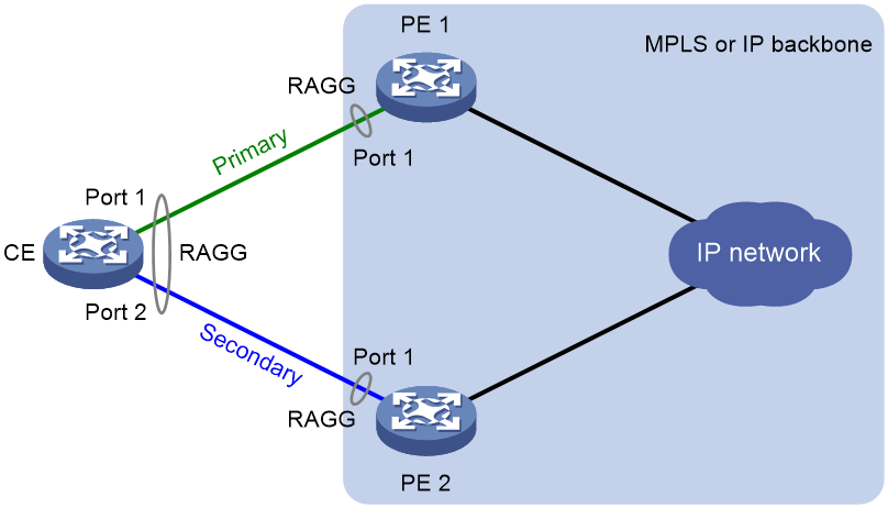

Configuring a 1+1 backup aggregation group· 16
About 1+1 backup link aggregation· 16
1+1 backup link aggregation tasks at a glance· 16
Configuring a static 1+1 backup aggregation group· 16
Specifying a primary member port 17
Setting the reversion delay· 17
Configuring a 1+1 backup aggregation group to place its secondary member port in down state· 18
Performing a primary/secondary member port switchover 18
As shown in Figure 6, a 1+1 backup aggregation group is used on a CE that is dualhomed to PEs for high availability of services. A 1+1 backup aggregation group is a static Layer 3 aggregation group that contains one primary member port and one secondary member port. The primary member port is placed in Selected state to forward all traffic, and the secondary member port is placed in Unselected state as a standby.
Figure 6 Application scenarios for 1+1 backup link aggregation
To configure a 1+1 backup aggregation group, perform the following tasks:
1.     Configuring a static 1+1 backup aggregation group
2.     (Optional.) Specifying a primary member port
3.     (Optional.) Setting the reversion delay
4.     (Optional.) Configuring a 1+1 backup aggregation group to place its secondary member port in down state
5.     (Optional.) Performing a primary/secondary member port switchover
A 1+1 backup aggregation group can contain a maximum of two member ports.

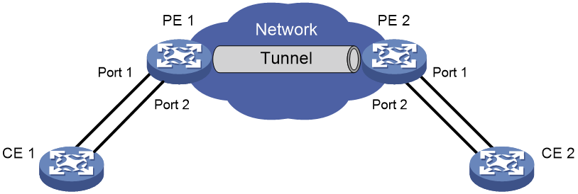

Enabling transparent LACPDU transmission
To establish a dynamic aggregation between two remote CEs in an L2VPN network, use transparent LACPDU transmission on the PEs to which the CEs are attached, as shown in Figure 7.
This feature enables the PEs to forward LACPDUs for the CEs to establish a dynamic aggregation.
If this feature is disabled, the PEs terminate the LACPDUs. The remote CEs cannot establish dynamic aggregations.
Figure 7 Application scenario of transparent LACPDU transmission
‌Prerequisites
Perform the following tasks on PEs:
1.     Configure the untagged or default frame match criterion for the Ethernet service instances on the interfaces connected to CEs.
2.     Map the Ethernet service instances to different VSIs and set the access mode to Ethernet for the VSIs.
When you use this feature on the PEs, follow these guidelines:
·     Enable transparent LACPDU transmission on the interfaces that transmit traffic between CEs and PEs and between PEs.
·     Do not use an interface for dynamic link aggregation if you enable transparent LACPDU transmission on that interface. With transparent LACPDU transmission enabled, an interface cannot be selected for aggregation.
·     You must enable transparent LACPDU transmission on a Layer 2 Ethernet interface facing the public network. You do not need to enable transparent LACPDU transmission on a Layer 3 Ethernet interface facing the public network.
2.     Enter interface view.
3.     Enable transparent LACPDU transmission.
lacp transparent enable
By default, transparent LACPDU transmission is disabled.
