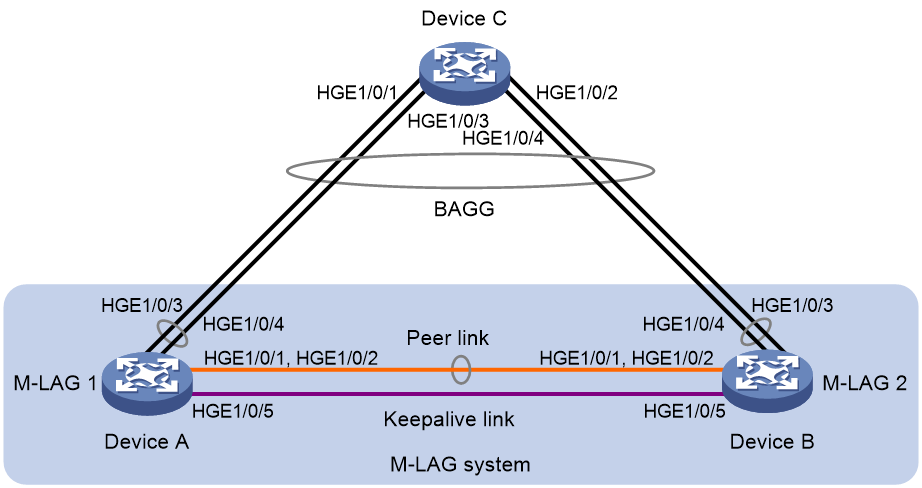

As shown in Figure 1, M-LAG virtualizes two devices into an M-LAG system, which connects to the remote aggregation system through a multichassis aggregate link. To the remote aggregation system, the M-LAG system is one device.
Figure 1 M-LAG network model
The M-LAG member devices are M-LAG peers to each other.
M-LAG defines the following interface roles for each M-LAG member device:
·     M-LAG interface—Layer 2 aggregate interface connected to the remote aggregation system. M-LAG interfaces connected to the same remote aggregation system belong to one M-LAG group. In Figure 1, Bridge-Aggregation 1 on Device A and Bridge-Aggregation 2 on Device B belong to the same M-LAG group. M-LAG interfaces in an M-LAG group form a multichassis aggregate link.
·     Peer-link interface—Interface connected to the M-LAG peer for internal control. Each M-LAG member device has only one peer-link interface. The peer-link interfaces of the M-LAG member devices transmit M-LAG protocol packets and data packets through the peer link established between them. An M-LAG system has only one peer link.
M-LAG member devices use a keepalive link to monitor each other's state. For more information about the keepalive mechanism, see "Keepalive and failover mechanism."
If a device is attached to only one of the M-LAG member devices in an M-LAG system, that device is a single-homed device.

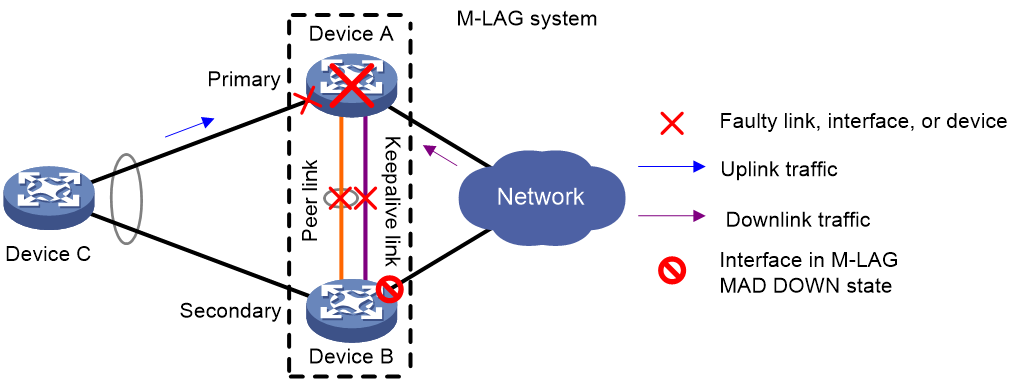

MAD mechanism
M-LAG MAD
A multi-active collision occurs if the peer link goes down while the keepalive link is up. To avoid network issues, M-LAG MAD by default shuts down all network interfaces on the secondary M-LAG member device except those manually or automatically excluded. For more information about automatically excluded ports, see "List of automatically excluded interfaces."
When the peer link comes up, the secondary M-LAG member device starts a delay timer and begins to restore table entries (including MAC address entries and ARP entries) from the primary M-LAG member device. When the delay timer expires, the secondary M-LAG member device brings up all network interfaces placed in M-LAG MAD DOWN state.
M-LAG MAD DOWN state persistence
Both of the M-LAG member devices might take the primary role if both of them have M-LAG interfaces in up state after the following series of events occur:
1.     The peer link goes down while the keepalive link is up. Then, M-LAG MAD shuts down all network interfaces on the secondary M-LAG member device except those excluded from the shutdown action by M-LAG MAD.
2.     The keepalive link also goes down. Then, the secondary M-LAG member device brings up the network interfaces in M-LAG MAD DOWN state and sets its role to primary.
M-LAG MAD DOWN state persistence helps avoid the forwarding issues that might occur in the multi-active situation that occurs because the keepalive link goes down while the peer link is down.

Mechanisms to handle concurrent peer link and keepalive link failures
When both the peer link and the keepalive link are down, the M-LAG member devices handle this situation depending on your configuration.
Default failure handling mechanism
Figure 8 shows the default mechanism to handle peer link and keepalive link failures when the M-LAG standalone mode and M-LAG MAD DOWN state persistency features are not configured.
·     If the peer link goes down while the keepalive link is up, the M-LAG member devices negotiate their roles over the keepalive link. M-LAG MAD shuts down all network interfaces on the secondary M-LAG member device except those excluded from the shutdown action by M-LAG MAD.
·     If the keepalive link goes down while the peer link is down, the secondary M-LAG member device sets its role to primary and brings up the network interfaces in M-LAG MAD DOWN state to forward traffic. In this situation, both of the M-LAG member devices might operate with the primary role to forward traffic. Forwarding errors might occur because the M-LAG member devices cannot synchronize MAC address entries over the peer link.
·     If the keepalive link is down before the peer link goes down, M-LAG MAD will not place network interfaces in M-LAG MAD DOWN state. Both M-LAG member devices can operate with the primary role to forward traffic.
Figure 8 Default failure handling mechanism
Failure handling mechanism with M-LAG MAD DOWN state persistence
Figure 9 shows the mechanism to handle peer link and keepalive link failures when the M-LAG MAD DOWN state persistence feature is configured.
·     If the keepalive link goes down while the peer link is down, the secondary M-LAG member device sets its role to primary, but it does not bring up the network interfaces in M-LAG MAD DOWN state. Only the original primary member device can forward traffic.
Figure 9 Failure handling mechanism with M-LAG MAD DOWN state persistence

Example: Configuring basic M-LAG functions
As shown in Figure 12:
·     To provide node redundancy for service continuity, configure M-LAG on Device A and Device B to establish a multichassis aggregate link with Device C.
·     Use a Layer 3 Ethernet interface on each member device to establish a keepalive link. Manually exclude the interfaces from the MAD shutdown action performed by M-LAG.
Figure 12 Network diagram
1.     Configure Device A:
# Configure M-LAG system settings.
<DeviceA> system-view
[DeviceA] m-lag system-mac 1-1-1
[DeviceA] m-lag system-number 1
[DeviceA] m-lag system-priority 123
# Configure M-LAG keepalive packet parameters.
[DeviceA] m-lag keepalive ip destination 1.1.1.1 source 1.1.1.2
# Set the link mode of HundredGigE 1/0/5 to Layer 3, and assign the interface an IP address. The IP address will be used as the source IP address of keepalive packets.
[DeviceA] interface hundredgige 1/0/5
[DeviceA-HundredGigE1/0/5] port link-mode route
[DeviceA-HundredGigE1/0/5] ip address 1.1.1.2 24
[DeviceA-HundredGigE1/0/5] quit
# Exclude the interface used for M-LAG keepalive detection (HundredGigE 1/0/5) from the shutdown action by M-LAG MAD.
[DeviceA] m-lag mad exclude interface hundredgige 1/0/5
# Create Layer 2 dynamic aggregate interface Bridge-Aggregation 3.
[DeviceA] interface bridge-aggregation 3
[DeviceA-Bridge-Aggregation3] link-aggregation mode dynamic
[DeviceA-Bridge-Aggregation3] quit
# Assign HundredGigE 1/0/1 and HundredGigE 1/0/2 to aggregation group 3.
[DeviceA] interface hundredgige 1/0/1
[DeviceA-HundredGigE1/0/1] port link-aggregation group 3
[DeviceA-HundredGigE1/0/1] quit
[DeviceA] interface hundredgige 1/0/2
[DeviceA-HundredGigE1/0/2] port link-aggregation group 3
[DeviceA-HundredGigE1/0/2] quit
# Specify Bridge-Aggregation 3 as the peer-link interface.
[DeviceA-Bridge-Aggregation3] port m-lag peer-link 1
# Create Layer 2 dynamic aggregate interface Bridge-Aggregation 4.
[DeviceA] interface bridge-aggregation 4
[DeviceA-Bridge-Aggregation4] link-aggregation mode dynamic
[DeviceA-Bridge-Aggregation4] quit
# Assign HundredGigE 1/0/3 and HundredGigE 1/0/4 to aggregation group 4.
[DeviceA] interface hundredgige 1/0/3
[DeviceA-HundredGigE1/0/3] port link-aggregation group 4
[DeviceA-HundredGigE1/0/3] quit
[DeviceA] interface hundredgige 1/0/4
[DeviceA-HundredGigE1/0/4] port link-aggregation group 4
[DeviceA-HundredGigE1/0/4] quit
# Assign Bridge-Aggregation 4 to M-LAG group 4.
[DeviceA-Bridge-Aggregation4] port m-lag group 4

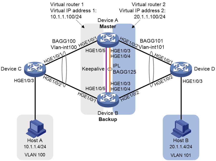

Example: Configuring Layer 3 gateways on an M-LAG system
As shown in Figure 13:
·     To provide node redundancy for service continuity, configure Device A and Device B as an M-LAG system to establish one multichassis aggregate link with Device C and one with Device D.
·     Set up a keepalive link between HundredGigE 1/0/5 of Device A and HundredGigE 1/0/5 of Device B, and exclude the interfaces from the shutdown action by M-LAG MAD.
·     Configure two VRRP groups on Device A and Device B to provide gateway services for VLAN 100 and VLAN 200. Configure Device A as the master of the VRRP groups.
Figure 13 Network diagram

[DeviceB-vlan-interface100] quit
[DeviceB] interface vlan-interface 101
[DeviceB-vlan-interface101] ip address 20.1.1.2 24
[DeviceB-vlan-interface101] quit
# Configure OSPF.
[DeviceB] ospf
[DeviceB-ospf-1] import-route direct
[DeviceB-ospf-1] area 0
[DeviceB-ospf-1-area-0.0.0.0] network 10.1.1.0 0.0.0.255
[DeviceB-ospf-1-area-0.0.0.0] network 20.1.1.0 0.0.0.255
[DeviceB-ospf-1-area-0.0.0.0] quit
[DeviceB-ospf-1] quit
# Create VRRP group 1 on VLAN-interface 100 and set its virtual IP address to 10.1.1.100.
[DeviceB] interface vlan-interface 100
[DeviceB-Vlan-interface100] vrrp vrid 1 virtual-ip 10.1.1.100
[DeviceB-Vlan-interface100] quit
# Create VRRP group 2 on VLAN-interface 101 and set its virtual IP address to 20.1.1.100.
[DeviceB-Vlan-interface101] vrrp vrid 2 virtual-ip 20.1.1.100
[DeviceB-Vlan-interface101] quit
3.     Configure Device C:
# Create Layer 2 dynamic aggregate interface Bridge-Aggregation 100.
<DeviceC> system-view
[DeviceC] interface bridge-aggregation 100
[DeviceC-Bridge-Aggregation100] link-aggregation mode dynamic
[DeviceC-Bridge-Aggregation100] quit
# Assign HundredGigE 1/0/1 and HundredGigE 1/0/2 to aggregation group 100.
[DeviceC] interface range hundredgige 1/0/1 to hundredgige 1/0/2
[DeviceC-if-range] port link-aggregation group 100
[DeviceC-if-range] quit
# Create VLAN 100.
[DeviceC] vlan 100
[DeviceC-vlan100] quit
# Set the link type of Bridge-Aggregation 100 to trunk, and assign it to VLAN 100.
[DeviceC-Bridge-Aggregation100] port link-type trunk
[DeviceC-Bridge-Aggregation100] port trunk permit vlan 100
# Set the link type of HundredGigE 1/0/3 to trunk, and assign it to VLAN 100.
[DeviceC] interface hundredgige 1/0/3
[DeviceC-HundredGigE1/0/3] port link-type trunk
[DeviceC-HundredGigE1/0/3] port trunk permit vlan 100
[DeviceC-HundredGigE1/0/3] quit
# Create VLAN-interface 100, and assign it an IP address.
[DeviceC] interface vlan-interface 100
[DeviceC-vlan-interface100] ip address 10.1.1.3 24
[DeviceC-vlan-interface100] quit
# Configure OSPF.
[DeviceC] ospf
[DeviceC-ospf-1] import-route direct
[DeviceC-ospf-1] area 0
[DeviceC-ospf-1-area-0.0.0.0] network 10.1.1.0 0.0.0.255
[DeviceC-ospf-1-area-0.0.0.0] quit
[DeviceC-ospf-1] quit
4.     Configure Device D:
# Create Layer 2 dynamic aggregate interface Bridge-Aggregation 101.
<DeviceD> system-view
[DeviceD] interface bridge-aggregation 101
[DeviceD-Bridge-Aggregation101] link-aggregation mode dynamic
[DeviceD-Bridge-Aggregation101] quit
# Assign HundredGigE 1/0/1 and HundredGigE 1/0/2 to aggregation group 101.
[DeviceD] interface range hundredgige 1/0/1 to hundredgige 1/0/2
[DeviceD-if-range] port link-aggregation group 101
[DeviceD-if-range] quit
# Create VLAN 101.
[DeviceD] vlan 101
[DeviceD-vlan101] quit
# Set the link type of Bridge-Aggregation 101 to trunk, and assign it to VLAN 101.
[DeviceD-Bridge-Aggregation101] port link-type trunk
[DeviceD-Bridge-Aggregation101] port trunk permit vlan 101
# Set the link type of HundredGigE 1/0/3 to trunk, and assign it to VLAN 101.
[DeviceD] interface hundredgige 1/0/3
[DeviceD-HundredGigE1/0/3] port link-type trunk
[DeviceD-HundredGigE1/0/3] port trunk permit vlan 101
[DeviceD-HundredGigE1/0/3] quit
# Create VLAN-interface 101, and assign it an IP address.
[DeviceD] interface vlan-interface 101
[DeviceD-vlan-interface101] ip address 20.1.1.3 24
[DeviceD-vlan-interface101] quit
# Configure OSPF.
[DeviceD] ospf
[DeviceD-ospf-1] import-route direct
[DeviceD-ospf-1] area 0
[DeviceD-ospf-1-area-0.0.0.0] network 20.1.1.0 0.0.0.255
[DeviceD-ospf-1-area-0.0.0.0] quit
[DeviceD-ospf-1] quit
# Verify that Device C has established OSPF neighbor relationships with Device A and Device B.
[DeviceC] display ospf peer
         OSPF Process 1 with Router ID 10.1.1.3
               Neighbor Brief Information
 Area: 0.0.0.0
 Router ID       Address         Pri Dead-Time  State             Interface
 20.1.1.1        10.1.1.1        1   37         Full/DR           Vlan100
 20.1.1.2        10.1.1.2        1   32         Full/BDR          Vlan100
# Verify that Device D has established OSPF neighbor relationships with Device A and Device B.
[DeviceD] display ospf peer
         OSPF Process 1 with Router ID 20.1.1.3
 Area: 0.0.0.0
 20.1.1.1        20.1.1.1        1   38         Full/DR           Vlan101
 20.1.1.2        20.1.1.2        1   37         Full/BDR          Vlan101
# Verify that Host A and Host B can ping each other. (Details not shown.)
