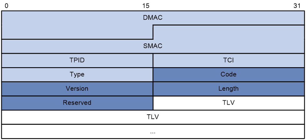

Figure 1 Ethernet frame header for loop detection
The Ethernet frame header of a loop detection packet contains the following fields:
· DMAC—Destination MAC address of the frame, which is the multicast MAC address 010f-e200-0007. When a loop detection-enabled device receives a frame with this destination MAC address, it performs the following operations:
¡ Sends the frame to the CPU.
¡ Floods the frame in the VLAN from which the frame was originally received.
· SMAC—Source MAC address of the frame, which is the bridge MAC address of the sending device.
· TPID—Type of the VLAN tag, with the value of 0x8100.
· TCI—Information of the VLAN tag, including the priority and VLAN ID.
· Type—Protocol type, with the value of 0x8918.
Figure 2 Inner frame header for loop detection
The inner frame header of a loop detection packet contains the following fields:
· Code—Protocol sub-type, which is 0x0001, indicating the loop detection protocol.
· Version—Protocol version, which is always 0x0000.
· Length—Length of the frame. The value includes the inner header, but excludes the Ethernet header.
· Reserved—This field is reserved.
Frames for loop detection are encapsulated as TLV triplets.

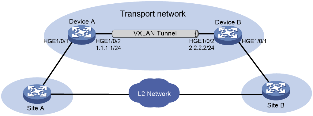

Example: Configuring loop detection on an M-LAG system
As shown in Figure 4, configure loop detection on the M-LAG system formed by Device A and Device B to meet the following requirements:
· Generates a log as a notification.
· Automatically shuts down the interface on which a loop is detected.

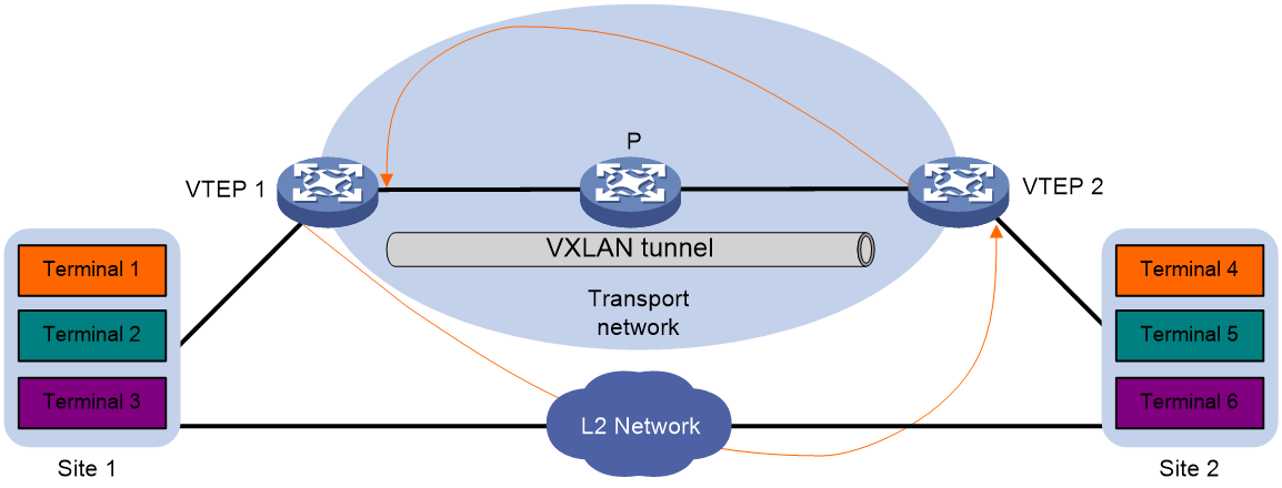

Configuring loop detection in a VXLAN network
About loop detection in a VXLAN network
Loop detection periodically checks for Layer 2 loops in a VXLAN network. The mechanism immediately generates a log when a loop occurs so that you are promptly notified to adjust network connections and configurations. You can configure loop detection to block a looped attachment circuit (AC). Logs are maintained in the information center. For more information, see Network Management and Monitoring Configuration Guide.
Application scenario
As shown in Figure 5, two VTEPs provide data transmission services for site 1 and site 2. Because the sites also have Layer 2 connectivity, broadcast storms can spread across the sites.
To remove loops from the VXLAN network, configure loop detection on the VTEPs. When a VTEP detects a loop on an AC, it blocks the AC to remove the loop.
Figure 5 Loop detection in a VXLAN network
Loop detection frame format
As shown in Figure 6, a loop detection frame contains the Ethernet header, loop detection header, and loop detection TLVs.
Figure 6 Loop detection frame format
The Ethernet frame header of a loop detection frame contains the following fields:
¡ Floods the frame in the VLAN from which the frame was received.
· TPID—Type of the VLAN tag, with the default value of 0x8100.
· TCI—Tag control information, including the priority and VLAN ID.
The loop detection header of a loop detection frame contains the following fields:
· Code—Protocol sub-type, which is 0x0001, indicating the loop detection type.
· Version—Protocol version, which is reserved. This field is fixed at 0x0000.
· Length—Length of the frame. The value includes the loop detection header, but excludes the Ethernet header.
Payload of a loop detection frame is encapsulated as TLV triplets.

3. If the bridge MAC addresses are the same, the system determines that the loop detection frame is sent by another AC on it. Then, the system perform the following comparisons to determine their priority:
¡ If M-LAG is not configured, compares the link IDs. The smaller link ID has higher priority.
¡ If M-LAG is configured, compares the M-LAG group IDs or link IDs.
- If the receiving AC and the frame both have an M-LAG group ID, the one with the larger ID has higher priority. This comparison occurs if the loop detection frame is sent and received by ACs that are on M-LAG interfaces.
- If the receiving AC has an M-LAG group ID but the frame does not contain one, the receiving AC has higher priority. If the frame contains an M-LAG group ID, but the receiving AC does not have one, the frame has higher priority. This comparison occurs if the loop detection frame is sent or received by an AC on a non-M-LAG interface.
- If both of them do not have M-LAG group IDs, compares the link IDs. The smaller link ID has higher priority. This comparison occurs if the loop detection frame is sent and received by ACs that are on non-M-LAG interfaces.
Loop detection mechanisms
After you enable loop detection on a VSI, its ACs keep sending loop detection frames and detecting incoming loop detection frames at the same time. If an AC receives a loop detection frame that carries a VXLAN ID the same as the AC's VXLAN ID, the device determines that a loop exists in the VXLAN. Then, the AC compares its own loop detection priority with that in the frame. If the loop detection priority in the frame is higher, the loop protection action is triggered. If the loop detection priority of the AC is higher, the system only records the loop information.
The ACs of a loop detection-enabled VSI send loop detection frames to detect loops in the attached sites. If the device receives a loop detection frame on a VXLAN tunnel interface and the VXLAN ID in the frame matches the local one, it determines that a loop exists on the traffic outgoing AC.
Loop detection is a continuous process as the network changes. Loop detection frames are sent at the loop detection interval to determine whether loops occur on ACs and whether loops are removed.
AC status auto recovery
When the device configured with the block action detects a loop on an AC, it generates a log, disables MAC address learning on the AC, and blocks the AC. If the device does not receive a loop detection frame on the blocked AC within three loop detection intervals, it performs the following actions:
· Automatically sets the AC to the forwarding state.
· Notifies the user of the event.

Example: Configuring local site loop detection
As shown in Figure 7, Device A and Device B provide user traffic transmission service for site 1 and site 2, and the sites have Layer 2 connectivity in VLAN 10. Configure loop detection on Device A and Device B so that they can block ACs if loops exist.
Configure a routing protocol in the VXLAN for the VTEPs to reach one another.
1. Configure Device A:
# Create VXLAN 1 and assign it a VXLAN tunnel. Map VSI vsi 1 to VXLAN 1.
<DeviceA> system-view
[DeviceA] l2vpn enable
[DeviceA] interface tunnel 0 mode vxlan
[DeviceA-Tunnel0] source 1.1.1.1
[DeviceA-Tunnel0] destination 2.2.2.2
[DeviceA-Tunnel0] quit
[DeviceA] vsi 1
[DeviceA-vsi-1] vxlan 1
[DeviceA-vsi-1-vxlan-1] tunnel 0
[DeviceA-vsi-1-vxlan-1] quit
# Disable spanning tree globally.
[DeviceA] undo stp global enable
# Configure an AC and map it to VSI vsi 1.
[DeviceA] interface hundredgige 1/0/1
[DeviceA-HundredGigE1/0/1] service-instance 1
[DeviceA-HundredGigE1/0/1-srv1] encapsulation s-vid 10
[DeviceA-HundredGigE1/0/1-srv1] xconnect vsi 1
[DeviceA-HundredGigE1/0/1-srv1] quit
#Set the link type of HundredGigE 1/0/1 to trunk, and assign it to VLAN 10.
[DeviceA-HundredGigE1/0/1] port link-type trunk
[DeviceA-HundredGigE1/0/1] port trunk permit vlan 10
[DeviceA-HundredGigE1/0/1] quit
# Enable loop detection on VSI vsi 1.
[DeviceA] vsi 1
[DeviceA-vsi-1] loopback-detection enable
# Set the loop protection action to block on VSI vsi 1.
[DeviceA-vsi-1] loopback-detection action block
# Set the loop detection interval to 35 seconds on VSI vsi 1.
[DeviceA-vsi-1] loopback-detection interval-time 35
# Set the loop detection priority to 1 on VSI vsi 1.
[DeviceA-vsi-1] loopback-detection priority 1
2. Configure Device B:
<DeviceB> system-view
[DeviceB] l2vpn enable
[DeviceB] interface Tunnel 0 mode vxlan
[DeviceB-Tunnel0] source 2.2.2.2
[DeviceB-Tunnel0] destination 1.1.1.1
[DeviceB-Tunnel0] quit
[DeviceB] vsi 1
[DeviceB-vsi-1] vxlan 1
[DeviceB-vsi-1-vxlan-1] tunnel 0
[DeviceB-vsi-1-vxlan-1] quit
[DeviceB] undo stp global enable
[DeviceB] interface hundredgige 1/0/1
[DeviceB-HundredGigE1/0/1] service-instance 1
[DeviceB-HundredGigE1/0/1-srv1] encapsulation s-vid 10
[DeviceB-HundredGigE1/0/1-srv1] xconnect vsi 1
[DeviceB-HundredGigE1/0/1-srv1] quit
[DeviceB-HundredGigE1/0/1] port link-type trunk
[DeviceB-HundredGigE1/0/1] port trunk permit vlan 10
[DeviceB-HundredGigE1/0/1] quit
[DeviceB] vsi 1
[DeviceB-vsi-1] loopback-detection enable
[DeviceB-vsi-1] loopback-detection action block
[DeviceB-vsi-1] loopback-detection interval-time 35
# Set the loop detection priority to 6 on VSI vsi 1.
[DeviceB-vsi-1] loopback-detection priority 6
# Verify that Device A has detected a loop.
[DeviceA]
%Mar 25 10:59:59:690 2019 Device A LPDT/4/LPDT_VSI_LOOPED: A loop was detected on VSI 1's Ethernet service instance srv1 on HundredGigE1/0/1.
# Verify that Device A has detected a loop on the AC on HundredGigE 1/0/1 but does not block the AC because it has high priority.
[DeviceA] display loopback-detection
Loop detection is enabled.
Global loop detection interval is 30 second(s).
Loop is detected on following interfaces:
* indicates the loop protection action was not triggered.
# indicates the loop protection action failed.
Interface Action mode VLANs/VSI
HundredGigE1/0/1 srv1 Block* 1
# Verify that Device B has blocked the AC on HundredGigE 1/0/1 to remove the loop.
[DeviceB] display loopback-detection
HundredGigE1/0/1 srv1 Block 1
