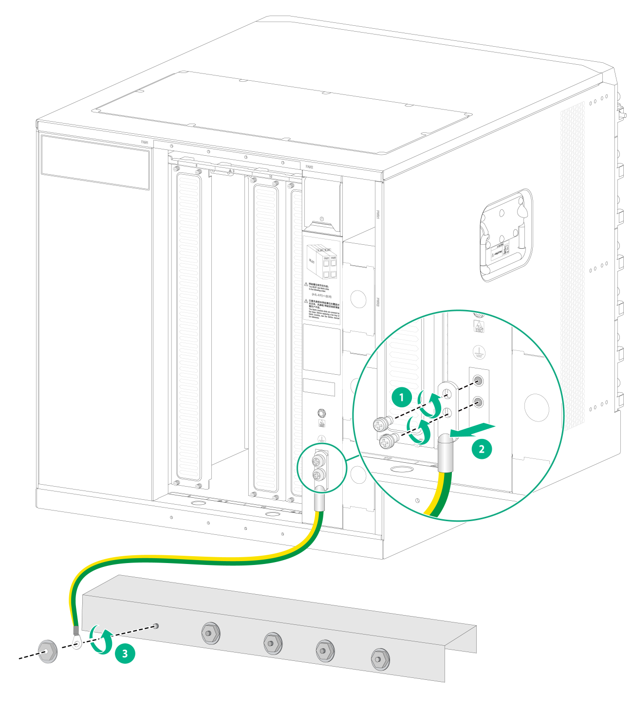

Removing the grounding cable
1. Loosen the two screws at the grounding holes
(located at the lower right of the rear panel and marked with the
grounding sign) of the chassis, as shown by callouts 1 and 2 in Figure10-1, and
then remove the grounding cable from the chassis.
2. Use a wrench to loosen the hex nut on the grounding post of the grounding strip, and remove the other end of the grounding cable (with a ring terminal) from the grounding post, as shown by callout 3 in Figure10-1.
Figure10-1 Removing the grounding cable (S10506X-G)

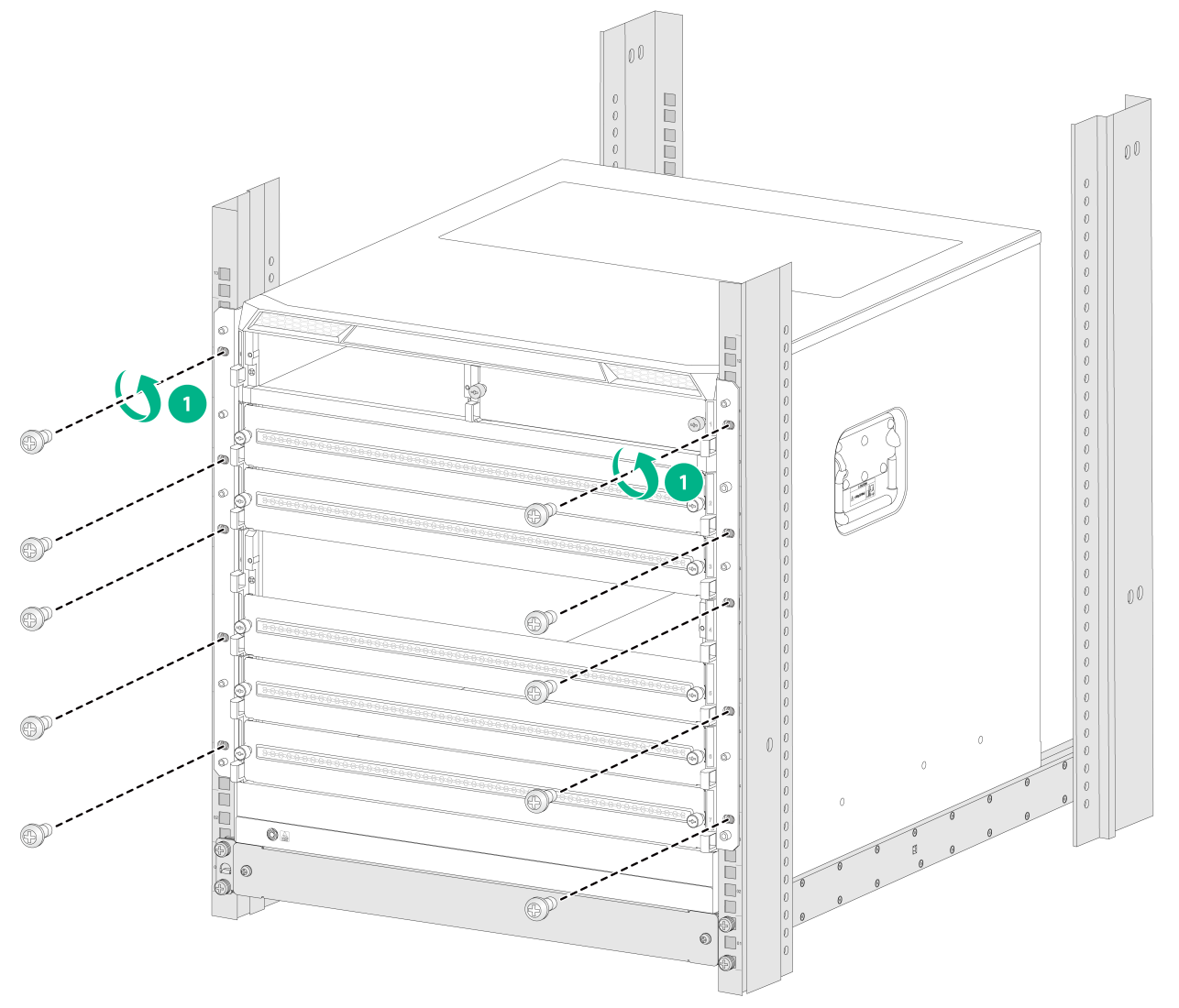

3. As shown by callout 1 in Figure10-2, use a Phillips screwdriver to loosen the screws that attach the mounting brackets to the rack.

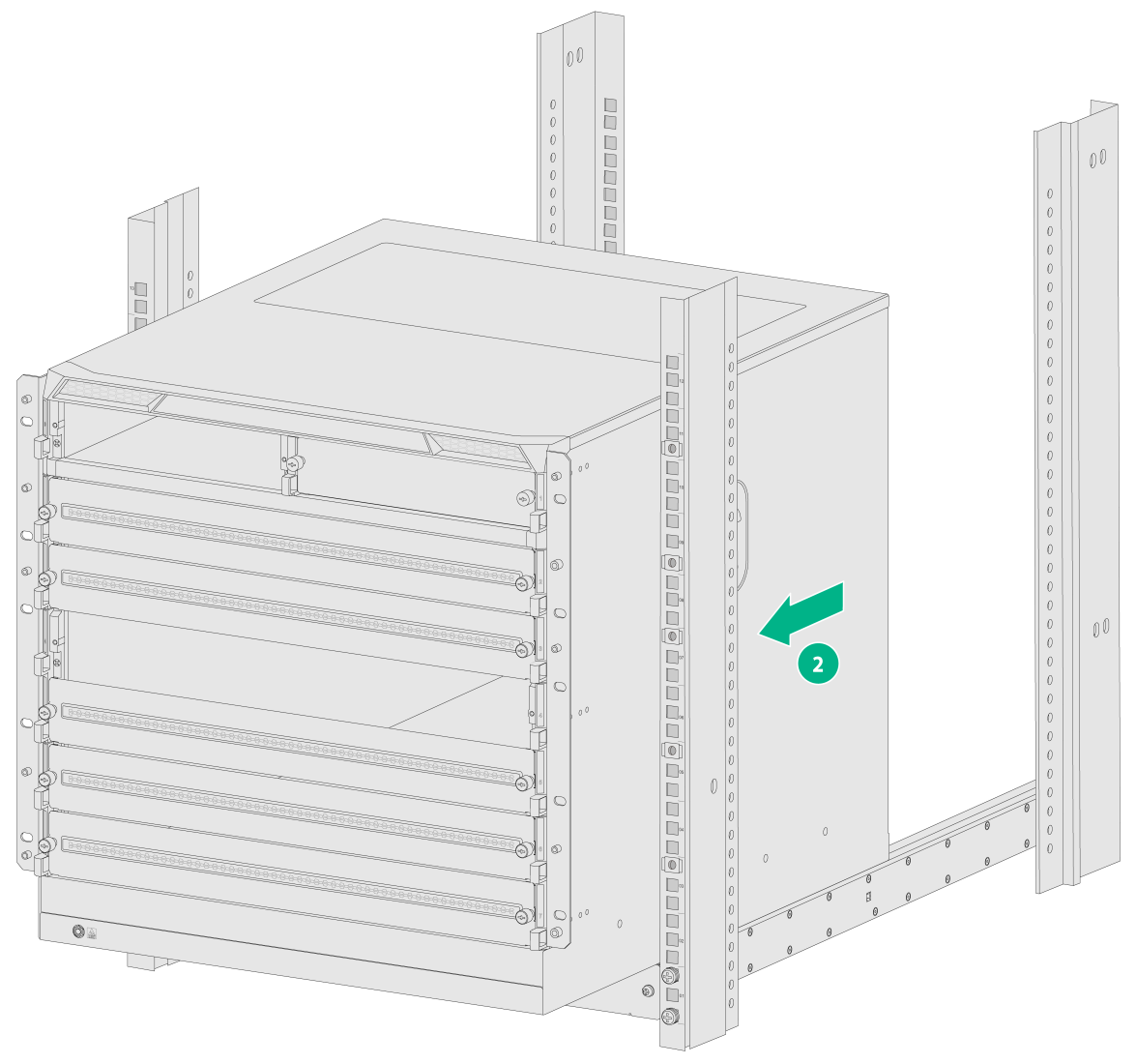

4. As shown by callout 2 in Figure10-2, cooperate with a minimum of two people to slide the chassis outwards along the slide rails. When most part of the chassis is removed from the slide rails, lift up the chassis by holding the handles at the chassis sides to completely remove the chassis from the rack.

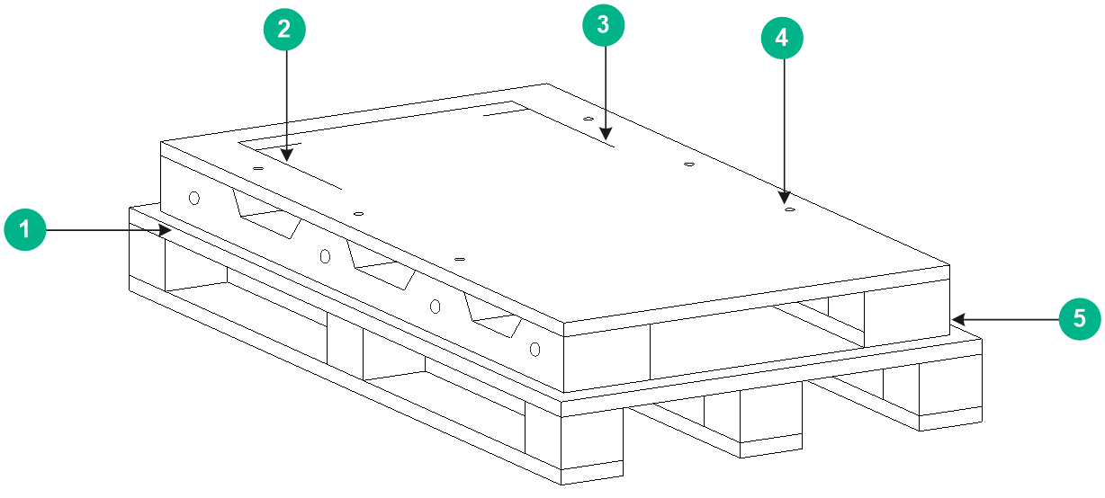

1. Align the left and right edges of the chassis bottom with the left and right positioning lines respectively on the wooden pallet base. See Figure10-4 for the wooden pallet base.
Figure10-4 Wooden pallet base (S10506X-G)
(1) Wooden pallet base |
(2) Left positioning line |
(3) Right positioning line |
(4) Screw hole |
(5) Front of the base (same direction as the front panel of the chassis) |

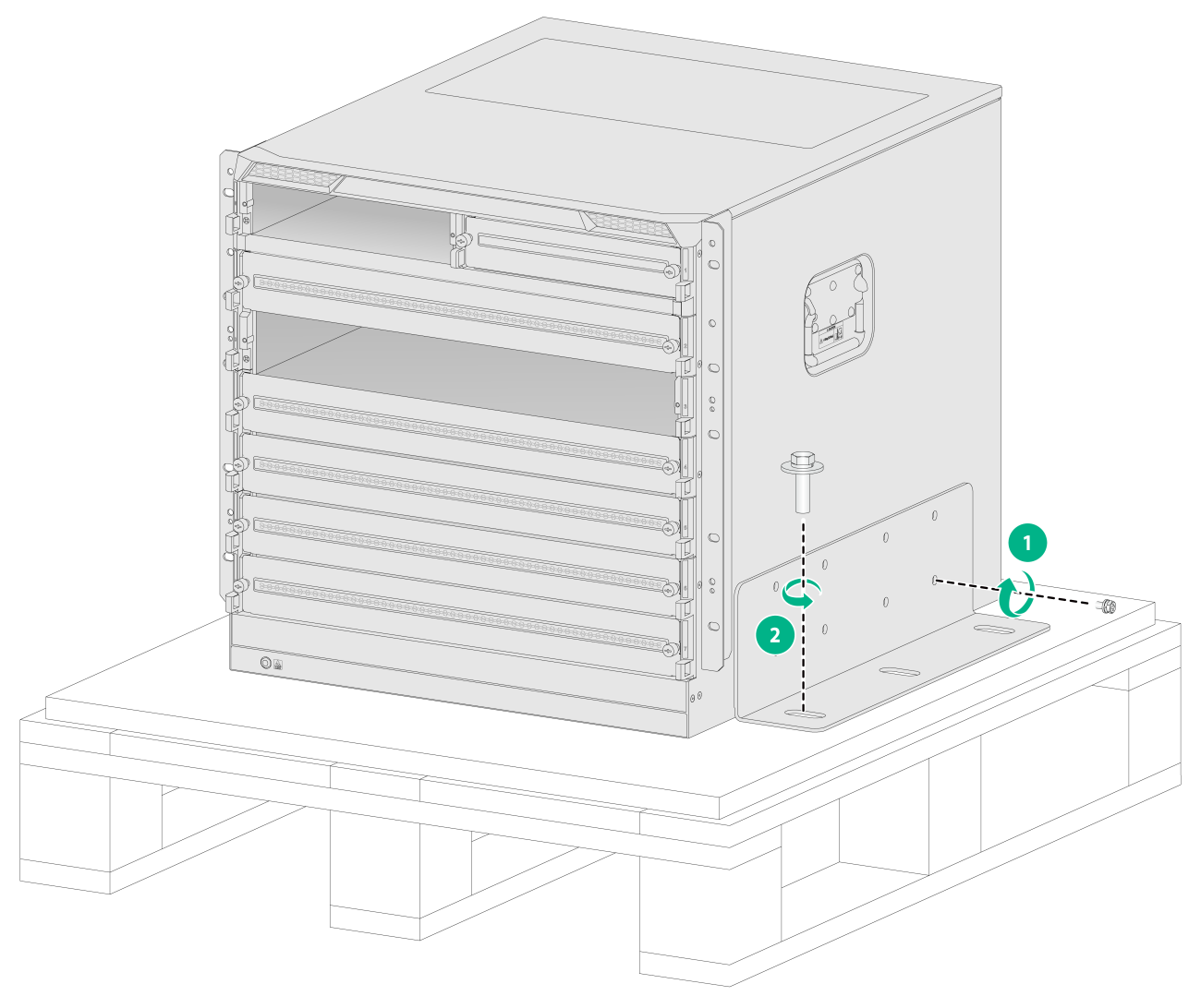

2. Use screws to attach L-type brackets to the chassis, as shown by callout 1 in Figure10-5.
3. Move the chassis so that the mounting holes in the pallet ear of the L-type brackets align with the mounting holes in the pallet base. Use screws to attach the L-type brackets to the wooden pallet base, as shown by callout 2 in Figure10-5.

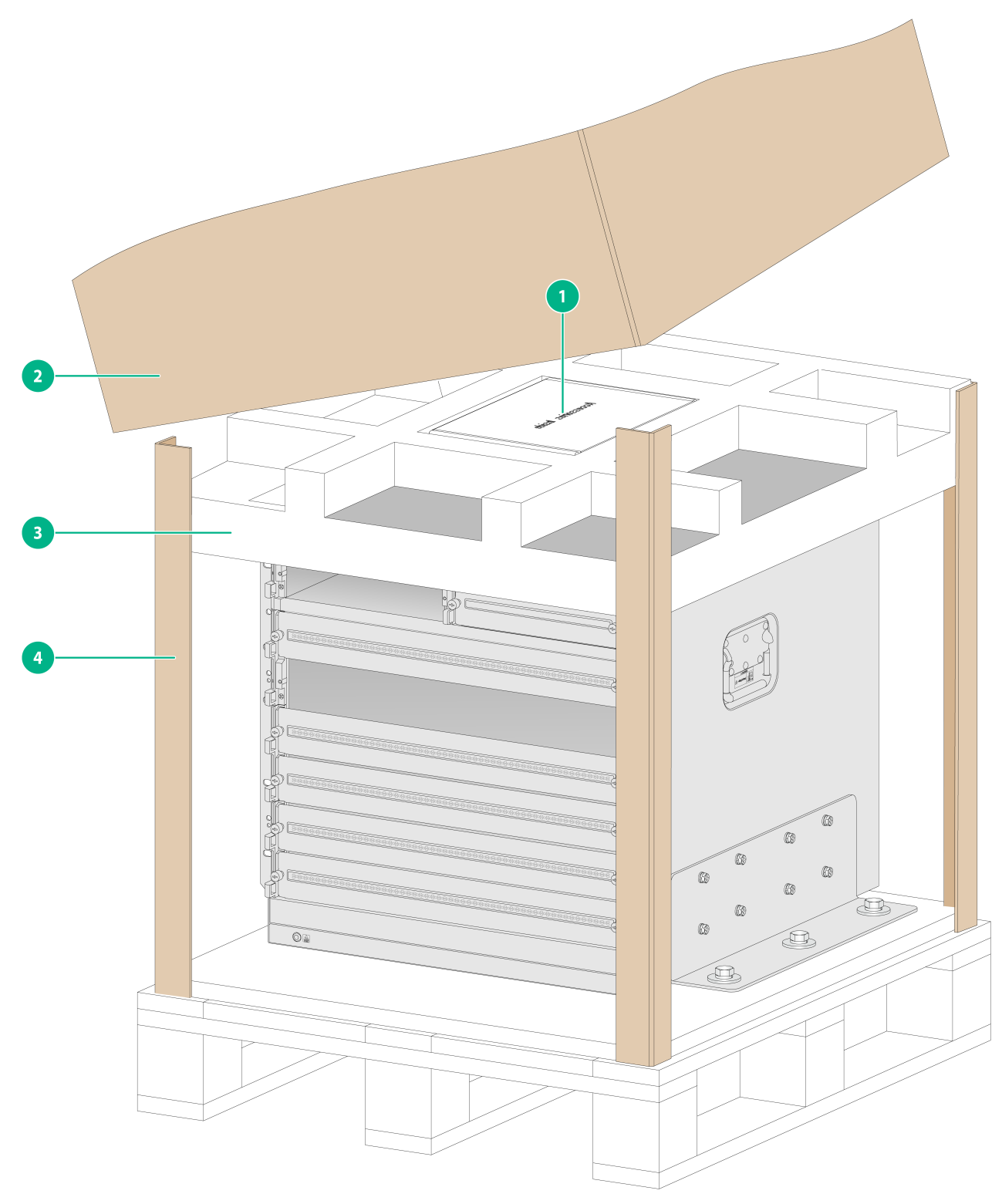

5. Place the foam cushion onto the chassis top, and make sure the mounting brackets seat into the internal notches of the foam cushion. See callout 3 in Figure10-6.
6. Fit the accessory box into the rear notch of the foam cushion, as shown by callout 1 in Figure10-6.
7. Erect one paper corner protector along each vertical edge of the chassis, and use the carton to cover the chassis from top down with the mark side aligning with the front panel of the chassis
8. Close the top cap of the carton.

(1) Accessory box position |
(2) Carton |
(2) Seat the mounting brackets into the internal notches of the foam cushion |
(4) Paper corner protector |
