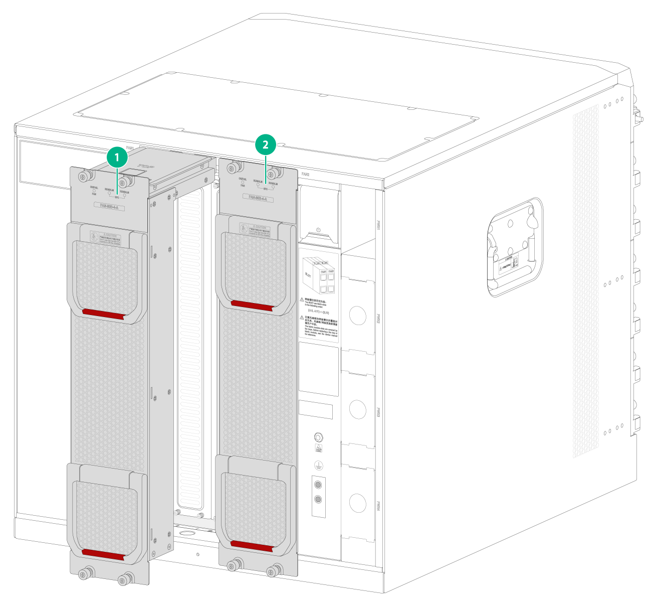

Switch fabric module failure
Symptom
The LEDs for a switch fabric module are in the following states:
·     On the MPU, the switch fabric module status LED is steady red or off.
·     On the fan tray, the RUN/ALM LED for the switch fabric module is red or off.
The RUN/ALM LEDs on the fan tray correspond to the switch fabric module slots from left to right.
Figure6-1 Corresponding relations between the LEDs on the fan trays and switch fabric module slots (S10506X-G)
(1) LEDs for the switch fabric module slots 8 and 9
(2) LEDs for the switch fabric module slots 10 and 11
·     On the switch fabric module, the RUN/ALM LED is red or off.
Solution
To resolve the issue:
1.     Verify that the MPU and the fan tray are operating correctly. For more information, see "MPU failure" and "Fan tray failure."
2.     Verify that the switch fabric module is compatible with the system software. Upgrade the system software if it does not support the switch fabric module.
3.     Calculate the total power consumption, and make sure your power supplies can provide enough power. For more information, see H3C S10500X-G Switch Series Hardware Information and Specifications.
4.     Remove and reinstall the switch fabric module to make sure the module is installed securely. You also need to verify that the ejector levers are locked securely in place. For more information, see "Installing switch fabric modules."
5.     If the switch has empty switch fabric module slots, install the module in an empty switch fabric module slot. If the module operates correctly, the previous slot is faulty.
6.     If the issue persists, contract H3C Support.
