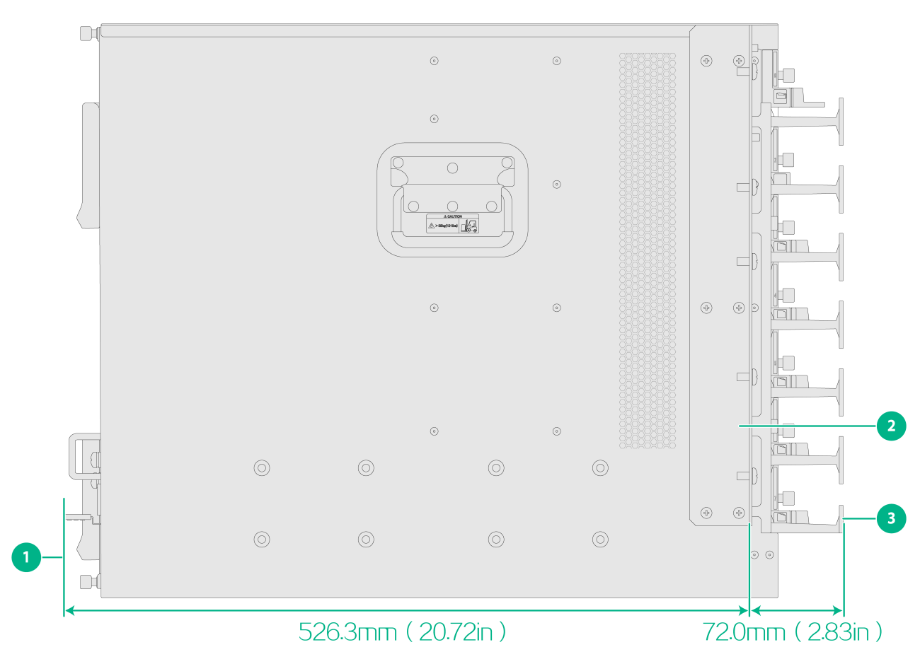

Switch dimensions and rack requirements
Figure3-1 S10506X-G switch dimensions
(1) Power supply latch |
(2) Mounting bracket |
(3) Cable management bracket |
To mount the switch in an enclosed rack, make sure the rack meets the requirements described in Table3-1.
Table3-1 Switch dimensions and rack requirements
Model |
Chassis depth |
Rack requirements |
S10506X-G |
Total depth of 598.3 mm (23.56 in) · 72.0 mm (2.83 in) from the rack-facing surface of the mounting brackets to the front ends of the cable management brackets · 526.3 mm (20.72 in) from the rack-facing surface of the mounting brackets to the power supply latch |
· A minimum of 0.8 m (2.62 ft) in depth (recommended) · A minimum of 130.0 mm (5.12 in) between the front rack post and the front door · A minimum of 558.0 mm (21.97 in) between the front rack post and the rear door |
S10508X-G |
Total depth of 758.7 mm (29.87 in) · 111.9 mm (4.41 in) from the rack-facing surface of the mounting brackets to the front ends of the cable management brackets · 646.8 mm (25.46 in) from the rack-facing surface of the mounting brackets to the power supply latch |
· A minimum of 0.8 m (2.62 ft) in depth (recommended) · A minimum of 130.0 mm (5.12 in) between the front rack post and the front door · A minimum of 678.0 mm (26.69 in) between the front rack post and the rear door |
S10512X-G |
Total depth of 718.8 mm (28.30 in) · 72.0 mm (2.83 in) from the rack-facing surface of the mounting brackets to the front ends of the cable management brackets · 646.8 mm (25.46 in) from the rack-facing surface of the mounting brackets to the power supply latch |

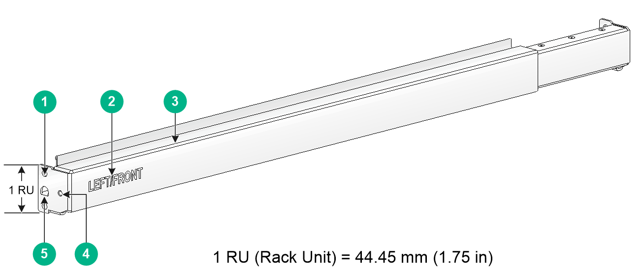

Attaching the LSXM1BSR slide rails
1. Read the signs on the slide rails to identify the right and left slide rails and their front and rear ends.
Figure3-4 Left slide rail
(1) Slide rail installation hole |
(2) Sign |
(3) Guide rail |
(4) Front plate installation hole |
(5) Locating tongue |
Table3-3 Description for signs on the slide rails
Sign |
Meaning |
Remarks |
LEFT/FRONT |
Front end of the left slide rail |
Mount this end to the front left rack post. |
RIGHT/FRONT |
Front end of the right slide rail |
Mount this end to the front right rack post. |
NOTE: · The LSXM1BSR slide rail accessories include the left slide rail, right slide rail, and front plate. · One rack unit (RU) has two standard installation holes and one auxiliary installation hole in the middle. The space between a standard installation hole and an auxiliary installation hole is wider than the space between two adjacent standard installation holes. |

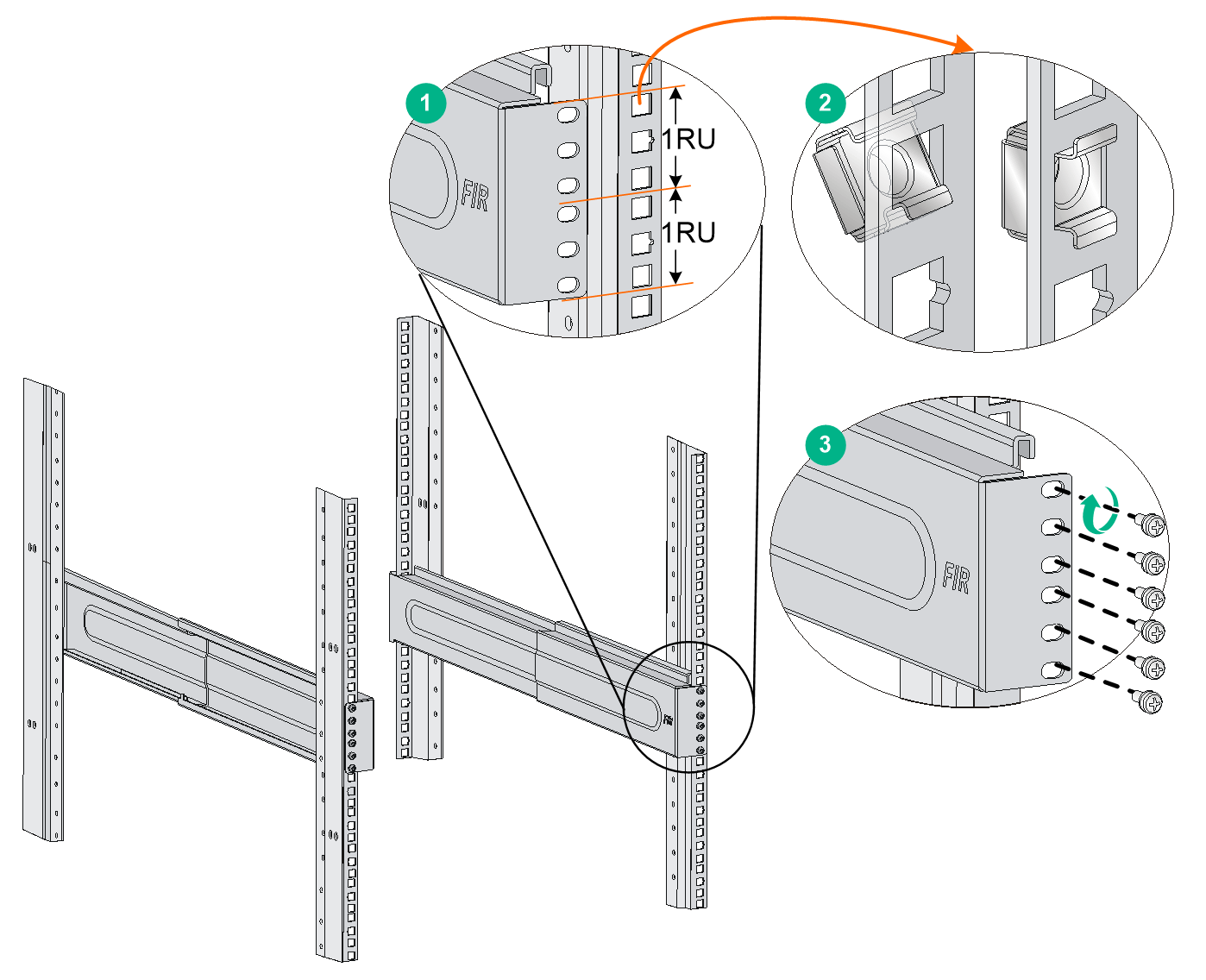

2. Mark the slide rail installation positions on the rack posts.
¡ Align the locating tongues of the slide rails with the target auxiliary holes in the rack posts, as shown by callout 1 in Figure3-6.
¡ Mark the start installation hole at the same height on each rack post.
3. Install cage nuts in the marked standard hole and the standard hole within the same RU. A total of eight cage nuts are required, with two cage nuts for each rack post.
4. Align the installation holes on the front end of the slide rail with the cage nuts on a front rack post.
5. Keep the slide rail horizontal and adjust its length until the locating tongues on the slide rail are attached to the auxiliary holes on the rack posts.
6. Use M6 screws to secure the slide rail to the front and back rack posts, as shown by callout 2 in Figure3-6.
To ensure load bearing, each installation hole of the slide rail requires a screw. A total of four M6 screws are required to secure the slide rail to the rack.
7. Repeat steps 4, 5, and 6 to install the other slide rail.

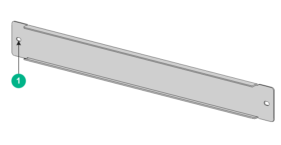

8. Attach the front plate to the rack:
a. Orient the front plate so that the front of the plate faces outward. Figure3-5 shows the rear of the plate.
Figure3-5 Rear of a front plate
(1) Installation hole |
b. Align the installation holes in the front plate with the front plate installation holes in the slide rails, and fasten the screws, as shown by callout 3 in Figure3-6.
Two M4 screws are required to secure the front plate to the rack.

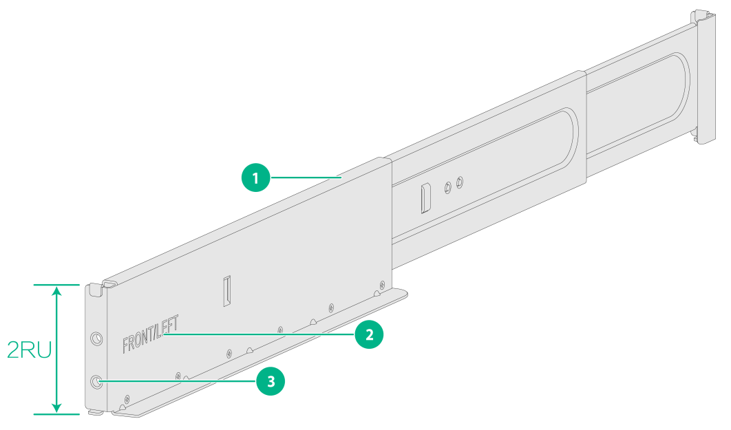

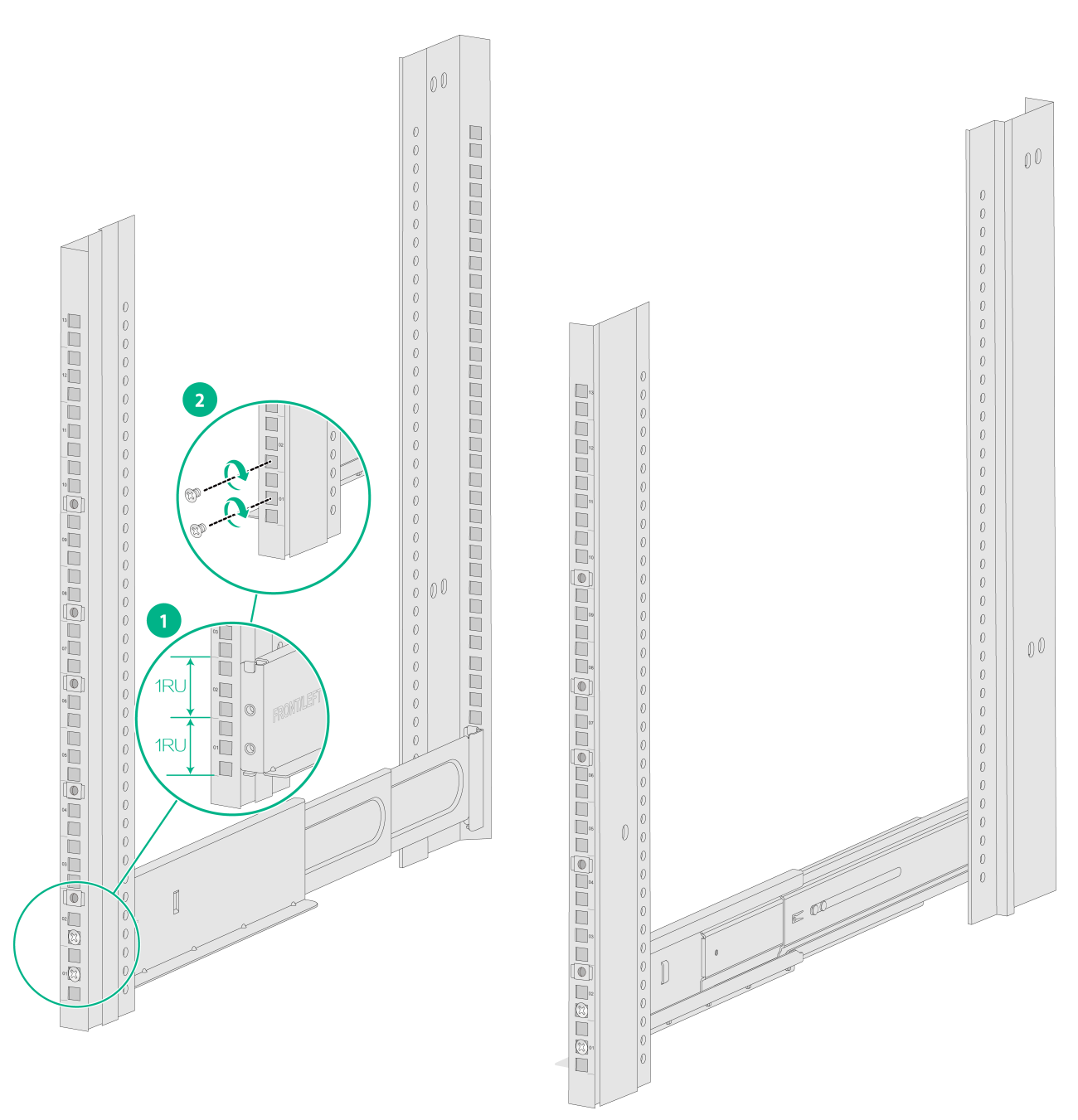

Attaching the LSTM2KSGD0 slide rails
Figure3-7 Right slide rail
(1) Guide rail |
(2) Sign |
(3) Installation hole |
Table3-4 Description for signs on the slide rails
Sign |
Meaning |
Remarks |
F/L |
F/R |

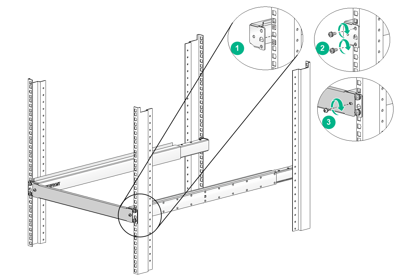

¡ Make sure the top flange of the slide rail aligns with the middle of the narrower metal area between holes on the right front rack post, as shown by callout 1 in Figure3-8.
¡ Make sure the slide rail installation positions are at the same height on the four rack posts so that the switch can be placed on the slide rails evenly.
3. Install cage nuts in the marked square holes within 2 RU at the same height on the rack posts, as shown by callout 2 in Figure3-8. Each rack post requires six cage nuts.
a. Insert the lower ear of a cage nut into the corresponding installation hole.
b. Compress the upper and lower ears of the cage nut to lead the upper ear through the hole.
4. Align the installation holes on the front end of the slide rail with the cage nuts on a front rack post, and use six M6 screws to attach the slide rail to the rack post, as shown by callout 3 in Figure3-8.
5. Keep the slide rail horizontal and adjust its length until the installation holes on the rear end of the slide rail touch the cage nuts on the rear rack post. Then use screws to attach the slide rail to the rear rack post.
Install a screw in each mounting hole of the slide rail to ensure its weight bearing capacity.
6. Repeat steps 4 and 5 to install the other slide rail.
Figure3-8 Installing the LSTM2KSGD0 slide rails

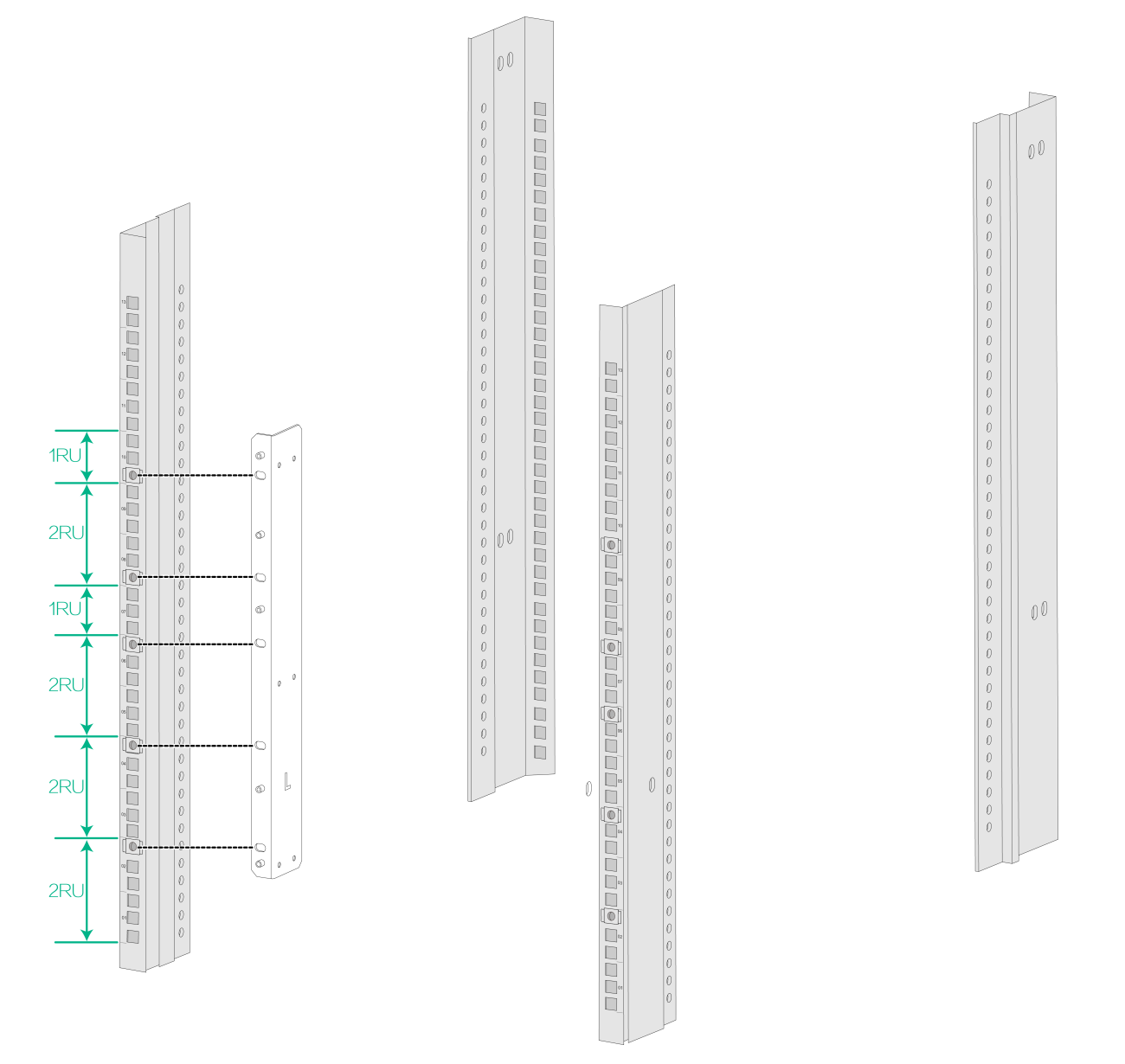

Installing cage nuts for attaching mounting brackets
1. As shown in Figure3-9, mark the cage nut installation holes for the switch.
2. Install cage nuts into the marked square holes in the front rack posts.
Figure3-9 Marking cage nut installation holes for attaching mounting brackets (S10506X-G)

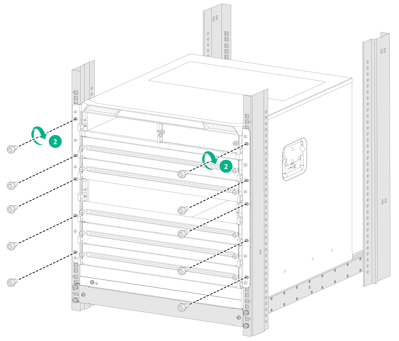

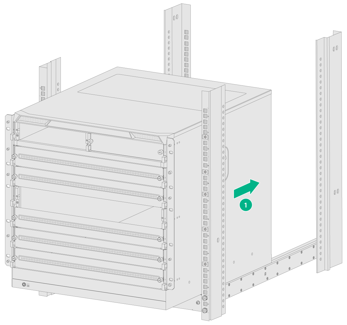

To mount the switch in a rack:
1. Orient the chassis with its rear facing towards the front of the rack.
2. Lift the chassis until the switch bottom is a little higher than the slide rails on the rack.
3. Facing the front of the rack, place the switch on the slide rails and slide the switch into the rack along the slide rails until the mounting brackets are flush against the front rack posts, as shown in Figure3-10 and Figure3-11.
After placing the switch on the slide rails, do not leave go of your hands immediately because this might tip the switch, damaging the switch or even causing bodily injury.
4. Use M6 screws provided with the switch to attach the mounting brackets to the rack posts.
If the mounting holes in the mounting brackets cannot align with the cage nuts on the rack, verify the following items:
¡ The top flange of the slide rail aligns with the middle of the narrower metal area between holes.
¡ The cage nuts are installed in the correct holes.
Figure3-10 Mounting the S10506X-G switch in the rack (1)
Figure3-11 Mounting the S10506X-G switch in the rack (2)

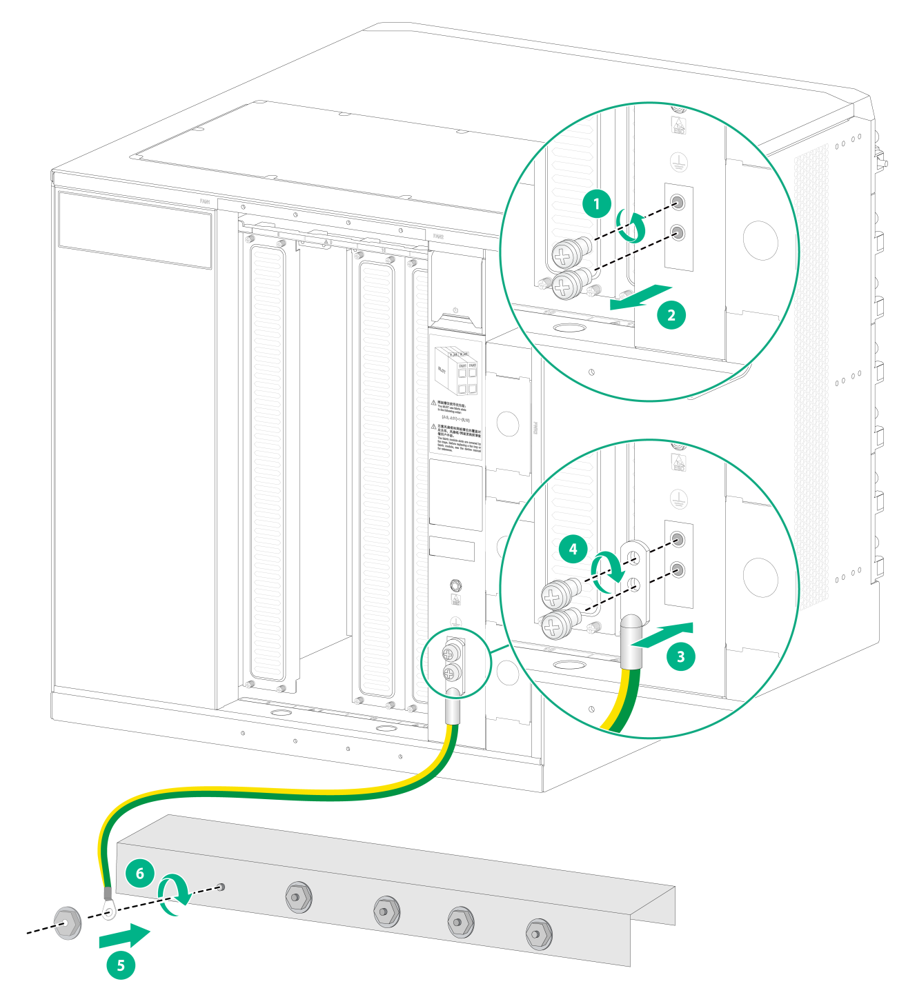

Grounding the switch
CAUTION: · Reliably grounding the switch is crucial to lightning protection and EMI protection. Ground the switch reliably before you use it. · Use the grounding cable (yellow-green grounding cable) provided with the switch. · Connect the grounding cable to the earthing system in the equipment room. Do not connect it to a fire main or lightning rod. |
You can ground the switch by connecting the grounding cable to a grounding strip in the equipment room or the grounding strip on the rack.
To connect the grounding cable to a grounding strip:
1. Unpack the grounding cable.
The grounding cable provided with the switch is compliant with the NEBS standards. The two-hole grounding lug of the grounding cable is used for connecting the chassis. The ring terminal of the grounding cable is used for connecting the grounding strip.
2. As shown by callouts 1 and 2 in Figure3-12, remove the grounding screws from the grounding holes at the rear of the chassis.
A grounding sign is provided with the grounding holes.
3. Use grounding screws to attach the two-hole grounding lug of the grounding cable to the chassis, as shown by callouts 3 and 4 in Figure3-12.
The recommended torque for the grounding screws is 30 kgf-cm (2.94 Nm).
4. As shown by callouts 5 and 6 in Figure3-12, connect the ring terminal of the grounding cable to a grounding post of the grounding strip, and fasten the grounding cable to the grounding strip with the hex nut.
Figure3-12 Connecting the grounding cable to a grounding strip (S10506X-G)
