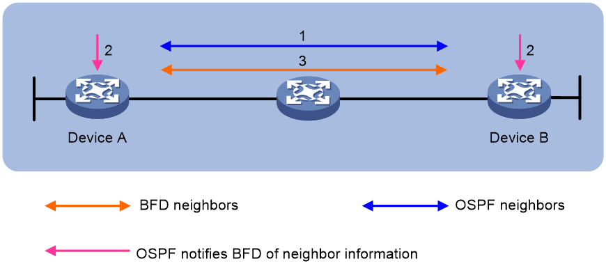

Mechanism
BFD establishes a session between two network devices to detect failures on the bidirectional forwarding paths between the devices and provide services for upper-layer protocols. BFD provides no neighbor discovery mechanism. Protocols that BFD services notify BFD of devices to which it needs to establish sessions. After a session is established, if no BFD control packet is received from the peer within the negotiated BFD interval, BFD notifies a failure to the protocol, which then takes appropriate measures.
Figure 1 describes the operation of BFD for OSPF.
1. OSPF discovers neighbors by sending Hello packets and establishes neighbor relationships.
2. After establishing neighbor relationships, OSPF notifies BFD of the neighbor information, including destination and source addresses.
3. BFD uses the information to establish BFD sessions.
Figure 1 BFD session establishment

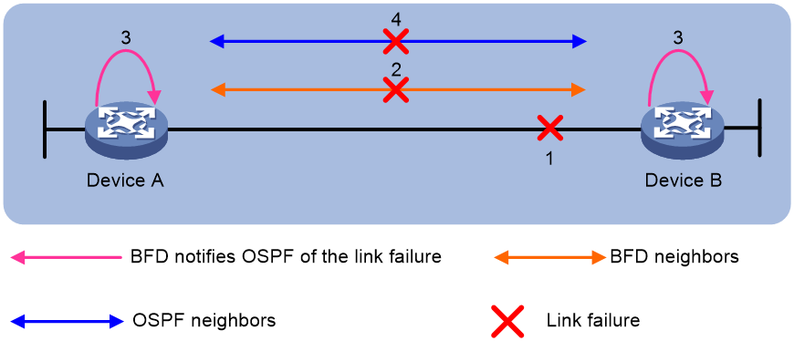

Figure 2 describes the BFD fault detection process.
1. BFD detects a link failure and tears down the session.
2. BFD notifies the neighbor unreachability to OSPF.
3. OSPF terminates the neighbor relationship on the link.

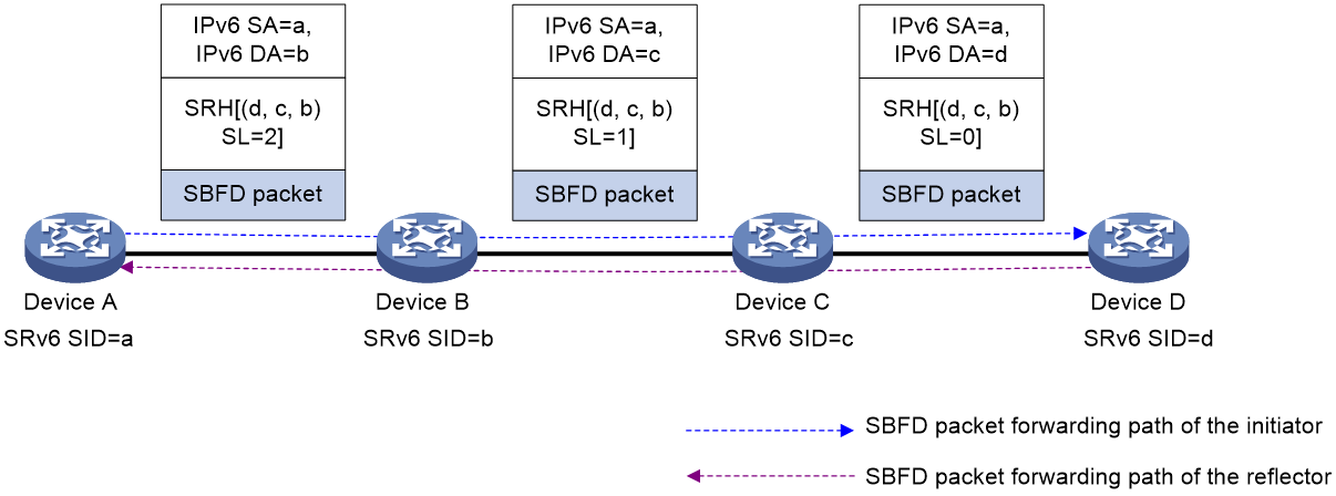

Control-packet-mode SBFD detects the connectivity of an SR-MPLS-based MPLS TE tunnel in the following process:
1. The initiator injects SBFD control packets into an SRLSP. The ingress node of the MPLS TE tunnel is used as the initiator.
2. After receiving an SBFD control packet, the reflector checks whether the remote discriminator carried in the packet is the same as the local discriminator. If they are the same, the reflector sends a response SBFD control packet to the initiator according to the IP routing table. The egress node of the MPLS TE tunnel is used as the reflector.
3. If the initiator receives the response SBFD control packet before the detection time expires, it considers the SRLSP available.
Echo-packet-mode SBFD can detect only the connectivity of a bidirectional MPLS TE tunnel in the following process:
1. The initiator injects SBFD echo packets into an SRLSP. The ingress node of the MPLS TE tunnel is used as the initiator.
2. The labeled SBFD packets arrive at the egress node of the MPLS TE tunnel. Upon receiving the packets, the egress node performs an LFIB table lookup and forwards the packets out of the specified output interface.
3. If the initiator receives the returned SBFD echo packets before the detection time expires, it considers the SRLSP available.
For more information about SRLSPs, see SR-MPLS in Segment Routing Configuration Guide.

SBFD can detect the connectivity of an SRv6 TE policy and provides millisecond-level fault detection and fast fault switchover. In an SRv6 TE policy, the candidate path with the greatest preference value acts as the primary path and that with the second greatest preference value acts as the backup path. SBFD detects both primary and backup paths and all SID lists of each path. If all the SID lists for the primary path are faulty, SBFD triggers a primary-to-back path switchover.
As shown in Figure 5, configure an SRv6 TE policy on Device A and use SBFD to detect the SRv6 TE policy. The detection process is as follows:
1. The source node (Device A, the initiator) sends SBFD control packets that encapsulate the SID lists of the primary and backup candidate paths of the SRv6 TE policy.
2. After the destination node (Device D, the reflector) receives an SBFD control packet, it checks whether the remote discriminator carried the packet is the same as the local discriminator. If they are the same, the reflector sends the response SBFD control packet to the initiator according to the IPv6 routing table. If they are different, the reflector drops the SBFD control packet.
3. If the source node receives the response SBFD control packet before the detection time expires, it considers the corresponding SID list (forwarding path) of the SRv6 TE policy available. Otherwise, the device considers the SID list faulty. If all the SID lists for the primary path are faulty, SBFD triggers a primary-to-back path switchover.
Figure 5 SRv6 TE policy association with SBFD
You can enable SBFD for all SRv6 TE policies globally in SRv6 TE view or for a specific SRv6 TE policy in SRv6 TE policy view. The policy-specific configuration takes precedence over the global configuration. An SRv6 TE policy uses the global configuration only when it has no policy-specific configuration.
When informing SBFD to establish an SBFD session, the SRv6 TE policy sends the source and destination IP addresses of the packet to SBFD. The source IP address is specified by the sbfd source-ipv6 command. To configure SRv6 TE policy detection, make sure the remote device has a route to the IPv6 address specified by the sbfd source-ipv6 command.
In the current software version, you can enable SRv6 TE policy detection through BFD echo packets or SBFD. If you configure both detection methods for the same SRv6 TE policy, SBFD takes effect.
For more information about the commands configured in SRv6 view, see SRv6 TE policy commands in Segment Routing Command Reference.
