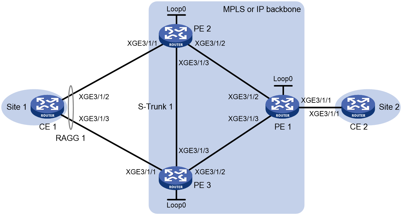

S-Trunk configuration examples
Example: Configuring S-Trunk in an MPLS L2VPN network

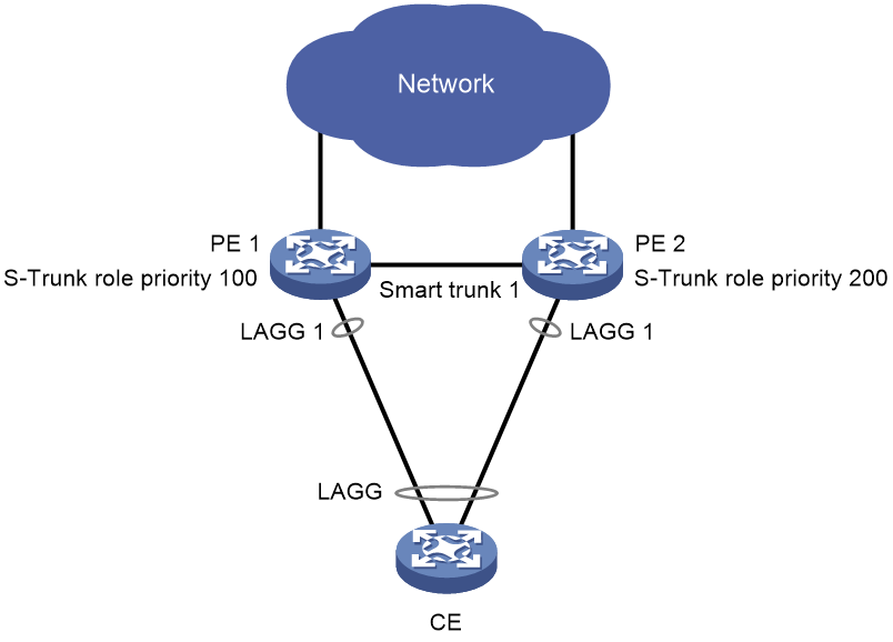

Smart Trunk (S-Trunk) is an H3C-proprietary protocol, used on two PEs that provide dual-homed access for a CE for link and node redundancy. It virtualizes two PEs into one system through a multichassis link aggregation called smart trunk.
Application scenario
S-Trunk is used in the dual-homing scenario shown in Figure 1 to ensure service continuity upon failure of one PE. S-Trunk virtualizes the PEs into an S-Trunk system. To the CE, the S-Trunk system is one device. A smart trunk is configured on the PEs to aggregate the links between the CE and PEs. When a link or PE fails, its traffic is automatically switched to the other available links or PE.
Figure 1 S-Trunk application scenario

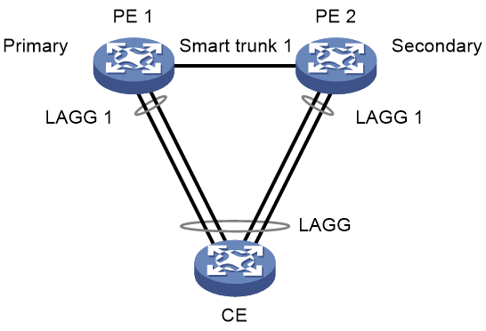

S-Trunk network model
As shown in Figure 2, each member device in the S-Trunk system is assigned the primary or secondary role based on its S-Trunk role priority. When both devices are operating correctly, only the primary S-Trunk member device forwards traffic. When the primary S-Trunk member device fails, the secondary S-Trunk member device takes over to forward all traffic.
A smart trunk contains two CE-facing aggregate interfaces as its member interfaces. S-Trunk also defines the primary and secondary roles for the member interfaces in a smart trunk. For the same smart trunk, typically the role of a smart trunk member interface is the same as the role of the S-Trunk member device that hosts that interface.
Figure 2 S-Trunk network model

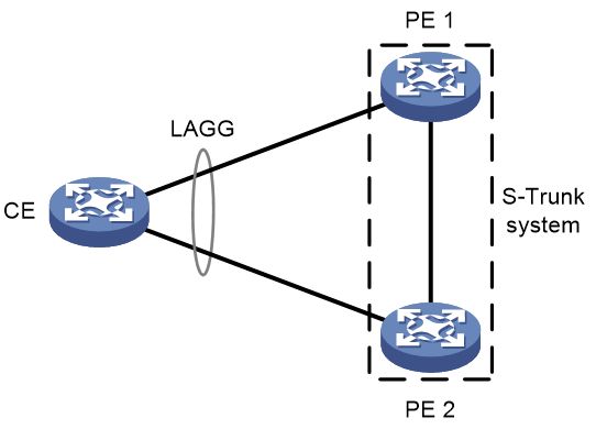

S-Trunk system setup process
As shown in Figure 3, perform the following tasks to configure a smart trunk:
1. Create a CE-facing aggregate interface and a smart trunk with the same ID on each PE, and assign the aggregate interfaces to the smart trunk.
2. Configure a link aggregation group on the CE and assign the interfaces connected to the PEs to the link aggregation group.
The PEs set up an S-Trunk system as follows:
1. PE 1 and PE 2 exchange S-Trunk protocol packets to advertise their S-Trunk configuration. The PEs form an S-Trunk system if the following requirements are met:
¡ They use the same LACP system MAC address and LACP system priority.
¡ They use different LACP system numbers.
¡ The S-Trunk protocol packets are destined for the same UDP port, and the source and destination IP addresses of incoming S-Trunk protocol packets are consistent with those configured on each PE.
¡ The IP addresses used for S-Trunk protocol packet transmission are reachable to each other.
2. The PEs determine the device roles and interface roles for the smart trunk.
¡ Determining device roles—The PEs compare their role priorities and elect the primary device through S-Trunk protocol packets. As shown in Figure 3, PE 1 is assigned the primary role, and PE 2 is assigned the secondary role.
¡ Determining interface roles—Each PE assigns the primary or secondary role to its smart trunk member interface based on its S-Trunk role and peer status. As shown in Figure 3, interface LAGG 1 on PE 1 is assigned the primary role, and interface LAGG 1 on PE 2 is assigned the secondary role.
3. The S-Trunk system forwards traffic through the primary S-Trunk member device.
Figure 3 S-Trunk system setup process

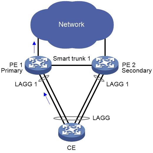

Typical traffic forwarding process
When both S-Trunk member devices are operating correctly, the smart trunk member interface on the primary member device forwards traffic. As shown in Figure 4, interface LAGG 1 on primary member device PE 1 is forwarding the traffic of CE 1. Interface LAGG 1 on PE 2 is the secondary member interface and is placed in down state.
Figure 4 Typical traffic forwarding process

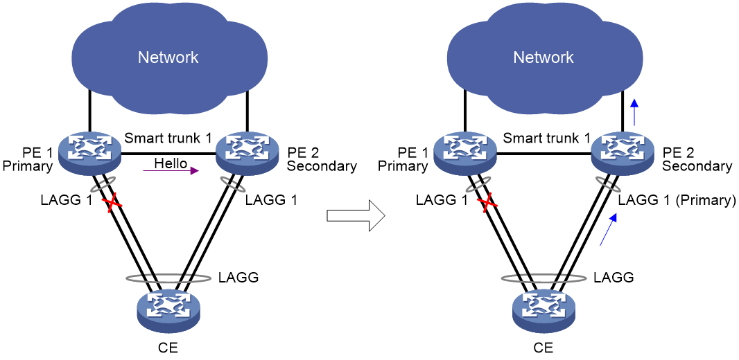

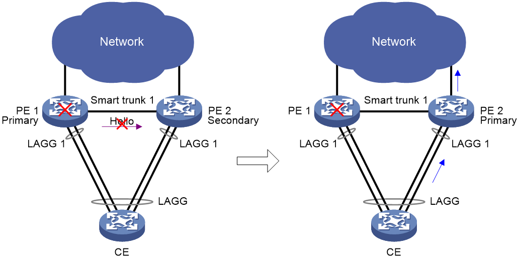

Primary member interface failure handling mechanism
When the primary member interface in a smart trunk fails, the smart trunk forwards traffic through the other member interface.
As shown in Figure 5, when the link between the CE and PE 1 fails, PE 1 notifies PE 2 of the failure of LAGG 1 through S-Trunk hello packets. After receiving the S-Trunk hello packets, PE 2 assigns the primary role to its LAGG 1 and brings the interface up to forward the traffic of the CE.
Figure 5 Primary interface failure handling mechanism

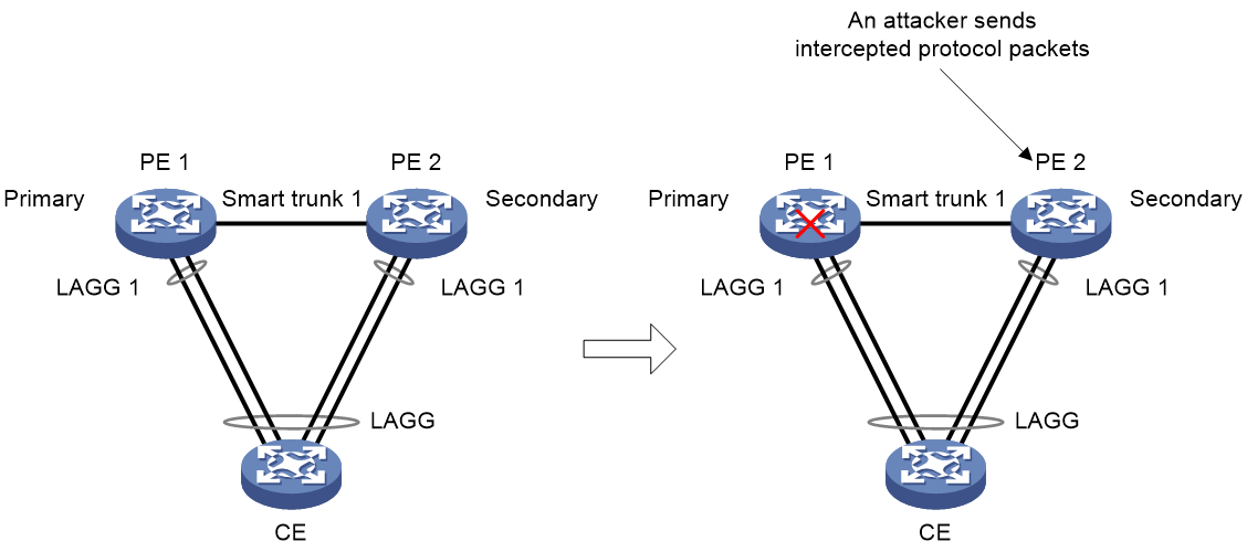

Primary member device failure handling mechanism
When the primary member device fails, the secondary member device takes over the primary role to forward all traffic.
As shown in Figure 6, if PE 1 fails, PE 2 cannot receive S-Trunk hello packets and determines that PE 1 is down upon expiration of the S-Trunk protocol packet timeout. Then, PE 2 becomes the primary member device and brings up LAGG 1 to forward the traffic of the CE.
Figure 6 Primary member device failure handling mechanism
As shown in Figure 8:
· Configure MPLS L2VPN for CE 1 and CE 2 to communicate. CE 1 is dual-homed to PE 2 and PE 3.
· Configure S-Trunk on PE 2 and PE 3 to establish a multichassis aggregate link with CE 1. Configure PE 2 and PE 3 as the primary and secondary devices, respectively.

1. Assign IP addresses to interfaces as described in Table 1. (Details not shown.)
2. Configure OSPF for Layer 3 connectivity:
# Configure PE 1.
[PE1] ospf
[PE1-ospf-1] area 0
[PE1-ospf-1-area-0.0.0.0] network 10.1.1.0 0.0.0.255
[PE1-ospf-1-area-0.0.0.0] network 10.1.2.0 0.0.0.255
[PE1-ospf-1-area-0.0.0.0] network 1.1.1.1 0.0.0.0
[PE1-ospf-1-area-0.0.0.0] quit
[PE1-ospf-1] quit
# Configure PE 2.
[PE2] ospf
[PE2-ospf-1] area 0
[PE2-ospf-1-area-0.0.0.0] network 10.1.1.0 0.0.0.255
[PE2-ospf-1-area-0.0.0.0] network 10.1.3.0 0.0.0.255
[PE2-ospf-1-area-0.0.0.0] network 2.2.2.2 0.0.0.0
[PE2-ospf-1-area-0.0.0.0] quit
[PE2-ospf-1] quit
# Configure PE 3.
[PE3] ospf
[PE3-ospf-1] area 0
[PE3-ospf-1-area-0.0.0.0] network 10.1.2.0 0.0.0.255
[PE3-ospf-1-area-0.0.0.0] network 10.1.3.0 0.0.0.255
[PE3-ospf-1-area-0.0.0.0] network 3.3.3.3 0.0.0.0
[PE3-ospf-1-area-0.0.0.0] quit
[PE3-ospf-1] quit
3. Configure MPLS LSR IDs, and enable MPLS and LDP:
# Configure PE 1.
[PE1] mpls lsr-id 1.1.1.1
[PE1] mpls ldp
[PE1-ldp] quit
[PE1] interface ten-gigabitethernet 3/1/2
[PE1-Ten-GigabitEthernet3/1/2] mpls enable
[PE1-Ten-GigabitEthernet3/1/2] mpls ldp enable
[PE1-Ten-GigabitEthernet3/1/2] quit
[PE1] interface ten-gigabitethernet 3/1/3
[PE1-Ten-GigabitEthernet3/1/3] mpls enable
[PE1-Ten-GigabitEthernet3/1/3] mpls ldp enable
[PE1-Ten-GigabitEthernet3/1/3] quit
# Configure PE 2.
[PE2] mpls lsr-id 2.2.2.2
[PE2] mpls ldp
[PE2-ldp] quit
[PE2] interface ten-gigabitethernet 3/1/2
[PE2-Ten-GigabitEthernet3/1/2] mpls enable
[PE2-Ten-GigabitEthernet3/1/2] mpls ldp enable
[PE2-Ten-GigabitEthernet3/1/2] quit
[PE2] interface ten-gigabitethernet 3/1/3
[PE2-Ten-GigabitEthernet3/1/3] mpls enable
[PE2-Ten-GigabitEthernet3/1/3] mpls ldp enable
[PE2-Ten-GigabitEthernet3/1/3] quit
# Configure PE 3.
[PE3] mpls lsr-id 3.3.3.3
[PE3] mpls ldp
[PE3-ldp] quit
[PE3] interface ten-gigabitethernet 3/1/2
[PE3-Ten-GigabitEthernet3/1/2] mpls enable
[PE3-Ten-GigabitEthernet3/1/2] mpls ldp enable
[PE3-Ten-GigabitEthernet3/1/2] quit
[PE3] interface ten-gigabitethernet 3/1/3
[PE3-Ten-GigabitEthernet3/1/3] mpls enable
[PE3-Ten-GigabitEthernet3/1/3] mpls ldp enable
[PE3-Ten-GigabitEthernet3/1/3] quit
4. Enable L2VPN:
# Configure PE 1.
[PE1] l2vpn enable
# Configure PE 2.
[PE2] l2vpn enable
# Configure PE 3.
[PE3] l2vpn enable
5. Create a cross-connect group, configure the primary and backup PWs and bind them with ACs, and configure the dual receive feature for PW redundancy:
# Configure PE 1.
[PE1] xconnect-group vpna
[PE1-xcg-vpna] connection ldp
[PE1-xcg-vpna-ldp] protection dual-receive
[PE1-xcg-vpna-ldp] ac interface ten-gigabitethernet 3/1/1
[PE1-xcg-vpna-ldp-Ten-GigabitEthernet3/1/1] quit
[PE1-xcg-vpna-ldp] peer 2.2.2.2 pw-id 11
[PE1-xcg-vpna-ldp-2.2.2.2-11] backup-peer 3.3.3.3 pw-id 22
[PE1-xcg-vpna-ldp-2.2.2.2-11-backup] quit
[PE1-xcg-vpna-ldp-2.2.2.2-11] quit
[PE1-xcg-vpna-ldp] quit
[PE1-xcg-vpna] quit
# Configure PE 2.
[PE2] xconnect-group vpna
[PE2-xcg-vpna] connection ldp
[PE2-xcg-vpna-ldp] ac interface route-aggregation 1
[PE2-xcg-vpna-ldp-Route-Aggregation1] bypass-peer 3.3.3.3 pw-id 44 ac-bypass
[PE2-xcg-vpna-ldp-Route-Aggregation1-bypass] quit
[PE2-xcg-vpna-ldp-Route-Aggregation1] quit
[PE2-xcg-vpna-ldp] peer 1.1.1.1 pw-id 11
[PE2-xcg-vpna-ldp-1.1.1.1-11] bypass-peer 3.3.3.3 pw-id 33 pw-bypass
[PE2-xcg-vpna-ldp-1.1.1.1-11-bypass] quit
[PE2-xcg-vpna-ldp-1.1.1.1-11] quit
[PE2-xcg-vpna-ldp] quit
[PE2-xcg-vpna] quit
# Configure PE 3.
[PE3] xconnect-group vpna
[PE3-xcg-vpna] connection ldp
[PE3-xcg-vpna-ldp] ac interface route-aggregation 1
[PE3-xcg-vpna-ldp-Route-Aggregation1] bypass-peer 2.2.2.2 pw-id 33 ac-bypass
[PE3-xcg-vpna-ldp-Route-Aggregation1-bypass] quit
[PE3-xcg-vpna-ldp-Route-Aggregation1] quit
[PE3-xcg-vpna-ldp] peer 1.1.1.1 pw-id 22
[PE3-xcg-vpna-ldp-1.1.1.1-22] bypass-peer 2.2.2.2 pw-id 44 pw-bypass
[PE3-xcg-vpna-ldp-1.1.1.1-22-bypass] quit
[PE3-xcg-vpna-ldp-1.1.1.1-22] quit
[PE3-xcg-vpna-ldp] quit
[PE3-xcg-vpna] quit
6. Configure Ethernet link aggregation for CE 1 to be dual-homed to PE 2 and PE 3:
<CE1> system-view
[CE1] interface route-aggregation 1
[CE1-Route-Aggregation1] link-aggregation mode dynamic
[CE1-Route-Aggregation1] quit
[CE1] interface ten-gigabitethernet 3/1/2
[CE1-Ten-GigabitEthernet3/1/2] port link-aggregation group 1
[CE1-Ten-GigabitEthernet3/1/2] quit
[CE1] interface ten-gigabitethernet 3/1/3
[CE1-Ten-GigabitEthernet3/1/3] port link-aggregation group 1
[CE1-Ten-GigabitEthernet3/1/3] quit
7. Configure LACP system settings for PE 2 and PE 3 to be identified as one device:
# Configure PE 2.
[PE2] lacp system-priority 10
[PE2] lacp system-mac 1-1-1
[PE2] lacp system-number 1
# Configure PE 3.
[PE3] lacp system-priority 10
[PE3] lacp system-mac 1-1-1
[PE3] lacp system-number 2
8. Configure S-Trunk protocol packet parameters:
# Configure PE 2.
[PE2] s-trunk udp-port 2048
[PE2] s-trunk id 1
[PE2-s-trunk1] s-trunk role priority 100
[PE2-s-trunk1] s-trunk ip destination 10.1.3.2 source 10.1.3.1
[PE2-s-trunk1] quit
# Configure PE 3.
[PE3] s-trunk udp-port 2048
[PE3] s-trunk id 1
[PE3-s-trunk1] s-trunk role priority 200
[PE3-s-trunk1] s-trunk ip destination 10.1.3.1 source 10.1.3.2
[PE3-s-trunk1] quit
9. Create a static BFD session and associate it with smart trunk 1:
# Configure PE 2.
[PE2] bfd static bfd1 peer-ip 10.1.3.2 source-ip 10.1.3.1 discriminator local 1 remote 2
[PE2-bfd-static-session-bfd1] quit
[PE2] s-trunk id 1
[PE2-s-trunk1] s-trunk bfd-session bfd1
[PE2-s-trunk1] quit
# Configure PE 3.
[PE3] bfd static bfd1 peer-ip 10.1.3.1 source-ip 10.1.3.2 discriminator local 2 remote 1
[PE3-bfd-static-session-bfd1] quit
[PE3] s-trunk id 1
[PE3-s-trunk1] s-trunk bfd-session bfd1
[PE3-s-trunk1] quit
10. Configure smart trunk 1:
# Configure PE 2.
[PE2] interface route-aggregation 1
[PE2-Route-Aggregation1] link-aggregation mode dynamic
[PE2-Route-Aggregation1] s-trunk 1
[PE2-Route-Aggregation1] quit
[PE2] interface ten-gigabitethernet 3/1/1
[PE2-Ten-GigabitEthernet3/1/1] port link-aggregation group 1
[PE2-Ten-GigabitEthernet3/1/1] quit
# Configure PE 3.
[PE3] interface route-aggregation 1
[PE3-Route-Aggregation1] link-aggregation mode dynamic
[PE3-Route-Aggregation1] s-trunk 1
[PE3-Route-Aggregation1] quit
[PE3] interface ten-gigabitethernet 3/1/1
[PE3-Ten-GigabitEthernet3/1/1] port link-aggregation group 1
[PE3-Ten-GigabitEthernet3/1/1] quit

The output shows that the PW to PE 2 is the primary PW and the PW to PE 3 is the backup PW.
# Verify that PE 2 and PE 3 have established two LDP PWs between them.
[PE2] display l2vpn pw
Flags: M - main, B - backup, E - ecmp, BY - bypass, H - hub link, S - spoke link
N - no split horizon, A - administration, ABY - ac-bypass
PBY - pw-bypass
Total number of PWs: 3
1 up, 2 blocked, 0 down, 0 defect, 0 idle, 0 duplicate
Xconnect-group Name: 1
Peer PWID/RmtSite/SrvID In/Out Label Proto Flag Link ID State
3.3.3.3 44 24125/24127 LDP ABY 0 Blocked
1.1.1.1 11 24129/24124 LDP M 1 Up
3.3.3.3 33 24128/24128 LDP PBY 1 Blocked
[PE3] display l2vpn pw
PBY - pw-bypass
2 up, 1 blocked, 0 down, 0 defect, 0 idle, 0 duplicate
2.2.2.2 33 24128/24128 LDP ABY 0 Up
1.1.1.1 22 24129/24123 LDP M 1 Up
2.2.2.2 44 24127/24125 LDP PBY 1 Blocked
# Verify that the BFD session between PE 2 and PE 3 is up.
[PE2] display bfd session
Total sessions: 1 Up sessions: 1 Init mode: Active
IPv4 static session working in control packet mode:
LD/RD SourceAddr DestAddr State Holdtime Interface
1/2 10.1.3.1 10.1.3.2 Up 1870ms N/A
[PE3] display bfd session
2/1 10.1.3.2 10.1.3.1 Up 1947ms N/A
# Verify that Ten-GigabitEthernet 3/1/2 is a Selected aggregation member port on CE 1.
[CE1] display link-aggregation verbose route-aggregation 1
Loadsharing Type: Shar -- Loadsharing, NonS -- Non-Loadsharing
Port Status: S -- Selected, U -- Unselected, I -- Individual
Port: A -- Auto
Flags: A -- LACP_Activity, B -- LACP_Timeout, C -- Aggregation,
G -- Defaulted, H -- Expired
Aggregate Interface: Route-Aggregation1
Aggregation Mode: Dynamic
System ID: 0x8000, 90e7-10f9-5000
Local:
Port Status Priority Index Oper-Key Flag
XGE3/1/2 S 32768 1 1 {ACDEF}
XGE3/1/3 U 32768 2 1 {ACD}
Remote:
Actor Priority Index Oper-Key SystemID Flag
XGE3/1/2 32768 16385 24577 0xa , 0001-0001-0001 {ACDEF}
XGE3/1/3 32768 32769 24577 0xa , 0001-0001-0001 {AC}
# Verify that PE 2 and PE 3 are the primary and secondary S-Trunk member devices, respectively.
[PE2] display s-trunk verbose 1
Trunk-wide info and statistics
S-Trunk ID: 1
Revert: Enabled Revert-delay(s): 120
Local bridge MAC: 00fc-3423-d800 Peer bridge MAC: 84d9-3125-7800
Local priority: 32768 Peer priority: 32768
DevRole (Trigger): Primary (PRIORITY)
DestIP: 10.1.3.2
SrcIP: 10.1.3.1
Local hello interval(100ms): 100 Local hello timeout(100ms): 2000
InStrunkPDUs: 16571 OutStrunkPDUs: 16603
InDrops: 0 OutDrops: 36
Peer hello interval(100ms): 100 Peer hello timeout(100ms): 2000
Sequence number check: Disabled
BFD-Session: bfd1
VPN instance: -
Description: -
Trunk member info
Local LinkState ConfigRole OperRole (Trigger) Peer
RAGG1 UP auto Primary (PEER_MEMBER_DOWN) RAGG1
[PE3] display s-trunk verbose 1
S-Trunk ID: 1
Local bridge MAC: 84d9-3125-7800 Peer bridge MAC: 00fc-3423-d800
DevRole (Trigger): Secondary (PRIORITY)
DestIP: 10.1.3.1
SrcIP: 10.1.3.2
InStrunkPDUs: 16580 OutStrunkPDUs: 16621
InDrops: 0 OutDrops: 37
BFD-Session: bfd1
VPN instance: -
Description: -
Trunk member info
RAGG1 DOWN auto Secondary (PEER_MEMBER_UP) RAGG1
