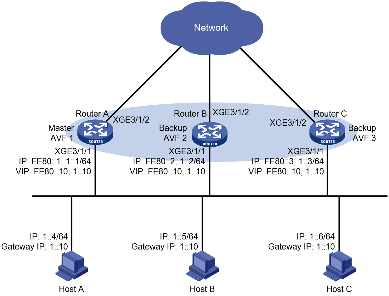

VRRP load balancing mode
In a standard-mode VRRP group, only the master can forward packets and backups are in listening state. You can create multiple VRRP groups to share traffic, but you must configure different gateways for hosts on the subnet.
In load balancing mode, a VRRP group maps its virtual IP address to multiple virtual MAC addresses, assigning one virtual MAC address to each member router. Every router in this VRRP group can forward traffic and respond to IPv4 ARP requests or IPv6 ND requests from hosts. Because their virtual MAC addresses are different, traffic from hosts is distributed across the VRRP group members. Load balancing mode simplifies configuration and improves forwarding efficiency.
VRRP load balancing mode uses the same master election, preemption, and tracking mechanisms as the standard mode. New mechanisms have been introduced to VRRP load balancing mode, as described in the following sections.
Virtual MAC address assignment
In load balancing mode, the master assigns virtual MAC addresses to routers in the VRRP group. The master uses different MAC addresses to respond to ARP requests or ND requests from different hosts. The backup routers, however, do not answer ARP requests or ND requests from hosts.
In an IPv4 network, a load balanced VRRP group works as follows:
1.     The master assigns virtual MAC addresses to all member routers, including itself. This example assumes that the virtual IP address of the VRRP group is 10.1.1.1/24, Router A is the master, and Router B is the backup. Router A assigns 000f-e2ff-0011 for itself and 000f-e2ff-0012 for Router B. See Figure 5.
Figure 5 Virtual MAC address assignment
2.     When an ARP request arrives, the master (Router A) selects a virtual MAC address based on the load balancing algorithm to answer the ARP request. In this example, Router A returns the virtual MAC address of itself in response to the ARP request from Host A. Router A returns the virtual MAC address of Router B in response to the ARP request from Host B. See Figure 6.
Figure 6 Answering ARP requests
3.     Each host sends packets to the returned MAC address. As shown in Figure 7, Host A sends packets to Router A and Host B sends packets to Router B.
Figure 7 Sending packets to different routers for forwarding
In the ARP reply sent by the master, the source MAC address in the Ethernet header is different from the sender MAC address in the message body. For the Layer 2 device to forward the ARP packet, follow these configuration guidelines on the Layer 2 device:
·     Do not enable ARP packet source MAC address consistency check.
·     Do not specify the src-mac keyword when you enable ARP packet validity check for ARP detection.
For more information about ARP packet source MAC address consistency check and ARP detection, see Security Configuration Guide.

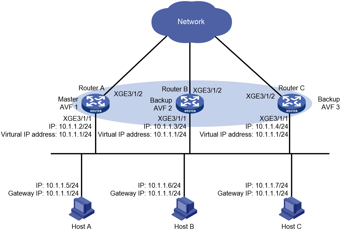

VF backup
The VFs corresponding to a virtual MAC address on different routers in the VRRP group back up one another.
Figure 8 VF information
Figure 8 shows the VF table on each router in the VRRP group and how the VFs back up one another. The master, Router A, assigns virtual MAC addresses 000f-e2ff-0011, 000f-e2ff-0012, and 000f-e2ff-0013 to itself, Router B, and Router C, respectively. Each router creates VF 1, VF 2, and VF 3 for virtual MAC addresses 000f-e2ff-0011, 000f-e2ff-0012, and 000f-e2ff-0013, respectively. The VFs for the same virtual MAC address on different routers back up one another. For example, the VF 1 instances on Router A, Router B, and Router C back up one another.
·     The VF 1 instance on Router A (the VF 1 owner) has priority 255. It acts as the AVF to forward packets sent to virtual MAC address 000f-e2ff-0011.
·     The VF 1 instances on Router B and Router C have a priority of 255/(1 + 1), or 127. Because their priorities are lower than the priority of the VF 1 instance on Router A, they act as LVFs. These LVFs listen to the state of the VF 1 instance on Router A.
·     When the VF 1 instance on Router A fails, the VF 1 instances on Router B and Router C elect the one with higher priority as the new AVF. This AVF forwards packets destined for virtual MAC address 000f-e2ff-0011. If the two LVFs' priorities are the same, the LVF with a greater device MAC address becomes the new AVF.
A VF always operates in preemptive mode. When an LVF finds its priority value higher than the one advertised by the AVF, the LVF declares itself as the AVF.

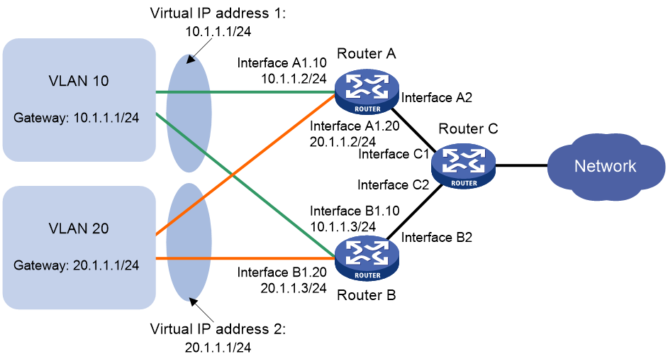

Specifying an IPv4 VRRP control VLAN
As shown in Figure 9, ambiguous VLAN termination is configured for VLAN 10 and VLAN 20 on the Layer 3 Ethernet subinterfaces on routers. To allow the master to regularly send VRRP advertisements in multicast to the backups, enable the VLAN termination-enabled subinterfaces to transmit broadcast packets and multicast packets. Then, the master can send VRRP advertisements within all VLANs whose VLAN packets are configured to be terminated by the subinterfaces. If ambiguous VLAN termination is configured on the Layer 3 Ethernet subinterfaces for a large range of VLANs, the VRRP advertisements might overload the subinterfaces. This adversely affects the performance of the routers.
To resolve this problem, you can disable the VLAN termination-enabled subinterfaces from transmitting broadcast packets and multicast packets and configure a VRRP control VLAN. The master sends VRRP advertisements only within the control VLAN.
Figure 9 VRRP control VLAN
Specify VRRP control VLANs according to the VLAN termination type.
·     For ambiguous Dot1q termination, specify one control VLAN by the outermost layer of VLAN tag.
·     For ambiguous QinQ termination, specify two control VLANs by the outermost two layers of VLAN tags.
For more information about VLAN termination, see Layer 2—LAN Switching Configuration Guide.
·     When VRRP is operating in load balancing mode, you cannot specify the VRRP control VLAN.
·     As a best practice, configure the arp send-gratuitous-arp command on the routers in a VRRP group after you specify a VRRP control VLAN. This command enables the routers to periodically send gratuitous ARP packets. The devices in the VLAN terminated ambiguously can then update MAC address entries after a master switchover. For more information about the arp send-gratuitous-arp command, see Layer 3—IP Services Command Reference.

Specifying an IPv6 VRRP control VLAN
As shown in Figure 11, ambiguous VLAN termination is configured for VLAN 10 and VLAN 20 on the Layer 3 Ethernet subinterfaces on routers. To allow the master to regularly send IPv6 VRRP advertisements in multicast to the backups, enable the VLAN termination-enabled subinterfaces to transmit broadcast packets and multicast packets. Then, the master can send IPv6 VRRP advertisements within all VLANs whose VLAN packets are configured to be terminated by the subinterfaces. If ambiguous VLAN termination is configured on the Layer 3 Ethernet subinterfaces for a large range of VLANs, the IPv6 VRRP advertisements might overload the subinterfaces. This adversely affects the performance of the routers.
To resolve this problem, you can disable the VLAN termination-enabled subinterfaces from transmitting broadcast packets and multicast packets and configure an IPv6 VRRP control VLAN. The master sends IPv6 VRRP advertisements only within the control VLAN.
Figure 11 IPv6 VRRP control VLAN
Specify IPv6 VRRP control VLANs according to the VLAN termination type.
When IPv6 VRRP is operating in load balancing mode, you cannot specify the IPv6 VRRP control VLAN.
2.     Enter Layer 3 Ethernet subinterface view or Layer 3 aggregate subinterface view.
3.     Specify IPv6 VRRP control VLANs.
¡     Specify an IPv6 VRRP control VLAN for the ambiguous Dot1q termination-enabled subinterface.
vrrp ipv6 dot1q vid vlan-id
¡     Specify IPv6 VRRP control VLANs for the ambiguous QinQ termination-enabled subinterface.
vrrp ipv6 dot1q vid vlan-id secondary-dot1q secondary-vlan-id
By default, no IPv6 VRRP control VLAN is specified. The master sends IPv6 VRRP advertisements within all VLANs whose VLAN packets are configured to be terminated by the subinterface.

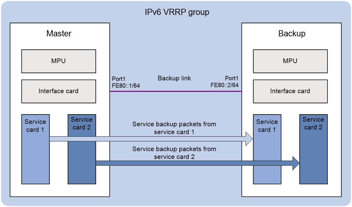

Enabling an IPv6 VRRP group to ignore interface down events

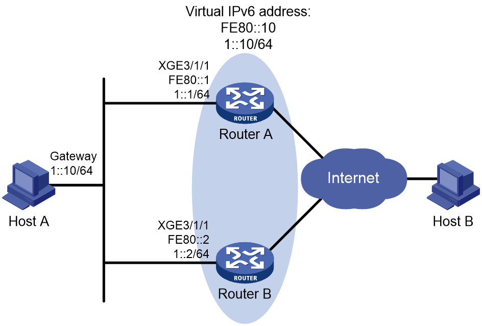

Some high availability services (such as VSRP, failover group, and subordinate IPv6 VRRP group) determine the device roles based on the device states in the associated IPv6 VRRP group. The master device corresponds to the master in the IPv6 VRRP group and is used to forward traffic. The backup device corresponds to the backup in the IPv6 VRRP group and is used to monitor the state of the master device. If the IPv6 VRRP group is configured on the interfaces of a direct link connecting two devices, an interface or link failure can cause a state transition. The master and backup in the IPv6 VRRP group transition to Initialize state. Consequently, the master and backup devices for the associated high availability service transition to the initialized state, and the master device stops processing service data. To prevent interruption of high availability services, perform this task on the two devices in the IPv6 VRRP group. The IPv6 VRRP group will keep the state of master and backup unchanged when a hosting interface is physically down.
As shown in Figure 12, in the network where a failover group is bound with an IPv6 VRRP group, a direct link exists between the two devices. The IPv6 VRRP group is configured on the interfaces at the two ends of the direct link. The failover group determines the primary node and secondary node based on the device states (master and backup) in the IPv6 VRRP group. If an interface or link failure occurs, the peer interface physically goes down, and the master and backup in the IPv6 VRRP group transition to Initialize state. As a result, the primary node in the failover group stops process service data, and a service interruption occurs. To avoid this issue, perform this task to keep the state of master and backup unchanged in the IPv6 VRRP group upon an interface or link failure.
Figure 12 Networking of a failover group bound with an IPv6 VRRP group
For more information about master and subordinate IPv6 VRRP groups, see "Configuring a subordinate IPv4 VRRP group to follow a master IPv4 VRRP group."

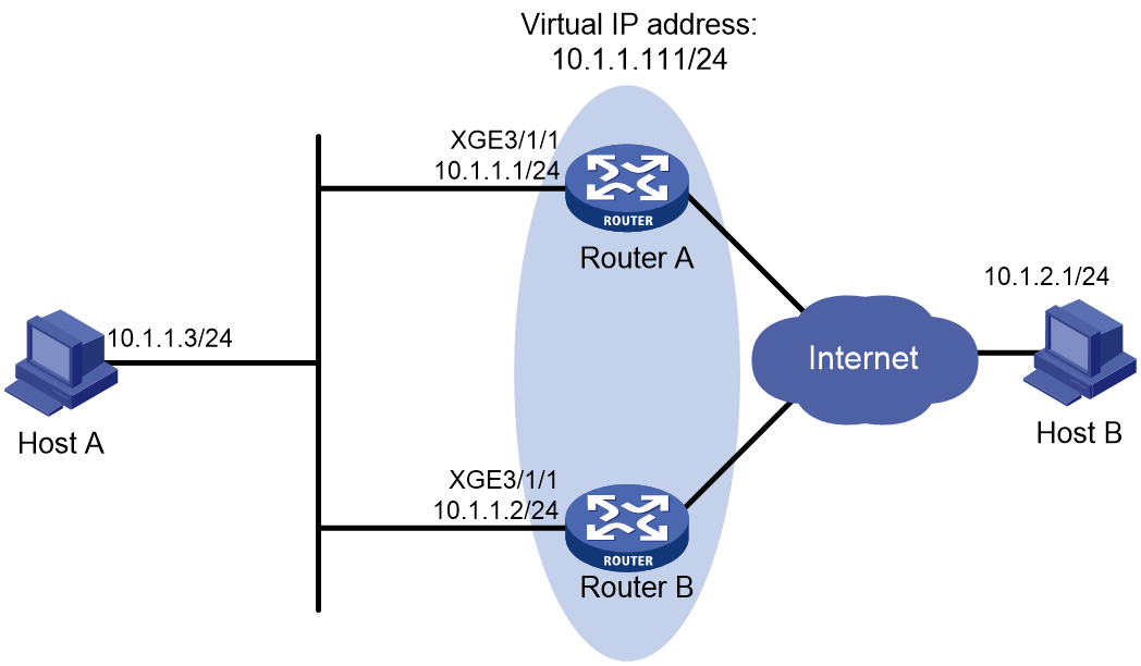

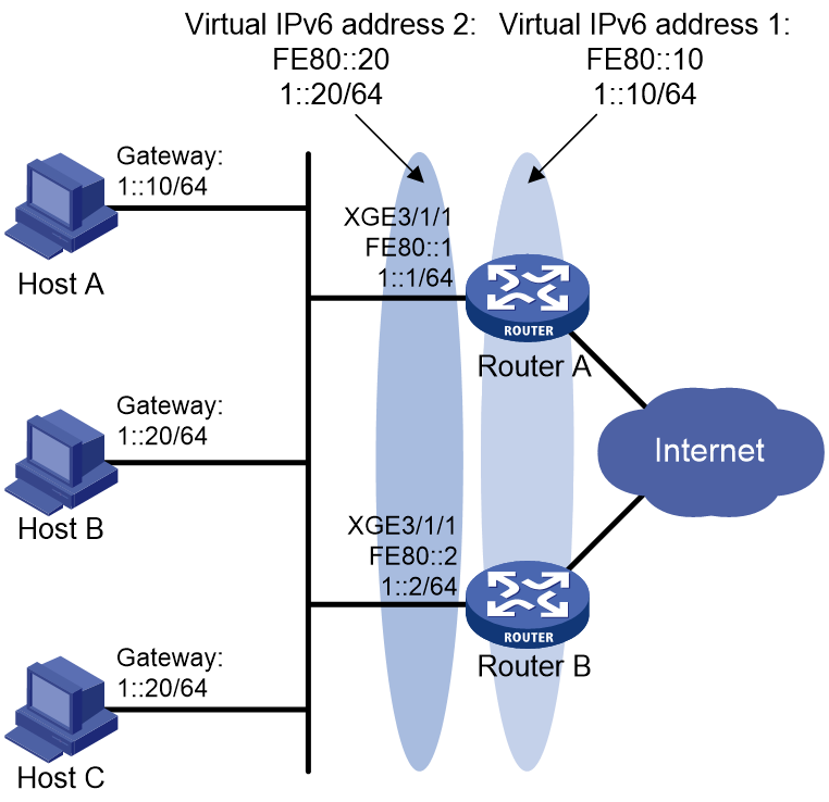

Example: Configuring a single VRRP group
As shown in Figure 13, Router A and Router B form a VRRP group. They use the virtual IP address 10.1.1.111/24 to provide gateway service for the subnet where Host A resides.
Router A operates as the master to forward packets from Host A to Host B. When Router A fails, Router B takes over to forward packets for Host A.
Configure Router A to operate in preempt mode so Router A can forward traffic as long as Router A operates correctly. Set the preemption delay to 5000 centiseconds to avoid frequent status change.
Figure 13 Network diagram

The output shows that Router A is operating as the master in VRRP group 1 to forward packets from Host A to Host B.
# Disconnect the link between Host A and Router A, and verify that Host A can still ping Host B. (Details not shown.)

The output shows that when Router A fails, Router B takes over to forward packets from Host A to Host B.

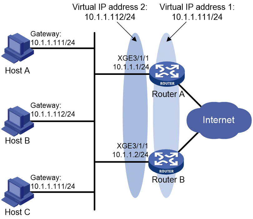

As shown in Figure 14, Router A and Router B form two VRRP groups to implement load sharing and mutual backup. VRRP group 1 uses the virtual IP address 10.1.1.111/24 to provide gateway service for some hosts on the subnet 10.1.1.0/24. VRRP group 2 uses the virtual IP address 10.1.1.112/24 to provide gateway service for the other hosts on the subnet.
Figure 14 Network diagram
For load sharing between the VRRP groups, configure the default gateways 10.1.1.111 and 10.1.1.112 for the hosts on the subnet 10.1.1.0/24.

The output shows the following information:
·     Router A is operating as the master in VRRP group 1 to forward Internet traffic for hosts that use the default gateway 10.1.1.111/24.
·     Router B is operating as the master in VRRP group 2 to forward Internet traffic for hosts that use the default gateway 10.1.1.112/24.
Example: Configuring VRRP load balancing
As shown in Figure 15, Router A, Router B, and Router C form a load-balanced VRRP group. They use the virtual IP address 10.1.1.1/24 to provide gateway service for subnet 10.1.1.0/24.
Configure VFs on Router A, Router B, and Router C to monitor their respective Ten-GigabitEthernet 3/1/2. When the interface on any one of them fails, the weights of the VFs on the problematic router decrease so another AVF can take over.
Figure 15 Network diagram

# Create VRRP group 1, and set its virtual IP address to 10.1.1.1.
[RouterA] interface ten-gigabitethernet 3/1/1
[RouterA-Ten-GigabitEthernet3/1/1] ip address 10.1.1.2 24
[RouterA-Ten-GigabitEthernet3/1/1] vrrp vrid 1 virtual-ip 10.1.1.1
# Assign Router A the highest priority in VRRP group 1, so Router A can become the master.
[RouterA-Ten-GigabitEthernet3/1/1] vrrp vrid 1 priority 120
# Configure Router A to operate in preemptive mode, so it can become the master whenever it operates correctly. Set the preemption delay to 5000 centiseconds to avoid frequent status switchover.
[RouterA-Ten-GigabitEthernet3/1/1] vrrp vrid 1 preempt-mode delay 5000
[RouterA-Ten-GigabitEthernet3/1/1] quit
# Create track entry 1 to monitor the upstream link status of Ten-GigabitEthernet 3/1/2. When the upstream link fails, the track entry transits to Negative.
[RouterA] track 1 interface ten-gigabitethernet 3/1/2
# Configure the VFs in VRRP group 1 to monitor track entry 1, and decrease their weights by 250 when the track entry transits to Negative.
[RouterA-Ten-GigabitEthernet3/1/1] vrrp vrid 1 track 1 weight reduced 250
2.     Configure Router B:
# Configure VRRP to operate in load balancing mode.
<RouterB> system-view
[RouterB] vrrp mode load-balance
[RouterB] interface ten-gigabitethernet 3/1/1
[RouterB-Ten-GigabitEthernet3/1/1] ip address 10.1.1.3 24
[RouterB-Ten-GigabitEthernet3/1/1] vrrp vrid 1 virtual-ip 10.1.1.1
# Assign Router B a higher priority than Router C in VRRP group 1, so Router B can become the master when Router A fails.
[RouterB-Ten-GigabitEthernet3/1/1] vrrp vrid 1 priority 110
# Configure Router B to operate in preemptive mode, and set the preemption delay to 5000 centiseconds.
[RouterB-Ten-GigabitEthernet3/1/1] vrrp vrid 1 preempt-mode delay 5000
[RouterB-Ten-GigabitEthernet3/1/1] quit
[RouterB] track 1 interface ten-gigabitethernet 3/1/2
[RouterB-Ten-GigabitEthernet3/1/1] vrrp vrid 1 track 1 weight reduced 250
3.     Configure Router C:
<RouterC> system-view
[RouterC] vrrp mode load-balance
# Create VRRP group 1, and set its virtual IP address as 10.1.1.1.
[RouterC] interface ten-gigabitethernet 3/1/1
[RouterC-Ten-GigabitEthernet3/1/1] ip address 10.1.1.4 24
[RouterC-Ten-GigabitEthernet3/1/1] vrrp vrid 1 virtual-ip 10.1.1.1
# Configure Router C to operate in preemptive mode, and set the preemption delay to 5000 centiseconds.
[RouterC-Ten-GigabitEthernet3/1/1] vrrp vrid 1 preempt-mode delay 5000
[RouterC-Ten-GigabitEthernet3/1/1] quit
[RouterC] track 1 interface ten-gigabitethernet 3/1/2
[RouterC-Ten-GigabitEthernet3/1/1] vrrp vrid 1 track 1 weight reduced 250
# Verify that Host A can ping the external network. (Details not shown.)
# Display detailed information about VRRP group 1 on Router A.
[RouterA-Ten-GigabitEthernet3/1/1] display vrrp verbose
IPv4 virtual router information:
 Running mode      : Load balance
 Enhanced sending of gratuitous ARP packets : Disabled
 Total number of virtual routers : 1
   Interface Ten-GigabitEthernet3/1/1
     VRID             : 1                    Adver timer  : 100 centiseconds
     Admin status     : Up                   State        : Master
     Config pri       : 120                  Running pri  : 120
     Preempt mode     : Yes                  Delay time   : 5000 centiseconds
     Auth type        : None
     Version          : 3
     Virtual IP       : 10.1.1.1
     Member IP list   : 10.1.1.2 (Local, Master)
                        10.1.1.3 (Backup)
                        10.1.1.4 (Backup)
   Forwarder information: 3 Forwarders 1 Active
     Config weight  : 255
     Running weight : 255
    Forwarder 01
     State          : Active
     Virtual MAC    : 000f-e2ff-0011 (Owner)
     Owner ID       : 0000-5e01-1101
     Priority       : 255
     Active         : local
    Forwarder 02
     State          : Listening
     Virtual MAC    : 000f-e2ff-0012 (Learnt)
     Owner ID       : 0000-5e01-1103
     Priority       : 127
     Active         : 10.1.1.3
    Forwarder 03
     State          : Listening
     Virtual MAC    : 000f-e2ff-0013 (Learnt)
     Owner ID       : 0000-5e01-1105
     Priority       : 127
     Active         : 10.1.1.4
   Forwarder weight track information:
     Track object   : 1          State : Positive   Weight reduced : 250
# Display detailed information about VRRP group 1 on Router B.
[RouterB-Ten-GigabitEthernet3/1/1] display vrrp verbose
     Admin status     : Up                   State        : Backup
     Config pri       : 110                  Running pri  : 110
     Become master    : 426ms milliseconds left
     Auth type        : None
     Version          : 3
     Member IP list   : 10.1.1.3 (Local, Backup)
                        10.1.1.2 (Master)
                        10.1.1.4 (Backup)
     Config weight  : 255
    Forwarder 01
     State          : Listening
     Virtual MAC    : 000f-e2ff-0011 (Learnt)
     Priority       : 127
     Active         : 10.1.1.2
    Forwarder 02
     State          : Active
     Virtual MAC    : 000f-e2ff-0012 (Owner)
     Priority       : 255
     Active         : local
    Forwarder 03
     State          : Listening
     Priority       : 127
     Active         : 10.1.1.4
# Display detailed information about VRRP group 1 on Router C.
[RouterC-Ten-GigabitEthernet3/1/1] display vrrp verbose
     Config pri       : 100                  Running pri  : 100 centiseconds
     Become master    : 417 milliseconds left
     Auth type        : None
     Version          : 3
     Member IP list   : 10.1.1.4 (Local, Backup)
                        10.1.1.2 (Master)
                        10.1.1.3 (Backup)
     Config weight  : 255
    Forwarder 01
     State          : Listening
     Priority       : 127
     Active         : 10.1.1.2
    Forwarder 02
     State          : Listening
     Priority       : 127
     Active         : 10.1.1.3
    Forwarder 03
     State          : Active
     Virtual MAC    : 000f-e2ff-0013 (Owner)
     Priority       : 255
     Active         : local
The output shows that Router A is the master in VRRP group 1, and each of the three routers has one AVF and two LVFs.
# Disconnect the link of Ten-GigabitEthernet 3/1/2 on Router A, and display detailed information about VRRP group 1 on Router A.
     Auth type        : None
     Version          : 3
                        10.1.1.3 (Backup)
                        10.1.1.4 (Backup)
   Forwarder information: 3 Forwarders 0 Active
     Config weight  : 255
     Running weight : 5
    Forwarder 01
     State          : Initialize
     Priority       : 0
     Active         : 10.1.1.4
    Forwarder 02
     State          : Initialize
     Priority       : 0
     Active         : 10.1.1.3
    Forwarder 03
     State          : Initialize
     Priority       : 0
     Active         : 10.1.1.4
     Track object   : 1          State : Negative   Weight reduced : 250
     Become master    : 412 milliseconds left
     Auth type        : None
     Version          : 3
                        10.1.1.2 (Master)
                        10.1.1.3 (Backup)
   Forwarder information: 3 Forwarders 2 Active
     Config weight  : 255
    Forwarder 01
     State          : Active
     Virtual MAC    : 000f-e2ff-0011 (Take Over)
     Priority       : 85
     Active         : local
    Forwarder 02
     State          : Listening
     Priority       : 85
     Active         : 10.1.1.3
    Forwarder 03
     State          : Active
     Priority       : 255
     Active         : local
The output shows that when Ten-GigabitEthernet 3/1/2 on Router A fails, the weights of the VFs on Router A drop below the lower limit of failure. All VFs on Router A transit to the Initialize state and cannot forward traffic. The VF for MAC address 000f-e2ff-0011 on Router C becomes the AVF to forward traffic.
# When the timeout timer (about 1800 seconds) expires, display detailed information about VRRP group 1 on Router C.
     Auth type        : None
     Version          : 3
                        10.1.1.2 (Master)
                        10.1.1.3 (Backup)
   Forwarder information: 2 Forwarders 1 Active
     Config weight  : 255
    Forwarder 02
     State          : Listening
     Priority       : 127
     Active         : 10.1.1.3
    Forwarder 03
     State          : Active
     Priority       : 255
     Active         : local
The output shows that when the timeout timer expires, the VF for virtual MAC address 000f-e2ff-0011 is removed. The VF no longer forwards the packets destined for the MAC address.
# When Router A fails, display detailed information about VRRP group 1 on Router B.
     Auth type        : None
     Version          : 3
     Member IP list   : 10.1.1.3 (Local, Master)
                        10.1.1.4 (Backup)
     Config weight  : 255
    Forwarder 02
     State          : Active
     Priority       : 255
As shown in Figure 16, Router A and Router B form a VRRP group. They use the virtual IP addresses 1::10/64 and FE80::10 to provide gateway service for the subnet where Host A resides.
Host A learns 1::10/64 as its default gateway from RA messages sent by the routers.
Figure 16 Network diagram

# Ping Host B from Host A. (Details not shown.)
[RouterA-Ten-GigabitEthernet3/1/1] display vrrp ipv6 verbose
IPv6 virtual router information:
 Running mode      : Standard
 Enhanced sending of gratuitous ND packets: Disabled
     Auth type        : None
     Virtual IP       : FE80::10
                        1::10
     Virtual MAC      : 0000-5e00-0201
     Master IP        : FE80::1
[RouterB-Ten-GigabitEthernet3/1/1] display vrrp ipv6 verbose
     Become master    : 411 milliseconds left
     Auth type        : None
                        1::10
     Master IP        : FE80::1
     Auth type        : None
                        1::10
     Master IP        : FE80::2
# Recover the link between Host A and Router A, and display detailed information about VRRP group 1 on Router A.
     Auth type        : None
                        1::10
     Master IP        : FE80::1
The output shows that after Router A resumes normal operation, it becomes the master to forward packets from Host A to Host B.
Example: Configuring multiple VRRP groups
As shown in Figure 17, Router A and Router B form two VRRP groups to implement load sharing and mutual backup. VRRP group 1 uses the virtual IP address 1::10/64 to provide gateway service for some hosts on the subnet 1::/64. VRRP group 2 uses the virtual IP address 1::20/64 to provide gateway service for the other hosts on the subnet.
Figure 17 Network diagram
For load sharing between the VRRP groups, configure the default gateways 1::10 and 1::20 for the hosts on the subnet 1::/64.
·     Router A is operating as the master in VRRP group 1 to forward Internet traffic for hosts that use the default gateway 1::10/64.
·     Router B is operating as the master in VRRP group 2 to forward Internet traffic for hosts that use the default gateway 1::20/64.
As shown in Figure 18, Router A, Router B, and Router C form a load balanced VRRP group and use the virtual IPv6 addresses FE80::10 and 1::10 to provide gateway service for the subnet 1::/64.
Hosts on subnet 1::/64 learn 1::10 as their default gateway from RA messages sent by the routers.
Configure VFs on Router A, Router B, or Router C to monitor their respective Ten-GigabitEthernet 3/1/2. When the interface on any of them fails, the weights of the VFs on the problematic router decrease so another AVF can take over.
Figure 18 Network diagram

# Enable Router B to send RA messages, so hosts on subnet 1::/64 can learn the default gateway address.
[RouterB-Ten-GigabitEthernet3/1/1] undo ipv6 nd ra halt
[RouterB-Ten-GigabitEthernet3/1/1] vrrp ipv6 vrid 1 track 1 weight reduced 250
[RouterC] vrrp ipv6 mode load-balance
# Create VRRP group 1 and set its virtual IPv6 addresses to FE80::10 and 1::10.
[RouterC-Ten-GigabitEthernet3/1/1] ipv6 address fe80::3 link-local
[RouterC-Ten-GigabitEthernet3/1/1] ipv6 address 1::3 64
[RouterC-Ten-GigabitEthernet3/1/1] vrrp ipv6 vrid 1 virtual-ip fe80::10 link-local
[RouterC-Ten-GigabitEthernet3/1/1] vrrp ipv6 vrid 1 virtual-ip 1::10
# Configure Router C to operate in preemptive mode and set the preemption delay to 5000 centiseconds.
[RouterC-Ten-GigabitEthernet3/1/1] vrrp ipv6 vrid 1 preempt-mode delay 5000
# Enable Router C to send RA messages, so hosts on subnet 1::/64 can learn the default gateway address.
[RouterC-Ten-GigabitEthernet3/1/1] undo ipv6 nd ra halt
[RouterC-Ten-GigabitEthernet3/1/1] vrrp ipv6 vrid 1 track 1 weight reduced 250
     Auth type        : None
                        1::10
     Member IP list   : FE80::1 (Local, Master)
                        FE80::2 (Backup)
                        FE80::3 (Backup)
     Config weight  : 255
    Forwarder 01
     State          : Active
     Virtual MAC    : 000f-e2ff-4011 (Owner)
     Priority       : 255
     Active         : local
    Forwarder 02
     State          : Listening
     Virtual MAC    : 000f-e2ff-4012 (Learnt)
     Priority       : 127
     Active         : FE80::2
    Forwarder 03
     State          : Listening
     Virtual MAC    : 000f-e2ff-4013 (Learnt)
     Priority       : 127
     Active         : FE80::3
     Become master    : 400 milliseconds left
     Auth type        : None
                        1::10
     Member IP list   : FE80::2 (Local, Backup)
                        FE80::1 (Master)
                        FE80::3 (Backup)
     Config weight  : 255
    Forwarder 01
     State          : Listening
     Virtual MAC    : 000f-e2ff-4011 (Learnt)
     Priority       : 127
     Active         : FE80::1
    Forwarder 02
     State          : Active
     Virtual MAC    : 000f-e2ff-4012 (Owner)
     Priority       : 255
     Active         : local
    Forwarder 03
     State          : Listening
     Priority       : 127
     Active         : FE80::3
[RouterC-Ten-GigabitEthernet3/1/1] display vrrp ipv6 verbose
     Become master    : 402 milliseconds left
     Auth type        : None
                        1::10
     Member IP list   : FE80::3 (Local, Backup)
                        FE80::1 (Master)
                        FE80::2 (Backup)
     Config weight  : 255
    Forwarder 01
     State          : Listening
     Priority       : 127
     Active         : FE80::1
    Forwarder 02
     State          : Listening
     Priority       : 127
     Active         : FE80::2
    Forwarder 03
     State          : Active
     Virtual MAC    : 000f-e2ff-4013 (Owner)
     Priority       : 255
     Active         : local
     Preempt mode     : Yes                  Delay Time   : 5000 centiseconds
     Auth type        : None
                        1::10
                        FE80::2 (Backup)
                        FE80::3 (Backup)
     Config weight  : 255
     Running weight : 5
    Forwarder 01
     State          : Initialize
     Priority       : 0
     Active         : FE80::3
    Forwarder 02
     State          : Initialize
     Priority       : 0
     Active         : FE80::2
    Forwarder 03
     State          : Initialize
     Priority       : 0
     Active         : FE80::3
     Become master    : 401 milliseconds left
     Auth type        : None
                        1::10
                        FE80::1 (Master)
                        FE80::2 (Backup)
     Config weight  : 255
    Forwarder 01
     State          : Active
     Virtual MAC    : 000f-e2ff-4011 (Take Over)
     Priority       : 85
     Active         : local
    Forwarder 02
     State          : Listening
     Priority       : 85
     Active         : FE80::2
    Forwarder 03
     State          : Active
     Priority       : 255
     Active         : local
The output shows that when Ten-GigabitEthernet 3/1/2 on Router A fails, the weights of the VFs on Router A drop below the lower limit of failure. All VFs on Router A transit to the Initialize state and cannot forward traffic. The VF for MAC address 000f-e2ff-4011 on Router C becomes the AVF to forward traffic.
     Auth type        : None
                        1::10
                        FE80::1 (Master)
                        FE80::2 (Backup)
     Config weight  : 255
    Forwarder 02
     State          : Listening
     Priority       : 127
     Active         : FE80::2
    Forwarder 03
     State          : Active
     Priority       : 255
     Active         : local
The output shows that when the timeout timer expires, the VF for virtual MAC address 000f-e2ff-4011 is removed. The VF no longer forwards the packets destined for the MAC address.
     Auth type        : None
                        1::10
     Member IP list   : FE80::2 (Local, Master)
                        FE80::3 (Backup)
     Config weight  : 255
    Forwarder 02
     State          : Active
     Priority       : 255
     Active         : local
    Forwarder 03
     State          : Listening
     Priority       : 127
     Active         : FE80::3
·     When Router A fails, Router B becomes the master because it has a higher priority than Router C.
·     The VF for virtual MAC address 000f-e2ff-4011 is removed.
