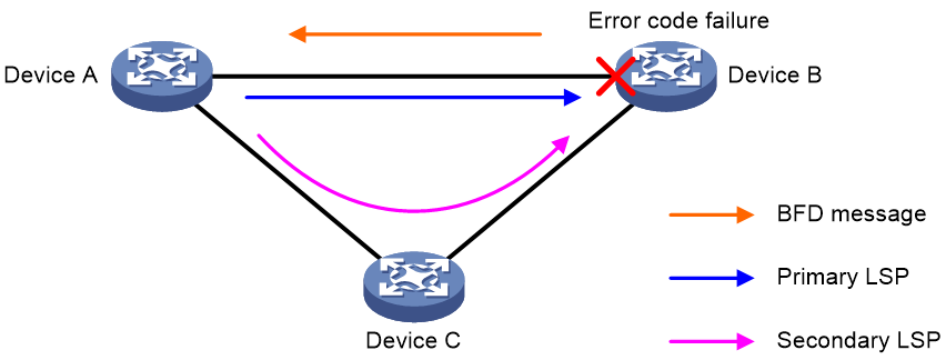

· Trigger LSP—Error code failures on an interface can trigger LSP switchover. An error code failure occurring on an interface is reported to the upper-layer service module to switch traffic from the primary LSP to the secondary LSP. After the error code failure is cleared, traffic is switched back to the primary LSP.
As shown in Figure 1, each interface has error code detection enabled for triggering LSP switchover. LDP labels are distributed among nodes. Typically, MPLS traffic is forwarded over the primary LSP. When error codes are detected on Device B, the following events occur:
¡ Device B senses the primary LSP failure, and switches traffic to the secondary LSP. At the same, Device B sends BFD messages to notify Device A of the error code failure.
¡ After Device A receives BFD messages from Device B, Device A also senses the primary LSP failure, and switches traffic to the secondary LSP.
Figure 1 Schematic diagram for error code detection for triggering LSP switchover

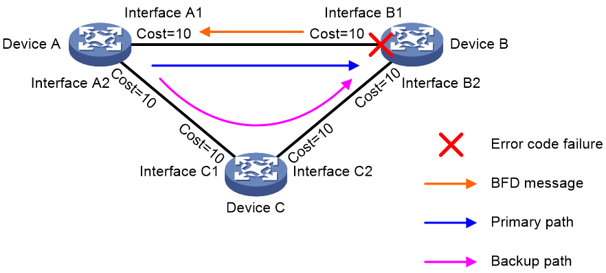

· Trigger Section—Error code failures on an interface can trigger section layer service protection. An error code failure occurring on an interface is reported to the interface management module to set the link layer protocol status of the interface to DOWN(Bit-error down). Then, the upper-layer service module associated with the interface triggers section layer service protection. After the error code failure is cleared, the link layer protocol status of the interface restores to UP and triggers the upper-layer service module to cancel section layer service protection.
As shown in Figure 2, each interface has error code detection enabled for triggering section layer service protection. All nodes can reach each other through IS-IS routes. Normally, both Device A and Device B preferentially use the primary path for IS-IS routes. Therefore, traffic in each direction is forwarded by the primary path. When error codes are detected on Device B, the following events occur:
¡ The link layer protocol state of the corresponding interface on Device B becomes DOWN(Bit-error down) to trigger switching the IS-IS route to the backup path, so the traffic from Device B to Device A is forwarded through the backup path. At the same time, Device B sends BFD messages to notify Device A of the error code failure.
¡ After Device A receives the BFD messages from Device B, the link layer protocol state of the corresponding interface on Device A becomes DOWN(Bit-error down) to trigger switching the IS-IS route to the backup path, so the traffic from Device A to Device B is forwarded through the backup path.
Figure 2 Schematic diagram for error code detection for triggering section layer service protection

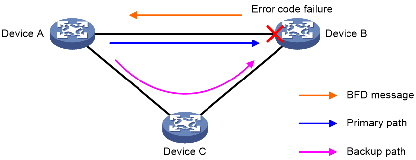

As shown in Figure 3, each interface has link quality detection enabled. All nodes can reach each other through IS-IS routes. Normally, both Device A and Device B preferentially use the primary path for IS-IS routes. Therefore, traffic in each direction is forwarded by the primary path. When error codes are detected on interface B1 of Device B, the following events occur:
· Device B sets the link quality level to LOW for interface B1 to trigger IS-IS to increase the cost for the link (for example, 40). At the same time, Device B sends BFD messages to notify Device A of the error code failure.
· After Device A receives BFD messages from Device B, Device A also sets the link quality level to LOW for interface A1 to trigger IS-IS to increase the cost for the link (for example, 40).
In this case, the cost of the backup path (20) is smaller than the cost of the primary path (40). As a result, the IS-IS routes on both Device A and Device B preferentially select the backup path, and bidirectional traffic between Device A and Device B is switched to the backup path to bypass error code failures.
Figure 3 Schematic diagram for link quality detection
