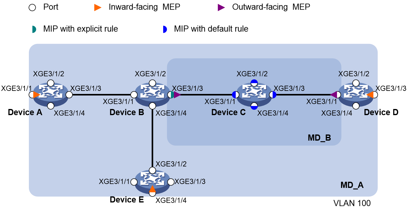

CFD grading example
Figure 3 demonstrates a grading example of the CFD module. Four levels of MDs (0, 2, 3, and 5) are designed. The bigger the number, the higher the level and the larger the area covered. MPs are configured on the ports of Device A through Device F. Port A of Device B is configured with the following MPs:
· A level 5 MIP.
· A level 3 inward-facing MEP.
· A level 2 inward-facing MEP.
· A level 0 outward-facing MEP.

Example: Configuring CFD in an Ethernet network
As shown in Figure 4:
· The network comprises five devices and is divided into two MDs: MD_A (level 5) and MD_B (level 3). All ports belong to VLAN 100, and the MAs in the two MDs all serve VLAN 100. Assume that the MAC addresses of Device A through Device E are 0010-FC01-6511, 0010-FC02-6512, 0010-FC03-6513, 0010-FC04-6514, and 0010-FC05-6515, respectively.
· MD_A has three edge ports: Ten-GigabitEthernet 3/1/1 on Device A, Ten-GigabitEthernet 3/1/3 on Device D, and Ten-GigabitEthernet 3/1/4 on Device E. They are all inward-facing MEPs. MD_B has two edge ports: Ten-GigabitEthernet 3/1/3 on Device B and Ten-GigabitEthernet 3/1/1 on Device D. They are both outward-facing MEPs.
· In MD_A, Device B is designed to have MIPs when its port is configured with low level MEPs. Port Ten-GigabitEthernet 3/1/3 is configured with MEPs of MD_B, and the MIPs of MD_A can be configured on this port. You must configure the MIP generation rule of MD_A as explicit.
· The MIPs of MD_B are designed on Device C, and are configured on all ports. You must configure the MIP generation rule as default.
· Configure CC to monitor the connectivity among all the MEPs in MD_A and MD_B. Configure LB to locate link faults, and use the AIS and EAIS functions to suppress the error alarms that are reported.
· After the status information of the entire network is obtained, use LT, LM, DM, and TST to detect link faults.
1. Configure a VLAN and assign ports to it:
On each device shown in Figure 4, create VLAN 100 and assign ports Ten-GigabitEthernet 3/1/1 through Ten-GigabitEthernet 3/1/4 to VLAN 100.
2. Enable CFD:
# Enable CFD on Device A.
<DeviceA> system-view
[DeviceA] cfd enable
# Configure Device B through Device E in the same way Device A is configured. (Details not shown.)
3. Configure service instances:
# Create MD_A (level 5) on Device A, and create service instance 1 (in which the MA is identified by a VLAN and serves VLAN 100).
[DeviceA] cfd md MD_A level 5
[DeviceA] cfd service-instance 1 ma-id vlan-based md MD_A vlan 100
# Configure Device E in the same way Device A is configured. (Details not shown.)
# Create MD_A (level 5) on Device B, and create service instance 1 (in which the MA is identified by a VLAN and serves VLAN 100).
[DeviceB] cfd md MD_A level 5
[DeviceB] cfd service-instance 1 ma-id vlan-based md MD_A vlan 100
# Create MD_B (level 3), and create service instance 2 (in which the MA is identified by a VLAN and serves VLAN 100).
[DeviceB] cfd md MD_B level 3
[DeviceB] cfd service-instance 2 ma-id vlan-based md MD_B vlan 100
# Configure Device D in the same way Device B is configured. (Details not shown.)
# Create MD_B (level 3) on Device C, and create service instance 2 (in which the MA is identified by a VLAN and serves VLAN 100).
[DeviceC] cfd md MD_B level 3
[DeviceC] cfd service-instance 2 ma-id vlan-based md MD_B vlan 100
4. Configure MEPs:
# On Device A, configure a MEP list in service instance 1, and create inward-facing MEP 1001 in service instance 1 on Ten-GigabitEthernet 3/1/1.
[DeviceA] cfd meplist 1001 4002 5001 service-instance 1
[DeviceA] interface ten-gigabitethernet 3/1/1
[DeviceA-Ten-GigabitEthernet3/1/1] cfd mep 1001 service-instance 1 inbound
[DeviceA-Ten-GigabitEthernet3/1/1] quit
# On Device B, configure a MEP list in service instances 1 and 2.
[DeviceB] cfd meplist 1001 4002 5001 service-instance 1
[DeviceB] cfd meplist 2001 4001 service-instance 2
# Create outward-facing MEP 2001 in service instance 2 on Ten-GigabitEthernet 3/1/3.
[DeviceB] interface ten-gigabitethernet 3/1/3
[DeviceB-Ten-GigabitEthernet3/1/3] cfd mep 2001 service-instance 2 outbound
[DeviceB-Ten-GigabitEthernet3/1/3] quit
# On Device D, configure a MEP list in service instances 1 and 2.
[DeviceD] cfd meplist 1001 4002 5001 service-instance 1
[DeviceD] cfd meplist 2001 4001 service-instance 2
# Create outward-facing MEP 4001 in service instance 2 on Ten-GigabitEthernet 3/1/1.
[DeviceD] interface ten-gigabitethernet 3/1/1
[DeviceD-Ten-GigabitEthernet3/1/1] cfd mep 4001 service-instance 2 outbound
[DeviceD-Ten-GigabitEthernet3/1/1] quit
# Create inward-facing MEP 4002 in service instance 1 on Ten-GigabitEthernet 3/1/3.
[DeviceD] interface ten-gigabitethernet 3/1/3
[DeviceD-Ten-GigabitEthernet3/1/3] cfd mep 4002 service-instance 1 inbound
[DeviceD-Ten-GigabitEthernet3/1/3] quit
# On Device E, configure a MEP list in service instance 1.
[DeviceE] cfd meplist 1001 4002 5001 service-instance 1
# Create inward-facing MEP 5001 in service instance 1 on Ten-GigabitEthernet 3/1/4.
[DeviceE] interface ten-gigabitethernet 3/1/4
[DeviceE-Ten-GigabitEthernet3/1/4] cfd mep 5001 service-instance 1 inbound
[DeviceE-Ten-GigabitEthernet3/1/4] quit
5. Configure MIPs:
# Configure the MIP generation rule in service instance 1 on Device B as explicit.
[DeviceB] cfd mip-rule explicit service-instance 1
# Configure the MIP generation rule in service instance 2 on Device C as default.
[DeviceC] cfd mip-rule default service-instance 2
6. Configure CC:
# On Device A, enable the sending of CCM frames for MEP 1001 in service instance 1 on Ten-GigabitEthernet 3/1/1.
[DeviceA-Ten-GigabitEthernet3/1/1] cfd cc service-instance 1 mep 1001 enable
# On Device B, enable the sending of CCM frames for MEP 2001 in service instance 2 on Ten-GigabitEthernet 3/1/3.
[DeviceB-Ten-GigabitEthernet3/1/3] cfd cc service-instance 2 mep 2001 enable
# On Device D, enable the sending of CCM frames for MEP 4001 in service instance 2 on Ten-GigabitEthernet 3/1/1.
[DeviceD-Ten-GigabitEthernet3/1/1] cfd cc service-instance 2 mep 4001 enable
# Enable the sending of CCM frames for MEP 4002 in service instance 1 on Ten-GigabitEthernet 3/1/3.
[DeviceD-Ten-GigabitEthernet3/1/3] cfd cc service-instance 1 mep 4002 enable
# On Device E, enable the sending of CCM frames for MEP 5001 in service instance 1 on Ten-GigabitEthernet 3/1/4.
[DeviceE-Ten-GigabitEthernet3/1/4] cfd cc service-instance 1 mep 5001 enable
7. Configure hardware CC:
# Configure hardware CC on Ten-GigabitEthernet 3/1/1 of Device D to enable MEP 4001 to receive CCM frames from MEP 2001.
[DeviceD-Ten-GigabitEthernet3/1/1] cfd hardware-cc service-instance 2 remote-mep 2001
8. Configure AIS:
# Enable AIS on Device B. Configure the AIS frame transmission level as 5 and AIS frame transmission interval as 1 second in service instance 2.
[DeviceB] cfd ais enable
[DeviceB] cfd ais level 5 service-instance 2
[DeviceB] cfd ais period 1 service-instance 2
9. Configure EAIS:
# Enable port status-AIS collaboration on Device B.
[DeviceB] cfd ais-track link-status global
# On Ten-GigabitEthernet 3/1/3 of Device B, configure the EAIS frame transmission level as 5 and the EAIS frame transmission interval as 60 seconds. Specify the VLANs where the EAIS frames can be transmitted as VLAN 100.
[DeviceB-Ten-GigabitEthernet3/1/3] cfd ais-track link-status level 5
[DeviceB-Ten-GigabitEthernet3/1/3] cfd ais-track link-status period 60
[DeviceB-Ten-GigabitEthernet3/1/3] cfd ais-track link-status vlan 100

Reply from 0010-fc05-6515: sequence number=1001-43404 time=5ms
Reply from 0010-fc05-6515: sequence number=1001-43405 time=5ms
Reply from 0010-fc05-6515: sequence number=1001-43406 time=5ms
Reply from 0010-fc05-6515: sequence number=1001-43407 time=5ms
Reply from 0010-fc05-6515: sequence number=1001-43408 time=5ms
Sent: 5 Received: 5 Lost: 0
2. Verify the LT function after the CC function obtains the status information of the entire network:
# Identify the path between MEP 1001 and MEP 5001 in service instance 1 on Device A.
[DeviceA] cfd linktrace service-instance 1 mep 1001 target-mep 5001
Linktrace to MEP 5001 with the sequence number 1001-43462:
MAC address TTL Last MAC Relay action
0010-fc05-6515 63 0010-fc02-6512 Hit
3. Verify the one-way LM function after the CC function obtains the status information of the entire network:
# Use short-period LM to test the frame loss from MEP 1001 to MEP 4002 in service instance 1 on Device A.
[DeviceA] cfd slm service-instance 1 mep 1001 target-mep 4002
Reply from 0010-fc04-6514:
Far-end frame loss : 10 Far-end frame loss rate : 10.00%
Near-end frame loss: 20 Near-end frame loss rate: 20.00%
Reply from 0010-fc00-6514:
Far-end frame loss : 40 Far-end frame loss rate : 40.00%
Near-end frame loss: 40 Near-end frame loss rate: 40.00%
Far-end frame loss : 0 Far-end frame loss rate : 0.00%
Near-end frame loss: 10 Near-end frame loss rate: 10.00%
Far-end frame loss : 30 Far-end frame loss rate : 30.00%
Near-end frame loss: 30 Near-end frame loss rate: 30.00%
Average:
Far-end frame loss : 20 Far-end frame loss rate : 20.00%
Near-end frame loss: 25 Near-end frame loss rate: 25.00%
Packet statistics:
Sent LMMs: 5 Received: 5
# Use continual LM to test the frame loss from MEP 1001 to MEP 4002 in service instance 1 on Device A.
[DeviceA] cfd slm continual service-instance 1 mep 1001 target-mep 4002
# Display the one-way LM result on MEP 1001 in service instance 1 on Device A.
[DeviceA] display cfd slm history service-instance 1 mep 1001
Total continual tests: 1
Service instance: 1
MEP ID: 1001
Send status: Testing
Test state: Active
Average:
4. Verify the one-way DM function after the CC function obtains the status information of the entire network:
# Use short-period DM to test the one-way frame delay from MEP 1001 to MEP 4002 in service instance 1 on Device A.
[DeviceA] cfd dm one-way service-instance 1 mep 1001 target-mep 4002
5 1DMs have been sent. Please check the result on the remote device.
# Display the one-way DM result on MEP 4002 in service instance 1 on Device D.
[DeviceD] display cfd dm one-way history service-instance 1 mep 4002
Service instance: 1
MEP ID: 4002
Test state: Active
Frame delay: 10ms 9ms 11ms 5ms 5ms
Delay average: 8ms
Frame jitter: 1ms 2ms 6ms 0ms
Variation average: 2ms
# Use continual DM to test the frame loss from MEP 1001 to MEP 4002 in service instance 1 on Device A.
[DeviceA] cfd dm one-way continual service-instance 1 mep 1001 target-mep 4002
Service instance: 1
MEP ID: 4002
Sent 1DM total number: 0
Received 1DM total number: 5
Delay average: 8ms
5. Verify the two-way DM function after the CC function obtains the status information of the entire network:
# Use short-period DM to test the two-way frame delay from MEP 1001 to MEP 4002 in service instance 1 on Device A.
[DeviceA] cfd dm two-way service-instance 1 mep 1001 target-mep 4002
Frame delay:
Reply from 0010-fc00-6514: 10us
Reply from 0010-fc00-6514: 9us
Reply from 0010-fc00-6514: 11us
Reply from 0010-fc00-6514: 5us
Average: 8us
Frame jitter: 1us 2us 6us 0us
Average: 2us
Packet statistics:
Sent DMMs: 5 Received: 5 Lost: 0
# Use continual DM to test the two-way frame delay from MEP 1001 to MEP 4002 in service instance 1 on Device A.
[DeviceA] cfd dm two-way continual service-instance 1 mep 1001 target-mep 4002
# Display the two-way DM result on MEP 1001 in service instance 1 on Device A.
[DeviceA] display cfd dm two-way history service-instance 1 mep 1001
Service instance: 1
MEP ID: 1001
Test state: Active
Frame delay:
Average: 8us
Average: 2us
6. Verify the TST function after the CC function obtains the status information of the entire network:
# Use short-period TST to test the bit errors on the link from MEP 1001 to MEP 4002 in service instance 1 on Device A.
[DeviceA] cfd tst service-instance 1 mep 1001 target-mep 4002
5 TSTs have been sent. Please check the result on the remote device.
# Display the short-period TST result on MEP 4002 in service instance 1 on Device D.
[DeviceD] display cfd tst history service-instance 1 mep 4002
Service instance: 1
MEP ID: 4002
Test state: Active
Received from 0010-fc01-6511, Bit True, sequence number 0
Received from 0010-fc01-6511, Bit True, sequence number 1
Received from 0010-fc01-6511, Bit True, sequence number 2
Received from 0010-fc01-6511, Bit True, sequence number 3
Received from 0010-fc01-6511, Bit True, sequence number 4
Sent TST total number: 7
Received TST total number: 5
Received bit error TST number: 0
Percentage of error messages: 0.00%

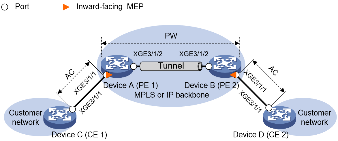

Example: Configuring CFD in a Layer 2 VPN (L2VPN networking)
As shown in Figure 5:
· Configure a static PW between PE 1 and PE 2 to enable CE 1 and CE 2 to communicate with each other. Assume that the MAC addresses of Device A through Device D are 0010-FC01-6511, 0010-FC02-6512, 0010-FC03-6513, and 0010-FC04-6514, respectively.
· Configure Ten-GigabitEthernet 3/1/1.1 on Device A and Device B as AC interfaces, and associate them with cross-connect svc of cross-connect group vpna.
· Assign the network to MD_A (level 5). MD_A has two edge interfaces: Ten-GigabitEthernet 3/1/1.1 on Device A and Ten-GigabitEthernet 3/1/1.1 on Device B. They are both inward-facing MEPs.
· Configure CC to monitor the connectivity between the inward-facing MEPs. Configure LB to locate link faults.
· After the status information of the entire network is obtained, use LT, LM, and DM to detect link faults.
1. Configure a static PW. (Details not shown.)
For information about configuring a static PW, see MPLS L2VPN in MPLS Configuration Guide.
2. Enable CFD:
# Configure Device B in the same way Device A is configured. (Details not shown.)
# Create MD_A (level 5) on Device A, and create service instance 1 (in which the MA is identified by vpnma and serves cross-connect svc of cross-connect group vpna).
[DeviceA] cfd service-instance 1 ma-id string vpnma md MD_A xconnect-group vpna connection svc
4. Configure MEPs:
# On Device A, configure a MEP list in service instance 1, and create inward-facing MEP 1001 in service instance 1 on Ten-GigabitEthernet 3/1/1.1.
[DeviceA] cfd meplist 1001 2001 service-instance 1
[DeviceA] interface ten-gigabitethernet 3/1/1.1
[DeviceA-Ten-GigabitEthernet3/1/1.1] cfd mep 1001 service-instance 1 inbound
[DeviceA-Ten-GigabitEthernet3/1/1.1] quit
# On Device B, configure a MEP list in service instance 1, and create inward-facing MEP 2001 in service instance 1 on Ten-GigabitEthernet 3/1/1.1.
[DeviceB] cfd meplist 1001 2001 service-instance 1
[DeviceB] interface ten-gigabitethernet 3/1/1.1
[DeviceB-Ten-GigabitEthernet3/1/1.1] cfd mep 2001 service-instance 1 inbound
[DeviceB-Ten-GigabitEthernet3/1/1.1] quit
5. Configure CC:
# On Device A, enable the sending of CCM frames for MEP 1001 in service instance 1 on Ten-GigabitEthernet 3/1/1.1.
[DeviceA-Ten-GigabitEthernet3/1/1.1] cfd cc service-instance 1 mep 1001 enable
# On Device B, enable the sending of CCM frames for MEP 2001 in service instance 1 on Ten-GigabitEthernet 3/1/1.1.
[DeviceB-Ten-GigabitEthernet3/1/1.1] cfd cc service-instance 1 mep 2001 enable
6. Configure the frame counting mode:
# Configure the frame counting mode as port-based for Ten-GigabitEthernet 3/1/1.1 on Device A.
[DeviceA-Ten-GigabitEthernet3/1/1.1] cfd frame-count mode port-based
# Configure the frame counting mode as port-based for Ten-GigabitEthernet 3/1/1.1 on Device B.
[DeviceB-Ten-GigabitEthernet3/1/1.1] cfd frame-count mode port-based
1. Verify the LB function when the CC function detects a link fault:
# Enable LB on Device A to check the status of the link between MEP 1001 and MEP 2001 in service instance 1.
[DeviceA] cfd loopback service-instance 1 mep 1001 target-mep 2001
Loopback to MEP 2001 with the sequence number start from 1001-43404:
Reply from 0010-fc02-6512: sequence number=1001-43404 time=5ms
Reply from 0010-fc02-6512: sequence number=1001-43405 time=5ms
Reply from 0010-fc02-6512: sequence number=1001-43406 time=5ms
Reply from 0010-fc02-6512: sequence number=1001-43407 time=5ms
Reply from 0010-fc02-6512: sequence number=1001-43408 time=5ms
# Identify the path between MEP 1001 and MEP 2001 in service instance 1 on Device A.
[DeviceA] cfd linktrace service-instance 1 mep 1001 target-mep 2001
Linktrace to MEP 2001 with the sequence number 1001-43462:
0010-fc02-6512 63 0010-fc02-6512 Hit
# Use short-period LM to test the frame loss from MEP 1001 to MEP 2001 in service instance 1 on Device A.
[DeviceA] cfd slm service-instance 1 mep 1001 target-mep 2001
Average:
Packet statistics:
# Use continual LM to test the frame delay from MEP 1001 to MEP 2001 in service instance 1 on Device A.
[DeviceA] cfd slm continual service-instance 1 mep 1001 target-mep 2001
Service instance: 1
MEP ID: 1001
Test state: Active
Average:
4. Verify the two-way LM function after the CC function obtains the status information of the entire network:
[DeviceA] cfd dlm continual service-instance 1 mep 1001 target-mep 2001
# Use continual LM to test the frame loss from MEP 2001 to MEP 1001 in service instance 1 on Device B.
[DeviceB] cfd dlm continual service-instance 1 mep 2001 target-mep 1001
# Display the two-way LM result on MEP 1001 in service instance 1 on Device A.
[DeviceA] display cfd dlm history service-instance 1 mep 1001
Service instance: 1
MEP ID: 1001
Test state: Active

As shown in Figure 6:
· Configure a static PW between PE 1 and PE 2 to enable CE 1 and CE 2 to communicate in VLAN 10. Assume that the MAC addresses of Device A through Device D are 0010-FC01-6511, 0010-FC02-6512, 0010-FC03-6513, and 0010-FC04-6514, respectively.
· Create Ethernet service instance 10 on Ten-GigabitEthernet 3/1/1 of PE 1 and PE 2 to match incoming packets with VLAN ID 10 on Ten-GigabitEthernet 3/1/1. Configure Ten-GigabitEthernet 3/1/1 on Device A and Device B as AC interfaces, and associate them with cross-connect svc of cross-connect group vpna.
· Assign the network to MD_A (level 5). MD_A has two edge interfaces: Ten-GigabitEthernet 3/1/1 on Device A and Ten-GigabitEthernet 3/1/1 on Device B. They are both inward-facing MEPs.
1. Configure VLANs and assign interfaces to them:
On each device shown in Figure 6, create VLAN 10 and VLAN 20, assign Ten-GigabitEthernet 3/1/1 to VLAN 10, and assign Ten-GigabitEthernet 3/1/2 to VLAN 20.
2. Configure a static PW. (Details not shown.)
