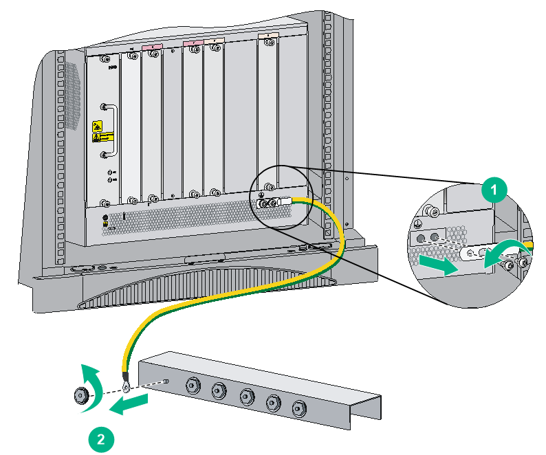

Removing the grounding cable
1.     Loosen the two screws at the grounding holes of the chassis and remove the grounding cable from the chassis.
2.     Use a wrench to loosen the hex nut on the grounding post of the grounding strip, and remove the other end of the grounding cable (with a ring terminal) from the grounding post.
Figure 13-1 Removing the grounding cable (S10506)

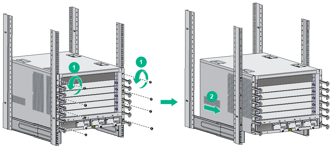

3.     As shown in callout 1 in Figure 13-2, use a Phillips screwdriver to loosen the screws that attach the mounting brackets to the rack.
4.     As shown in callout 2 in Figure 13-2, use at least two persons to slide the chassis outwards along the slide rails. When most part of the chassis is removed from the slide rails, lift up the chassis by holding the handles at the chassis sides to completely remove the chassis from the rack.

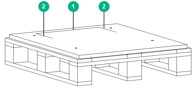

1.     Align the left, right, and rear edges of the chassis bottom with the left, right, and rear positioning lines respectively on the wooden pallet base. See Figure 13-3 for the wooden pallet base.
Figure 13-3 Wooden pallet base
(1) Rear positioning line
(2) Left and right positioning lines

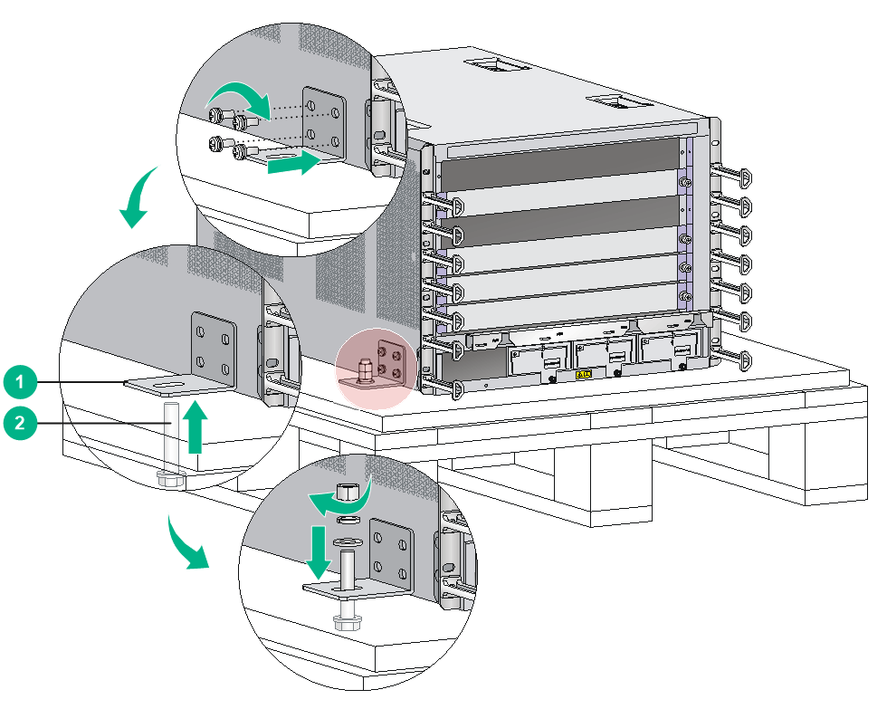

2.     Use screws to attach L-type brackets to the chassis.
3.     Align the mounting holes on the L-type brackets with the mounting holes on the wooden pallet base.
4.     Use bolts to attach the L-type brackets to the wooden pallet base, as shown in Figure 13-4:
a.     Attach a washer to a bolt.
b.     Insert the bolt through the mounting hole from the bottom of the wooden pallet base until the bolt reaches out the mounting hole from the top of the wooden pallet base.
c.     Attach another washer and two nuts to the bolt in sequence.
d.     Fasten the nuts.

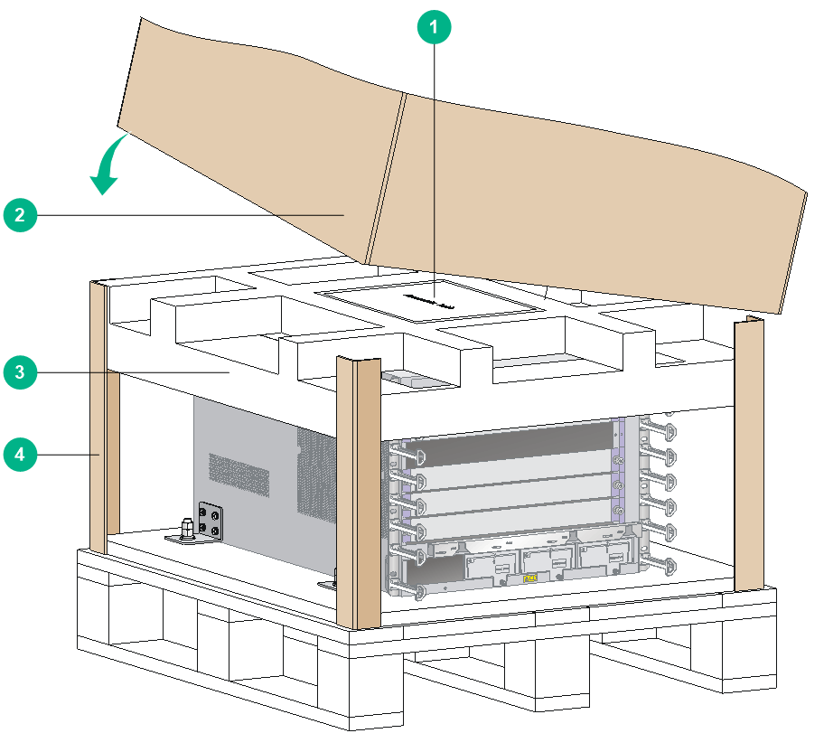

5.     Cover the chassis with the packing bag from the top down, and then tape the bag to the plastic cover of pallet base.
6.     Cover the foam cushion to the chassis top, and make sure the mounting brackets seat into the internal notches of the foam cushion. See Figure 13-5.
7.     Put the box of packed accessories into the notch of the foam cushion that is near to the rear end of the chassis, as shown in Figure 13-5.
8.     Erect one paper angle bead along each vertical edge of the chassis, and use the carton to cover the chassis from top down with the silkscreen side facing the front panel of the chassis.
9.     Cover the top cap to the carton. Skip this step for the S10504 and S10506.
Figure 13-5 Covering the chassis
(1) Box of packed accessories
(2) Carton
(3) Foam cushion
(4) Paper angle bead
