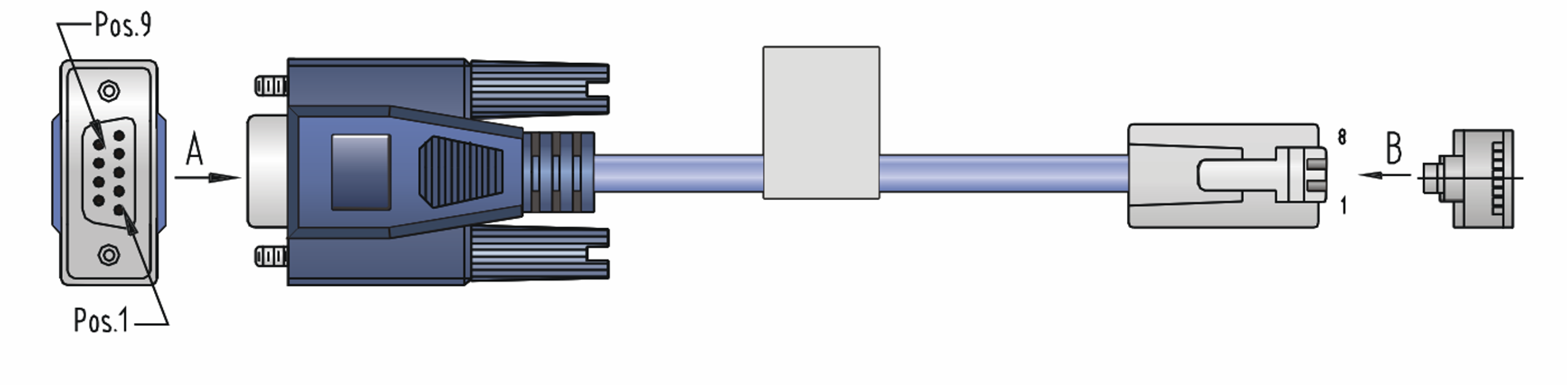

·     Console cable connecting the console port on a switch and the serial port on a terminal
The console cable has a crimped RJ-45 connector for connecting to the console port of the switch, and a DB-9 connector for connecting to the 9-core serial port on the terminal.
Figure 4-1 shows the console cable and Table 4-1 shows its pinouts.
Figure 4-1 Console cable connecting the serial port and the console port
Table 4-1 Pinouts for the console cable connecting the serial port and the console port

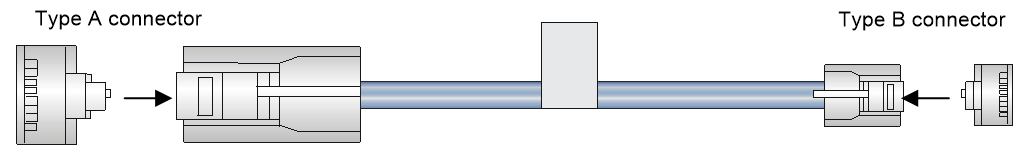

·     Console cable connecting the USB console port on a switch and the USB port on a terminal
The console cable has one mini-USB A/B connector for connecting to the USB console port on the switch and one USB A connector for connecting to the USB port on the terminal.
Figure 4-2 shows the console cable and Table 4-2 shows its pinouts.
Figure 4-2 Console cable connecting the USB port and the USB console port
Table 4-2 Pinouts for the console cable connecting the USB port and the USB console port

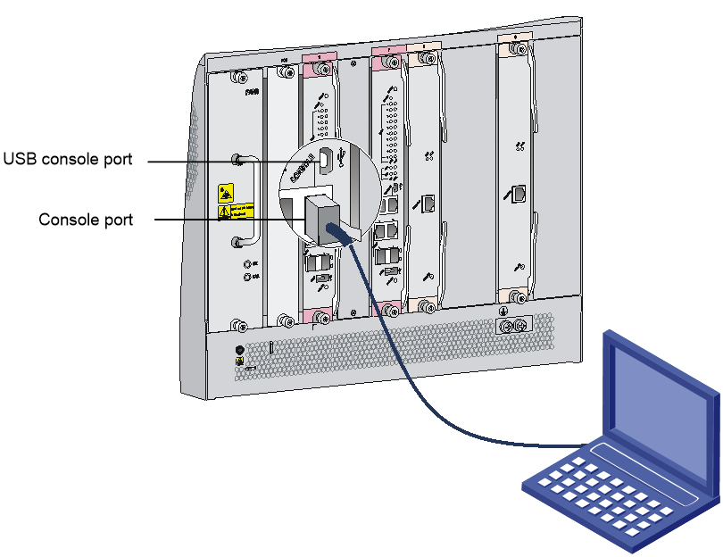

Connecting the console port to the terminal
IMPORTANT
IMPORTANT:
·     Identify the mark on the console and USB console port and make sure you are connecting to the correct port.
·     The serial ports on PCs do not support hot swapping. To connect a PC to an operating device, first connect the PC end. To disconnect a PC from an operating device, first disconnect the device end.
To connect the console cable to the console port:
1.     Connect the DB-9 connector of the console cable to the serial port on a PC or terminal.
2.     Connect the RJ-45 connector of the console cable to the console port on the MPU of the switch.
To connect the console cable to the USB console port:
1.     Connect the USB-A connector of the console cable to the USB port on a PC or terminal.
2.     Connect the mini-USB A/B connector of the console cable to the USB console port on the MPU of the switch.
Figure 4-3 Connecting the console port to the terminal

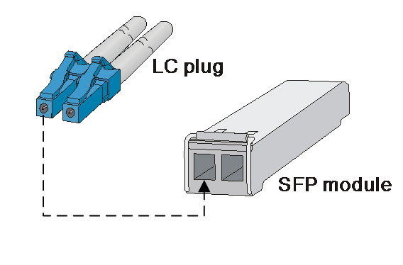

¡     For how to connect an LC connector, see Figure 4-4.

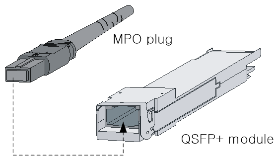

¡     For how to connect an MPO connector, see Figure 4-5.
4.     Examine the port LEDs for incorrect connection.
For more information about the LED status, see "Appendix C LEDs."
For the QSFP+ module, you do not need to differentiate between the transmitter (TX) and receiver (RX) ports. For other types of transceiver modules, the Tx port on one end must connect to the RX port on the other end.
Figure 4-4 Using an LC optical fiber connector to connect an SFP module
Figure 4-5 Using an MPO optical fiber connector to connect a QSFP module
