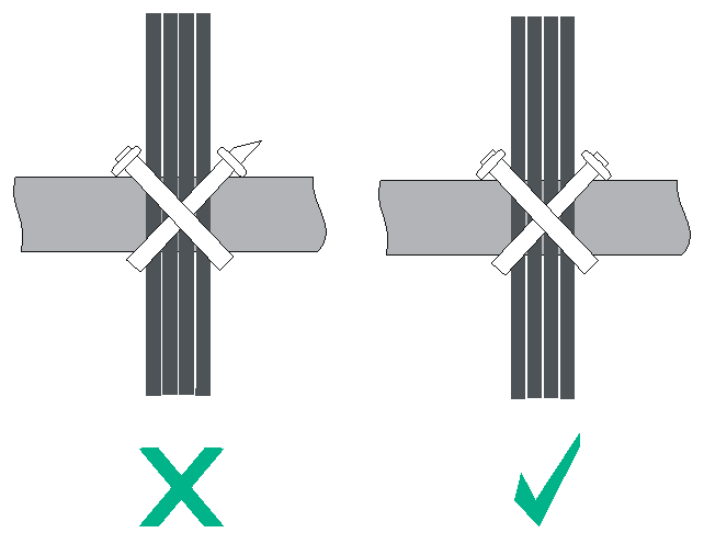

·     Use the correct ties to bind the cables. Do not bind cables with joined ties.
·     The distances between cable ties must be three to four times the cable diameter.

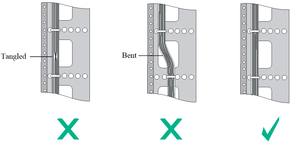

·     Bind and route the cables neatly inside the rack, and make sure the cables are not kinked or bent. Do not tie cables or bundles in a knot.
Figure 12-1 Correct and incorrect cable binding

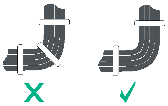

·     When you bend cables, bind cables as shown in Figure 12-2. To avoid cable core break due to excessive stress, do not tie up the cables in the bending area. The cable bend radius at connectors must be at least 5 times the cable diameter, and must be at least twice the cable diameter away from the connectors.
Figure 12-2 Binding the cables

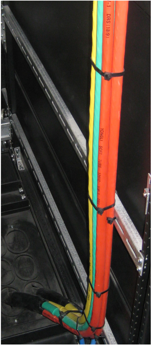

·     Fasten heavy or rigid power cords at the connectors to relief stress.
Cable management examples

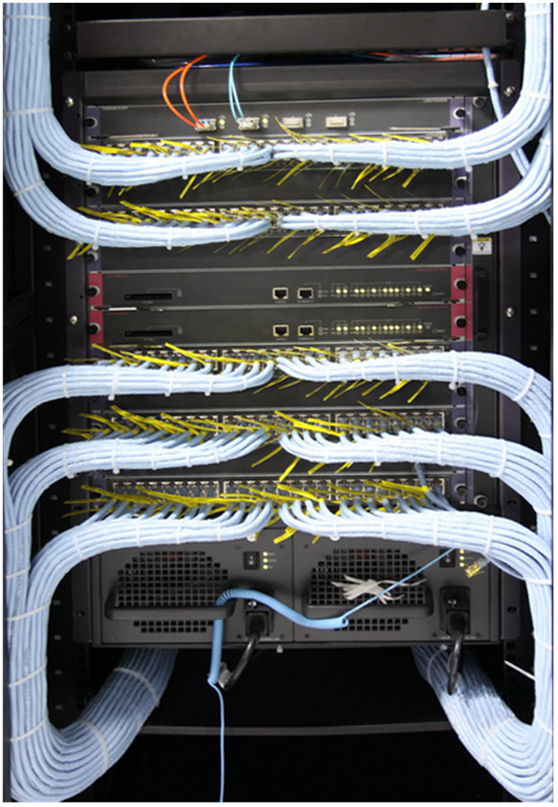

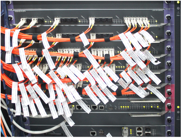

The devices in the following figures are for illustration only.
Figure 12-4 Network cable management
Figure 12-5 Optical fiber management
Use strapping tapes to carefully bind optical fibers. Avoid excessive force. For more information, see the instructions shipped with the strapping tapes.
Figure 12-6 Power cord management
