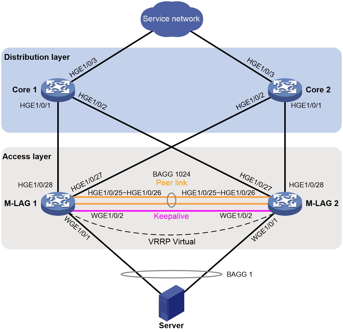

Example: Configuring M-LAG and VRRP
In the underlay network as shown in Figure 1, deploy M-LAG at the access layer to provide high availability and load balancing services for access devices. Deploy VRRP to provide gateway redundancy and ensure user service continuity. You can achieve the following purposes on the server through the VRRP gateway:
· To implement Layer 2 connectivity, the server can communicate with the service network at Layer 2 through the M-LAG system.
· Use the secondary IP addresses of the VLAN interfaces created on the M-LAG member devices to set up Layer 3 links between the server and the core devices, and configure BGP or OSPF to achieve Layer 3 connectivity.

Analysis
· Deploy link aggregation between M-LAG 1 and the server and between M-LAG 2 and the server.
· Deploy M-LAG for M-LAG 1 and M-LAG 2 at the access layer. Configure a VRRP group and specify its virtual IP address as the gateway address of the server.
· Core 1 and Core 2 are Layer 3 devices connected to the service network.
· Create VLAN interfaces on the M-LAG interfaces of the M-LAG member devices, and configure the primary and secondary IP addresses.
¡ Set up Layer 3 links between the M-LAG member devices and the core devices, and configure BGP between them to achieve Layer 3 connectivity.
¡ Use the secondary IP address of the VLAN interfaces created on the M-LAG interfaces to set up Layer 3 links to the server, and configure BGP or OSPF to achieve Layer 3 connectivity.

Deploying a VRRP gateway on the M-LAG member devices
M-LAG 1 |
M-LAG 2 |

Configuring the links between the M-LAG member devices and the Layer 3 virtualization server
M-LAG 2 |
Description |
Remarks |

Configuring the links between the M-LAG member devices and core devices
M-LAG 2 |
Description |
Remarks |

Configuring BGP between the M-LAG member devices and core devices
M-LAG 2 |
Description |
Remarks |

Configuring BGP between the M-LAG member devices and the server
Perform this task or the task in "Configuring OSPF between the M-LAG member devices and the server."
M-LAG 2 |
Perform this task or the task in "Configuring BGP between the M-LAG member devices and the server."
M-LAG 1 |
M-LAG 2 |
Description |

Configuring the links between the core devices and M-LAG member devices
Core 2 |
Description |
Remarks |

Configuring the links between the core devices and the service network
Core 2 |
Description |
Remarks |

Configuring BGP on the core devices for communication with the M-LAG member devices
Core 2 |
Description |
Remarks |

Traffic forwarding models
Underlay traffic forwarding models
Traffic type: Known IPv4 unicast, Layer 2 unicast, and unknown unicast.
Direction: South to north, north to south, east to west across the M-LAG system, and west to east across the M-LAG system.
Forwarding path: Server > M-LAG system > core devices > service network, service network > core devices > M-LAG system > server, M-LAG 2 > M-LAG 1, and M-LAG 1 > M-LAG 2.
Traffic simulation: Send packets by using the tester.

Verification commands
M-LAG 1 |
M-LAG 2 |
Description |
display m-lag summary |
Displays summary information about M-LAG interfaces. |
display m-lag system |
Displays the M-LAG system settings. |
display m-lag keepalive |
Displays M-LAG keepalive packet statistics. |
display m-lag role |
Displays M-LAG role information. |
display m-lag consistency { type1 | type2 } |
Displays information about the configuration consistency check done by M-LAG. |
display m-lag consistency-check status |
Displays the configuration consistency check status. |
display interface Bridge-Aggregation [ brief ] |
Displays information about aggregate interfaces. |
# Display the M-LAG system settings on M-LAG 1 to verify that M-LAG 1 and M-LAG 2 has established an M-LAG system.
[M-LAG1] display m-lag system
System information
Local system number: 1 Peer system number: 2
Local system MAC: 8465-6958-e2c4 Peer system MAC: 8465-6958-e2c4
Local system priority: 10000 Peer system priority: 10000
Local bridge MAC: 0068-5116-5101 Peer bridge MAC: 90e7-1062-5371
Local effective role: Primary Peer effective role: Secondary
Health level: 0
Standalone mode on split: Enabled
In standalone mode: No
System timer information
Timer State Value (s) Remaining time (s)
Auto recovery Disabled - -
Restore delay Disabled 300 -
Consistency-check delay Disabled 150 -
Standalone delay Disabled - -
Role to None delay Disabled 60 -
# View summary information about M-LAG interfaces on M-LAG 1.
[M-LAG1] display m-lag summary
Flags: A -- Aggregate interface down, B -- No peer M-LAG interface configured
C -- Configuration consistency check failed
Peer-link interface: BAGG1024
Peer-link interface state (cause): UP
Keepalive link state (cause): UP
M-LAG interface information
M-LAG IF M-LAG group Local state (cause) Peer state Remaining down time(s)
BAGG1 1 UP UP -
# View M-LAG role information on M-LAG 1.
[M-LAG1] display m-lag role
Effective role information
Factors Local Peer
Effective role Primary Secondary
Initial role Primary Secondary
MAD DOWN state No Yes
Health level 0 0
Role priority 10000 40000
Bridge MAC 0068-5116-5101 90e7-1062-5371
Effective role trigger: Peer link calculation
Effective role reason: MAD status
Configured role information
Factors Local Peer
Configured role Primary Secondary
# View information about the aggregate interfaces on M-LAG 1.
[M-LAG1] display interface Bridge-Aggregation brief
Brief information on interfaces in bridge mode:
Link: ADM - administratively down; Stby - standby
Speed: (a) - auto
Duplex: (a)/A - auto; H - half; F - full
Type: A - access; T - trunk; H - hybrid
Interface Link Speed Duplex Type PVID Description
BAGG1 UP 25G(a) F(a) T 100
BAGG1024 UP 200G(a) F(a) T 1
