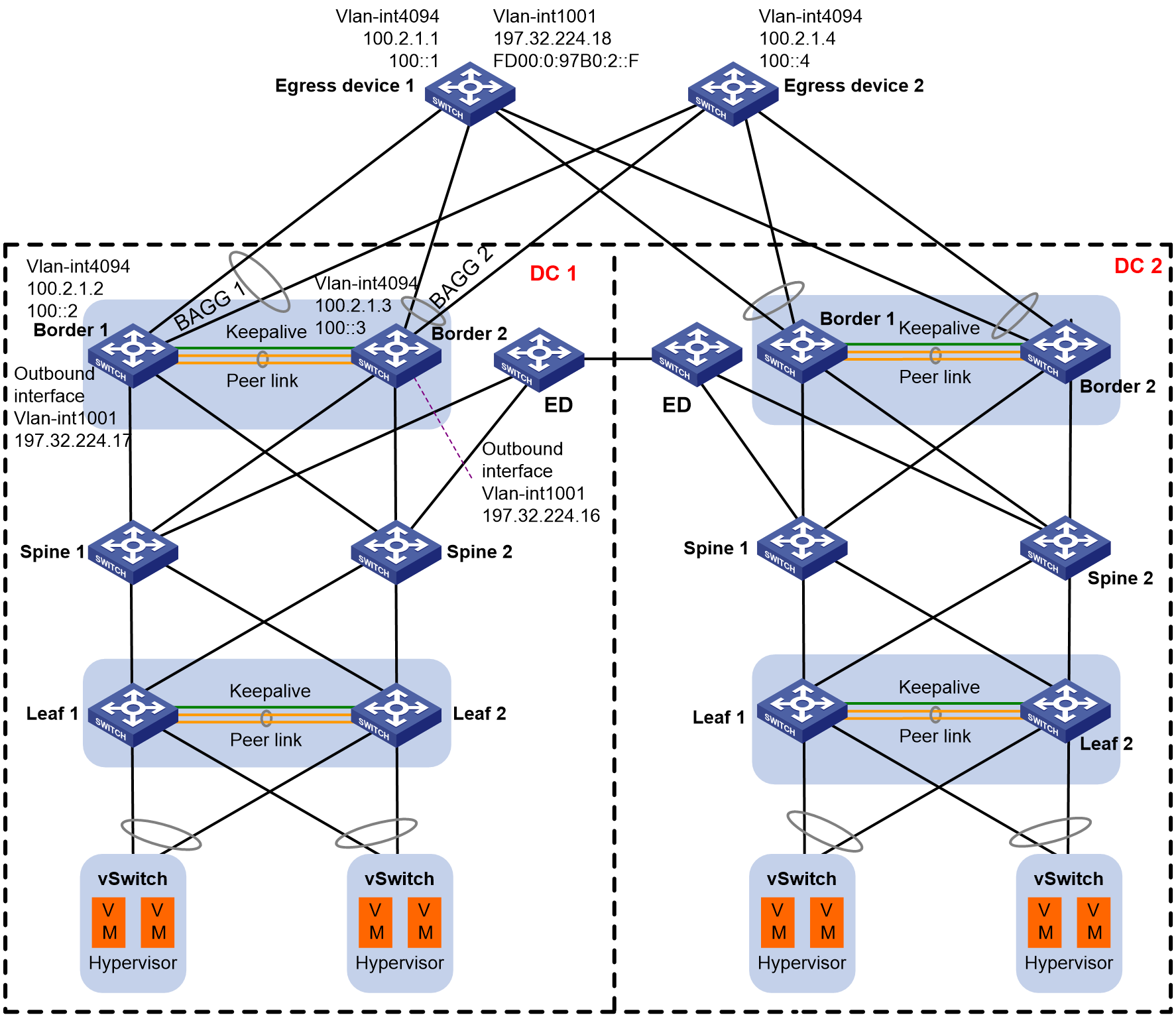

Example: Using multiple M-LAG interfaces on the border devices as the outbound interfaces to external networks
As shown in Figure 1, two DCs adopt the EVPN+M-LAG networking, and they are interconnected through the VXLAN-DCI tunnel established on ED devices. DC 2 acts as the backup for DC 1. Configure static routes on the border devices to communicate with the external networks. The border devices in DC 1 are connected to different uplink egress devices through multiple M-LAG interfaces. Egress device 1 and egress device 2 are connected to different external networks.

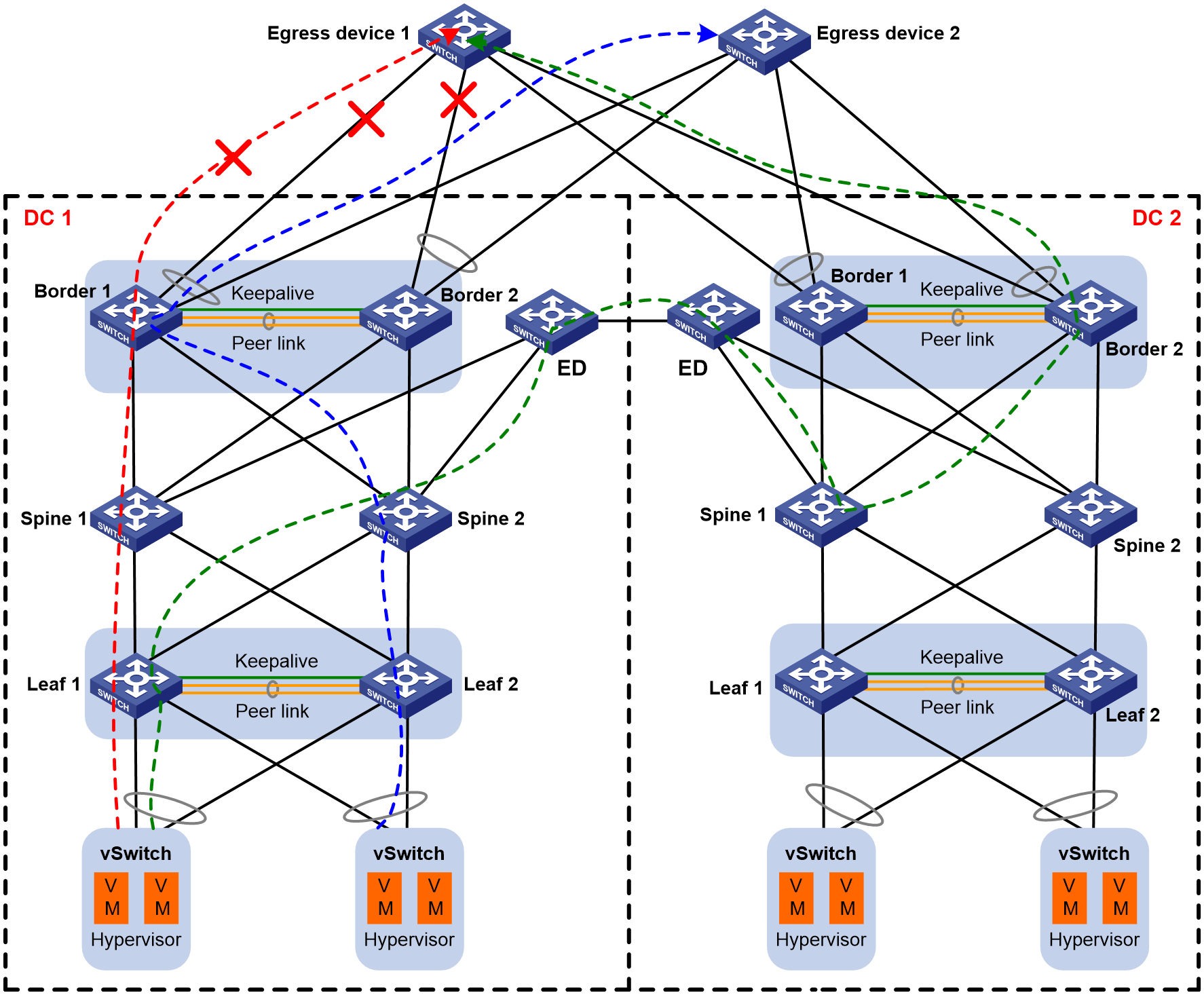

When one of the following situations occurs in DC 1, make sure traffic can switch over to the border devices in DC 2:
· For the two border devices in DC 1, all member ports of an M-LAG interface go down. This situation requires switchover of only the traffic on the faulty M-LAG interface to the backup DC. Other traffic do not require switchover.
· All spine device-attached ports on the two border devices go down.
· Both border devices become faulty.
Analysis
The border device has multiple M-LAG interfaces. Connect each M-LAG interface to an external network. When the same M-LAG interface on the two border devices fails, only the outbound traffic on the faulty M-LAG interface requires switchover. Other traffic do not require switchover. Do not shut down the border device interfaces attached to the spine devices. If you shut down such interfaces, all outbound traffic will be switched over.
To meet these requirements, configure collaboration between NQA, Track, and default static routes (IPv4 and IPv6) as follows:
· Configure a default static route on the border device, with the IP address of VLAN-interface 1001 as the next hop.
· Configure an ICMP-echo NQA operation to detect the connectivity between the border device and egress device.
· Configure a track entry to associate the NQA operation with the static route. When NQA detects a connection failure between the border device and the egress device, the static route is withdrawn.

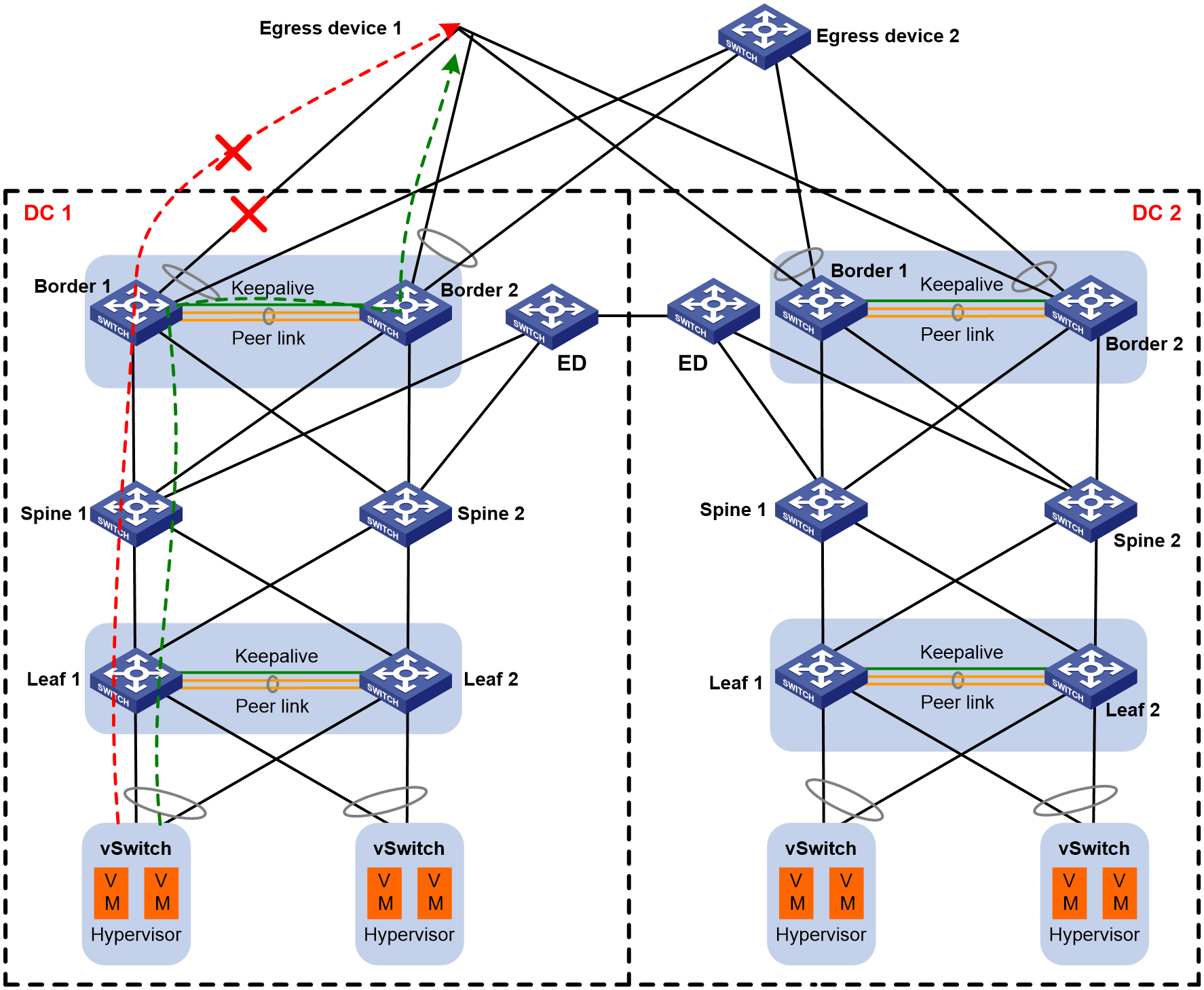

When a member port of an M-LAG interface on Border 1 goes down and the corresponding member port of the M-LAG interface on Border 2 is up, ICMP packets can go through the peer link. NQA will not trigger track entry state change. When the physical member ports of M-LAG interfaces on both border devices go down, NQA on the border devices can detect failure of the connections to the egress device. Track will then notify the devices to withdraw the static routes on the M-LAG interfaces. The route information change will be synchronized to the remote leaf devices. The remote leaf devices will not forward outbound traffic to this group of border devices. Traffic on other M-LAG interfaces on the border devices will not be affected because they are still in up state.

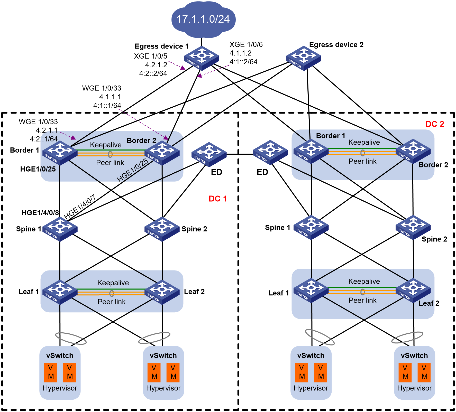

This example describes the configuration for traffic switchover upon failures when the border devices use multiple M-LAG interfaces as the outbound interfaces to the external network. The settings include VLAN-interface 4094 for the failover link, as well as collaboration between NQA, Track, and default static routes. The settings of EVPN, VXLAN, and data center interconnection are omitted.

Verifying failure recovery
Shut down the M-LAG member port on one border device (Border 1, for example). Traffic can be forwarded through the peer link, the track entry state is Positive, and the default static route is still active. VLAN-interface 1001 and VLAN-interface 4094 on the egress device can learn the ARP and ND entries from the M-LAG interface, and no packet loss occurs.
As shown in Figure 2, the traffic from the server to the external network is forwarded through the peer link to the egress device.

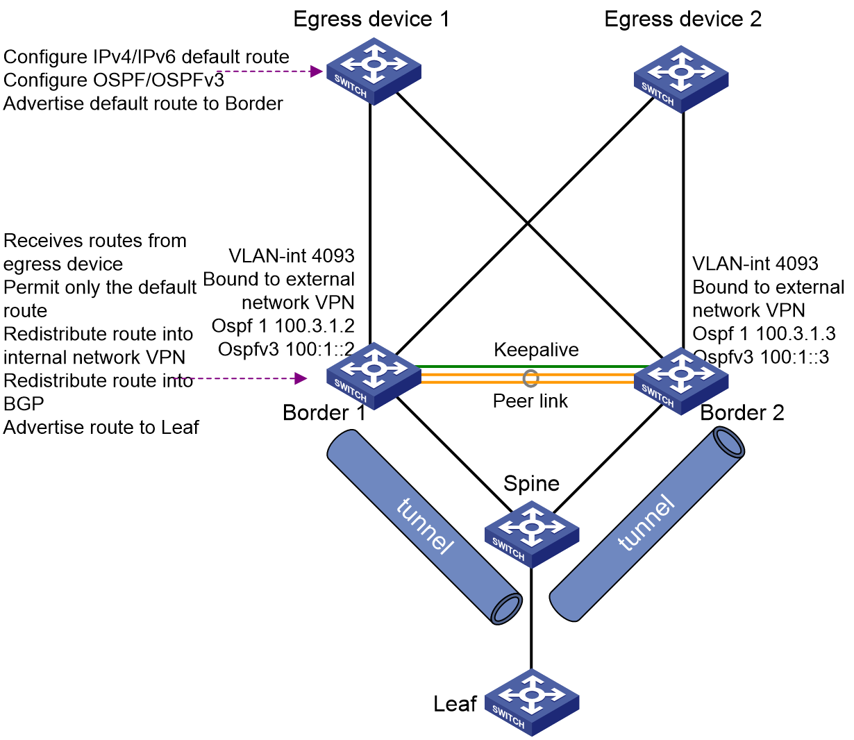

As shown in Figure 3, shut down all member ports of BAGG1 on both Border 1 and Border 2 in DC 1. The static route marked with a red line is withdrawn (with BAGG1 on Border 1 and Border 2 as the output interface, and IP address of VLAN-interface 1001 on egress device 1 as the next hop). The changed route information is then synchronized to the leaf devices. The outbound traffic the previously forwarded through BAGG1 on Border 1 and Border 2 will be switched over to the border device in DC 2 (the traffic path is marked with a green line).
The interface status of BAGG2 on Border 1 and Border 2 in DC 1 and the default static route are not changed. The path (marked with a blue line) is not changed for outbound traffic forwarded through BAGG2 on Border 1 and Border 2.
Figure 3 Failure recovery the M-LAG member ports on both Border 1 and Border 2
Example: Connecting the border devices to the external network with multiple Layer 3 Ethernet interfaces
As shown in Figure 4, two data centers adopt the EVPN+M-LAG networking, and they are interconnected through the VXLAN-DCI tunnel established between ED devices. DC 2 acts as the backup for DC 1. The border devices are connected to different uplink egress devices through multiple Layer 3 Ethernet interfaces. Egress device 1 and egress device 2 are connected to different external networks.
· On the two border devices in DC 1, both Layer 3 Ethernet interfaces connected to the same egress device go down.
Analysis
Route setup for northbound traffic
1. Configure a default IPv4/IPv6 static route (with the ip route-static 0.0.0.0 0 NULL0 command) on the egress device. Configure OSPF/OSPFv3 to advertise the default static route to the border device. The border device will forward traffic matching the default route through the Layer 3 interface connected to the egress device.
In this solution, the default static route is not deployed to the border device. If the default static route is deployed to the border device, the IP address of the interface on the border device directly connected to the egress device is used as the next hop. When the direct link fails, the next hop no longer exists, and the default static route becomes invalid and is withdrawn. Then the traffic sent by the leaf device can enter the border device through the M-LAG group IP address. With a private network failover link configured, traffic can be forwarded through the peer link. However, such a situation has long convergence time and is not as expected.
2. Configure a routing policy on the border device to deny all routes except the default route received from the egress device.
This configuration saves route resources and prevents the border device from receiving other unnecessary static routes from the egress device.
3. The border device redistributes the default route to the internal network VPN and then into BGP. Then it advertises the route to the leaf device.
4. The leaf device accepts only the default route. Northbound traffic will be forwarded through the default route.
Figure 5 Route setup for northbound traffic
Verify recovery upon failure of a single border device or both border devices.
As shown in Figure 6, shut down the outbound interface to the external network on Border 1 and Border 2 separately. The traffic can be forwarded through the peer link. From the routing table, you can see that the next hop of the default route points to VLAN-interface 4093 of the failover link.
[Border] display ip routing-table vpn external_vpn_1001 0.0.0.0
Summary count : 2
Destination/Mask Proto Pre Cost NextHop Interface
0.0.0.0/0 O_ASE2 150 1 100.3.1.2 Vlan4093
0.0.0.0/32 Direct 0 0 127.0.0.1 InLoop0
Figure 6 Layer 3 Ethernet interface failure on a single border device
As shown in Figure 7, shut down the outbound interfaces to the external network on both Border 1 and Border 2. The traffic is completely switched to the path marked in green. Border 1 and Border 2 no longer receive the traffic from this group marked in red. On the remote leaf device, you can see that the default static route for this group has been withdrawn. Outbound traffic in the other group and the associated default static route are not affected.
Figure 7 Layer 3 Ethernet interface failure on both border devices
