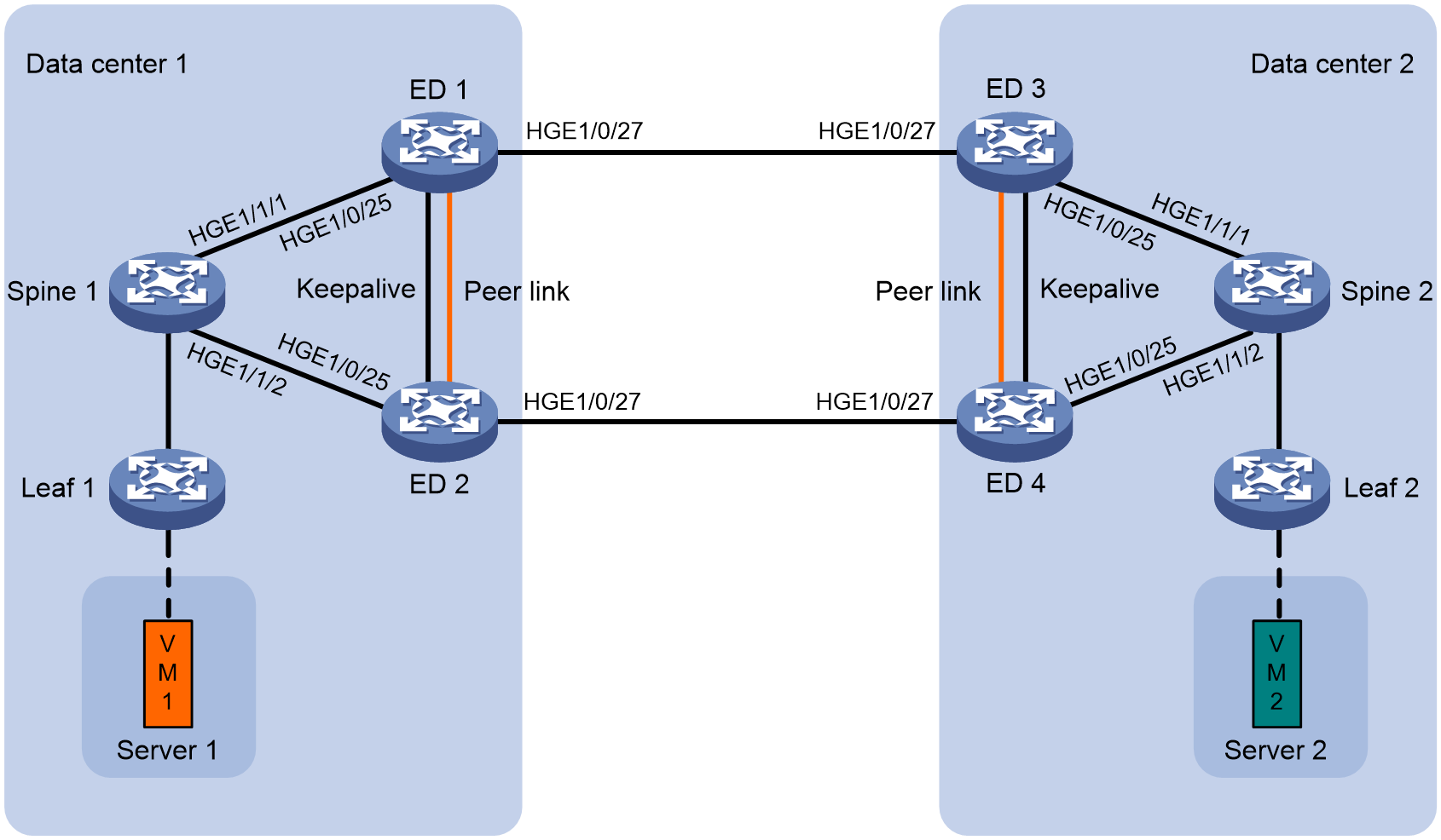

Example: Configuring M-LAG and DCI
As shown in Figure 1:
· The two EDs in each data center (DC) form an M-LAG system. The interfaces connected the EDs in different DCs operate in Layer 3 mode.
· Run a dynamic routing protocol on the EDs. In this example, OSPF is used.
· All the EDs are connected to spine devices.
NOTE: In this example, the same tenant uses the same VXLAN ID and L3 VXLAN ID for inter-DC communication. |

Applicable product matrix
IMPORTANT: In addition to running an applicable software version, you must also install the most recent patch, if any. |
Role |
Device |
Software version |
ED |
S6805, S6825, S6850, and S9850 |
R6710 |
S6800 and S6860 |
R6710 |
S12500X-AF and S6890 |
R2825 |
S12500R |
R5210 |
S12500G-AF |
R7625 |
S9820-64H and S9820-8C |
Not supported |
S6812 and S6813 |
Not supported |
SDN controller |
N/A |
E6103 or higher versions NOTE: Before you use a higher version than E6103, contact H3C support to verify version compatibility. |
· You must configure the same M-LAG system MAC address for the M-LAG member devices in an M-LAG system and configure different M-LAG system MAC addresses for the M-LAG member devices in different M-LAG systems. Make sure each M-LAG system has a unique M-LAG system MAC address in the network.
· This example covers the settings on the EDs. For more information about configuring the spine and leaf devices, see the configuration guides for the devices.
· Before you perform the tasks in this example, perform the following tasks:
a. Configure IP addresses and masks for interfaces.
b. Configure routing protocols on the transport network to ensure that the devices have routes to reach one another.
· The spine in each DC establishes IBGP peer relationship with the ED and leaf devices in the local DC. The EDs in one DC establish EBGP peer relationship with the EDs in the other DC.
Configuring EDs

Manual |
On the DCI interface, enable OSPF to advertise the maximum link cost to neighbors within 60 seconds. |
N/A |
quit |
quit |
N/A |
N/A |
N/A |

Configuring EDs in data center 2
ED 3 (S6850) |
ED 4 (S6850) |
Configuration method |
Description |
Remarks |
m-lag system-mac 3-3-3 |
Manual or controller-based |
Configure the M-LAG system MAC address. |
For the M-LAG member devices to be identified as one M-LAG system, you must configure the same M-LAG system MAC address on them. |

Overlay traffic forwarding models
Overlay traffic characteristics
The following table describes overlay traffic characteristics:
Parameter |
Description |
No. |
Overlay traffic number in the format of xxx, starting from 001. |
Traffic type |
Traffic type, which is IPv4 or IPv6 known unicast. |
Direction |
Traffic direction. Traffic can be forwarded from south to north across EDs or from north to south across EDs. |
Forwarding path |
List of nodes that the traffic passes through. |
Traffic simulation |
Simulation method used in the test. A tester is simulated as a server to transmit traffic. The following types of traffic is injected: · Server A sends 10K ARP or ND request traffic to Server B. · Server B replies to the ARP or ND request traffic of Server A. The traffic amount is also 10K. · Traffic is sent between the servers and between the servers and the external network. The source port of each flow changes 100th times. · 20K traffic is sent from each server to the external network through the border. |
Load |
Traffic load is light or heavy. If the number of flows is less than 1000, the load is light. If the number of flows is more than 1000, the load is heavy. |
Traffic direction to firewalls/LB |
Enter the method used to direct traffic to firewalls or LBs. In this example, no firewalls or LBs are deployed. |
Forwarding models
No. |
Traffic type |
Direction |
Forwarding path |
Load |
001 |
Known unicast/IPv4 |
DC 1 to DC 2 |
Server 1 > Leaf 1 > Spine 1 > ED 1 & ED 2 > ED 3 & ED 4 > Spine 2 > Leaf 2 > Server 2 |
Tester |
Light |
N/A |
002 |
Known unicast/IPv6 |
DC 1 to DC 2 |
Tester |
Light |
N/A |
003 |
DC 2 to DC 1 |
Server 2 > Leaf 2 > Spine 2 > ED 3 & ED 4 > ED 1 & ED 2 > Spine 1 > Leaf 1 > Server 1 |
Tester |
Light |
N/A |
004 |
DC 2 to DC 1 |
Tester |
Light |
N/A |
