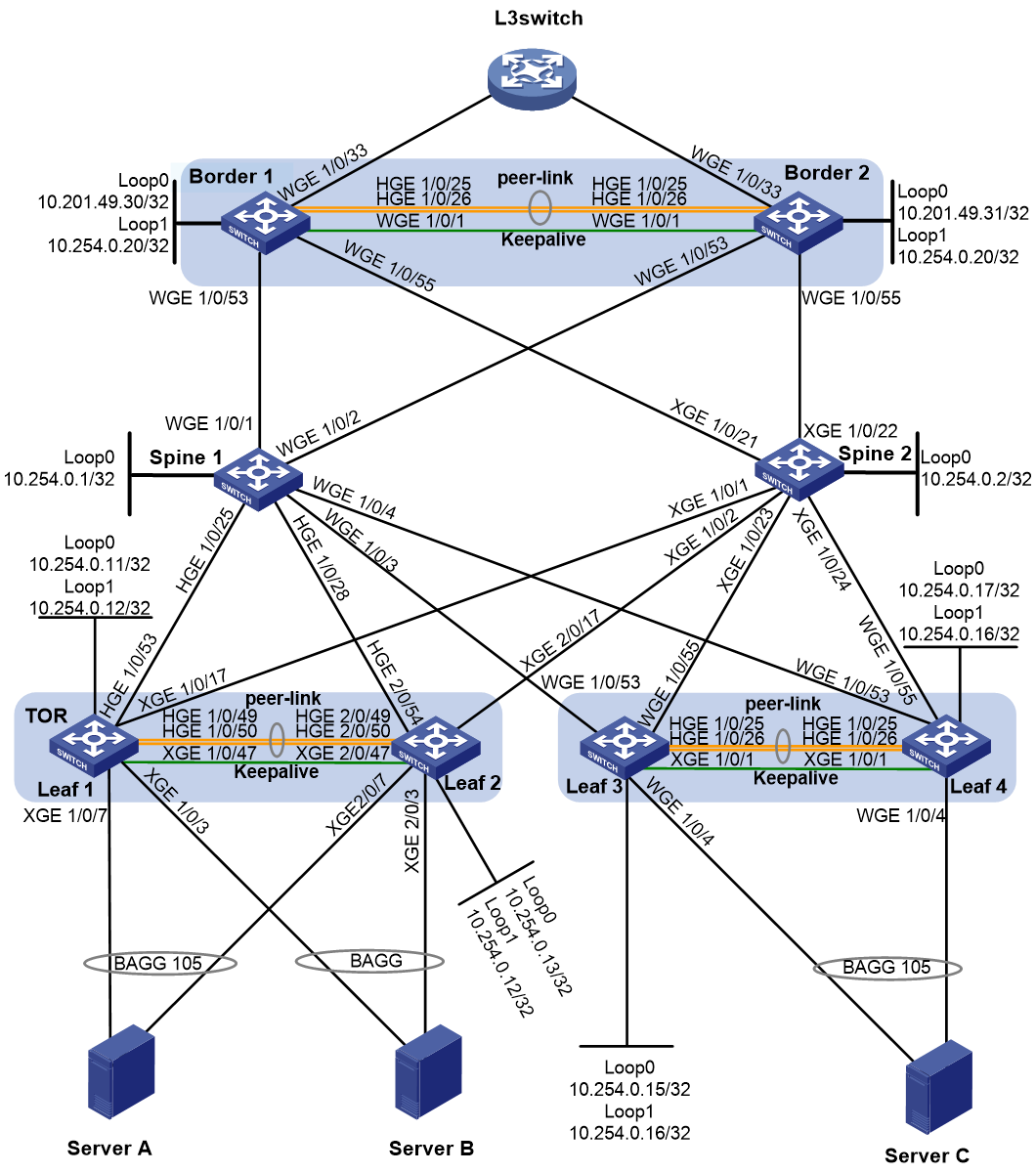

Example: Configuring M-LAG and EVPN distributed gateways (BGP for underlay routing)
As shown in Figure 1, deploy an M-LAG system at the border tier, and deploy two M-LAG systems at the leaf tier. Configure the network as follows:
· Configure Ethernet aggregate links as peer links.
· Set up one border M-LAG system with two switches, and configure the M-LAG system as the distributed gateway.
· Configure two switches as spine devices. Configure them as route reflectors to reflect BGP EVPN routes among border and leaf devices.
· Set up two leaf M-LAG systems, each containing two switches. Configure the leaf M-LAG systems as the EVPN access devices of network overlay (such as bare metal servers).
· Configure BGP as the underlay routing protocol.
Device |
Interface |
IP address |
Remarks |
Leaf 1 |
XGE1/0/7 |
N/A |
Member port of an M-LAG interface, interface with ACs configured. Connected to bare metal server A. |
XGE1/0/3 |
N/A |
Member port of an M-LAG interface, interface with ACs configured. Connected to bare metal server B. |
HGE1/0/49 |
N/A |
Member port of the peer-link interface. Connected to HGE2/0/49 on Leaf 2. |
HGE1/0/50 |
N/A |
Member port of the peer-link interface. Connected to HGE2/0/50 on Leaf 2. |
XGE1/0/47 |
172.16.0.1/30 |
Keepalive link Leaf 2: XGE2/0/47 |
HGE1/0/53 |
10.254.1.2/30 |
Spine 1: HGE1/0/25 |
XGE1/0/17 |
10.254.1.6/30 |
Spine 2: XGE1/0/1 |
Loopback0 |
10.254.0.11/32 |
VTEP IP address Connected to a BGP EVPN peer |
Loopback1 |
10.254.0.12/32 |
Virtual VTEP IP address. |
Vlan-interface100 |
10.1.1.1/30 |
Interface for east-west traffic forwarding. |
Leaf 2 |
XGE2/0/7 |
N/A |
Member port of an M-LAG interface, interface with ACs configured. Connected to bare metal server A |
XGE2/0/3 |
N/A |
Member port of an M-LAG interface, interface with ACs configured. Connected to bare metal server B |
HGE2/0/49 |
N/A |
Member port of the peer-link interface. Leaf 1: HGE1/0/49 |
HGE2/0/50 |
N/A |
Member port of the peer-link interface. Leaf 1: HGE1/0/50 |
XGE2/0/47 |
172.16.0.2/30 |
Keepalive link Leaf 1: XGE1/0/47 |
HGE2/0/54 |
10.254.1.10/30 |
Spine 1: HGE1/0/28 |
XGE2/0/17 |
10.254.1.14/30 |
Spine 2: XGE1/0/2 |
Loopback0 |
10.254.0.13/32 |
VTEP IP address Connected to a BGP EVPN peer. |
Loopback1 |
10.254.0.12/32 |
Vlan-interface100 |
10.1.1.2/30 |
Leaf 3 |
WGE1/0/4 |
N/A |
Member port of an M-LAG interface, interface with ACs configured. Server C |
HGE1/0/25 |
N/A |
Member port of the peer-link interface. Leaf 4: HGE1/0/25 |
HGE1/0/26 |
N/A |
Member port of the peer-link interface. Leaf 4: HGE1/0/26 |
WGE1/0/1 |
173.16.1.1/30 |
Keepalive link Leaf 4: WGE1/0/1 |
WGE1/0/53 |
10.254.2.2/30 |
Spine 1: WGE1/0/3 |
WGE1/0/55 |
10.254.2.6/30 |
Spine 2: XGE1/0/23 |
Loopback0 |
10.254.0.15/32 |
Loopback1 |
10.254.0.16/32 |
Virtual VTEP IP address |
Vlan-interface100 |
10.1.2.1/30 |
Leaf 4 |
WGE1/0/4 |
N/A |
Member port of an M-LAG interface, interface with ACs configured. Bare metal server C |
HGE1/0/25 |
N/A |
Member port of the peer-link interface. Leaf 3: HGE1/0/25 |
HGE1/0/26 |
N/A |
Member port of the peer-link interface. Leaf 3: HGE1/0/26 |
WGE1/0/1 |
173.16.1.2/30 |
Keepalive link Leaf 3: WGE1/0/1 |
WGE1/0/53 |
10.254.2.10/30 |
Spine 1: WGE1/0/4 |
WGE1/0/55 |
10.254.2.14/30 |
Spine 2: XGE1/0/24 |
Loopback0 |
10.254.0.17/32 |
Loopback1 |
10.254.0.16/32 |
Vlan-interface100 |
10.1.2.2/30 |
Spine 1 |
HGE1/0/25 |
10.254.1.1/30 |
Leaf 1: HGE1/0/53 |
HGE1/0/28 |
10.254.1.9/30 |
Leaf 2: HGE2/0/54 |
WGE1/0/3 |
10.254.2.1/30 |
Leaf 3: WGE1/0/53 |
WGE1/0/4 |
10.254.2.9/30 |
Leaf 4: WGE1/0/53 |
WGE1/0/1 |
10.254.7.1/30 |
Border 1: WGE1/0/53 |
WGE1/0/2 |
10.254.7.5/30 |
Border 2: WGE1/0/53 |
LoopBack0 |
10.254.0.1/32 |
Spine 2 |
XGE1/0/1 |
10.254.1.5/30 |
Leaf 1: XGE1/0/17 |
XGE1/0/2 |
10.254.1.13/30 |
Leaf 2: XGE2/0/17 |
XGE1/0/23 |
10.254.2.5/30 |
Leaf 3: WGE1/0/55 |
XGE1/0/24 |
10.254.2.13/30 |
Leaf 4: WGE1/0/55 |
XGE1/0/21 |
10.254.7.21/30 |
Border 1: WGE1/0/55 |
XGE1/0/22 |
10.254.7.25/30 |
Border 2: WGE1/0/55 |
LoopBack0 |
10.254.0.2/32 |
Border1 |
WGE1/0/53 |
10.254.7.2/30 |
Spine 1: WGE1/0/1 |
WGE1/0/55 |
10.254.7.22/30 |
Spine 2: XGE1/0/21 |
HGE1/0/25 |
N/A |
Member port of the peer-link interface. Border 2: HGE1/0/25 |
HGE1/0/26 |
N/A |
Member port of the peer-link interface. Border 2: HGE1/0/26 |
WGE1/0/1 |
174.16.2.1/30 |
Keepalive link Border2: WGE1/0/1 |
WGE1/0/33 |
192.101.1.1/31 |
L3switch |
LoopBack0 |
10.201.49.30/32 |
ED IP |
LoopBack1 |
10.254.0.20/32 |
Virtual ED IP |
Vlan-interface100 |
100.1.1.1/31 |
Border2 |
WGE1/0/53 |
10.254.7.6/30 |
Spine 1: WGE1/0/2 |
WGE1/0/55 |
10.254.7.26/30 |
Spine 2: XGE1/0/22 |
HGE1/0/25 |
N/A |
HGE1/0/26 |
N/A |
WGE1/0/1 |
174.16.2.2/30 |
WGE1/0/33 |
192.101.1.3/31 |
L3 switch |
LoopBack0 |
10.201.49.31/32 |
ED IP |
LoopBack1 |
10.254.0.20/32 |
Virtual ED IP |
Vlan-interface100 |
100.1.1.2/31 |

Configuring an underlay BGP instance
Leaf 1 |
Leaf 2 |
Configuration method |
Description |
Purpose |
Remarks |
router id 10.254.0.11 |
router id 10.254.0.13 |
Manual |
Configure the IP address of Loopback 0 as the router ID. |
Configure the global router ID. |
N/A |
bgp 65001 |
bgp 65002 |
Manual |
Enter BGP view. |
N/A |
N/A |
bgp update-delay on-startup 100 |
Manual |
Configure BGP to delay sending route updates on reboot. |
Avoid forwarding issues during fallback after a ToR switch restarts. |
N/A |
router-id 10.254.0.11 |
router-id 10.254.0.13 |
Manual |
Configure a router ID for the BGP instance. |
To run BGP in a BGP instance, you must configure a router ID for the BGP instance. If you do not configure a router ID for the BGP instance, it uses the global router ID. |
N/A |
group spines internal |
Manual |
Create an IBGP peer group. |
N/A |
N/A |
peer spines route-update-interval 0 |
Manual |
Specify an interval for sending the same update to the peer group. |
Enable the device to immediately send update to the peer group upon route changes to speed up route convergence after an M-LAG primary/secondary switchover occurs. |
Execute this command only for IBGP peers. |
peer 10.254.1.1 group spines |
peer 10.254.1.9 group spines |
Manual |
Add a spine device to the peer group. |
N/A |
N/A |
peer 10.254.1.5 group spines |
peer 10.254.1.13 group spines |
Manual |
N/A |
N/A |
peer 10.1.1.2 as-number 65002 |
peer 10.1.1.1 as-number 65001 |
Manual |
Configure an EBGP peer. |
N/A |
N/A |
address-family ipv4 unicast |
Manual |
Enter IPv4 unicast address family view. |
N/A |
N/A |
balance 8 |
balance 8 |
Manual |
Set the maximum number of BGP ECMP routes for load balancing. |
N/A |
N/A |
import-route direct |
Manual |
Configure BGP to redistribute direct routes. |
N/A |
N/A |
peer spines enable |
Manual |
Enable BGP to exchange routing information with a peer or peer group. |
N/A |
N/A |
peer 10.1.1.2 enable |
peer 10.1.1.1 enable |
Manual |
N/A |
N/A |
quit |
quit |
Manual |
Return to IPv4 address family view |
N/A |
N/A |
quit |
quit |
Manual |
Return to system view. |
N/A |
N/A |
interface LoopBack0 |
Manual |
Create Loopback 0 and enter its view. |
N/A |
N/A |
ip address 10.254.0.11 255.255.255.255 |
ip address 10.254.0.13 255.255.255.255 |
Manual |
Assign an IP address to the interface. |
VTEP IP |
N/A |
quit |
quit |
Manual |
N/A |
N/A |
interface LoopBack1 |
Manual |
N/A |
N/A |
ip address 10.254.0.12 255.255.255.255 |
Manual |
Virtual VTEP IP |
N/A |
quit |
quit |
Manual |
N/A |
N/A |
vlan 10 |
vlan 10 |
Manual |
Create a VLAN. |
Create the VLAN for communicating with the M-LAG peer. |
N/A |
interface Vlan-interface10 |
Manual |
Create VLAN-interface 10. |
Create the VLAN interface for the VLAN used for communicating with the M-LAG peer. When the uplink interface fails, the device forwards the packets received on the M-LAG interfaces to the M-LAG peer for Layer 3 forwarding. |
N/A |
ip address 10.1.1.1 255.255.255.0 |
ip address 10.1.1.2 255.255.255.0 |
Manual |
N/A |
N/A |
quit |
quit |
Manual |
N/A |
N/A |
Configuring the links towards the spine tier
Leaf 1 |
Leaf 2 |
Description |
Purpose |
Remarks |
interface HundredGigE1/0/53 |
interface HundredGigE2/0/54 |
Manual |
Configure the interface connected to Spine 1. |
N/A |
N/A |
port link-mode route |
Manual |
Configure the Ethernet interface to work in Layer 3 mode. |
N/A |
N/A |
ip address 10.254.1.2 255.255.255.252 |
ip address 10.254.1.10 255.255.255.252 |
Manual |
N/A |
N/A |
undo mac-address static source-check enable |
Manual |
Disable static source check. |
To correctly forward traffic sourced from the MAC address of a VLAN interface, you must disable the static source check feature on the Layer 2 interfaces in the VLAN. |
N/A |
interface Ten-GigabitEthernet 1/0/17 |
interface Ten-GigabitEthernet 2/0/17 |
Manual |
Configure the interface connecting to Spine 2. |
N/A |
N/A |
Manual |
Configure the interface as a Layer 3 interface. |
N/A |
N/A |
ip address 10.254.1.6 255.255.255.252 |
ip address 10.254.1.14 255.255.255.252 |
Manual |
N/A |
N/A |
Manual |
N/A |
Configuring L2VPN
Leaf 1 |
Leaf 2 |
Description |
Purpose |
Remarks |
l2vpn enable |
l2vpn enable |
Manual |
Enable L2VPN. |
N/A |
N/A |
vxlan default-decapsulation source interface LoopBack0 |
Manual |
Enable default VXLAN decapsulation on the packets destined for the VTEP IP address. |
Execute this command in unidirectional tunnel scenarios. |
This command takes effect only when the specified interface has an IP address. |
vxlan tunnel mac-learning disable |
Manual |
Disable remote-MAC address learning. |
Execute this command if a controller issues forwarding entries to the device. |
N/A |
vxlan tunnel arp-learning disable |
Manual |
Disable remote ARP learning. |
N/A |
mac-address timer aging 3600 |
Manual |
Set the aging time to 3600 seconds for dynamic MAC address entries. |
Increase this timer to ensure forwarding entry synchronization is finished in time after the M-LAG peer restarts. |
This setting must be consistent on the M-LAG member devices in the same M-LAG system. |
NOTE: If you use two border devices to set up an M-LAG system and BMs in bond1 mode need to communicate with the external network, unidirectional tunnels exist between the ToR switches and SDN gateway. Typically, unidirectional tunnels are set up when a ToR switch is disconnected from the controller or new BMs come online. In this scenario, an online ToR switch advertises routes that contain its real IP address. The SDN will set up a tunnel to that real IP address, while the ToR switch uses the virtual VTEP IP address for tunnel setup. For the ToR switches to decapsulate the packets sent by the SDN gateway, enable default VXLAN decapsulation on the ToR switches. |
Configuring M-LAG
Leaf 1 |
Leaf 2 |
Description |
Purpose |
Remarks |
ip vpn-instance mgmt |
Manual |
Create a VPN for the management Ethernet interface. |
N/A |
This command is optional. |
interface M-GigabitEthernet 0/0/0 |
Manual |
Enter the view of the management Ethernet interface. |
N/A |
N/A |
ip binding vpn-instance mgmt |
Manual |
Assign the management Ethernet interface to the VPN. |
N/A |
Assign the management Ethernet interface to a VPN as needed. |
ip address 101.0.186.91 255.255.255.0 |
ip address 101.0.186.90 255.255.255.0 |
Manual |
Configure a management IP address. |
N/A |
N/A |
quit |
quit |
Manual |
N/A |
N/A |
l2vpn m-lag peer-link ac-match-rule vxlan-mapping |
Manual |
Enable the device to create frame match criteria based on VXLAN IDs for the dynamic ACs on the Ethernet aggregate link (peer link). |
If two site-facing ACs on different interfaces have the same frame match criteria but different VSI mappings, the dynamic ACs created for the site-facing ACs will conflict with each other. Execute this command to resolve this issue. |
N/A |
evpn m-lag group 10.254.0.12 |
Manual |
Enable EVPN M-LAG and specify the virtual VTEP address. |
N/A |
You must specify the same virtual VTEP address on both VTEPs in the same M-LAG system. |
evpn m-lag local 10.254.0.11 remote 10.254.0.13 |
evpn m-lag local 10.254.0.13 remote 10.254.0.11 |
Manual |
Specify the IP addresses of the VTEPs in an M-LAG system. |
After you configure this command, each VTEP in an M-LAG system changes the next hop of the routes for single-armed ACs to its local VTEP IP address when advertising the routes. This ensures that the traffic of a single-armed AC is forwarded to its attached VTEP. |
When you execute this command, make sure the IP address of the local VTEP belongs to a local interface. Make sure the local VTEP IP address and peer VTEP IP address are reversed on the VTEPs in an M-LAG system. |
evpn global-mac 0000-0005-0001 |
Manual |
Configure the EVPN global MAC address. |
N/A |
You must specify the same EVPN global MAC address on the devices in the same M-LAG system. Do not use a reserved MAC address as the EVPN global MAC address. |
m-lag system-mac 0001-0001-0002 |
Manual |
Configure the M-LAG system MAC address. |
Configure the settings required for establishing the M-LAG system. |
The M-LAG system MAC address uniquely identifies the M-LAG system on the network. For the M-LAG member devices to be identified as one M-LAG system, you must configure the same M-LAG system MAC address on them. |
m-lag system-number 1 |
m-lag system-number 2 |
Manual |
Set the M-LAG system number. |
You must assign different M-LAG system numbers to the M-LAG member devices in an M-LAG system. |
m-lag system-priority 123 |
Manual |
Set the M-LAG system priority. |
N/A |
This command is optional. You must configure the same M-LAG system priority for the M-LAG member devices in an M-LAG system. The default M-LAG system priority is 32768. The smaller the priority value, the higher the priority. |
m-lag keepalive ip destination 172.16.0.2 source 172.16.0.1 |
m-lag keepalive ip destination 172.16.0.1 source 172.16.0.2 |
Manual |
Configure M-LAG keepalive packet parameters. |
N/A |
You do not need to specify a VPN instance if the interface does not belong to any VPN instance. If the interface that owns the source IP address is not excluded from the M-LAG MAD DOWN action, exclude it from that action. |
m-lag mad default-action none |
Manual |
Set the default M-LAG MAD action to NONE. |
N/A |
N/A |
m-lag mad include interface HundredGigE1/0/53 |
m-lag mad include interface HundredGigE2/0/52 |
Manual |
Enable M-LAG to shut down an interface when the M-LAG system splits. |
Shut down the interface upon an M-LAG system split to reduce the fallback duration after a device restart. |
Execute this command on the uplink interface attached to a spine device. |
m-lag mad include interface Ten-GigabitEthernet 1/0/17 |
m-lag mad include interface Ten-GigabitEthernet 2/0/17 |
Manual |
m-lag restore-delay 200 |
Manual |
Set the data restoration interval. |
Ensure that entry synchronization is finished before interfaces are brought up. |
N/A |
interface Bridge-Aggregation1 |
Manual |
Create Bridge-Aggregation 1 which will be the peer-link interface. |
N/A |
N/A |
port link-type trunk |
Manual |
Set the link type of the interface to trunk. |
N/A |
N/A |
port trunk permit vlan all |
Manual |
Configure the trunk interface to permit all VLANs. |
N/A |
N/A |
link-aggregation mode dynamic |
Manual |
Configure the aggregate interface to operate in dynamic mode and enable LACP. |
N/A |
N/A |
port m-lag peer-link 1 |
Manual |
Configure the interface as the peer-link interface. |
N/A |
N/A |
Manual |
You do not need to execute this command on S12500X-AF switches. Disable static source check on the peer-link interface and the uplink interfaces attached to spine devices. |
interface FortyGigE1/0/49 |
interface FortyGigE2/0/49 |
Manual |
Configure the interface as a member port of the peer-link interface. |
N/A |
N/A |
Manual |
N/A |
N/A |
Manual |
N/A |
N/A |
port link-aggregation group 1 |
Manual |
Assign the interface to link aggregation group 1. |
N/A |
N/A |
interface FortyGigE1/0/50 |
interface FortyGigE2/0/50 |
Manual |
N/A |
N/A |
Manual |
N/A |
N/A |

Configuring the links towards the bare metal servers
Leaf 1 |
Leaf 2 |
Description |
Purpose |
Remarks |
interface Bridge-Aggregation105 |
Manual |
Create an aggregate interface to be configured as an M-LAG interface. |
Create the aggregate interface to connect to the bare metal servers. |
N/A |
Manual |
N/A |
N/A |
Manual |
N/A |
N/A |
port m-lag group 105 |
Manual |
Assign the aggregate interface to an M-LAG group. |
N/A |
N/A |
interface Ten-GigabitEthernet1/0/7 |
interface Ten-GigabitEthernet 2/0/7 |
Manual |
Enter the view of a member port to be assigned to the M-LAG interface. |
N/A |
N/A |
Manual |
N/A |
N/A |
port link-aggregation group 105 |
Manual |
Assign the interface to the aggregation group of the M-LAG interface. |
N/A |
N/A |
quit |
quit |
Manual |
N/A |
N/A |
Configuring spanning tree
Leaf 1 |
Leaf 2 |
Description |
Purpose |
stp global enable |
stp global enable |
Manual |
Enable spanning tree globally. |
N/A |
interface Bridge-Aggregation 105 |
Manual |
Enter the view of the M-LAG interface connected to the bare metal servers. |
N/A |
stp edged-port |
stp edged-port |
Manual |
Configure the interface as an edge port. |
Exclude the interface from spanning tree calculation. |
NOTE: Make sure the M-LAG member devices have the same spanning tree configuration, including: · Global spanning tree configuration. · Spanning tree configuration on the peer-link interface. · Spanning tree configuration on M-LAG interfaces. Violation of this rule might cause network flapping. Peer-link interfaces in the M-LAG system do not participate in spanning tree calculation. The M-LAG member devices still use the M-LAG system MAC address after the M-LAG system splits, which will cause spanning tree calculation issues. To avoid the issues, enable M-LAG standalone mode on the M-LAG member devices before the M-LAG system splits. |
Configuring an EVPN BGP instance (controller-deployed)
Leaf 1 |
Leaf 2 |
Description |
Purpose |
Remarks |
bgp 65010 instance EVPN |
Manual |
Enable a BGP instance. |
N/A |
N/A |
bgp update-delay on-startup 150 |
Manual |
N/A |
Manual |
N/A |
group evpn internal |
Manual |
N/A |
N/A |
peer evpn connect-interface LoopBack0 |
Manual |
Specify a source interface for establishing TCP links towards the peer group. |
N/A |
N/A |
peer evpn route-update-interval 0 |
Manual |
Enable the device to fast send update to the peer group upon route changes to speed up route convergence after an M-LAG primary/secondary switchover occurs. |
peer 10.254.0.1 group evpn |
Manual |
N/A |
N/A |
peer 10.254.0.2 group evpn |
Manual |
N/A |
N/A |
address-family l2vpn evpn |
Manual |
Enter EVPN address family view. |
N/A |
N/A |
peer evpn enable |
peer evpn enable |
Manual |
Enable the device to exchange routes with the peer group. |
N/A |
N/A |
quit |
quit |
Manual |
N/A |
N/A |
Configuring the overlay network
Leaf 1 |
Leaf 2 |
Description |
Remarks |
ip vpn-instance Core_VRF |
Controller-based |
Create a VPN instance on the private network. |
N/A |
route-distinguisher 65131:10 |
route-distinguisher 65132:10 |
Controller-based |
Configure the RD of the VPN instance. |
N/A |
address-family ipv4 |
Controller-based |
Enter IPv4 address family view of the VPN instance. |
N/A |
vpn-target 65131:10 65040:10 import-extcommunity |
vpn-target 65132:10 65040:10 import-extcommunity |
Controller-based |
Configure import targets for the VPN instance. |
N/A |
vpn-target 65131:10 export-extcommunity |
vpn-target 65132:10 export-extcommunity |
Controller-based |
Configure export targets for the VPN instance. |
N/A |
address-family evpn |
Controller-based |
Enter EVPN view of the VPN instance. |
N/A |
Controller-based |
N/A |
Controller-based |
N/A |
quit |
quit |
Controller-based |
Return to VPN instance view. |
N/A |
quit |
quit |
Controller-based |
N/A |
interface Vsi-interface1303 |
Controller-based |
Create a VSI interface and enter its view. |
N/A |
mtu 1450 |
mtu 1450 |
Controller-based |
Configure the MTU of the VSI interface. |
N/A |
ip binding vpn-instance Core_VRF |
Controller-based |
Associate the VSI interface with the VPN instance. |
N/A |
ip address 10.201.54.33 255.255.255.224 |
Controller-based |
Assign an IPv4 address as a gateway address to the VSI interface. |
Make sure the VSI interface has the same setting for this command on all distributed gateways. |
mac-address 0000-0001-1303 |
Controller-based |
Assign a MAC address to the VSI interface. |
distributed-gateway local |
Controller-based |
Specify the VSI interface as a distributed gateway to provide services for the local site. |
N/A |
quit |
quit |
Controller-based |
N/A |
interface Vsi-interface10000 |
Controller-based |
N/A |
Controller-based |
Associate the VSI interface with a VPN instance. |
N/A |
l3-vni 10000 |
l3-vni 10000 |
Controller-based |
Assign an L3VNI to the VSI interface. |
The L3VNI is shared among the VSI interfaces associated with the same VPN instance. |
quit |
quit |
Controller-based |
N/A |
vsi Core_VRF-1303 |
vsi Core_VRF-1303 |
Controller-based |
Create a VSI and enter its view. |
N/A |
gateway vsi-interface 1303 |
Controller-based |
Specify a gateway interface for the VSI. |
N/A |
vxlan 1303 |
vxlan 1303 |
Controller-based |
Create a VXLAN and enter its view. |
N/A |
evpn encapsulation vxlan |
Controller-based |
Create an EVPN instance and enter its view. |
N/A |
route-distinguisher auto |
Controller-based |
Configure the RD of the EVPN instance. |
N/A |
vpn-target auto export-extcommunity |
Controller-based |
Configure export targets for EVPN. |
N/A |
vpn-target auto import-extcommunity |
Controller-based |
Configure import targets for EVPN. |
N/A |
quit |
quit |
Controller-based |
Return to VSI view |
N/A |
quit |
quit |
Controller-based |
Controller-based |
Enter the view of the interface to be configured with ACs. |
N/A |
Controller-based |
N/A |
undo port trunk permit vlan 1 |
Controller-based |
Remove the trunk interface from VLAN 1. |
N/A |
port trunk permit vlan 1303 |
Controller-based |
Assign the trunk interface to VLAN 1303. |
N/A |
Controller-based |
N/A |
Controller-based |
Assign the interface to an M-LAG group. |
N/A |
service-instance 1303 |
Controller-based |
Create an Ethernet service instance and enter its view. |
N/A |
encapsulation s-vid 1303 |
Controller-based |
Configure the Ethernet service instance to match traffic by the outer VLAN ID. |
N/A |
xconnect vsi Core_VRF-1303 |
Controller-based |
Map the Ethernet service instance to the VSI created previously. |
N/A |
quit |
quit |
Controller-based |
N/A |
Configuring S6850 switches as leaf devices
Procedure summary
· Configuring the resource mode
· Configuring the underlay BGP instance
· Configuring the links towards the spine tier
· Configuring the links towards the bare metal servers
· Configuring an EVPN BGP instance
· Configuring the overlay network
Leaf 3 |
Leaf 4 |
Description |
Purpose |
Remarks |
hardware-resource switch-mode DUAL-STACK |
Manual |
Set the hardware resource mode to DUAL-STACK for the MAC address table, ARP/ND table, and routing tables |
Adjust the capacities of the MAC address table, ARP/ND table, and routing tables. |
Reboot the device for this setting to take effect. |
hardware-resource routing-mode ipv6-128 |
Manual |
Enable support for IPv6 routes with prefixes longer than 64 bits. |
N/A |
hardware-resource vxlan l3gw |
Manual |
Set the VXLAN hardware resource mode to Layer 3 gateway mode that supports 40 K of overlay adjacency table |
N/A |
Leaf 3 |
Leaf 4 |
Description |
Purpose |
Remarks |
router id 10.254.0.15 |
router id 10.254.0.17 |
Manual |
N/A |
bgp 65003 |
bgp 65004 |
Manual |
Enter BGP view. |
N/A |
N/A |
Manual |
N/A |
router-id 10.254.0.15 |
router-id 10.254.0.17 |
Manual |
N/A |
Manual |
N/A |
N/A |
Manual |
Configure BGP to immediately send route updates to a peer or peer group. |
Execute this command on only IBGP peers. |
peer 10.254.2.1 group spines |
peer 10.254.2.9 group spines |
Manual |
N/A |
N/A |
peer 10.254.2.5 group spines |
peer 10.254.2.13 group spines |
Manual |
N/A |
N/A |
peer 10.1.2.2 as-number 65004 |
peer 10.1.2.1 as-number 65003 |
Manual |
N/A |
N/A |
Manual |
Enter IPv4 address family view. |
N/A |
N/A |
balance 8 |
Leaf 3 |
Leaf 4 |
Description |
Purpose |
Remarks |
Configuring M-LAG
Manual |
N/A |
evpn m-lag group 10.254.0.16 |
Manual |
N/A |
evpn m-lag local 10.254.0.15 remote 10.254.0.17 |
evpn m-lag local 10.254.0.17 remote 10.254.0.15 |
Manual |
evpn global-mac 0000-0005-0002 |
Manual |
N/A |
m-lag system-mac 0001-0001-0003 |
Manual |
Manual |
Manual |
N/A |
m-lag keepalive ip destination 173.16.1.2 source 173.16.1.1 |
m-lag keepalive ip destination 173.16.1.1 source 173.16.1.2 |
Manual |
N/A |
Manual |
N/A |
N/A |
m-lag mad include interface Twenty-FiveGigE1/0/53 |
Manual |
m-lag mad include interface Twenty-FiveGigE1/0/55 |
Manual |
Manual |
N/A |
Manual |
N/A |
N/A |
Manual |
N/A |
N/A |
Manual |
N/A |
N/A |
Manual |
N/A |
N/A |
Manual |
N/A |
N/A |
Manual |
You do not need to execute this command on S6890 switches. Disable static source check on the peer-link interface and the uplink interfaces attached to spine devices. |
interface HundredGigE1/0/25 |
Manual |
N/A |
N/A |
Manual |
N/A |
N/A |
Manual |
N/A |
N/A |
Manual |
Add the interface to aggregation group 1. |
N/A |
N/A |
interface HundredGigE1/0/26 |
Manual |
N/A |
N/A |
Manual |
N/A |
N/A |
Manual |
N/A |
N/A |
Manual |
N/A |
N/A |
N/A |
quit |
quit |
Manual |
N/A |
N/A |

Configuring L2VPN
Border 1 |
Border 2 |
Description |
Purpose |
Remarks |
l2vpn enable |
l2vpn enable |
Manual |
Enable L2VPN. |
N/A |
N/A |
Manual |
Enable the device to automatically set up a VXLAN tunnel with the peer M-LAG member device. |
N/A |
Manual |
Execute this command if a controller issues forwarding entries to the device to save resources. |
N/A |
Manual |
N/A |
mac-address timer aging 900 |
Manual |
Set the aging time to 900 seconds for dynamic MAC address entries. |
Configuring M-LAG
Border 1 |
Border 2 |
Description |
Purpose |
Remarks |
Manual |
N/A |
interface M-GigabitEthernet0/0/0 |
Manual |
N/A |
N/A |
Manual |
N/A |
ip address 101.0.186.121 255.255.255.0 |
ip address 101.0.186.112 255.255.255.0 |
Manual |
N/A |
N/A |
quit |
quit |
Manual |
N/A |
N/A |
Manual |
N/A |
m-lag role priority 100 |
m-lag role priority 101 |
Manual |
Set the M-LAG role priority of the device. |
N/A |
An M-LAG member device is assigned the primary or secondary role based on its M-LAG role priority. The lower the priority value, the higher the priority. |
m-lag system-mac 0001-0001-0001 |
Manual |
N/A |
Manual |
N/A |
Manual |
N/A |
m-lag keepalive ip destination 174.16.2.2 source 174.16.2.1 |
m-lag keepalive ip destination 174.16.2.1 source 174.16.2.2 |
Manual |
Specify the destination and source IP addresses of keepalive packets. |
N/A |
Manual |
N/A |
N/A |
Manual |
Enable M-LAG to shut down the interface when the M-LAG system splits. |
Execute this command on the uplink interface connecting to the spine device. |
Manual |
m-lag mad include interface Twenty-FiveGigE1/0/33 |
Manual |
evpn m-lag group 10.254.0.20 |
Manual |
N/A |
N/A |
evpn global-mac 0000-0005-0003 |
Manual |
N/A |
Manual |
N/A |
N/A |
Manual |
N/A |
N/A |
Manual |
N/A |
N/A |
Manual |
N/A |
N/A |
Manual |
N/A |
N/A |
Manual |
N/A |
N/A |
Manual |
N/A |
N/A |
Manual |
N/A |
N/A |
Manual |
N/A |
N/A |
Manual |
N/A |
N/A |
Manual |
N/A |
N/A |
Manual |
N/A |
N/A |
Manual |
N/A |
N/A |
quit |
quit |
Manual |
N/A |
N/A |
Configuring the route interfaces connected to the external network
Border 1 |
Border 2 |
Description |
Manual |
Enter member interface view. |
Manual |
Manual |
Associate a VPN instance with the interface. |
ip address 192.101.1.1 255.255.255.254 |
ip address 192.101.1.3 255.255.255.254 |
Manual |
Assign an IP address to the interface. address |
quit |
quit |
Manual |
Border 1 |
Border 2 |
Description |
Purpose |
Remarks |
Manual |
Configure a BGP instance and enter its view. |
N/A |
N/A |
Manual |
N/A |
router id 10.201.49.30 |
router id 10.201.49.31 |
Manual |
Configure a router ID for the device. |
N/A |
N/A |
Manual |
N/A |
Configure the IBGP peer group name as evpn. |
Manual |
N/A |
N/A |
Manual |
Manual |
N/A |
N/A |
N/A |
Manual |
N/A |
N/A |
N/A |
Manual |
Create the BGP EVPN address family and enter its view. |
N/A |
N/A |
nexthop evpn-m-lag group-address |
Manual |
Set the next hop address of the advertised EVPN routes to the M-LAG virtual ED address. |
By default, the real address is used. Execute this command to use the virtual address. |
N/A |
peer evpn enable |
peer evpn enable |
Manual |
N/A |
N/A |
quit |
quit |
Manual |
N/A |
N/A |
Border 1 |
Border 2 |
Description |
Purpose |
Controller-based |
N/A |
route-distinguisher 65135:10 |
route-distinguisher 65136:10 |
Controller-based |
N/A |
Controller-based |
N/A |
vpn-target 65135:10 65040:10 import-extcommunity |
vpn-target 65136:10 65040:10 import-extcommunity |
Controller-based |
N/A |
vpn-target 65135:10 export-extcommunity |
vpn-target 65136:10 export-extcommunity |
Controller-based |
N/A |
Controller-based |
N/A |
Controller-based |
N/A |
Controller-based |
N/A |
quit |
quit |
Controller-based |
Exit the current view. |

Configuring spine devices
Procedure summary
· Configuring an underlay BGP instance
· Configuring the links interconnecting spine and leaf devices
· Configuring the links interconnecting spine and border devices
Spine 1 |
Spine 2 |
Description |
Purpose |
router id 10.254.0.1 |
router id 10.254.0.2 |
Manual |
Configure a global router ID. |
N/A |
bgp 64601 |
bgp 64601 |
Manual |
Enter BGP view. |
N/A |
bgp update-delay on-startup 300 |
Manual |
Manual |
peer 10.254.1.2 as-number 65001 |
peer 10.254.1.6 as-number 65001 |
Manual |
Configure a BGP peer. |
N/A |
peer 10.254.1.10 as-number 65002 |
peer 10.254.1.14 as-number 65002 |
Manual |
N/A |
peer 10.254.2.2 as-number 65003 |
peer 10.254.2.6 as-number 65003 |
Manual |
N/A |
peer 10.254.2.10 as-number 65004 |
peer 10.254.2.14 as-number 65004 |
Manual |
N/A |
peer 10.254.7.2 as-number 64901 |
peer 10.254.7.22 as-number 64901 |
Manual |
N/A |
peer 10.254.7.6 as-number 64902 |
peer 10.254.7.26 as-number 64902 |
Manual |
N/A |
Manual |
N/A |
balance 8 |
balance 8 |
Manual |
N/A |
balance as-path-relax |
Manual |
Enable load balancing for routes that have different AS_PATH attributes of the same length. |
N/A |
Manual |
N/A |
network 10.254.0.1 255.255.255.255 |
network 10.254.0.2 255.255.255.255 |
Manual |
Advertise the address of interface loopback0. |
N/A |
peer 10.254.1.2 as-enable |
peer 10.254.1.6 enable |
Manual |
N/A |
peer 10.254.1.10 enable |
peer 10.254.1.14 enable |
Manual |
N/A |
peer 10.254.2.2 enable |
peer 10.254.2.6 enable |
Manual |
N/A |
peer 10.254.2.10 enable |
peer 10.254.2.14 enable |
Manual |
N/A |
peer 10.254.7.2 enable |
peer 10.254.7.22 enable |
Manual |
N/A |
peer 10.254.7.6 enable |
peer 10.254.7.26 enable |
Manual |
N/A |
quit |
quit |
Manual |
N/A |
interface LoopBack 0 |
Manual |
N/A |
ip address 10.254.0.1 255.255.255.255 |
ip address 10.254.0.2 255.255.255.255 |
Manual |
N/A |
quit |
quit |
Manual |
N/A |
This table uses one interface as an example to describe the configuration. Configure the other interfaces in the same way.
Spine 1 |
Spine 2 |
Description |
Purpose |
Manual |
Enter interface view. |
Configure the interface connecting to Leaf 1. |
Manual |
N/A |
ip address 10.254.1.1 255.255.255.252 |
ip address 10.254.1.5 255.255.255.252 |
Manual |
N/A |
quit |
quit |
Manual |
N/A |
Spine 1 |
Spine 2 |
Description |
Purpose |
interface Twenty-FiveGigE1/0/1 |
interface Ten-GigabitEthernet1/0/21 |
Manual |
Enter Ethernet interface view. |
Configure the interface connecting to Border 1. |
Manual |
N/A |
ip address 10.254.7.1 255.255.255.252 |
ip address 10.254.7.21 255.255.255.252 |
Manual |
N/A |
quit |
quit |
Manual |
N/A |
Spine 1 |
Spine 2 |
Description |
Purpose |
Remarks |
Manual |
N/A |
N/A |
bgp update-delay on-startup 350 |
Manual |
N/A |
Manual |
N/A |
group LEAFS internal |
Manual |
N/A |
N/A |
peer LEAFS connect-interface LoopBack0 |
Manual |
Specify the source interface for establishing TCP connections to a peer or peer group. |
N/A |
N/A |
peer LEAFS route-update-interval 0 |
Manual |
Specify the interval for sending the same update to a peer or peer group. |
peer 10.201.49.30 group LEAFS |
Manual |
Add a peer to the peer group. |
N/A |
N/A |
peer 10.201.49.31 group LEAFS |
Manual |
N/A |
N/A |
peer 10.254.0.11 group LEAFS |
Manual |
N/A |
N/A |
peer 10.254.0.13 group LEAFS |
Manual |
N/A |
N/A |
peer 10.254.0.15 group LEAFS |
Manual |
N/A |
N/A |
peer 10.254.0.17 group LEAFS |
Manual |
N/A |
N/A |
Manual |
N/A |
N/A |
undo policy vpn-target |
Manual |
Disable route target filtering for BGP EVPN routes. |
N/A |
N/A |
peer LEAFS enable |
peer LEAFS enable |
Manual |
N/A |
N/A |
peer LEAFS reflect-client |
Manual |
Configure the device as a route reflector and specify a peer or peer group as a client. |
N/A |
N/A |
quit |
quit |
Manual |
Return to BGP view. |
N/A |
N/A |
quit |
quit |
Manual |
N/A |
N/A |

# Verify that nodes Border 1 and Border 2 has established an M-LAG system.
[Border1]display m-lag summary
Flags: A -- Aggregate interface down, B -- No peer M-LAG interface configured
C -- Configuration consistency check failed
Peer-link interface: BAGG1
Peer-link interface state (cause): UP
Keepalive link state (cause): UP
# Verify the M-LAG system settings on Border 1.
[Border1]display m-lag system
System information
Local system number: 1 Peer system number: 2
Local system MAC: 0001-0001-0001 Peer system MAC: 0001-0001-0001
Local system priority: 123 Peer system priority: 123
Local bridge MAC: 0012-4785-7666 Peer bridge MAC: 00e0-fc00-6820
Local effective role: Primary Peer effective role: Secondary
Health level: 0
Standalone mode on split: Disabled
In standalone mode: No
System timer information
Timer State Value (s) Remaining time (s)
Auto recovery Disabled - -
Restore delay Disabled 60 -
Consistency-check delay Disabled 30 -
Standalone delay Disabled - -
Role to None delay Disabled 60 -
# Verify the keepalive packet statistics on Border 1.
[Border1]display m-lag keepalive
Neighbor keepalive link status (cause): Up
Neighbor is alive for: 2761759 s 114 ms
Keepalive packet transmission status:
Sent: Successful
Received: Successful
Last received keepalive packet information:
Source IP address: 172.16.0.2
Time: 2001/02/01 18:13:50
Action: Accept
M-LAG keepalive parameters:
Destination IP address: 172.16.0.2
Source IP address: 172.16.0.1
Keepalive UDP port : 6400
Keepalive VPN name : N/A
Keepalive interval : 1000 ms
Keepalive timeout : 5 sec
Keepalive hold time: 3 sec
# Verify the M-LAG roles on Border 1.
[Border1]display m-lag role
Effective role information
Factors Local Peer
Effective role Primary Secondary
Initial role None None
MAD DOWN state No No
Health level 0 0
Role priority 4096 8192
Bridge MAC 0012-4785-7666 00e0-fc00-6820
Effective role trigger: Peer link calculation
Effective role reason: Role priority
Configured role information
Factors Local Peer
Configured role Primary Secondary
# View information about the configuration consistency check done by M-LAG on Border 1.
[Border1]display m-lag consistency-check status
Global Consistency Check Configuration
Local status : Enabled Peer status : Enabled
Local check mode : Strict Peer check mode : Strict
Consistency Check on Modules
Module Type1 Type2
LAGG Check Check
VLAN Check Check
STP Check Check
MAC Not Check Check
L2VPN Not Check Check
Type1 Consistency Check Result
Global consistency check result: SUCCESS
Inconsistent global modules: -
