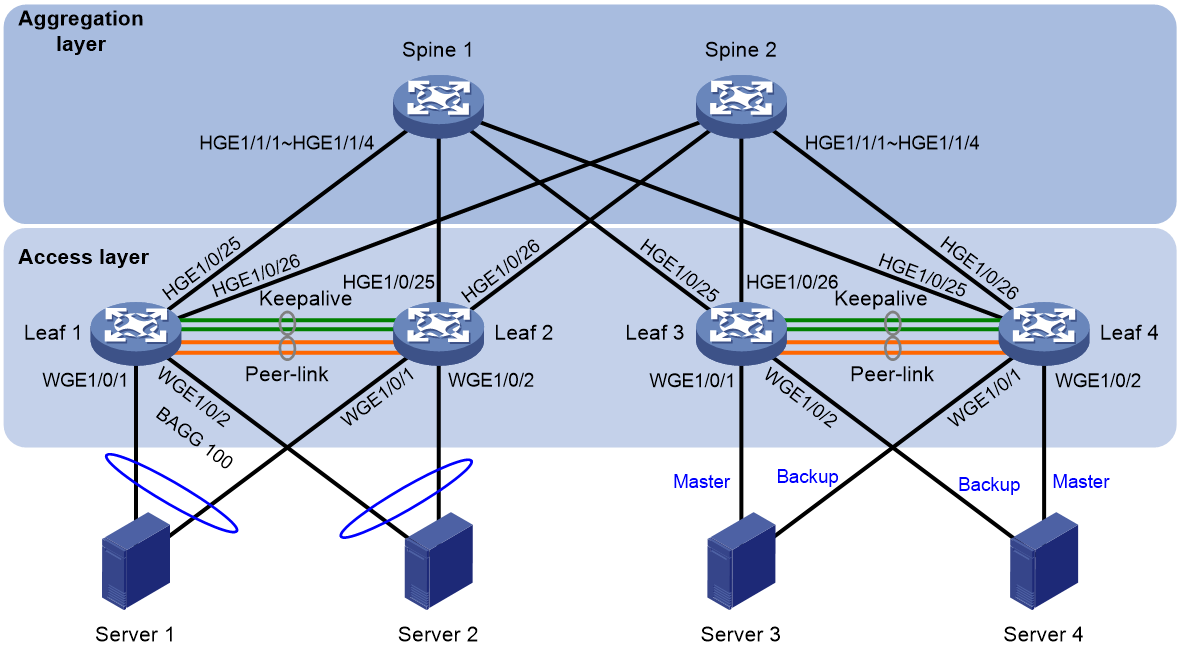

Example: Deploying M-LAG and RDMA
As shown in Figure 1, build a Layer 2 network within the data center to implement traffic forwarding across leaf devices and spine devices.
The following is the network configuration:
·     Deploy the leaf devices as access switches. Use M-LAG to build two pairs of access switches as M-LAG systems. The M-LAG interfaces in an M-LAG system form a multichassis aggregate link for improved link usage. Configure dual-active-gateway or VRRP for the leaf devices to provide connectivity for servers.
·     Deploy the spine devices as aggregation switches. Configure them as route reflectors (RRs) to reflect BGP routes among leaf devices.
·     Configure intelligent lossless network features such as PFC and data buffer to provide zero packet loss for RDMA. In this example, zero packet loss is implemented for packets with 802.1p priority 3.
·     Configure DHCP relay on leaf devices to help servers obtain IP addresses.
Figure 1 Network diagram
Device
Interface
IP address
Remarks
Leaf 1
WGE1/0/1
N/A
Member port of an M-LAG interface.
Connected to Server 1.
WGE1/0/2
N/A
Connected to Server 2.
HGE1/0/29
N/A
Member port of the peer-link interface.
Connected to HGE 1/0/29 on Leaf 2.
HGE1/0/30
N/A
Connected to HGE 1/0/30 on Leaf 2.
HGE1/0/31
N/A
Connected to HGE 1/0/31 on Leaf 2.
HGE1/0/32
N/A
Connected to HGE 1/0/32 on Leaf 2.
WGE1/0/55
RAGG 1000: 1.1.1.1/30
Keepalive link between M-LAG member devices.
Connected to WGE 1/0/55 on Leaf 2.
WGE1/0/56
Connected to WGE 1/0/56 on Leaf 2.
HGE1/0/25
172.16.2.154/30
Connected to WGE 1/1/1 on Spine 1.
HGE1/0/26
172.16.3.154/30
Connected to WGE 1/1/1 on Spine 2.
Loopback1
50.50.255.41/32
N/A
Leaf 2
WGE1/0/1
N/A
WGE1/0/2
N/A
HGE1/0/29
N/A
Connected to HGE 1/0/29 on Leaf 1.
HGE1/0/30
N/A
Connected to HGE 1/0/30 on Leaf 1.
HGE1/0/31
N/A
Connected to HGE 1/0/31 on Leaf 1.
HGE1/0/32
N/A
Connected to HGE 1/0/32 on Leaf 1.
WGE1/0/55
RAGG 1000: 1.1.1.2/30
Connected to WGE 1/0/55 on Leaf 1.
WGE1/0/56
Connected to WGE 1/0/56 on Leaf 1.
HGE1/0/25
172.16.2.158/30
Connected to WGE 1/1/2 on Spine 1.
HGE1/0/26
172.16.3.158/30
Connected to WGE 1/1/2 on Spine 2.
Loopback1
50.50.255.42/32
N/A
Leaf 3
WGE1/0/1
N/A
Interface connected to a single-homed device.
Connected Server 3.
WGE1/0/2
N/A
Connected Server 4.
HGE1/0/29
N/A
Connected to HGE 1/0/29 on Leaf 4.
HGE1/0/30
N/A
Connected to HGE 1/0/30 on Leaf 4.
HGE1/0/31
N/A
Connected to HGE 1/0/31 on Leaf 4.
HGE1/0/32
N/A
Connected to HGE 1/0/32 on Leaf 4.
WGE1/0/55
WGE1/0/56
HGE1/0/25
172.16.2.82/30
HGE1/0/26
172.16.3.82/30
Loopback1
50.50.255.23/32
N/A
Leaf 4
WGE1/0/1
N/A
Connected Server 3.
WGE1/0/2
N/A
Connected Server 4.
HGE1/0/29
N/A
Connected to HGE 1/0/29 on Leaf 3.
HGE1/0/30
N/A
Connected to HGE 1/0/30 on Leaf 3.
HGE1/0/31
N/A
Connected to HGE 1/0/31 on Leaf 3.
HGE1/0/32
N/A
Connected to HGE 1/0/32 on Leaf 3.
WGE1/0/55
WGE1/0/56
HGE1/0/25
172.16.2.86/30
HGE1/0/26
172.16.3.86/30
Loopback1
50.50.255.24/32
N/A
Spine 1
HGE1/1/1
172.16.2.153/30
Connected to HGE 1/0/25 on Leaf 1.
HGE1/1/2
172.16.2.157/30
Connected to HGE 1/0/25 on Leaf 2.
HGE1/1/3
172.16.2.81/30
Connected to HGE 1/0/25 on Leaf 3.
HGE1/1/4
172.16.2.85/30
Connected to HGE 1/0/25 on Leaf 4.
Loopback1
50.50.255.1/32
N/A
Spine 2
HGE1/1/1
172.16.3.153/30
Connected to HGE 1/0/26 on Leaf 1.
HGE1/1/2
172.16.3.157/30
Connected to HGE 1/0/26 on Leaf 2.
HGE1/1/3
172.16.3.81/30
Connected to HGE 1/0/26 on Leaf 3.
HGE1/1/4
172.16.3.85/30
Connected to HGE 1/0/26 on Leaf 4.
Loopback1
50.50.255.2/32
N/A

Configuring M-LAG
Leaf 1
Leaf 2
Description
Remarks
interface Bridge-Aggregation1000
Create the Layer 2 aggregate interface to be used as the peer-link interface and enter its interface view.
N/A
link-aggregation mode dynamic
Configure the aggregate interface to operate in dynamic mode.
N/A
Return to system view.
N/A
interface range HundredGigE1/0/29 to HundredGigE1/0/32
Enter interface range view.
N/A
port link-aggregation group 1000
Assign the ports to the link aggregation group for the peer-link interface (aggregation group 1000).
N/A
N/A
Enter the interface view for the port to be used as the peer-link interface.
N/A
port m-lag peer-link 1
Specify the aggregate interface as the peer-link interface.
N/A
N/A
ip vpn-instance M-LAGKeepalive
Create a VPN instance used for M-LAG keepalive.
N/A
N/A
interface Route-Aggregation1000
Create the Layer 3 aggregate interface to be used as the keepalive interface.
N/A
ip binding vpn-instance M-LAGKeepalive
Associate the interface with the VPN instance.
N/A
ip address 1.1.1.1 255.255.255.252
ip address 1.1.1.2 255.255.255.252
Assign an IP address to the keepalive interface.
N/A
N/A
N/A
interface Twenty-FiveGigE1/0/55
Configure the interface as a member port of the keepalive interface.
N/A
port link-mode route
Configure the interface for keepalive detection to operate in route mode as a Layer 3 interface.
N/A
Assign the port to the link aggregation group for the peer-link interface (aggregation group 1000).
N/A
N/A
interface Twenty-FiveGigE1/0/56
N/A
N/A
N/A
N/A
m-lag role priority 50
m-lag role priority 100
Set the M-LAG role priority.
N/A
m-lag system-mac 2001-0000-0018
Configure the M-LAG system MAC address.
You must configure the same M-LAG system MAC address for all M-LAG member devices.
m-lag system-number 1
m-lag system-number 2
Set the M-LAG system number.
You must assign different M-LAG system numbers to the member devices in an M-LAG system.
m-lag system-priority 110
(Optional.) Set the M-LAG system priority.
You must set the same M-LAG system priority on the member devices in an M-LAG system.
The lower the value, the higher the priority.
m-lag keepalive ip destination 1.1.1.2 source 1.1.1.1 vpn-instance M-LAGKeepalive
m-lag keepalive ip destination 1.1.1.1 source 1.1.1.2 vpn-instance M-LAGKeepalive
Configure M-LAG keepalive packet parameters.
If the interface of an IP address is not an interface excluded from the MAD shutdown action, configure it as an interface excluded from the MAD shutdown action.
m-lag mad exclude interface LoopBack1
Exclude Loopback1 from the shutdown action by M-LAG MAD.
N/A
m-lag mad exclude interface Route-Aggregation1000
Exclude Route-Aggregation 1000 from the shutdown action by M-LAG MAD.
N/A
m-lag mad exclude interface Twenty-FiveGigE1/0/55
Exclude Twenty-FiveGigE 1/0/55 from the shutdown action by M-LAG MAD.
N/A
m-lag mad exclude interface Twenty-FiveGigE1/0/56
Exclude Twenty-FiveGigE 1/0/56 from the shutdown action by M-LAG MAD.
N/A
m-lag mad exclude interface M-GigabitEthernet0/0/0
Exclude M-GigabitEthernet 0/0/0 from the shutdown action by M-LAG MAD.
N/A

Configuring the links towards the servers
Configuring M-LAG links
This example describes the procedure to configure Twenty-FiveGigE 1/0/1 on Leaf 1 and Leaf 2. The same procedure applies to other interfaces.
Leaf 1
Leaf 2
Description
interface bridge-aggregation 100
Create an aggregate interface to be used as an M-LAG interface.
port m-lag group 1
port m-lag group 1
Assign the aggregate interface to an M-LAG group.
N/A
interface Twenty-FiveGigE1/0/1
Enter the view of interface connected to servers.
Add the physical interface to the Layer 2 aggregation group.
broadcast-suppression 1
Enable broadcast suppression and set the broadcast suppression threshold.
multicast-suppression 1
Enable multicast suppression and set the multicast suppression threshold.
stp edged-port
stp edged-port
Configure the interface as an edge port.
port monitor-link group 1 downlink
Configure the interface as the downlink interface of a monitor link group.
N/A
N/A
port link-type trunk
Set the link type of the interface to trunk.
undo port trunk permit vlan 1
Remove the trunk port from VLAN 1.
port trunk permit vlan 1100 to 1500
Assign the trunk port to VLANs 1100 through 1500.
N/A

Traffic model
ID
Type
Traffic direction
Traffic path
Simulation method
Load
Description
1
Unicast/L2
East-west traffic between servers attached to the same leaf M-LAG system.
M-LAG access: Server1 > Leaf1/Leaf2 > Server2
Non-M-LAG access: Server3 > Leaf3 > Leaf4 > Server4
Tester
Light/Congested
Layer 2 connectivity between servers attached to the same M-LAG system at the leaf tier.
2
Unicast/L2
M-LAG access: Server2-Leaf2/Leaf1-Server1
Non-M-LAG access: Server4-Leaf4 –Leaf3-Server3
Tester
Light/Congested
3
Known unicast/IPv4
M-LAG access: Server1-Leaf1/Leaf2-Server2
Non-M-LAG access: Server3-Leaf3 –Leaf4-Server4
Tester
Light/Congested
Layer 3 connectivity between servers attached to the same M-LAG system at the leaf tier.
4
Known unicast/IPv4
Tester
Light/Congested
5
Known unicast/IPv4
East-west traffic between servers attached to different leaf M-LAG systems.
Server1 > Leaf1/Leaf2 > Spine 1/Spine 2 > Leaf3 > Server3
Tester
Light/Congested
Layer 3 connectivity between servers attached to different M-LAG systems at the leaf tier.
6
Known unicast/IPv4
Server3 > Leaf3 > Spine 1/Spine 2 > Leaf1/Leaf2 > Server1
Tester
Light/Congested
