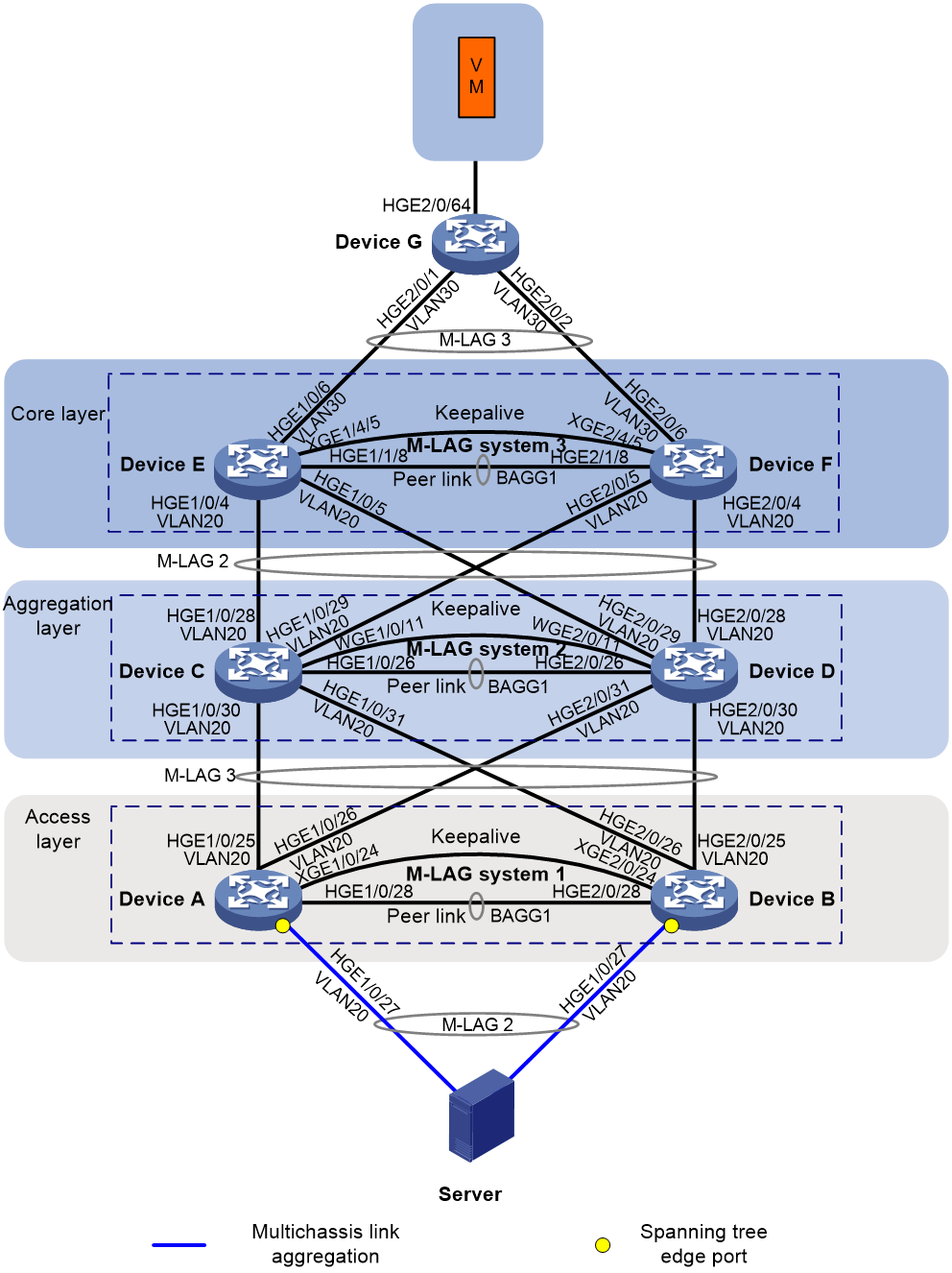

As shown in Figure 1, the user network uses a three-layer architecture: core-aggregation-access. To improve network availability, deploy two devices separately on the core layer, aggregation layer, and access layer. Two devices on each layer form an M-LAG system.
· Device A and Device B form M-LAG system 1, which acts as an access device and connects to Server.
· Device C and Device D form M-LAG system 2, which acts as an aggregation device.
· Device E and Device F form M-LAG system 3, which acts as the core device and connects to VM.
To meet the network access requirements of VM and Server, make sure the M-LAG member devices on the core layer act as both the IPv4 gateway and IPv6 gateway of VM and Server.
To avoid loops between aggregation member ports over a peer link because the M-LAG system splits, the cables are connected incorrectly, or the configuration is incorrect, perform he following tasks:
· Configure STP on the M-LAG member devices.
· Configure the M-LAG member devices on the core layer (Device E and Device F) as the root bridges of STP. If you do not do that, when new devices are added to the STP network, they might dynamically preempt the STP root bridge roles. As a result, the STP network will flap.
NOTE: This document uses three-layer M-LAG+STP+dual-active VLAN gateways as an example to describe how to configure a multi-layer M-LAG network. The configuration procedure for a two-layer M-LAG+STP+dual-active VLAN gateways is similar. |

Configuring Device C and Device D
Device C |
Device D |
Description |
Remarks |
stp global enable |
stp global enable |
Enable the spanning tree protocol globally. |
By default, this feature is enabled on fixed-port switches. |
m-lag system-mac 1-1-1 |
Configure the M-LAG system MAC address. |
You must configure the same M-LAG system MAC address for devices in the same M-LAG system. |
m-lag system-number 1 |
m-lag system-number 2 |
Set the M-LAG system number. |
You must set different M-LAG system numbers for devices in the same M-LAG system. |
m-lag system-priority 124 |
Set the M-LAG system priority. |
You must set the same M-LAG system priority for devices in the same M-LAG system. |
m-lag role priority 10 |
m-lag role priority 20 |
Set the M-LAG role priority of an M-LAG member device. |
M-LAG assigns the primary or secondary role to an M-LAG member device based on its M-LAG role priority. The smaller the priority value, the higher the priority. The device with the higher priority is the primary device. |
m-lag standalone enable |
Enable M-LAG standalone mode. |
N/A |
m-lag keepalive ip destination 220.1.1.4 source 220.1.1.3 |
m-lag keepalive ip destination 220.1.1.3 source 220.1.1.4 |
Configure the destination and source IP addresses of keepalive packets. |
N/A |
interface Twenty-FiveGigE 1/0/11 |
interface Twenty-FiveGigE 2/0/11 |
Enter the interface view for the keepalive link. |
N/A |
port link-mode route |
Configure the interface for the keepalive link to operate in route mode as a Layer 3 interface. |
N/A |
ip address 220.1.1.3 24 |
ip address 220.1.1.4 24 |
Assign an IP address to the interface for the keepalive link. |
N/A |
quit |
quit |
Return to system view. |
N/A |
m-lag mad exclude interface Twenty-FiveGigE 1/0/11 |
m-lag mad exclude interface Twenty-FiveGigE 2/0/11 |
Exclude the interface used for M-LAG keepalive detection from the shutdown action by M-LAG MAD. |
N/A |
vlan 20 |
vlan 20 |
Create VLAN 20. |
N/A |
quit |
quit |
N/A |
interface bridge-aggregation 1 |
Create the Layer 2 aggregate interface to be used as the peer-link interface and enter Layer 2 aggregate interface view. |
N/A |
quit |
quit |
N/A |
interface HundredGigE 1/0/26 |
interface HundredGigE 2/0/26 |
Enter the view of physical interfaces on the peer link. |
N/A |
port link-aggregation group 1 |
Assign the physical interfaces on the peer link to the aggregation group for the peer link (aggregation group 1). |
N/A |
Enter the view of the aggregation group for the peer link. |
N/A |
undo mac-address static source-check enable |
Disable source MAC check on an interface. |
N/A |
link-aggregation mode dynamic |
Configure the aggregate interface to operate in dynamic mode. |
N/A |
port m-lag peer-link 1 |
Specify the aggregate interface (Bridge-Aggregation 1) as the peer-link interface. |
N/A |
quit |
quit |
N/A |
interface bridge-aggregation 2 |
Create an aggregate interface connecting to Device E and Device F. |
N/A |
Configure the aggregate interface connecting to Device E and Device F to operate in dynamic mode. |
N/A |
port lacp system-priority 101 |
port lacp system-priority 100 |
Set the LACP priority. |
Set different LACP priorities for different M-LAG member devices, so that only member ports with a higher priority are selected upon brain split. |
port m-lag group 2 |
Assign the Layer 2 aggregate interface (Bridge-Aggregation 2) to M-LAG group 2. |
N/A |
quit |
quit |
N/A |
interface bridge-aggregation 3 |
Create an aggregate interface connecting to Device A and Device B. |
N/A |
Configure the aggregate interface connecting to Device A and Device B to operate in dynamic mode. |
N/A |
port m-lag group 3 |
Assign the Layer 3 aggregate interface (Bridge-Aggregation 3) to M-LAG group 3. |
N/A |
quit |
quit |
N/A |
interface range HundredGigE 1/0/28 HundredGigE 1/0/29 |
interface range HundredGigE 2/0/28 HundredGigE 2/0/29 |
Enter the view of the physical interfaces connecting the M-LAG system to Device E and Device F. |
N/A |
port link-aggregation group 2 |
Assign the interfaces to an M-LAG group. |
N/A |
quit |
quit |
N/A |
Enter the view of an aggregate interface. |
N/A |
port link-type trunk |
Set the link type of the aggregate interface to trunk. |
N/A |
undo port trunk permit vlan 1 |
Remove the trunk port from VLAN 1. |
N/A |
port trunk permit vlan 20 |
Assign the interface to the specified VLAN. |
N/A |
interface range HundredGigE 1/0/30 HundredGigE 1/0/31 |
interface range HundredGigE 2/0/30 HundredGigE 2/0/31 |
Enter the view of the physical interfaces connecting the M-LAG system to Device A and Device B. |
N/A |
port link-aggregation group 3 |
N/A |
quit |
quit |
N/A |
N/A |
N/A |
N/A |
N/A |
quit |
quit |
N/A |
link-aggregation global load-sharing algorithm 7 |
Configure a link aggregation load sharing algorithm. |
To identify whether traffic is load-shared among aggregation member ports, use the display counters command to view the traffic on each aggregation group member port. If traffic is not well load-shared, you can use this command to specify a proper link aggregation load sharing algorithm. This command is not supported on the S6812 and S6813 switches. |
Configuring Device E and Device F
Device E |
Device F |
Description |
Remarks |
stp global enable |
stp global enable |
m-lag system-mac 1-2-3 |
m-lag system-priority 122 |
N/A |
m-lag keepalive ip destination 220.1.1.6 source 220.1.1.5 |
m-lag keepalive ip destination 220.1.1.5 source 220.1.1.6 |
N/A |
interface Ten-GigabitEthernet 1/4/5 |
interface Ten-GigabitEthernet 2/4/5 |
N/A |
N/A |
ip address 220.1.1.5 24 |
ip address 220.1.1.6 24 |
N/A |
quit |
quit |
N/A |
m-lag mad exclude interface Ten-GigabitEthernet 1/4/5 |
m-lag mad exclude interface Ten-GigabitEthernet 2/4/5 |
N/A |
N/A |
quit |
quit |
N/A |
Interface HundredGigE 1/1/8 |
interface HundredGigE 2/1/8 |
N/A |
N/A |
quit |
quit |
N/A |
N/A |
N/A |
N/A |
N/A |
quit |
quit |
N/A |
Create an aggregate interface connecting to Device C and Device D. |
N/A |
Configure the aggregate interface connecting to Device C and Device D to operate in dynamic mode. |
N/A |
N/A |
quit |
quit |
N/A |
Create an aggregate interface connecting to Device G. |
N/A |
Configure the aggregate interface connecting to Device G to operate in dynamic mode. |
N/A |
N/A |
quit |
quit |
N/A |
interface range HundredGigE 1/0/4 HundredGigE 1/0/5 |
interface range HundredGigE 2/0/4 HundredGigE 2/0/5 |
Enter the view of the physical interfaces connecting the M-LAG system to Device C and Device D. |
N/A |
N/A |
quit |
quit |
N/A |
interface HundredGigE1/0/6 |
interface HundredGigE2/0/6 |
Enter the view of the physical interfaces connecting the M-LAG system to VM. |
N/A |
N/A |
quit |
quit |
N/A |
stp instance 0 root primary |
Configure the device as the root bridge. |
N/A |
Configuring the dual-active gateways
Device E |
Device F |
Description |
Remarks |
vlan 20 30 |
vlan 20 30 |
Create VLANs 20 and 30. |
N/A |
Enter the view of the aggregate interface connecting to Device D. |
N/A |
Set the link type of the Layer 2 aggregate interface (Bridge-Aggregation 2) to trunk. |
N/A |
Assign the interface to VLAN 20. |
N/A |
Remove the interface from VLAN 1. |
N/A |
quit |
quit |
N/A |
Enter the view of the aggregate interface connecting to Device G. |
N/A |

Traffic forwarding models
Underlay traffic characteristics
The forwarding model matrix provides the following characteristics of underlay traffic:
· No.—Traffic number in the U-X-XXX format:
¡ U—Underlay traffic.
¡ X—Protocol number, which can be 4 (IPv4) or 6 (IPv6).
¡ XXX—Traffic sequence number.
· Traffic type—Type of underlay traffic, which can be IPv4 known unicast or IPv6 known unicast.
· Direction—Direction of underlay traffic. The value is south-north, which indicates traffic from the south to north.
· Forwarding path—Nodes that underlay traffic traverses.
· Traffic simulation—Traffic simulation method. Typically, a tester is used to simulate server traffic.
· Load—Traffic size, which can be light (less than 1000 flows) and heavy (more than 1000 flows).
Underlay traffic forwarding models

Verifying the status of the M-LAG system
Verify that the M-LAG system is working correctly on Device E and Device F. Use Device E as an example. Configure Device F in the same way Device E is configured.
# Display summary information about the peer-link interface and M-LAG interface.
[DeviceE] display m-lag summary
Flags: A -- Aggregate interface down, B -- No peer M-LAG interface configured
C -- Configuration consistency check failed
Peer-link interface: BAGG1
Peer-link interface state (cause): UP
Keepalive link state (cause): UP
M-LAG interface information
M-LAG IF M-LAG group Local state (cause) Peer state Remaining down time(s)
BAGG2 2 UP UP -
BAGG3 3 UP UP -
# Verify that keepalive link is working correctly.
[DeviceE] display m-lag keepalive
Neighbor keepalive link status (cause): Up
Neighbor is alive for: 774 s 381 ms
Keepalive packet transmission status:
Sent: Successful
Received: Successful
Last received keepalive packet information:
Source IP address: 220.1.1.2
Time: 2022/02/07 06:50:17
Action: Accept
M-LAG keepalive parameters:
Destination IP address: 220.1.1.6
Source IP address: 220.1.1.5
Keepalive UDP port : 6400
Keepalive VPN name : N/A
Keepalive interval : 1000 ms
Keepalive timeout : 5 sec
Keepalive hold time: 3 sec
# Display the M-LAG system information.
[DeviceE] display m-lag system
System information
Local system number: 1 Peer system number: 2
Local system MAC: 0001-0002-0003 Peer system MAC: 0001-0002-0003
Local system priority: 122 Peer system priority: 122
Local bridge MAC: 5cc9-995f-7d7e Peer bridge MAC: 5cc9-995f-79fa
Local effective role: Secondary Peer effective role: Primary
Health level: 0
Standalone mode on split: Enabled
In standalone mode: No
System timer information
Timer State Value (s) Remaining time (s)
Auto recovery Disabled - -
Restore delay Disabled 180 -
Consistency-check delay Disabled 90 -
Standalone delay Disabled 0 -
Role to None delay Disabled 60 -
# Display detailed information about the peer-link interface and M-LAG interfaces.
[DeviceE] display m-lag verbose
Flags: A -- Home_Gateway, B -- Neighbor_Gateway, C -- Other_Gateway,
D -- PeerLink_Activity, E -- DRCP_Timeout, F -- Gateway_Sync,
G -- Port_Sync, H -- Expired
Peer-link interface/Peer-link interface ID: BAGG1/1
State: UP
Cause: -
Local DRCP flags/Peer DRCP flags: ABDFG/ABDFG
Local Selected ports (index): HGE1/1/8 (40)
Peer Selected ports indexes: 235
M-LAG interface/M-LAG group ID: BAGG2/2
Local M-LAG interface state: UP
Peer M-LAG interface state: UP
M-LAG group state: UP
Local M-LAG interface down cause: -
Remaining M-LAG DOWN time: -
Local M-LAG interface LACP MAC: Config=N/A, Effective=0001-0002-0003
Peer M-LAG interface LACP MAC: Config=N/A, Effective=0001-0002-0003
Local M-LAG interface LACP priority: Config=32768, Effective=122
Peer M-LAG interface LACP priority: Config=32768, Effective=122
Local Selected ports (index): HGE1/1/4 (20), HGE1/1/5 (25)
Peer Selected ports indexes: 215, 220
M-LAG interface/M-LAG group ID: BAGG3/3
Local Selected ports (index): FGE1/2/1 (45)
Peer Selected ports indexes: 240
Verifying that the STP state is normal
# Display the STP state after the M-LAG systems are cascaded. On Device A, Device B, Device C, Device D, Device E, and Device F, the STP state of each aggregate interface is FORWARDING, and the root bridge is 0.0001-0002-0003.
[DeviceE] display stp brief
MST ID Port Role STP State Protection
0 Bridge-Aggregation2 (M-LAG) DESI FORWARDING NONE
0 Bridge-Aggregation3 (M-LAG) DESI FORWARDING NONE
[DeviceE] display stp root
MST ID Root Bridge ID ExtPathCost IntPathCost Root Port
0 0.0001-0002-0003 0 0
[DeviceF] display stp brief
[DeviceF] display stp root
[DeviceC] display stp brief
0 Bridge-Aggregation2 (M-LAG) ROOT FORWARDING NONE
[DeviceC] display stp root
0 0.0001-0002-0003 1 0 BAGG2
[DeviceD] display stp brief
[DeviceD] display stp root
[DeviceA] display stp brief
[DeviceA] display stp root
[DeviceB] display stp brief
[DeviceB] display stp root
