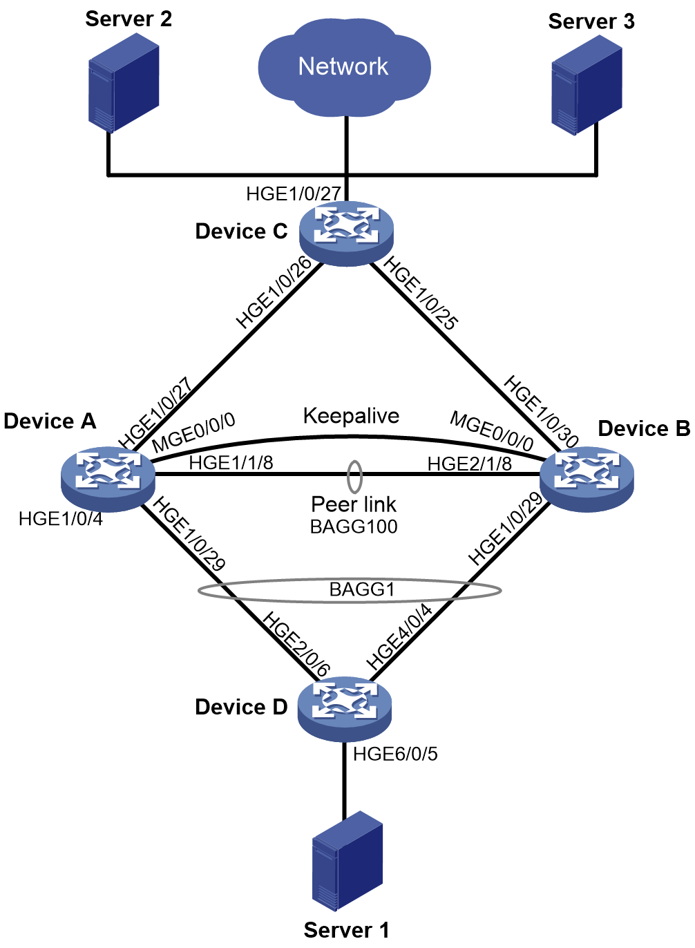

Example: Configuring M-LAG, EVPN, and Monitor Link
As shown in Figure 1, configure the network as follows:
·     Set up an M-LAG system with Device A and Device B.
·     Connect Server 1 to the M-LAG system via Device D.
·     Connect Device C to Server 2, Server 3, and Network (public network).
·     Configure ECMP routes between the M-LAG system and Device C.
Perform the following tasks to ensure network connectivity:
·     Configure Device A and Device B as distributed gateways.
·     Configure Device C as a distributed gateway and border gateway.
·     Assign Server 1 to Server 2 to one VXLAN, and assign Server 3 to another VXLAN.
·     Configure Monitor Link to enable one M-LAG member device to shut down its downlink interface upon uplink interface failure for traffic to fail over to the other M-LAG member device.
Configure spanning tree to eliminate loops:
·     Enable spanning tree on the M-LAG member devices.
·     Enable BPDU guard on the M-LAG member devices to protect them from forged BPDU attacks.
Figure 1 Network diagram
Device
Interface
IP address
Remarks
Device A
HGE 1/0/27
10.130.0.161/31
Connected to HGE 1/0/26 on Device C.
HGE 1/0/29
N/A
Connected to HGE 2/0/6 on Device D.
MGE 0/0/0
10.130.8.105/24
Connected to MGE 0/0/0 on Device A.
Vlan-int 100
192.168.1.1/30
Connected to VLAN-interface 100 on Device B.
Used for Layer 3 communication between the M-LAG member devices, BGP peer relationship setup, and traffic failover.
Vsi-int 5000
120.241.147.49/26
Distributed EVPN gateway interface.
Vsi-int 1
N/A
L3VNI-associated VSI interface.
LoopBack 0
10.130.11.1/32
VTEP IP address used for setting up BGP EVPN peer relationships.
LoopBack 1
10.130.12.1/32
Virtual VTEP IP address.
Device B
HGE 1/0/25
N/A
Connected to HGE 1/0/26 on Device A.
HGE 1/0/29
N/A
Connected to HGE 4/0/4 on Device D.
HGE 1/0/30
10.130.1.161/31
Connected to HGE 1/0/25 on Device C.
MGE 0/0/0
10.130.8.106/24
Connected to MGE 0/0/0 on Device B.
Vlan-int 100
192.168.1.2/30
Connected to VLAN-interface 100 on Device A.
Vsi-int 5000
120.241.147.49/26
Vsi-int 1
N/A
LoopBack 0
10.130.11.2/32
LoopBack 1
10.130.12.1/32
Device C
HGE 1/0/25
10.130.1.160/31
Connected to HGE 1/0/30 on Device B.
HGE 1/0/26
10.130.0.160/31
Connected to HGE 1/0/27 on Device A
HGE 1/0/27
N/A
Connected to Network, Server 2, and Server 3.
Vlan-int 5
192.168.255.1
Connected to Network.
Vsi-int 5000
120.241.147.49/26
Vsi-int 1000
11.0.0.1/26
Gateway interface for Server 3.
Vsi-int 1
N/A
LoopBack 1
10.130.12.253/32
Device D
HGE 2/0/6
N/A
Connected to HGE 1/0/29 on Device A.
HGE 4/0/4
N/A
Connected to HGE 1/0/29 on Device B.
HGE 6/0/5
N/A
Connected to Server 1.

Configuring Device D
Procedure summary
·     Configuring the links towards the
·     Configuring the link towards Server 1
Configuring the links towards the M-LAG system
Device D
Description
vlan 50
Create VLAN 50.
interface bridge-aggregation 1
Create an aggregate interface.
Return to system view.
interface HundredGigE 2/0/6
Enter Ethernet interface view.
port link-mode bridge
Configure the Ethernet interface to work in Layer 2 mode.
port link-aggregation group 1
Assign the Ethernet interface to aggregation group 1.
interface HundredGigE 4/0/4
link-aggregation mode dynamic
Configure the aggregate interface to work in dynamic aggregation mode.
port link-type trunk
Set the link type of the aggregate interface to trunk.
undo port trunk permit vlan 1
Forbid traffic of VLAN 1.
port trunk permit vlan 50
Permit traffic of VLAN 50.
Device D
Description
stp global enable
Enable spanning tree globally.
interface HundredGigE 6/0/5
Enter the view of the interface connected to Server 1.
Configure the interface to work at Layer 2 mode.
port link-type access
Set the link type to access.
port access vlan 50
Configure the interface to permit traffic of VLAN 50 as an access port.
stp edged-port
Configure the interface as a spanning tree edge port.
Configuring routing
Procedure summary
·     Configuring routing on the M-LAG member devices
·     Configuring routing on Device C
Device A
Device B
Description
Purpose/Remarks
bgp 1
bgp 1
Enable BGP instance default, specify 1 as the local AS number, and enter BGP instance view.
Used for creating underlay routes.
bgp update-delay on-startup 240
Configure BGP to delay sending route updates on reboot.
The delay timer must be longer than the time spent on BGP relationship establishment after the BGP process restarts.
non-stop-routing
non-stop-routing
Enable BGP NSR.
N/A
router-id 10.130.11.1
router-id 10.130.11.2
Configure a router ID.
Configure unique router IDs for the devices in the same AS.
group ibgp internal
group ibgp internal
Create IBGP peer group ibgp.
N/A
group spine external
Create EBGP peer group spine.
N/A
peer spine as-number 2
Specify AS number 2 for the EBGP peer group.
N/A
peer spine route-update-interval 0
Set the interval to 0 for sending the same update to peer group spine.
N/A
peer 10.130.0.160 group spine
peer 10.130.1.160 group spine
Assign peers with a 10.130.x.160 IP address to EBGP peer group spine.
Set up peer relationships between the M-LAG member devices and Device C.
peer 192.168.1.2 group ibgp
peer 192.168.1.1 group ibgp
Assign peers with a 192.168.1.x address to IBGP peer group ibgp.
address-family ipv4 unicast
Create the BGP-VPN IPv4 unicast address family and enter its view.
N/A
balance ebgp 8
balance ebgp 8
Enable load balancing and set the maximum number of EBGP ECMP routes for load balancing to 8.
N/A
network 10.130.11.1 255.255.255.255
network 10.130.11.2 255.255.255.255
Configure BGP to advertise a local network.
N/A
network 10.130.12.1 255.255.255.255
Configure BGP to inject local network 10.130.12.1/32 into the BGP routing table.
N/A
peer ibgp enable
peer ibgp enable
Enable BGP to exchange IPv4 unicast routing information with peer group ibgp.
N/A
peer ibgp next-hop-local
Set the local router as the next hop for BGP routes sent to the IBGP peer group.
N/A
peer spine enable
peer spine enable
Enable BGP to exchange IPv4 unicast routing information with peer group spine.
N/A
Return to BGP view.
N/A
N/A
bgp 65000 instance evpn
Enable BGP instance evpn, specify 65000 as the local AS number, and enter BGP instance view.
Used for creating overlay routes.
non-stop-routing
non-stop-routing
Enable BGP NSR.
N/A
group spine internal
Create IBGP peer group spine.
N/A
peer spine connect-interface LoopBack0
Specify source interface Loopback 0 for establishing TCP links towards peer group spine.
N/A
peer 10.130.12.253 group spine
Assign the peer at 10.130.12.253 to IBGP peer group spine.
N/A
address-family l2vpn evpn
Create the BGP EVPN address family and enter its view.
N/A
nexthop evpn-m-lag group-address
Set the next hop of advertised EVPN routes to the virtual VTEP address of the M-LAG system.
N/A
peer spine enable
peer spine enable
Enable the device to exchange BGP EVPN routes with peer group spine.
N/A
Return to BGP view.
N/A
N/A
Device C
Description
Remarks
bgp 2
Enable BGP instance default, specify 2 as the local AS number, and enter BGP instance view.
N/A
non-stop-routing
Enable BGP NSR.
N/A
N/A
peer spine as-number 1
Specify AS number 1 for the EBGP peer group.
N/A
N/A
peer 10.130.0.161 group spine
Assign the peer at 10.130.0.161 to EBGP peer group spine.
N/A
peer 10.130.1.161 group spine
Assign the peer at 10.130.1.161 to EBGP peer group spine.
N/A
Enter BGP IPv4 unicast address family view.
N/A
balance ebgp 8
N/A
network 10.130.12.253 255.255.255.255
Configure BGP to inject local network 10.130.12.253/32 into the BGP routing table.
N/A
peer spine enable
N/A
Return to BGP view.
N/A
N/A
N/A
non-stop-routing
Enable BGP NSR.
N/A
router-id 10.130.12.253
N/A
N/A
peer spine connect-interface LoopBack1
Specify source interface Loopback 1 for establishing TCP links towards peer group spine.
N/A
peer 10.130.11.1 group spine
Assign the peer at 10.130.11.1 to IBGP peer group spine.
N/A
peer 10.130.11.2 group spine
Assign the peer at 10.130.11.2 to IBGP peer group spine.
N/A
N/A
peer spine enable
Enable BGP to exchange BGP EVPN routing information with peer group spine.
N/A
ip vpn-instance WAN
Enter the view of BGP-VPN instance WAN.
N/A
Enter BGP-VPN IPv4 unicast address family view.
N/A
default-route imported
Import default routes to the BGP routing table.
N/A
balance 16
Enable load balancing and set the maximum number of BGP ECMP routes for load balancing to 16.
N/A
Return to BGP view.
N/A
N/A
ip route-static vpn-instance WAN 0.0.0.0 0 Vlan-interface5 192.168.255.2 description to-evpn-wan
Configure a static route for Network.
N/A
ip route-static vpn-instance Mgt 10.0.0.0 8 10.130.8.1
Configure a static route for the management Ethernet interface.
N/A

Verifying routing information
# Verify that Device A has underlay BGP peers.
[DeviceA] display bgp peer ipv4
BGP local router ID: 10.130.11.1
Local AS number: 1
Total number of peers: 2        peers in established state: 2
* - Dynamically created peer
Peer          AS    MsgRcvd   MsgSent    OutQ    PrefRcv    Up/Down      State
10.130.0.160  2     3743      3744       0       1          01:02:17     Established
192.168.1.2   1     600024    600043     0       3          0166h40m     Established
# Verify that Device A has overlay BGP peers.
[DeviceA] display bgp instance evpn peer l2vpn evpn
Local AS number: 65000
Total number of peers: 1        peers in established state: 1
10.130.12.253 65000 10232     11134      0       4          0166h52m     Established
# Verify that Device B has underlay BGP peers.
[DeviceB] display bgp peer ipv4
BGP local router ID: 10.130.11.2
Local AS number: 1
10.130.1.160  2    3925       3926       0       1          01:21:55     Established
192.168.1.1   1    601092     602000     0       3          0166h52m     Established
# Verify that Device B has overlay BGP peers.
[DeviceB] display bgp instance evpn peer l2vpn evpn
10.130.12.253 65000 12539     11149      0       4          0166h59m     Established
# Verify that Device C has underlay BGP peers.
[DeviceC] display bgp peer ipv4
BGP local router ID: 10.130.12.253
Local AS number: 2
10.130.0.161  1    5211       5209       0       3          01:26:42     Established
10.130.1.161  1    502        501        0       3          01:08:16     Established
# Verify that Device C has overlay BGP peers.
BGP local router ID: 10.130.12:253
10.130.11.1   65000  11156     10252      0       3          0167h12m     Established
10.130.11.2   65000  11157     12549      0       3          0167h07m     Established
Verifying connectivity between Server 1 and Server 2
Verify that Server 1 and Server 2, which are in the same VXLAN, have Layer 2 connectivity.
Verifying connectivity between Server 1 and Server 3
Verify that Server 1 and Server 2, which are in different VXLANs, have Layer 3 connectivity.
Verifying connectivity between Server 1 and Network
Verify that Server 1 on a private network and Network on the public network have Layer 3 connectivity.
Verifying traffic failover upon uplink failure
Configure Monitor Link.
monitor-link group 1
port HGE 1/0/30 uplink           Uplink interface
port ethernet 1/0/29 downlink    Associated member port of an M-LAG group
monitor-link group 2
port HGE 1/0/27 uplink           Uplink interface
Disconnect the interface connected to Device C on Device A or Device B.
Verify that Server 1, Server 2, Server 3, and Network can communicate with one another.
