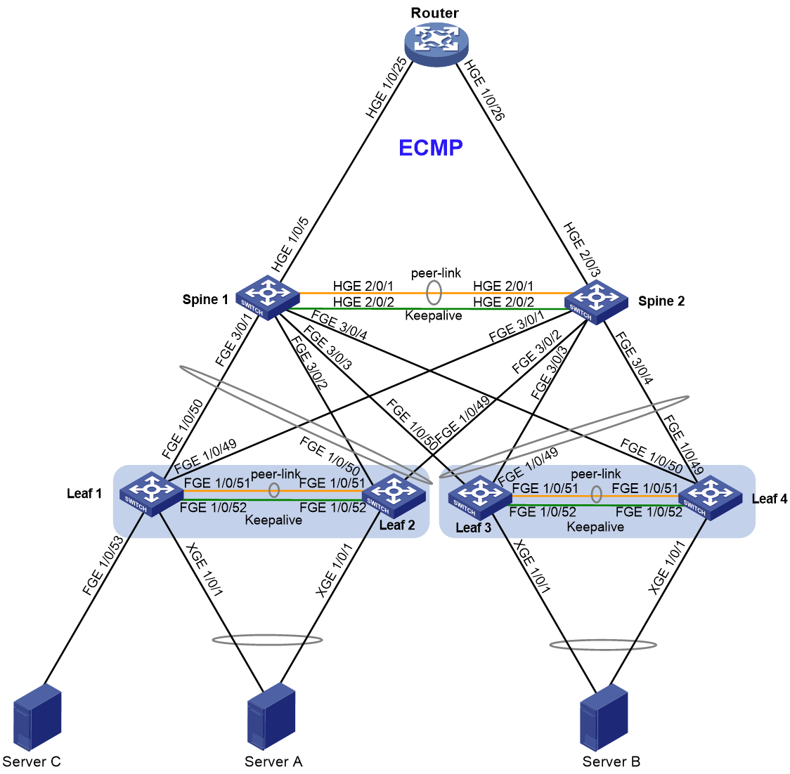

Example: Configuring multi-tier M-LAG+spine gateways+ECMP paths to the external network
As shown in Figure 1, configure the network as follows:
· Set up an M-LAG system at the spine tier to offer gateway services.
· Set up two M-LAG systems at the leaf tier to offer access services to the servers.
· Attach each server to a leaf M-LAG system by using two links or a single link.
· Attach each leaf device to the spine devices by using M-LAG interfaces.
· Configure the router to provide access to the external network.
Device |
Interface |
IP address |
Interface description and peer device and interface |
Spine 1 |
HGE2/0/1 |
N/A |
Peer-link interface Spine 2: HGE2/0/1 |
HGE2/0/2 |
2.0.0.1/30 |
Keepalive interface Spine 2: HGE2/0/2 |
HGE1/0/5 |
25.1.1.1/24 |
Router: HGE1/0/25 |
FGE3/0/1 |
N/A |
Leaf 1: FGE1/0/50 |
FGE3/0/2 |
N/A |
Leaf 2: FGE1/0/50 |
FGE3/0/3 |
N/A |
Leaf 3: FGE1/0/50 |
FGE3/0/4 |
N/A |
Leaf 4: FGE1/0/50 |
Vlan-interface21 |
21.1.1.1/24 |
Leaf 1 and Leaf 2 Service VLAN |
Vlan-interface31 |
31.1.1.1/24 |
Leaf 3 and Leaf 4 Service VLAN |
Vlan-interface2000 |
192.168.2.1/30 |
East-west failover VLAN |
Spine 2 |
HGE2/0/1 |
N/A |
Peer-link interface Spine 1: HGE2/0/1 |
HGE2/0/2 |
2.0.0.2/30 |
Keepalive interface Spine 1: HGE2/0/2 |
HGE2/0/3 |
23.1.1.1/24 |
Router: HGE1/0/26 |
FGE3/0/1 |
N/A |
Leaf 1: FGE1/0/49 |
FGE3/0/2 |
N/A |
Leaf 2: FGE1/0/49 |
FGE3/0/3 |
N/A |
Leaf 3: FGE1/0/49 |
FGE3/0/4 |
N/A |
Leaf 4: FGE1/0/49 |
Vlan-interface21 |
21.1.1.1/24 |
Vlan-interface31 |
31.1.1.1/24 |
192.168.2.2/30 |
Leaf 1 |
XGE1/0/1 |
N/A |
Member port of an M-LAG system interface Server A |
FGE1/0/49 |
N/A |
Spine 2: FGE3/0/1 |
FGE1/0/50 |
N/A |
Spine 1: FGE3/0/1 |
FGE1/0/51 |
N/A |
Peer-link interface Leaf 2: FGE1/0/51 |
FGE1/0/52 |
1.0.0.1/30 |
Keepalive interface Leaf 2: FGE1/0/52 |
FGE1/0/53 |
N/A |
Single-homed link Server C |
Leaf 2 |
XGE1/0/1 |
N/A |
FGE1/0/49 |
N/A |
Spine 2: FGE3/0/2 |
FGE1/0/50 |
N/A |
Spine 1: FGE3/0/2 |
FGE1/0/51 |
N/A |
Peer-link interface Leaf 1: FGE1/0/51 |
FGE1/0/52 |
1.0.0.2/30 |
Keepalive interface Leaf 1: FGE1/0/52 |
Leaf 3 |
XGE1/0/1 |
N/A |
Member port of an M-LAG system interface Server B |
FGE1/0/49 |
N/A |
Spine 2: FGE3/0/3 |
FGE1/0/50 |
N/A |
Spine 1: FGE3/0/3 |
FGE1/0/51 |
N/A |
Peer-link interface Leaf 4: FGE1/0/51 |
FGE1/0/52 |
1.0.0.5/30 |
Keepalive interface Leaf 4: FGE1/0/52 |
Leaf 4 |
XGE1/0/1 |
N/A |
FGE1/0/49 |
N/A |
Spine 2: FGE3/0/4 |
FGE1/0/50 |
N/A |
Spine 1: FGE3/0/4 |
FGE1/0/51 |
N/A |
Peer-link interface Leaf 3: FGE1/0/51 |
FGE1/0/52 |
1.0.0.6/30 |
Keepalive interface Leaf 3: FGE1/0/52 |
Router |
HGE1/0/25 |
25.1.1.2 |
Spine 1: HGE2/0/3 |
HGE1/0/26 |
23.1.1.2 |
Spine 2: HGE2/0/3 |

Configuring the interfaces facing single-homed downstream devices
Leaf 1 (S6800) |
Leaf 2 (S6800) |
Configuration method |
Description |
interface FortyGigE1/0/53 |
Manual |
Enter the view of an M-LAG aggregation member port. |

Configuring the links towards the spine tier
Leaf 1 (S6800) |
Leaf 2 (S6800) |
Description |
Remarks |
interface Bridge-Aggregation102 |
Manual |
Create an aggregate interface to be assigned to an M-LAG system group and enter aggregate interface view. |

Configuring the spine nodes
Procedure summary
· Configuring the links towards the leaf tier
· Configuring the dual-active VLAN gateways
· Configuring the interfaces connected to the external network
Configuring M-LAG
Spine 1 |
Spine 2 |
Description |
Remarks |
Vlan 21 31 |
Vlan 21 31 |
Manual |
Create VLANs. |
N/A |
quit |
quit |
Manual |
Return to system view. |
N/A |
Manual |
Enter the view of the M-LAG group member aggregate interface connected to Leaf 1 and Leaf 2. |
Spine 1 |
Spine 2 |
Description |
Remarks |
routing-interface base-mac 3c8c-4003-8ba5 |
routing-interface base-mac 3c8c-4003-8b41 |
Manual |
Configure the base MAC address. |
The base MAC address of Spine 2 is equal to that of Spine 1 + 0X64. This step only applies to S12500X-AF and S6890 switches. |
interface Vlan-interface21 |
Manual |
Create the VLAN interface of VLAN 21, the service VLAN on Leaf 1 and Leaf 2. |

Traffic forwarding models
The forwarding model matrix provides the following characteristics of traffic:
· No.—Traffic number in the U-X-XXX format:
¡ U—Underlay traffic.
¡ X—Protocol number, which can be 4 (IPv4).
¡ XXX—Traffic sequence number, starting from 201.
· Traffic type—Type of underlay traffic, which can be IPv4 known unicast.
· Direction—Direction of underlay traffic, which can be south-north or east-west across leaf M-LAG systems.
· Forwarding path—Nodes that underlay traffic traverses.
· Traffic simulation—Traffic simulation method. Typically, a tester is used to simulate server traffic.
· Load—Traffic size, which can be light (less than 1000 flows) and heavy (more than 1000 flows).
Table 1 Traffic forwarding models
No. |
Traffic type |
Direction |
Forwarding path |
Traffic simulation |
Load |
Remarks |
U-4-201 |
IPv4 known unicast |
East-west across leaf M-LAG systems |
Server A > Leaf 1 & Leaf 2 > Spine 1 & Spine 2 > Leaf 3 & Leaf 4 > Server B |
Bond4+ tester |
Light |
Layer 3 forwarding between PMs. |
U-4-202 |
Server B > Leaf 1 & Leaf 2 > Spine 1 & Spine 2 > Leaf 1 & Leaf 2 > Server A |
Bond4+ tester |
Light |
U-4-203 |
South-north |
Server A > Leaf 1 & Leaf 2 > Spine 1 & Spine 2 > Router |
Bond4+ tester |
Light |
Layer 3 forwarding between PMs and the external network. |
U-4-204 |
South-north |
Router > Spine 1 & Spine 2 > Leaf 1 & Leaf 2 > Server A |
Bond4+ tester |
Light |
U-4-205 |
Server C > Leaf 1 > Spine 1 & Spine 2 > Leaf 3 & Leaf 4 > Server B |
Bond4+ tester |
Light |
U-4-206 |
Server B > Leaf 3 & Leaf 4 > Spine 1 & Spine 2 > Leaf 1 > Server C |
Bond4+ tester |
Light |
U-4-207 |
South-north |
Server C > Leaf 1 > Spine 1 & Spine 2 > Router |
Bond4+ tester |
Light |
U-4-208 |
South-north |
Router > Spine 1 & Spine 2 > Leaf 1 > Server C |
Bond4+ tester |
Light |
