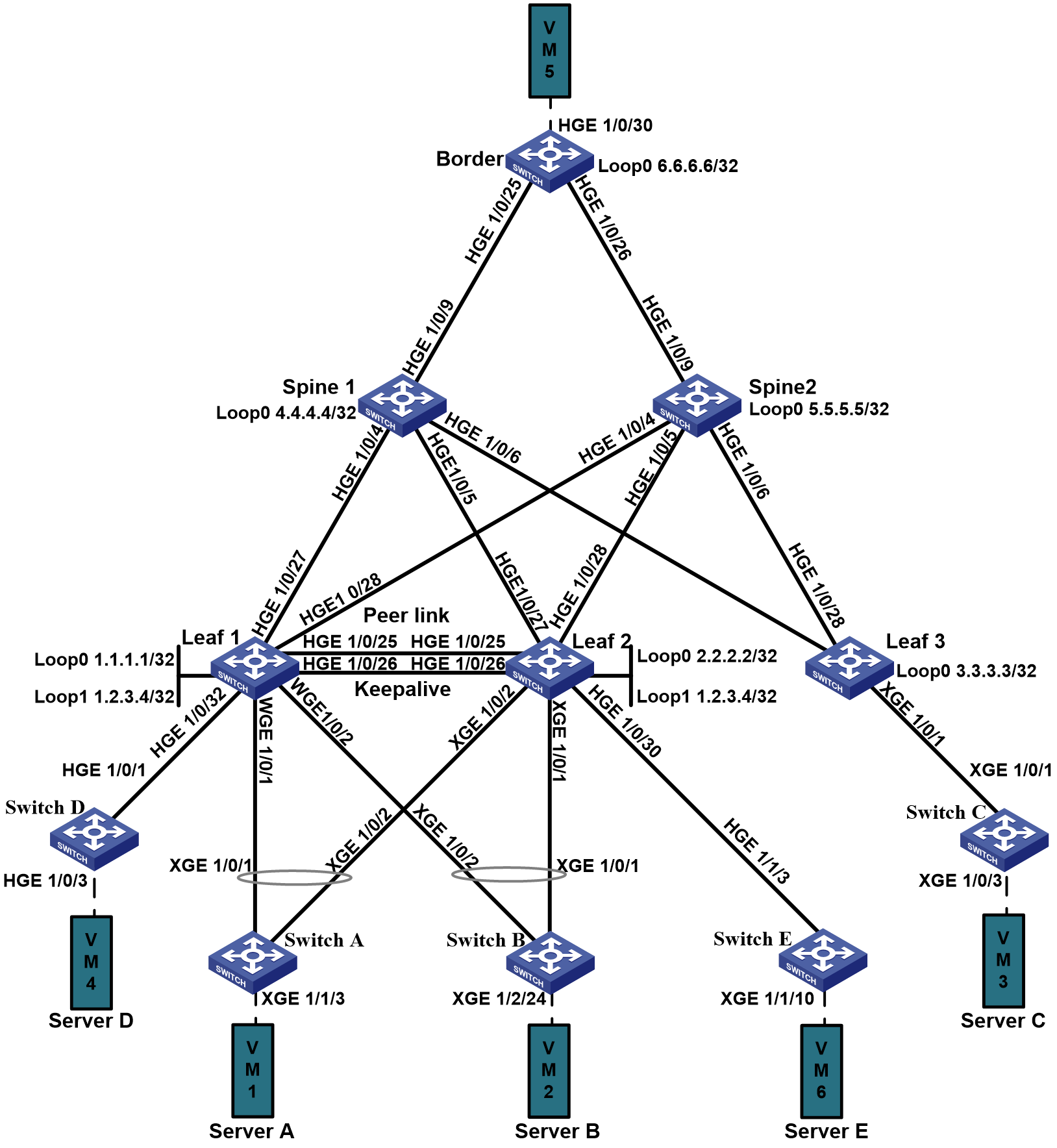

As shown in Figure 1:
· Leaf 1 and Leaf 2 are distributed EVPN gateways that are virtualized into one M-LAG system. The peer link is an Ethernet aggregate link.
· Spine 1 and Spine 2 act as RRs to reflect routes between the leaf devices and between the leaf and border devices.
· Switch A and Switch B each is dual-homed to Leaf 1 and Leaf 2 through an Ethernet aggregate link. To avoid single points of failure, a Layer 2 Ethernet interface that contains member ports across devices is configured for the links connected to each VM.
· Standalone device Leaf 3 is connected to Switch C through a Layer 2 aggregate link.
· Switch D and Switch E each is single-homed to Leaf 1 and Leaf 2 through a physical link.
· To forward VXLAN traffic from one M-LAG member to the other M-LAG member for single-homed ACs, the M-LAG member devices create VXLAN tunnels over the peer link.
· For Layer 3 communication, enable a routing protocol for route advertisement between Leaf 1 and Leaf 2 and the user network. The underlay network is an IPv4 network and the overlay network is an IPv4 and IPv6 network.
Table 1 Topology and IP assignment
Device |
Interface |
IP address |
Remarks |
Leaf 1 |
Loopback 0 |
1.1.1.1/32 |
VTEP address Used to establish BGP EVPN peer relationship |
Loopback 1 |
1.2.3.4/32 |
Virtual VTEP address |
VLAN-interface 4094 |
100.0.1.1/24 |
Attached to the link that forwards east-west traffic |
HGE 1/0/25 |
N/A |
Attached to the peer link Connected to HGE 1/0/25 on Leaf 2 |
HGE 1/0/26 |
100.0.0.1/24 100::1/64 |
Attached to the keepalive link Connected to HGE 1/0/26 on Leaf 2. |
HGE 1/0/27 |
Borrowed from Loopback 0 |
Connected to HGE 1/0/4 on Spine 1. |
HGE 1/0/28 |
Connected to HGE 1/0/4 on Spine 2. |
HGE 1/0/32 |
N/A |
AC interface Connected to HGE 1/0/1 on Switch D |
WGE 1/0/1 |
N/A |
M-LAG group member port Connected to Server A |
WGE 1/0/2 |
N/A |
M-LAG group member port Connected to Server B |
VSI-interface 10 |
20.1.1.1/24 20:1:1:1::1/64 Virtual IP: 20.1.1.5/24 IPv6 virtual IP: 20:1:1:1::5/64 |
Gateway interface for VXLAN 100 |
VSI-interface 20 |
20.2.1.1/24 20:2:1:1::1/64 Virtual IP: 20.2.1.5/24 IPv6 virtual IP: 20:2:1:1::5/64 |
Gateway interface for VXLAN 101 |
VSI-interface 100 |
N/A |
Associated with a L3 VXLAN ID |
Leaf 2 |
Loopback 0 |
2.2.2.2/32 |
Loopback 1 |
1.2.3.4/32 |
100.0.1.2/24 |
HGE 1/0/25 |
N/A |
Attached to the peer link Connected to HGE 1/0/25 on Leaf 1 |
HGE 1/0/26 |
100.0.0.2/24 100::2/64 |
Attached to the keepalive link Connected to HGE 1/0/26 on Leaf 1 |
HGE 1/0/27 |
N/A |
Borrowed from Loopback 0 Connected to HGE 1/0/5 on Spine 1 |
HGE 1/0/28 |
N/A |
Borrowed from Loopback 0 Connected to HGE 1/0/5 on Spine 2 |
HGE 1/0/30 |
N/A |
Single-homed AC interface Connected to HGE 1/1/3 on Switch E |
XGE 1/0/1 |
N/A |
XGE 1/0/2 |
N/A |
VSI-interface 10 |
20.1.1.1/24 20:1:1:1::1/64 Virtual IP: 20.1.1.6/24 IPv6 virtual IP: 20:1:1:1::6/64 |
VSI-interface 20 |
20.2.1.1/24 20:2:1:1::1/64 Virtual IP: 20.2.1.6/24 IPv6 virtual IP: 20:2:1:1::6/64 |
VSI-interface 100 |
N/A |
Leaf 3 |
Loopback 0 |
3.3.3.3/32 |
HGE 1/0/27 |
Connected to HGE 1/0/6 on Spine 1 |
HGE 1/0/28 |
Connected to HGE 1/0/6 on Spine 2 |
XGE 1/0/1 |
N/A |
Member port of a Layer 2 aggregate interface Connected to Server 3 |
Spine 1 |
Loopback 0 |
4.4.4.4/32 |
HGE 1/0/4 |
N/A |
Borrowed from Loopback 0 Connected to HGE 1/0/27 on Leaf 1 |
HGE 1/0/5 |
N/A |
Borrowed from Loopback 0 Connected to HGE 1/0/27 on Leaf 2 |
HGE 1/0/6 |
N/A |
Borrowed from Loopback 0 Connected to HGE 1/0/27 on Leaf 3 |
HGE 1/0/9 |
30.0.0.1/24 |
Connected to HGE 1/0/25 on the border device |
Spine 2 |
Loopback 0 |
5.5.5.5/32 |
HGE 1/0/4 |
N/A |
Borrowed from Loopback 0 Connected to HGE 1/0/28 on Leaf 1 |
HGE 1/0/5 |
N/A |
Borrowed from Loopback 0 Connected to HGE 1/0/28 on Leaf 2 |
HGE 1/0/6 |
N/A |
Borrowed from Loopback 0 Connected to HGE 1/0/28 on Leaf 3 |
HGE 1/0/9 |
31.0.0.1/24 |
Connected to HGE 1/0/26 on the border device |
Border |
Loopback 0 |
6.6.6.6/32 |
HGE 1/0/25 |
30.0.0.2/24 |
Connected to HGE 1/0/9 on Spine 1 |
HGE 1/0/26 |
31.0.0.2/24 |
Connected to HGE 1/0/9 on Spine 2 |
HGE 1/0/30 |
50.0.0.1/24 |
Connected to the external network |
VSI-interface 100 |
N/A |

Leaf 1 and Leaf 2 form an M-LAG system and the same VSI interface on the leaf devices is assigned the same IP address and MAC address. As a result, the leaf devices cannot separately establish EBGP peer relationship with Switch A and Switch B. For Leaf 1 and Leaf 2 to separately establish EBGP peer relationship with the switches, you must assign different M-LAG virtual IP addresses to the same VSI interface on the leaf devices. Then, Leaf 1 and Leaf 2 each can use its own M-LAG virtual IP address to establish EBGP peer relationship with the switches. To configure an M-LAG virtual IP address on a VSI interface, use the port m-lag virtual-ip command.
For the servers to reach one another, configure Switch A through Switch E to import direct routes to EBGP.
M-LAG configuration
· When Leaf 1 and Leaf 2 create VXLAN tunnels over the peer link, the tunnel source IP address is the virtual VTEP address of the M-LAG system. The tunnel destination IP address is the VTEP address of the local leaf device. When traffic from a single-homed server is forwarded from one M-LAG member to the other M-LAG member through a VXLAN tunnel created on the peer link, the latter M-LAG member cannot decapsulate the traffic. To resolve this issue, use the vxlan default-decapsulation source interface loopback 0 command on the latter M-LAG member so that the M-LAG member can decapsulate the traffic.
· In this example, Leaf 1 is the primary device and Leaf 2 is the secondary device in the M-LAG system. When the peer link is disconnected, the links connecting Leaf 1 to Sever A and Sever B are also disconnected. However, the EBGP connections to Sever A and Sever B go down only when the BGP peer relationship expires. The convergence time is up to dozens seconds and even more than 100 seconds. To resolve this issue, use the m-lag mad include interface command on Leaf 1 to add the interfaces connected to Server A and Server B to the user-configured list of included ports. The interfaces will be shut down by M-LAG MAD when the M-LAG system splits.

Configuring the border device
Procedure summary
· Configuring the overlay network
· Configuring the links connected to the spine devices
· Configuring routing for communication with the external network
Border |
Configuration method |
Description |
Remarks |
ip vpn-instance vpn1 |
Manual or controller-based |
Create VPN instance vpn1 and enter VPN instance view. |
N/A |
route-distinguisher 1:106 |
Configure an RD for the VPN instance. |
N/A |
address-family ipv4 |
Enter VPN instance IPv4 address family view. |
N/A |
vpn-target 1:100 both |
Configure route targets for the VPN instance. |
N/A |
quit |
N/A |
N/A |
N/A |
address-family ipv6 |
Enter VPN instance IPv6 address family view. |
N/A |
N/A |
quit |
N/A |
N/A |
N/A |
address-family evpn |
Enter VPN instance EVPN view. |
N/A |
Configure route targets for EVPN. |
N/A |
quit |
N/A |
N/A |
N/A |
quit |
N/A |
N/A |
N/A |
interface vsi-interface 100 |
Create VSI-interface100 and enter VSI interface view. |
N/A |
description L3_vni |
Configure a description for the VSI interface. |
N/A |
ip binding vpn-instance vpn1 |
Associate VPN instance vpn1 with the VSI interface. |
N/A |
l3-vni 1000 |
Associate Layer 3 VXLAN ID 1000 with the VSI interface. |
N/A |
quit |
N/A |
N/A |
N/A |
Border |
Description |
Remarks |
ospf 1 router-id 6.6.6.6 |
Enable OSPF process 1 and enter OSPF process view. |
N/A |
non-stop-routing |
Enable NSR for the OSPF process. |
N/A |
stub-router include-stub on-startup 900 |
Configure the router as a stub router during reboot and specify the timeout time to 900 seconds to accelerate network convergence. |
N/A |
quit |
N/A |
N/A |
N/A |
interface loopback 0 |
Create interface Loopback 0 and enter loopback interface view. |
N/A |
ip address 6.6.6.6 32 |
Assign an IP address to the interface. |
This IP address will be used as the VTEP address of the device. Make sure the VTEP address is unique in the network. |
ospf 1 area 0 |
Enable OSPF process 1 on the interface. |
N/A |
quit |
N/A |
N/A |
N/A |
interface hundredgige 1/0/25 |
Enter the view of the interface connected to Spine 1. |
N/A |
port link-mode route |
Set the link mode of the interface to Layer 3. |
N/A |
flow-interval 5 |
Set the statistics polling interval to 5 seconds on the interface. |
N/A |
ip address 30.0.0.2 24 |
N/A |
ospf 1 area 0 |
N/A |
quit |
N/A |
N/A |
N/A |
interface hundredgige 1/0/26 |
Enter the view of the interface connected to Spine 2. |
N/A |
N/A |
flow-interval 5 |
N/A |
ip address 31.0.0.2 24 |
N/A |
ospf 1 area 0 |
N/A |
quit |
N/A |
N/A |
N/A |
bgp 30 |
Create BGP instance 30 and enter its view. |
N/A |
non-stop-routing |
Enable NSR for the BGP instance. |
N/A |
router-id 6.6.6.6 |
Specify a router ID for the BGP instance. |
N/A |
group spine external |
Create an EBGP peer group named spine. |
N/A |
peer spine as-number 20 |
Specify AS number 20 for the peer group. |
N/A |
peer spine connect-interface loopback 0 |
Specify source interface Loopback 0 for establishing TCP connections to the peer group. |
N/A |
peer spine ebgp-max-hop 64 |
Enable the local router to establish EBGP sessions to indirectly connected EBGP peers in peer group spine, and set the maximum hop count to 64. |
N/A |
peer 4.4.4.4 group spine |
Add peer 4.4.4.4 to peer group spine. |
N/A |
peer 5.5.5.5 group spine |
Add peer 5.5.5.5 to peer group spine. |
N/A |
address-family l2vpn evpn |
Enter BGP EVPN address family view. |
N/A |
peer spine enable |
Enable the local router to exchange unicast routing information with peer group spine. |
N/A |
quit |
N/A |
N/A |
N/A |
quit |
N/A |
N/A |
N/A |
Border |
Description |
Remarks |
interface hundredgige 1/0/30 |
Enter the view of the interface connected to the external network. |
N/A |
N/A |
Associate VPN instance vpn1 with the interface. |
N/A |
ip address 50.0.0.1 24 |
Assign an IPv4 address to the interface. |
N/A |
ipv6 address 50::1/64 |
Assign an IPv6 address to the interface. |
N/A |
quit |
N/A |
N/A |
N/A |
ip route-static vpn-instance vpn1 50.0.0.0 16 50.0.0.2 |
Configure a static route. |
N/A |
ipv6 route-static vpn-instance vpn1 50:: 32 50::2 |
Configure an IPv6 static route. |
N/A |
bgp 30 |
Enter BGP instance view. |
N/A |
Create BGP-VPN instance vpn1 and enter BGP-VPN instance view. |
N/A |
address-family ipv4 unicast |
Create the BGP-VPN IPv4 unicast address family and enter its view. |
N/A |
default-route imported |
Enable default route redistribution into the BGP routing table. |
N/A |
balance 4 |
Enable load balancing and set the maximum number of BGP ECMP routes used for load balancing to 4. |
N/A |
import-route static |
Import static routes to the BGP routing table for BGP to advertise the imported routes. |
N/A |
address-family ipv6 unicast |
Create the BGP-VPN IPv6 unicast address family and enter its view. |
N/A |
N/A |
balance 4 |
N/A |
N/A |
quit |
N/A |
N/A |
N/A |
