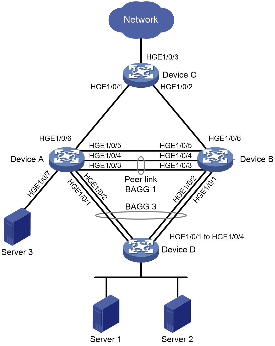

As shown in Figure 1:
·     Device A and Device B form an M-LAG system. Device D accesses the M-LAG system through M-LAG interfaces.
·     Device A and Device B are connected to uplink device Device C through equal-cost routes.
Configure the network as follows to meet the server access requirements of users:
·     The two M-LAG member devices Device A and Device B both act as the IPv4 gateway and IPv6 gateway for the servers.
·     If the link between Device A or Device B and uplink device Device C fails, packets can be transmitted along the other M-LAG member device to Device C to avoid interrupting the servers’ communication with the external network.
In some scenarios, the devices or servers attached to the M-LAG interfaces are required to establish routing peer relationships with the M-LAG member devices.
Figure 1 Network diagram

Routing peers to the M-LAG virtual IP addresses assigned to VLAN-interface 100 on the M-LAG member devices

Analysis
·     Configure VLAN-interface 100 on Device A and Device B to act as the IPv4 and IPv6 dual-active gateways. To enable IPv4 and IPv6 users to access the external network through the gateways, configure the same IPv4 address, MAC address, IPv6 address, and IPv6 link-local address for VLAN-interface 100 on Device A and Device B.
·     Enable Device A and Device B to communicate at Layer 3 through VLAN-interface 101. Then, packets can be routed to the other M-LAG member device when the link between Device A or Device B and uplink device Device C fails.
All the devices were started with the factory default configuration. When you are working on a live network, make sure the existing configuration does not conflict with the following configuration.
The M-LAG system MAC address must be the same for devices in the same M-LAG system. The M-LAG system MAC addresses must be different for devices in different M-LAG systems.
For how to set the MAC addresses for dual-active gateways on S12500X-AF series switches, see S12500X-AF MAC address configuration guide in the recommended M-LAG networking solutions.

port trunk permit vlan 100
Assign the interface to VLAN 100.
port lacp system-priority 100
port lacp system-priority 101
Set the LACP system priority, so that only member ports with higher priority are selected when both peer link and keepalive link fail.
N/A
interface bridge-aggregation 1
N/A
port link-type trunk
Set the link type of the Layer 2 aggregate interface (Bridge-Aggregation 1) to trunk.
port trunk permit vlan all
Assign the interface to all VLANs.
N/A
interface vlan-interface 100
Create VLAN-interface 100.
ip address 100.1.1.100 24
Assign an IPv4 address to VLAN-interface 100, which is to act as an IPv4 dual-active gateway.
mac-address 0000-0010-0010
Assign a MAC address to VLAN-interface 100, which is to act as an IPv4 dual-active gateway.
ipv6 address 100::100 64
Assign an IPv6 address to VLAN-interface 100, which is to act as an IPv6 dual-active gateway.
ipv6 address FE80::80 link-local
Assign a link-local address to VLAN-interface 100, which is to act as an IPv6 dual-active gateway.
ipv6 nd unsolicited-na-learning enable
Enable unsolicited NA learning.
For ND entries to be synchronous on M-LAG member devices, enable this feature.
N/A
m-lag mad exclude interface Vlan-interface100
Exclude VLAN-interface100 from the shutdown action by M-LAG MAD.
interface vlan-interface 101
Create VLAN-interface 101.
ip address 101.1.1.1 24
ip address 101.1.1.2 24
Assign an IPv4 address to VLAN-interface 101, which is used for Layer 3 communication between M-LAG member devices.
ipv6 address 101::1 64
ipv6 address 101::2 64
Assign an IPv6 address to VLAN-interface 101, which is used for Layer 3 communication between M-LAG member devices.
N/A
m-lag mad exclude interface Vlan-interface101
Exclude VLAN-interface101 from the shutdown action by M-LAG MAD.
Configuring Layer 3 communication between M-LAG member devices
Device A
Device B
Description
router id 3.3.3.3
router id 4.4.4.4
Configure a router ID.
ospf 1
ospf 1
Configure OSPF to enable M-LAG member devices to communicate through an IPv4 network.
stub-router include-stub on-startup 900
Specify the cost of the stub links (link type 3) in Router LSAs to the maximum value 65535 to accelerate network convergence.
silent-interface Vlan-interface 100
Disable VLAN-interface 100 from receiving and sending OSPF packets.
area 0
area 0
N/A
N/A
N/A
ospf 1 area 0
ospf 1 area 0
Enable OSPF on an interface.
N/A
N/A
ospf 1 area 0
ospf 1 area 0
N/A
ospfv3 1
ospfv3 1
Configure OSPFv3 to enable M-LAG member devices to communicate through an IPv6 network.
router-id 3.3.3.3
router-id 4.4.4.4
stub-router max-metric on-startup 900
Specify the cost of the links in Type-1 LSAs to the maximum value 65535 and specify the router as a stub router during reboot.
area 0
area 0
N/A
N/A
N/A
ospfv3 1 area 0
ospfv3 1 area 0
Enable OSPFv3 on an interface.
N/A
N/A
ospfv3 1 area 0
ospfv3 1 area 0
N/A
Configuring the interconnect links between the M-LAG system and the uplink device Device C
Device A
Device B
Description
vlan 32
vlan 33
Create a VLAN.
N/A
interface HundredGigE 1/0/6
N/A
Set the link type of the interface to trunk.
port trunk permit vlan 32
port trunk permit vlan 33
Assign the interface to the specified VLANs.
undo port trunk permit vlan 1
Remove the interface from VLAN 1.
undo stp enable
undo stp enable
Disable STP on the uplink interface to speed up topology convergence.
N/A
interface vlan-interface 32
interface vlan-interface 33
Create a VLAN interface.
ip address 32.1.1.1 24
ip address 33.1.1.1 24
Assign an IPv4 address to a VLAN-interface.
ipv6 address 32::1 64
ipv6 address 33::1 64
Assign an IPv6 address to a VLAN-interface.
ospf 1 area 0
ospf 1 area 0
ospfv3 1 area 0
ospfv3 1 area 0
N/A
Configuring the single-homed interface of the M-LAG system
Device A
Description
vlan 100
Create a VLAN.
N/A
interface HundredGigE 1/0/7
Configure the single-homed interface.
port link-mode bridge
Configure the interface to operate in bridge mode as a Layer 2 interface.
port link-type access
Set the link type of the interface to access.
port access vlan 100
Assign the interface to the specified VLAN.
Configuring a dynamic routing protocol used for communication with Device D
Perform this task if the devices or servers attached to the M-LAG member devices are required to establish routing peer relationships with the M-LAG member devices.
Device A
Device B
Description
N/A
port m-lag virtual-ip 100.1.1.101 255.255.255.0 active
port m-lag virtual-ip 100.1.1.102 255.255.255.0 active
Assign an M-LAG virtual IPv4 address to this VLAN interface.
port m-lag ipv6 virtual-ip FE80::81 link-local
port m-lag ipv6 virtual-ip FE80::82 link-local
Assign an M-LAG link-local virtual IPv6 address to this VLAN interface.
port m-lag ipv6 virtual-ip 100::101 64 active
port m-lag ipv6 virtual-ip 100::102 64 active
Assign an M-LAG virtual IPv6 address to this VLAN interface, and set the state of the address to active.
ospf peer sub-address enable 100.1.1.101
ospf peer sub-address enable 100.1.1.102
Enable OSPF to use secondary IP addresses to set up peer relationships.
N/A
Configuring uplink device Device C
Procedure summary
·     Configuring the interconnect links to the M-LAG member devices
·     Configuring the interconnect links between the uplink device Device C and the network
Device C
Description
vlan 32
Create VLAN 32.
N/A
interface HundredGigE 1/0/1
N/A
Assign HundredGigE 1/0/1 (which connects Device C to Device A) to VLAN 32.
undo stp enable
Disable the spanning tree protocol to speed up topology convergence.
N/A
Create VLAN-interface 32.
ip address 32.1.1.2 24
Assign an IPv4 address to the VLAN-interface.
ipv6 address 32::2 64
Assign an IPv6 address to the VLAN-interface.
N/A
vlan 33
Create VLAN 33.
N/A
interface HundredGigE 1/0/2
N/A
Assign HundredGigE 1/0/2 (which connects Device C to Device B) to VLAN 33.
undo stp enable
N/A
Create VLAN-interface 33.
ip address 33.1.1.2 24
ipv6 address 33::2 64
N/A
router id 5.5.5.5
ospf 1
area 0
N/A
N/A
N/A
ospf 1 area 0
Enable OSPF on the interface.
N/A
N/A
ospf 1 area 0
N/A
ospfv3 1
router id 5.5.5.5
Configure a Router ID.
area 0
N/A
N/A
N/A
ospfv3 1 area 0
Enable OSPFv3 on the interface.
N/A
N/A
ospfv3 1 area 0
N/A
Device C
Description
vlan 22
Create VLAN 22.
N/A
interface HundredGigE 1/0/3
N/A
port trunk permit vlan 22
Assign HundredGigE 1/0/3 (which connects Device C to the network) to VLAN 22.
undo stp enable
N/A
interface vlan-interface 22
Create VLAN-interface 22.
ip address 22.1.1.1 24
ipv6 address 22::1 64
N/A
Configuring downlink device Device D
Procedure summary
·     Setting up OSPF and OSPFv3 peer relationships with the M-LAG member devices
Device D
Description
interface bridge-aggregation 3
Create Layer 2 aggregate interface Bridge-Aggregation 3, and enter its view.
link-aggregation mode dynamic
Configure the aggregate interface connecting to the M-LAG system to operate in dynamic mode.
N/A
interface range HundredGigE 1/0/1 to HundredGigE 1/0/4
Enter the view of the physical interfaces connecting Device D to the M-LAG system.
port link-aggregation group 3
Assign interfaces to an aggregation group.
N/A
vlan 100
Create VLAN 100.
N/A
N/A
N/A
Device D
Description
router id 6.6.6.6
Configure the router ID.
ospf 1
Configure OSPF to set up IPv4 connectivity to the M-LAG member devices.
area 0
Create an OSPF area and enter its view.
N/A
N/A
ip address 100.1.1.110 255.255.255.0
Assign an IPv4 address to this VLAN interface.
ipv6 address FE80::83 link-local
Assign an IPv6 link-local address to this VLAN interface.
ipv6 address 100::110 64
Assign an IPv6 address to this VLAN interface.
ospf 1 area 0.0.0.0
Enable OSPF on VLAN-interface 100.
ospfv3 1 area 0.0.0.0
Enable OSPFv3 on VLAN-interface 100.
N/A

Verifying the status of the M-LAG system
Verify that the peer-link interface and the M-LAG interface are working correctly on Device A and Device B. Use Device A as an example.
# Display summary information about the peer-link interface and M-LAG interface.
[DeviceA] display m-lag summary
Flags: A -- Aggregate interface down, B -- No peer M-LAG interface configured
       C -- Configuration consistency check failed
Peer-link interface: BAGG1
Peer-link interface state (cause): UP
Keepalive link state (cause): UP
                     M-LAG interface information
M-LAG IF    M-LAG group  Local state (cause)  Peer state  Remaining down time (s)
BAGG3       1            UP                   UP          -
# Verify that keepalive link is working correctly.
[DeviceA] display m-lag keepalive
Neighbor keepalive link status: Up
Neighbor is alive for: 64765 s 28 ms
Keepalive packet transmission status:
  Sent: Successful
  Received: Successful
Last received keepalive packet information:
  Source IP address: 21.1.1.2
  Time: 2021/01/17 17:10:52
  Action: Accept
M-LAG keepalive parameters:
Destination IP address: 21.1.1.2
Source IP address: 21.1.1.1
Keepalive UDP port : 6400
Keepalive VPN name : N/A
Keepalive interval : 1000 ms
Keepalive timeout  : 5 sec
Keepalive hold time: 3 sec
# Display the M-LAG system settings.
<DeviceA> display m-lag system
                     System information
Local system number: 1                      Peer system number: 2
Local system MAC: 0002-0002-0002            Peer system MAC: 0002-0002-0002
Local system priority: 123                  Peer system priority: 123
Local bridge MAC: 3cd4-3ce1-0200            Peer bridge MAC: 3cd4-437d-0300
Local effective role: Primary               Peer effective role: Secondary
Health level: 0
Standalone mode on split: Enabled
In standalone mode: No
                     System timer information
Timer                      State       Value (s)    Remaining time (s)
Auto recovery              Disabled    -            -
Restore delay              Disabled    300          -
Consistency-check delay    Disabled    150          -
Standalone delay           Disabled    -            -
Role to None delay         Disabled    60           -
# Display detailed information about the peer-link interface and M-LAG interfaces.
[DeviceA] display m-lag verbose
Flags: A -- Home_Gateway, B -- Neighbor_Gateway, C -- Other_Gateway,
       D -- PeerLink_Activity, E -- DRCP_Timeout, F -- Gateway_Sync,
       G -- Port_Sync, H -- Expired
Peer-link interface/Peer-link interface ID: BAGG1/1
State: UP
Cause: -
Local DRCP flags/Peer DRCP flags: ABDFG/ABDFG
Local Selected ports (index): HGE1/0/3 (27), HGE1/0/4 (32)
Peer Selected ports indexes: 125, 130
M-LAG interface/M-LAG group ID: BAGG3/1
Local M-LAG interface state: UP
Peer M-LAG interface state: UP
M-LAG group state: UP
Local M-LAG interface down cause: -
Remaining M-LAG DOWN time: -
Local M-LAG interface LACP MAC: Config=0002-0002-0002, Effective=0002-0002-0002
Peer M-LAG interface LACP MAC: Config=0002-0002-0002, Effective=0002-0002-0002
Local M-LAG interface LACP priority: Config=123, Effective=123
Peer M-LAG interface LACP priority: Config=123, Effective=123
Local Selected ports (index): HGE1/0/1 (12), HGE1/0/2 (13)
Peer Selected ports indexes: 56, 57
Verifying the routing protocols
# Display the OSPF neighbors of Device A.
[DeviceA] display ospf peer
         OSPF Process 1 with Router ID 3.3.3.3
               Neighbor Brief Information
 Area: 0.0.0.0
 Router ID       Address         Pri Dead-Time  State             Interface
 4.4.4.4         101.1.1.2       1   36         Full/DR           Vlan101
 5.5.5.5         32.1.1.2        1   38         Full/DR           Vlan32
 6.6.6.6         100.1.1.110     1   36         Full/DR           Vlan100
# Display the OSPFv3 neighbors of Device A.
[DeviceA] display ospfv3 peer
               OSPFv3 Process 1 with Router ID 3.3.3.3
 Area: 0.0.0.0
 Router ID       Pri State             Dead-Time InstID Interface
 4.4.4.4         1   Full/DR           00:00:36  0      Vlan101
 5.5.5.5         1   Full/DR           00:00:35  0      Vlan32
 6.6.6.6         1   Full/DR           00:00:35  0      Vlan100
# Display the OSPF neighbors of Device B.
[DeviceB] display ospf peer
         OSPF Process 1 with Router ID 4.4.4.4
 Area: 0.0.0.0
 3.3.3.3         101.1.1.1       1   32         Full/BDR          Vlan101
 5.5.5.5         33.1.1.2        1   33         Full/DR           Vlan33
# Display the OSPFv3 neighbors of Device B.
[DeviceB] display ospfv3 peer
               OSPFv3 Process 1 with Router ID 4.4.4.4
 Area: 0.0.0.0
 3.3.3.3         1   Full/BDR          00:00:35  0      Vlan101
 5.5.5.5         1   Full/DR           00:00:38  0      Vlan33
 6.6.6.6         1   Full/DR           00:00:36  0      Vlan100
# Display the OSPF neighbors of Device C.
[DeviceC] display ospf peer
         OSPF Process 1 with Router ID 5.5.5.5
 Area: 0.0.0.0
 3.3.3.3         32.1.1.1        1   32         Full/DR           Vlan32
 4.4.4.4         33.1.1.1        1   38         Full/DR           Vlan33
# Display the OSPFv3 neighbors of Device C.
[DeviceC] display ospfv3 peer
               OSPFv3 Process 1 with Router ID 5.5.5.5
 Area: 0.0.0.0
 3.3.3.3         1   Full/DR           00:00:37  0      Vlan32
 4.4.4.4         1   Full/DR           00:00:34  0      Vlan33
Verifying that Server 1 and Server 2 can communicate with Network
Server 1 and Server 2 can communicate with Network through both IPv4 and IPv6 addresses.
Verifying that Server 1 and Server 2 can still communicate with Network when the uplink interface of Device A or Device B fails
Disconnect the interface connecting Device A to Device C. Server 1 and Server 2 can still communicate with Network (transient packet loss occurs during the traffic switchover process).
Displaying the brief spanning tree status and statistics
<DeviceA> display stp brief
 MST ID      Port                         Role  STP State     Protection
 0           Bridge-Aggregation3 (M-LAG)     DESI  FORWARDING    NONE
<DeviceB> display stp brief
Verifying OSPF and OSPFv3 peer establishment with the M-LAG virtual IP addresses
[DeviceD]display ospf peer
         OSPF Process 1 with Router ID 6.6.6.6
 Area: 0.0.0.0
 3.3.3.3         100.1.1.101     1   38         Full/DR           Vlan100
 4.4.4.4         100.1.1.102     1   33         Full/DROther      Vlan100
[DeviceD]display ospfv3 peer
               OSPFv3 Process 1 with Router ID 6.6.6.6
 Area: 0.0.0.0
 3.3.3.3         1   Full/DROther      00:00:32  0      Vlan100
 4.4.4.4         1   Full/BDR          00:00:34  0      Vlan100
