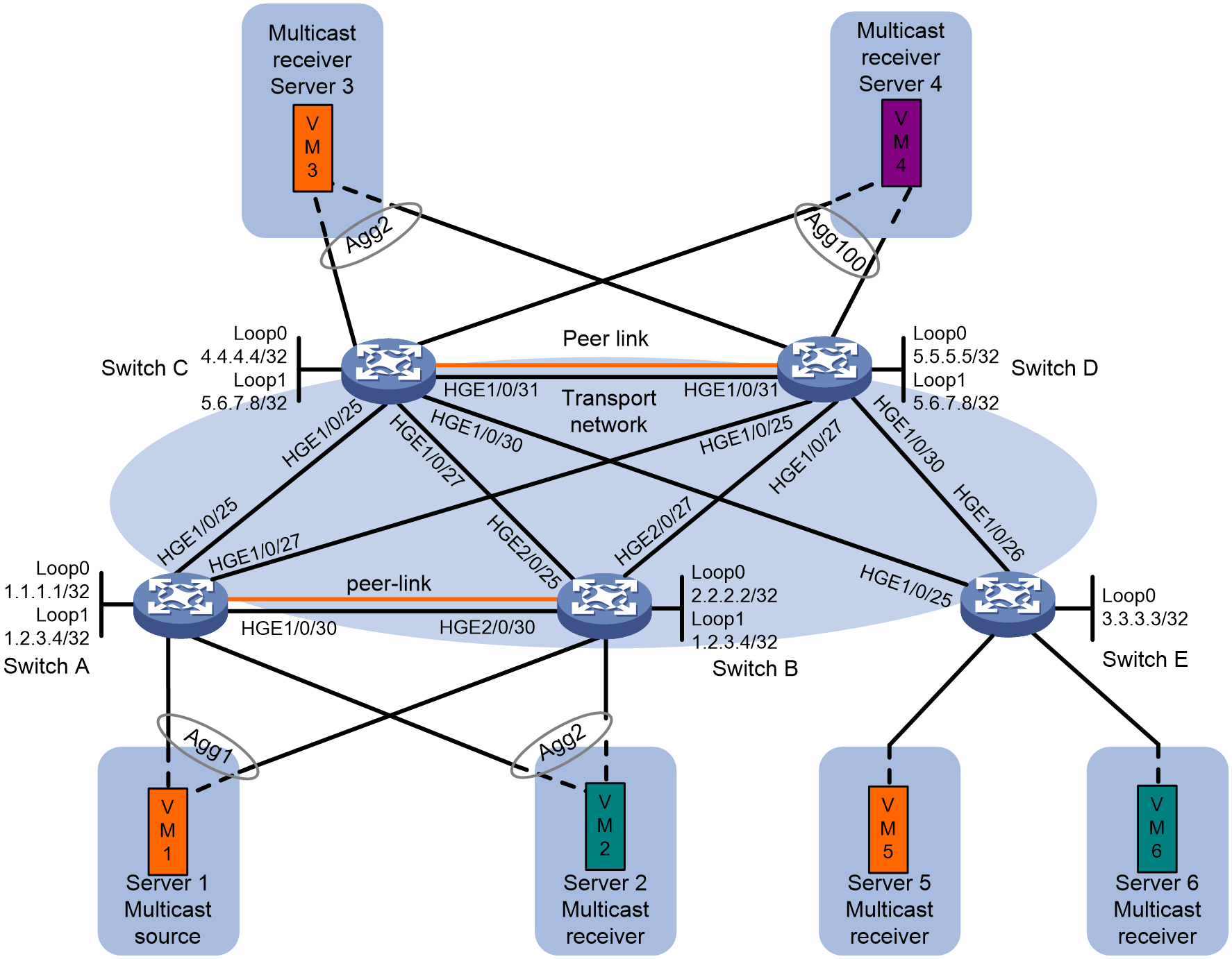

Example: Configuring M-LAG with MDT-based MVXLAN
As shown in Figure 1:
· Switch A, Switch B, Switch C, Switch D, and Switch E are distributed EVPN gateways.
¡ Leaf devices Switch A and Switch B form an M-LAG system through M-LAG, and they use the peer link to synchronize MAC and ARP entries to ensure MAC and ARP entry consistency. In this example, an Ethernet aggregate link acts as the peer link.
¡ Switch C and Switch D form an M-LAG system through M-LAG, and the M-LAG system acts all the roles of spine, border, and leaf. In this example, an Ethernet aggregate link acts as the peer link.
¡ Switch E acts as a standalone leaf device.
· Switch A and Switch B are connected to VM 1 and VM 2 through Ethernet links. On Switch A and Switch B, the Ethernet links connected to the same VM are aggregated into a Layer 2 aggregation group to avoid single points of failure. Connect Switch C, Switch D, and VMs in the same way Switch A, Switch B, VM 1, and VM 2 are connected.
· VM 1 is the multicast source. VM 2, VM 3, VM 5, and VM 6 are multicast receivers in a private network. VM 4 is a multicast receiver in the public network. They use MVXLAN to transmit multicast traffic.
Device |
Interface |
IP address |
Switch A |
Loopback 0 |
1.1.1.1/32 |
Loopback 1 |
1.2.3.4/32 |
Loopback 2 |
1.2.3.4/32 |
HundredGigE 1/0/25 |
11.1.1.2/24 |
HundredGigE 1/0/27 |
12.1.1.2/24 |
HundredGigE 1/0/30 |
21.0.0.1/24 |
VSI-interface 1 |
10.1.1.1/24 |
VSI-interface 2 |
10.1.2.1/24 |
Switch B |
Loopback 0 |
2.2.2.2/32 |
Loopback 1 |
1.2.3.4/32 |
Loopback 2 |
1.2.3.4/32 |
HundredGigE 2/0/25 |
13.1.1.2/24 |
HundredGigE 2/0/27 |
14.1.1.2/24 |
HundredGigE 2/0/30 |
21.0.0.2/24 |
VSI-interface 1 |
10.1.1.1/24 |
VSI-interface 2 |
10.1.2.1/24 |
Switch C |
Loopback 0 |
4.4.4.4/32 |
Loopback 1 |
5.6.7.8/32 |
Loopback 2 |
5.6.7.8/32 |
11.1.1.1/24 |
13.1.1.1/24 |
15.1.1.1/24 |
HundredGigE 1/0/31 |
21.1.0.1 |
VSI-interface 1 |
10.1.1.1/24 |
VSI-interface 2 |
10.1.2.1/24 |
VLAN-interface 100 |
100.1.1.3/24 |
Switch D |
Loopback 0 |
5.5.5.5/32 |
Loopback 1 |
5.6.7.8/32 |
Loopback 2 |
5.6.7.8/32 |
12.1.1.1/24 |
14.1.1.1/24 |
16.1.1.1/24 |
21.1.0.2 |
VSI-interface 1 |
10.1.1.1/24 |
VSI-interface 2 |
10.1.2.1/24 |
100.1.1.4/24 |
Switch E |
Loopback 0 |
3.3.3.3/32 |
Loopback 1 |
3.3.3.3/32 |
15.1.1.2/24 |
HundredGigE 1/0/26 |
16.1.1.2/24 |
VSI-interface 1 |
10.1.1.1/24 |
VSI-interface 2 |
10.1.2.1/24 |

l2vpn m-lag peer-link ac-match-rule vxlan-mapping |
Enable the switch to create frame match criteria based on VXLAN IDs for the dynamic ACs on the peer link. |
evpn m-lag group 1.2.3.4 |
Enable EVPN distributed relay and specify the virtual VTEP address. |
evpn m-lag local 1.1.1.1 remote 2.2.2.2 |
evpn m-lag local 2.2.2.2 remote 1.1.1.1 |
Specify the IP addresses of the local and peer VTEPs in the M-LAG system. |
m-lag restore-delay 300 |
Set the data restoration interval to 300 seconds. |
m-lag system-mac 0021-0021-0021 |
Configure the M-LAG system MAC address. |
m-lag system-number 1 |
m-lag system-number 2 |
Set the M-LAG system number. |
m-lag system-priority 21 |
Set the M-LAG system priority. |
m-lag standalone enable |
Enable M-LAG standalone mode. |
m-lag keepalive ip destination 21.0.0.2 source 21.0.0.1 |
m-lag keepalive ip destination 21.0.0.1 source 21.0.0.2 |
Configure M-LAG keepalive packet parameters. |
interface bridge-aggregation 1 |
Create Layer 2 aggregate interface Bridge-Aggregation 1 and enter its view. |
link-aggregation mode dynamic |
Configure the aggregation group to operate in dynamic aggregation mode and enable LACP. |
quit |
quit |
N/A |
interface hundredgige 1/0/29 |
interface hundredgige 2/0/29 |
Enter interface view. |
port link-aggregation group 1 |
Assign the interface to aggregation group 1. |
quit |
quit |
N/A |
Enter the view of Bridge-Aggregation 1. |
port m-lag peer-link 1 |
Configure Bridge-Aggregation 1 as the peer-link interface. |
undo mac-address static source-check enable |
Disable static source check to ensure correct Layer 3 forwarding over the peer link. |
quit |
quit |
N/A |
interface bridge-aggregation 2 |
Create Layer 2 aggregate interface Bridge-Aggregation 2 and enter its view. |
port trunk pvid vlan 4040 |
Configure the Layer 2 aggregate interface as a trunk port and set its PVID to 4040. |
quit |
quit |
N/A |
interface hundredgige 1/0/26 |
interface hundredgige 2/0/26 |
port link-aggregation group 2 |
Assign the interface to aggregation group 2. |
quit |
quit |
N/A |
Enter the view of Bridge-Aggregation 2. |
port link-type trunk |
Set the link type of the aggregate interface to trunk. |
undo port trunk permit vlan 1 |
Remove the aggregate interface from VLAN 1. |
port trunk permit vlan 2 to 3 |
Assign the aggregate interface to VLANs 2 and 3. |
port m-lag group 2 |
Assign the aggregate interface to M-LAG group 2. |
quit |
quit |
N/A |
m-lag mad exclude interface hundredgige 1/0/25 |
m-lag mad exclude interface hundredgige 2/0/25 |
Exclude an interface from the M-LAG MAD shutdown action. |
m-lag mad exclude interface hundredgige 1/0/27 |
m-lag mad exclude interface hundredgige 2/0/27 |
m-lag mad exclude interface hundredgige 1/0/30 |
m-lag mad exclude interface hundredgige 2/0/30 |
m-lag mad exclude interface loopback 0 |
m-lag mad exclude interface loopback 1 |
m-lag mad exclude interface loopback 2 |
m-lag mad exclude interface vsi-interface 1 |
m-lag mad exclude interface vsi-interface 2 |
m-lag mad exclude interface vsi-interface 3 |
bgp 100 |
bgp 100 |
Create BGP instance 100. |
router-id 1.1.1.1 |
router-id 2.2.2.2 |
Configure a router ID for the BGP instance. |
peer 4.4.4.4 as-number 100 |
Specify an AS number for a peer group. |
peer 4.4.4.4 connect-interface loopback 0 |
Specify a source interface for establishing TCP connections to a peer or peer group. |
peer 5.5.5.5 as-number 100 |
peer 5.5.5.5 connect-interface loopback 0 |
address-family l2vpn evpn |
Enter BGP EVPN address family view. |
peer 4.4.4.4 enable |
Enable BGP to exchange unicast routing information with a peer or peer group. |
peer 5.5.5.5 enable |
quit |
quit |
N/A |
quit |
quit |
N/A |
service-instance 1000 |
Create Ethernet service instance 1000. |
encapsulation s-vid 2 |
Configure a frame match criterion for the Ethernet service instance. |
xconnect vsi vpn1 |
xconnect vsi vpn1 |
Map VSI vpn1 to the Ethernet service instance. |
service-instance 1001 |
Create Ethernet service instance 1001. |
encapsulation s-vid 3 |
xconnect vsi vpn2 |
xconnect vsi vpn2 |
Map VSI vpn2 to the Ethernet service instance. |
quit |
quit |
N/A |
quit |
quit |
N/A |
igmp-snooping |
igmp-snooping |
Enable IGMP snooping on the switch and enter IGMP-snooping view. |
quit |
quit |
N/A |
vsi vpn1 |
vsi vpn1 |
Enter the view of VSI vpn1. |
igmp-snooping enable |
Enable IGMP snooping for the VSI. |
pim-snooping enable |
Enable PIM snooping for the VSI. |
igmp-snooping proxy enable |
Enable IGMP snooping proxying for the VSI. |
quit |
quit |
N/A |
vsi vpn2 |
vsi vpn2 |
Enter the view of VSI vpn2. |
quit |
quit |
N/A |
multicast-vpn vxlan vpn-instance vpn1 mode mdt |
Create an MDT-based MVXLAN. |
address-family ipv4 |
Enter MVXLAN IPv4 address family view. |
source loopback 1 evpn-m-lag-group |
Specify the virtual VTEP address of the M-LAG member devices as the IP address of the source interface. |
default-group 239.0.0.1 |
Configure the default group. |
data-group 239.0.1.0 255.255.255.128 |
Configure the data group range. |
Specify the IP addresses of the local and remote M-LAG member devices. |
quit |
quit |
N/A |
quit |
quit |
N/A |
multicast routing |
multicast routing |
Enable IP multicast routing for the public network. |
quit |
quit |
N/A |
multicast routing vpn-instance vpn1 |
Enable IP multicast routing for VPN instance vpn1. |
quit |
quit |
N/A |
pim |
pim |
Enable PIM for the public network. |
c-bsr 1.1.1.1 |
c-bsr 2.2.2.2 |
Configure a candidate-BSR. |
c-rp 1.1.1.1 |
c-rp 2.2.2.2 |
Configure a candidate-RP. |
quit |
quit |
N/A |
pim vpn-instance vpn1 |
Enable PIM for VPN instance vpn1. |
c-bsr 1.2.3.4 |
c-bsr 1.2.3.4 |
c-rp 1.2.3.4 |
c-rp 1.2.3.4 |

area 0.0.0.0 |
area 0.0.0.0 |
Create an OSPF area. |
quit |
quit |
N/A |
quit |
quit |
N/A |
ospf 2 vpn-instance external_vpn |
Enable OSPF process 2 and specify VPN instance external_vpn for the process. |
stub-router include-stub on-startup 900 |
Configure the router as a stub router during reboot and specify the timeout time to 900 seconds. |
area 0.0.0.0 |
area 0.0.0.0 |
quit |
quit |
N/A |
quit |
quit |
N/A |
pim sm |
pim sm |
Enable PIM SM on the interface. |
ospf 1 area 0.0.0.0 |
Enable OSPF process 1 on the interface. |
quit |
quit |
N/A |
pim sm |
pim sm |
quit |
quit |
N/A |
pim sm |
pim sm |
quit |
quit |
N/A |
Create Loopback 0 and enter loopback interface view. |
pim sm |
pim sm |
quit |
quit |
N/A |
Create Loopback 1 and enter loopback interface view. |
pim sm |
pim sm |
quit |
quit |
N/A |
Create Loopback 2 and enter loopback interface view. |
ip binding vpn-instance vpn1 |
Associate the interface with VPN instance vpn1. |
pim sm |
pim sm |
quit |
quit |
N/A |
l2vpn enable |
l2vpn enable |
Enable L2VPN. |
vxlan tunnel mac-learning disable |
Disable remote-MAC address learning. |
vxlan tunnel arp-learning disable |
Disable remote ARP learning for VXLANs. |
evpn global-mac 0001-0002-0004 |
Configure the EVPN global MAC address. |
vsi vpn1 |
vsi vpn1 |
Create VSI vpn1 and enter VSI view. |
flooding disable unknown-unicast unknown-multicast |
Disable flooding for the VSI. |
vxlan 10 |
vxlan 10 |
Create VXLAN 10 and enter its view. |
quit |
quit |
N/A |
evpn encapsulation vxlan |
Create an EVPN instance. |
route-distinguisher auto |
Configure the switch to automatically generate an RD for the EVPN instance. |
vpn-target auto |
vpn-target auto |
Configure the switch to automatically generate a route target for the EVPN instance. |
quit |
quit |
N/A |
quit |
quit |
N/A |
vsi vpn2 |
vsi vpn2 |
Create VSI vpn2 and enter VSI view. |
vxlan 20 |
vxlan 20 |
Create VXLAN 20 and enter its view. |
quit |
quit |
N/A |
vpn-target auto |
vpn-target auto |
quit |
quit |
N/A |
quit |
quit |
N/A |
Create VSI-interface 1. |
Associate the VSI interface with VPN instance vpn1. |
mac-address 0001-0001-0001 |
Configure the MAC address of the VSI interface. |
local-proxy-arp enable |
Enable local proxy ARP on the VSI interface. |
distributed-gateway local |
Specify the VSI interface as a distributed gateway. |
pim distributed-dr |
Configure the VSI interface as a distributed designated router interface. |
igmp enable |
igmp enable |
Enable IGMP on the VSI interface. |
pim sm |
pim sm |
Enable PIM SM on the VSI interface. |
quit |
quit |
N/A |
Create VSI-interface 2. |
mac-address 0002-0002-0002 |
igmp enable |
igmp enable |
pim sm |
pim sm |
quit |
quit |
N/A |
Create VSI-interface 3. |
pim sm |
pim sm |
l3-vni 1000 |
l3-vni 1000 |
Configure the L3 VXLAN ID as 1000 for the VPN instance. |
quit |
quit |
N/A |
interface vsi-interface 4 |
Create VSI-interface 4. |
ip binding vpn-instance external_vpn |
Associate the VSI interface with VPN instance external_vpn. |
pim sm |
pim sm |
l3-vni 2000 |
l3-vni 2000 |
Configure the L3 VXLAN ID as 2000 for the VPN instance. |
quit |
quit |
N/A |
vsi vpn1 |
vsi vpn1 |
gateway vsi-interface 1 |
Specify VSI-interface 1 as the gateway interface for the VSI. |
quit |
quit |
N/A |
vsi vpn2 |
vsi vpn2 |
gateway vsi-interface 2 |
Specify VSI-interface 2 as the gateway interface for the VSI. |
quit |
quit |
N/A |
evpn m-lag group 5.6.7.8 |
evpn m-lag local 4.4.4.4 remote 5.5.5.5 |
evpn m-lag local 5.5.5.5 remote 4.4.4.4 |
m-lag system-mac 0022-0022-0022 |
m-lag system-priority 22 |
m-lag keepalive ip destination 21.1.0.2 source 21.1.0.1 |
m-lag keepalive ip destination 21.1.0.1 source 21.1.0.2 |
quit |
quit |
N/A |
interface hundredgige 1/0/32 |
quit |
quit |
N/A |
Configure the aggregate interface as the peer-link interface. |
port trunk pvid vlan 4050 |
Configure the aggregate interface as a trunk port and set its PVID to 4050. |
quit |
quit |
N/A |
quit |
quit |
N/A |
quit |
quit |
N/A |
vlan 2 to 3 100 |
vlan 2 to 3 100 |
Create VLANs 2, 3, and 100. |
quit |
quit |
N/A |
xconnect vsi vpn1 |
xconnect vsi vpn1 |
Map the Ethernet service instance to VSI vpn1. |
xconnect vsi vpn2 |
xconnect vsi vpn2 |
Map the Ethernet service instance to VSI vpn2. |
quit |
quit |
N/A |
quit |
quit |
N/A |
interface bridge-aggregation 100 |
Create Layer 2 aggregate interface Bridge-Aggregation 100 and enter its view. |
quit |
quit |
N/A |
port link-aggregation group 100 |
Assign the interface to aggregation group 100. |
quit |
quit |
N/A |
Enter the view of Bridge-Aggregation 100. |
port trunk permit vlan 100 |
Assign the aggregate interface to VLAN 100. |
port m-lag group 100 |
Assign the aggregate interface to M-LAG group 100. |
quit |
quit |
N/A |
interface hundredgige 1/0/31 |
pim sm |
pim sm |
quit |
quit |
N/A |

Overlay traffic forwarding models
Overlay traffic characteristics
The following table describes overlay traffic characteristics:
Parameter |
Description |
No. |
Overlay traffic number in the format of O-4-xxx or O-6-xxx. O represents overlay, 4 represents IPv4, 6 represents IPv6, and xxx represents the traffic number starting from 001. |
Traffic type |
Traffic type, which is IPv4 multicast. |
Direction |
Traffic direction. Traffic can be forwarded from leaf to border, east to north across leaf devices, and from border to leaf. |
Forwarding path |
List of nodes that the traffic passes through. |
Traffic simulation |
Simulation method used in the test. A tester is simulated as a server to transmit traffic. |
Load |
Traffic load is light or heavy. If the number of flows is less than 1000, the load is light. If the number of flows is more than 1000, the load is heavy. |
Traffic direction to firewalls/LB |
Enter the method used to direct traffic to firewalls or LBs. In this example, no firewalls or LBs are deployed. |
Forwarding models
No. |
Traffic type |
Direction |
Forwarding path |
Load |
O-4-001 |
IPv4 multicast |
East to west, across leaf devices |
Server 1 > Switch A&Switch B > Switch E > Server 5 |
Bond4+ tester |
Light |
N/A |
O-4-002 |
IPv4 multicast |
Leaf to border |
Server 1 > Switch A&Switch B > Switch C&Switch D > Server 4 |
Bond4+ tester |
Light |
N/A |
