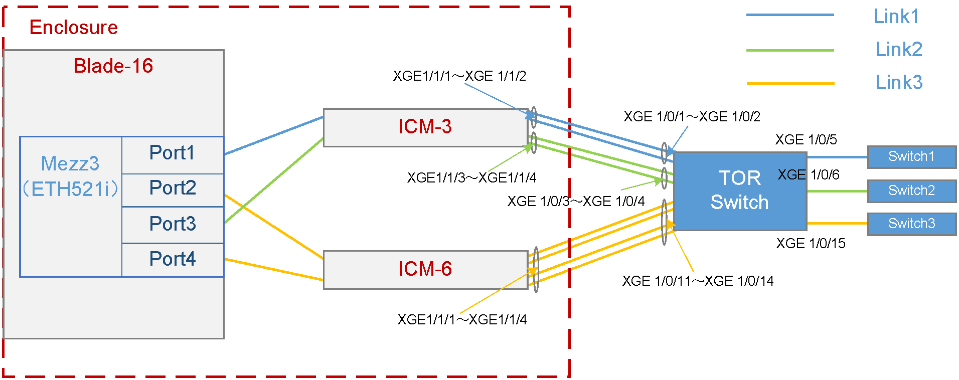

As shown in Figure 1, a blade server and an ICM are installed in the H3C UniServer B16000 blade server chassis. In this example, the blade server used is H3C UniServer B5700 G3, the Mezz NIC used is NIC-ETH521i-Mb-4*10G (ETH521i for short), the RAID card used is RAID-P5408-Mf-8i, and the ICM used is H3C UniServer BX720E. The TOR switch used is H3C S5820V2-52QF.
·     The blade server is installed in slot 16. The Mezz NIC is installed in the slot of Mezz 3 at the rear of the blade server. The RAID card is installed in the front Mezz slot.
·     Two ICMs are installed in the slots of ICM 3 and ICM 6 respectively, and connect to the TOR switch through external ports. The external ports of ICM 3, including XGE1/1/1 (Port 1), XGE1/1/2 (Port 2), XGE1/1/3 (Port 3), and XGE1/1/4 (Port 4), are connected to the ports XGE1/0/1, XGE1/0/2, XGE1/0/3, and XGE1/0/4 of the TOR switch in turn. The external ports of ICM 6, including XGE1/1/1 (Port 1), XGE1/1/2 (Port 2), XGE1/1/3 (Port 3), and XGE1/1/4 (Port 4), are connected to the ports XGE1/0/11, XGE1/0/12, XGE1/0/13, and XGE1/0/14 of the TOR switch in turn.
·     On the TOR switch, ports XGE1/0/1 and XGE1/0/2 are added to the aggregation group and allow traffic of VLAN 100 to pass through; ports XGE1/0/3 and XGE1/0/4 are added to the aggregation group and allow traffic of VLAN 10 to pass through; ports XGE1/0/11, XGE1/0/12, XGE1/0/13, and XGE1/0/14 are added to the aggregation group and allow traffic of VLAN 400 and VLAN 500 to pass through. Port XGE1/0/5 allows VLAN 100 to connect to Switch 1 (acting as the access switch of the R&D Department), port XGE1/0/6 allows VLAN 10 to connect to Switch 2 (acting as the access switch of the Quality Department), and port XGE1/0/15 allows VLAN 400 and VLAN 500 to connect to Switch 3 (acting as the access switch of the Marketing Department).
A chassis profile needs to be configured so that different departments of the company can access different services on the blade server. The specific requirements are as follows:
·     To ensure stability of services, back up the BIOS and RAID configurations of the blade server before service deployment, and meanwhile ensure redundancy of service data.
·     Allocate the R&D Department to VLAN 100 and the gateway address is 192.168.20.2/24. This department needs to access the service resources of the blade server in VLAN 200 through Link 1 and the service IP address is 192.168.20.1/24.
·     Allocate the Marketing Department to VLAN 400 and VLAN 500 and the gateway addresses are 192.168.40.2/24 and 192.168.50.2/24. This department needs to access the service resources of the blade server in VLAN 400 and VLAN 500 through Link 3 and the service IP addresses are 192.168.40.1/24 and 192.168.50.1/24.
·     Allocate the Quality Department to VLAN 10, and the gateway address is 192.168.1.2/24. This department needs to access the service resources of the blade server in VLAN 10 through Link 2, and the service IP address is 192.168.1.1/24.
·     To ensure reliability of external links, configure link aggregation on the uplink port (external port of the ICM) and TOR switch ports.
·     After the blade server is replaced by the same type of blade server, no configuration is needed, and the original network configuration is still effective.
·     The detailed port connections for the chassis profile networking are shown in Table 2.

Figure 1 Network diagram

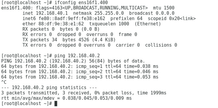

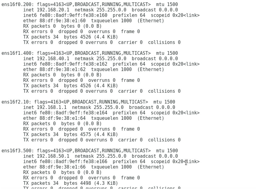

1.     As shown in Figure 2, add Port 1, Port 2, Port 3, and Port 4 to VLAN 200, VLAN 400, VLAN 10, and VLAN 500 based on the service requirements, and configure the IP addresses 192.168.20.1, 192.168.40.1, 192.168.1.1, and 192.168.50.1, respectively.
Figure 2 Configuring the IP address of each port

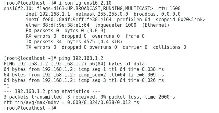

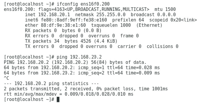

1.     As shown in Figure 3, the gateway address of the R&D Department can be successfully pinged on Port 1.
Figure 3 Checking whether the network is normal on Port 1
2.     As shown in Figure 4, the gateway address of the Quality Department can be successfully pinged on Port 3.
Figure 4 Checking whether the network is normal on Port 3

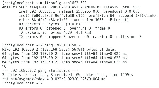

3.     As shown in Figure 5 and Figure 6, the gateway address of the Marketing Department can be successfully pinged on Port 2 and Port 4.
Figure 5 Checking whether the network is normal on Port 2
Figure 6 Checking whether the network is normal on Port 4
