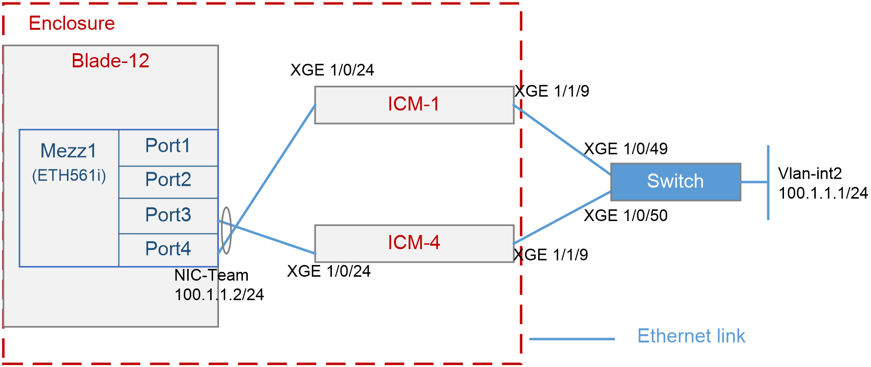

Network requirement

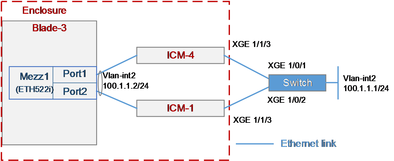

As shown in Figure 1, the blade server and interconnect modules are installed in the H3C B16000 blade server chassis. The blade server is installed in slot 12, two interconnect modules are installed in slot 1 and slot 4, and the mezzanine card is installed in the mezzanine card slot 1 of the blade server. The XGE 1/1/9 port of each of the two interconnect modules is connected to the XGE 1/0/49 and XGE 1/0/50 ports of the Ethernet switch.
In this example, the following devices and modules are used: mezzanine card (NIC-ETH561i-Mb-4*10G, "ETH561i"), aggregation interconnect module (BX720E), Ethernet switch (H3C switch).
It is required that the OS on the blade server can access the external Ethernet network through the switch (in this example, accessing VLAN 2 port on the switch is used as an example), and can still communicate correctly when any interconnect module fails.
Figure 1 Example: Configuring Ethernet services
Analysis

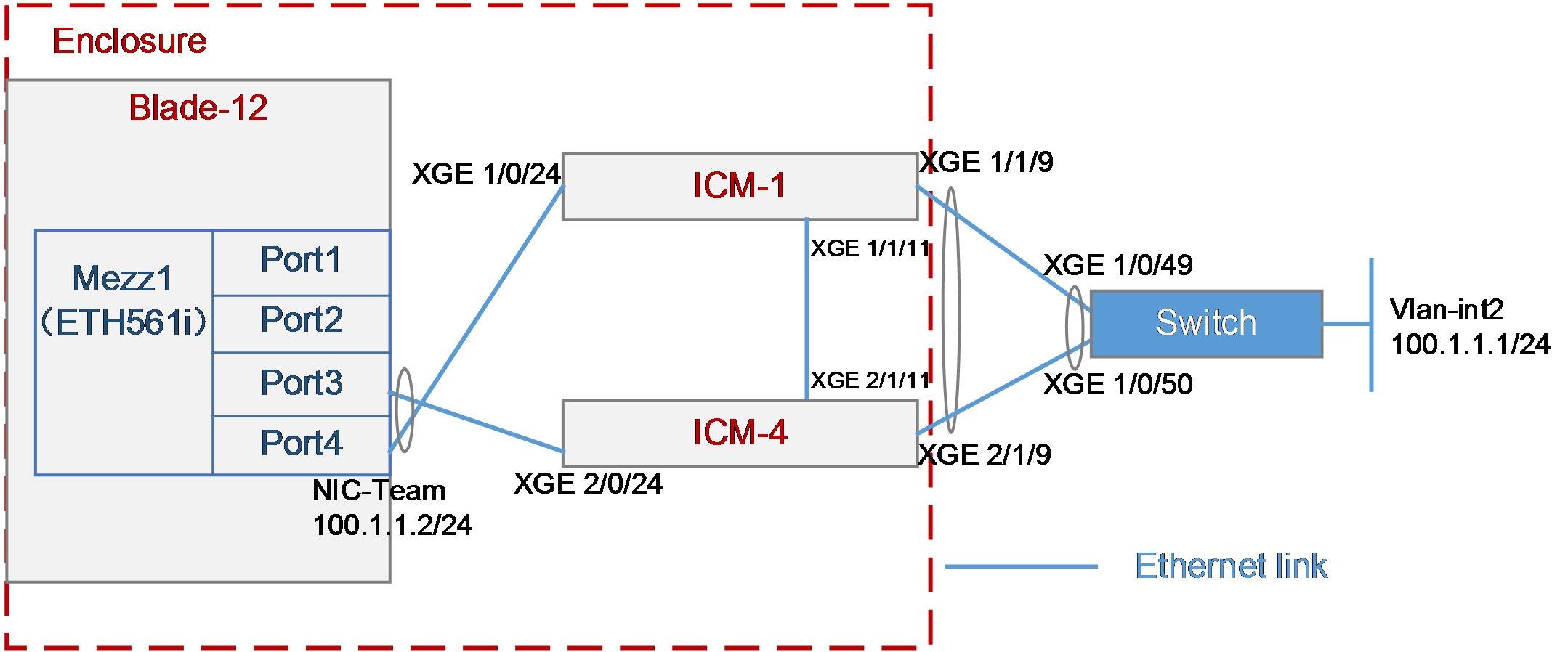

· To improve the reliability of external links, you need to aggregate the links over the uplink port on the interconnect module and the downlink port on the aggregation switch.
· To improve the reliability of internal links in the blade server chassis, you need to configure the bonding function under the OS to bind Port 3 and Port 4 of the mezzanine card to a logic port. In this example, the bonding function adopts the active/standby mode.
· In this example, the bonding function adopts the active/standby mode, indicating that either Port 3 or Port 4 on the mezzanine card receives and sends the traffic, while the other serves as the backup. Therefore, you do not need to aggregate the links over the XGE 1/0/24 internal ports of the two interconnect module. If the bonding function uses other modes, you need to aggregate the links over the internal ports of the two interconnect modules.
· As a best practice, disable the STP function of the internal ports on the interconnect modules, to prevent the rebooting or plugging in/out of the blade server from causing the STP of the interconnect modules to start calculating and resulting in short disconnection of external ports on the interconnect modules.

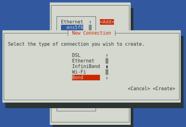

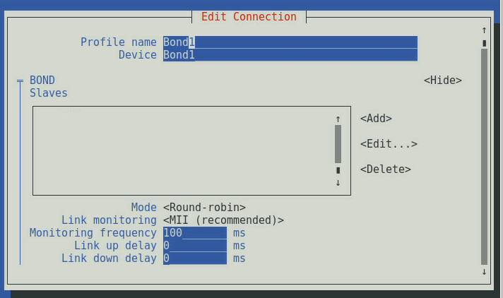

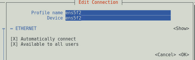

c. Select Add to add a new network connection, select the type of connection as Bond, and click Create, as shown in Figure 3.
Figure 3 Adding a "bond" connection

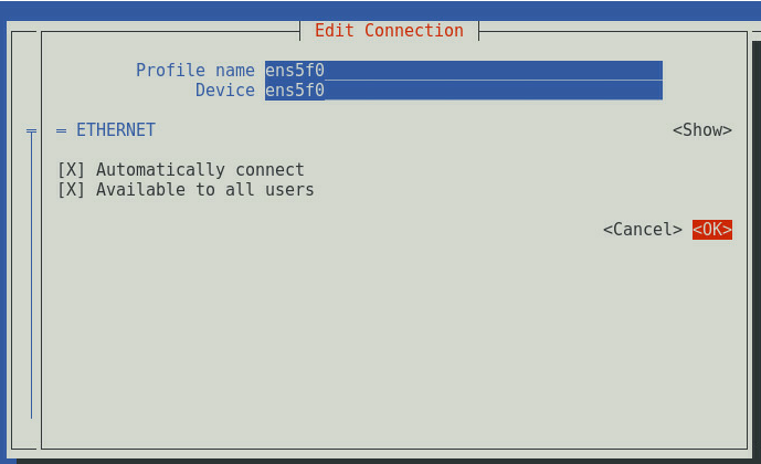

d. As shown in Figure 4, set Profile name and Device.
Figure 4 Setting the bond connection

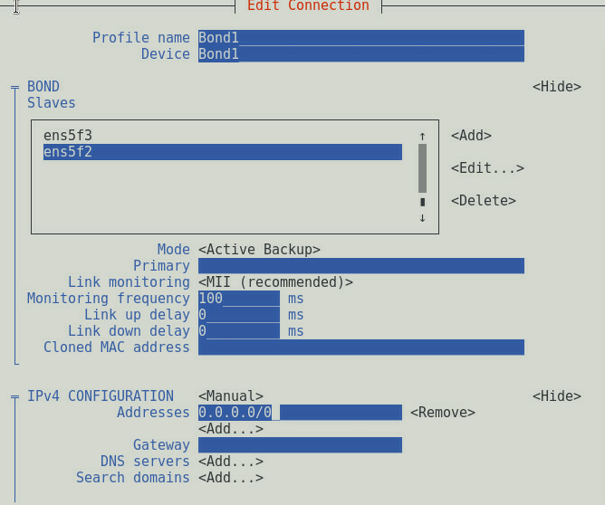

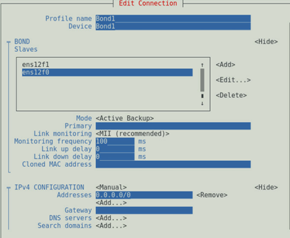

e. Under the BOND Slaves option, select Add and add ens5f2 and ens5f3 slave ports, as shown in Figure 5.
f. Set Mode to Active Backup and set the IP address according to the service environment. In this example, the service traffic is transmitted through the VLAN port connected to the bond port. Therefore, set the static IP address of the bond master port to 0.0.0.0/0, as shown in Figure 6.
Figure 6 Setting network parameters

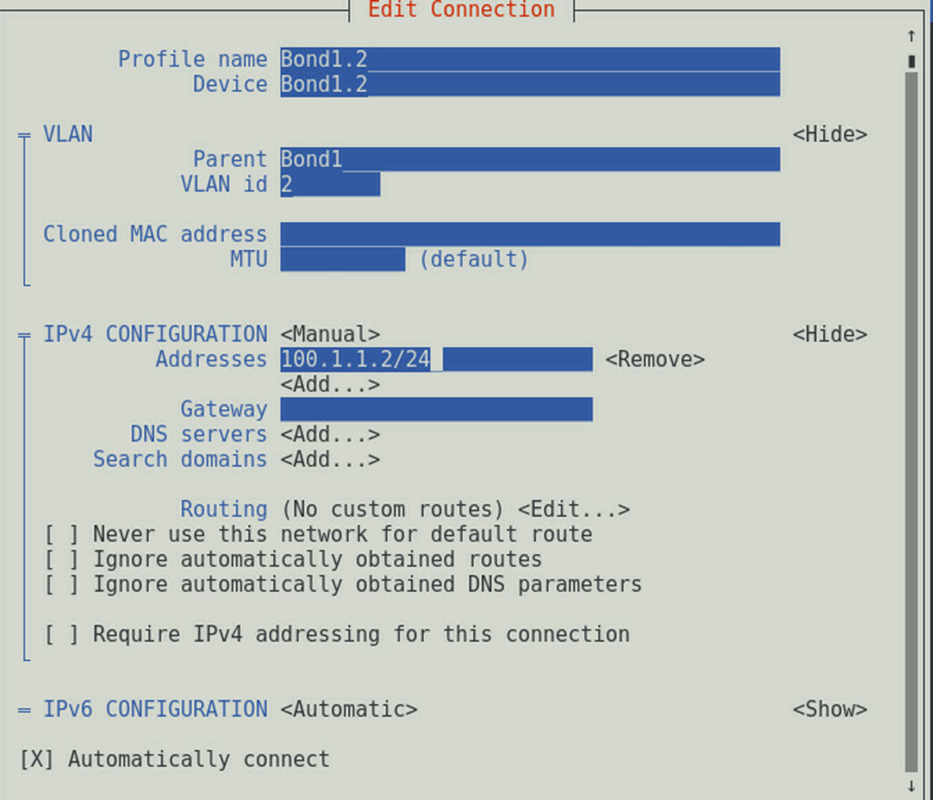

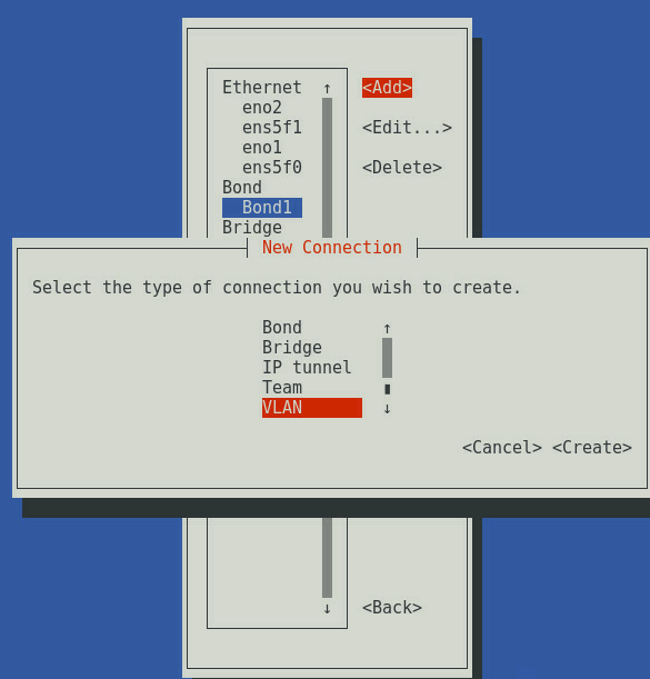

g. Return to the homepage of the nmtui tool, select Add to add a new network connection, select the type of connection as VLAN, and click Create, as shown in Figure 7.
h. As shown in Figure 8, set Profile name, Device and VLAN id, and configure the IP address of the service network. This example uses the VLAN ID of 2 and the static IP address 100.1.1.2/24.
Figure 8 Setting the IP address of the VLAN slave port connected to the bond port
i. Then, press Esc to return to the configuration screen.

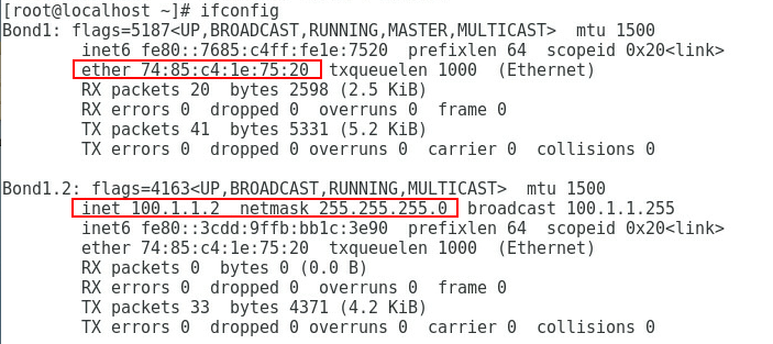

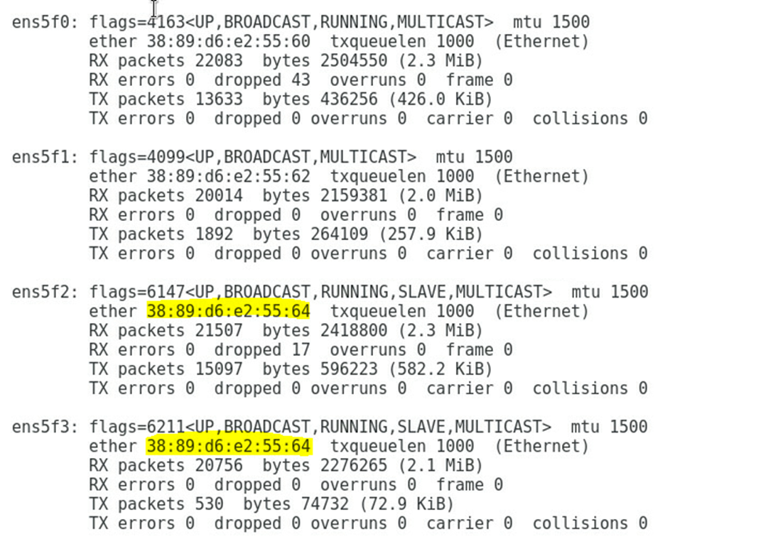

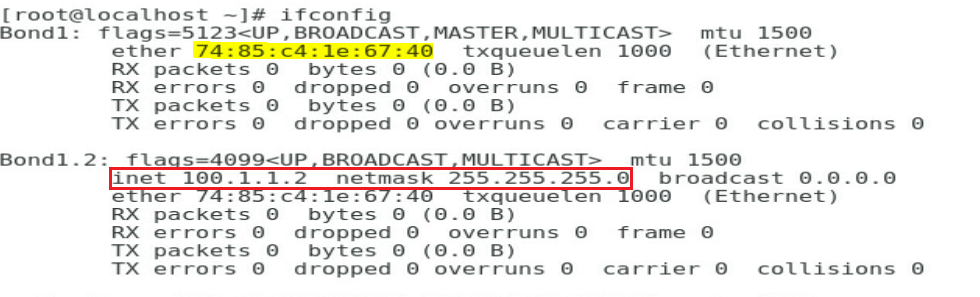

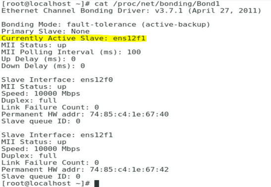

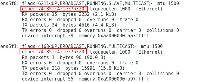

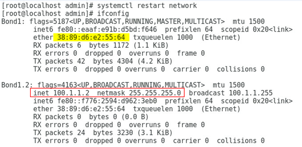

3. Execute the ifconfig command to view the Bond1 and Bond1.2 configurations as shown in Figure 9 and Figure 10. Note that the physical addresses of the aggregation port and the two physical network adapters are the same in the active/standby mode.
Figure 9 Viewing the network adapter configuration (I)
Figure 10 Viewing the network adapter configuration (II)

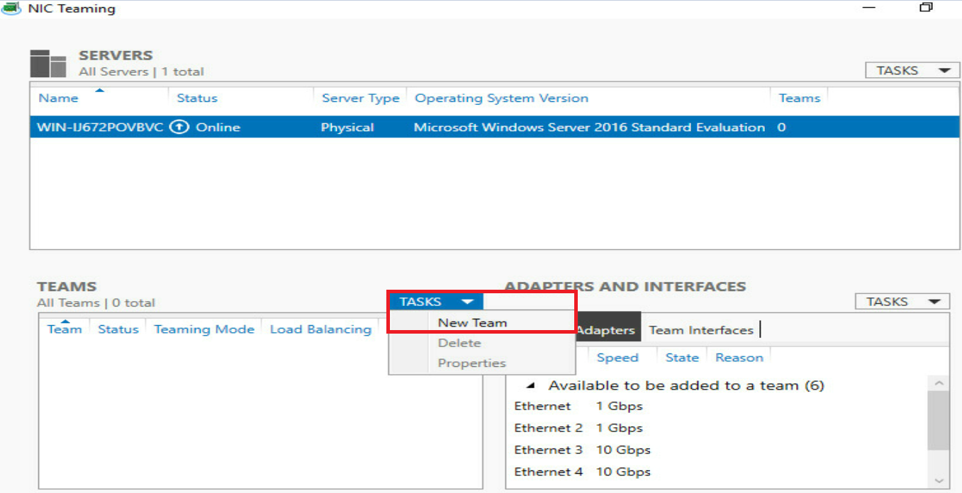

2. Configure the teaming.

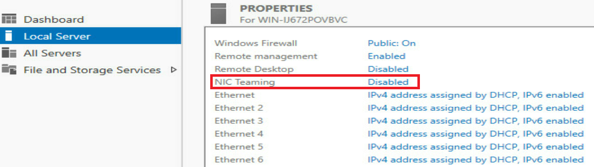

a. As shown in Figure 11, click Disabled in Server Manager > Local Server > NIC Teaming to open the configuration screen of NIC Teaming.
Figure 11 Opening the configuration screen of NIC Teaming

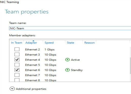

b. As shown in Figure 12, click TASKS > NEW Team to create a team.

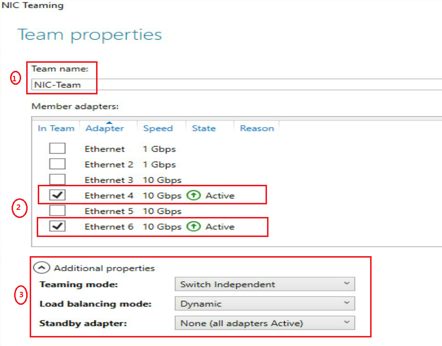

c. As shown in Figure 13, set the team name and select the network adapter that you want to add to the team, set the appropriate properties in Additional properties, and click OK to create the team.
TIP: · For descriptions of team properties, see Mezzanine Card User Guide. · The creation of a team in the Switch Independent mode is slow. Please wait patiently. |
Figure 13 Setting the new team

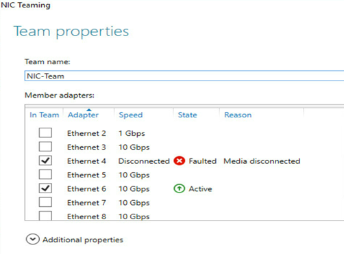

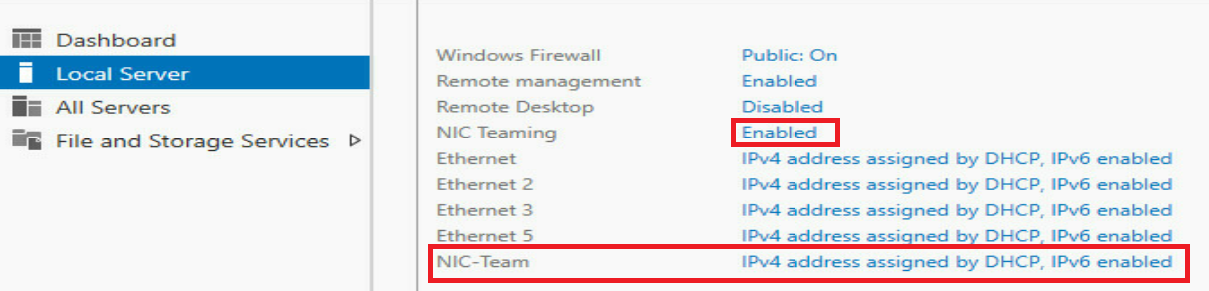

d. As shown in Figure 14, you can see that the state has changed to Enabled. You can also see a new network port named NIC-Team. Click this port to enter the network connection configuration screen.
Figure 14 Viewing the NIC teaming

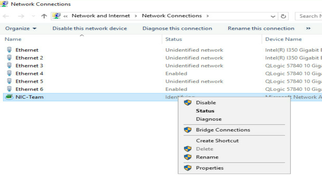

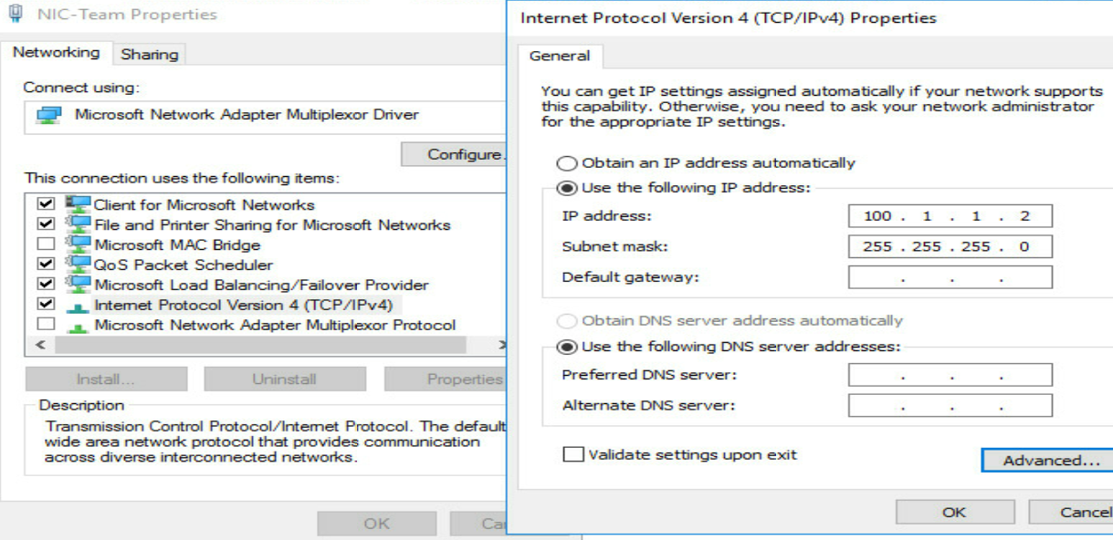

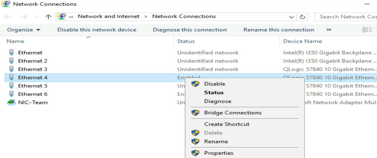

e. As shown in Figure 15, right-click the network port named NIC-Team and select Properties.
Figure 15 Setting the NIC-Team
f. As shown in Figure 16, set the IP address of the port named NIC-Team. The IP address of 100.1.1.2/24 is used in this example.
Figure 16 Setting the IP address

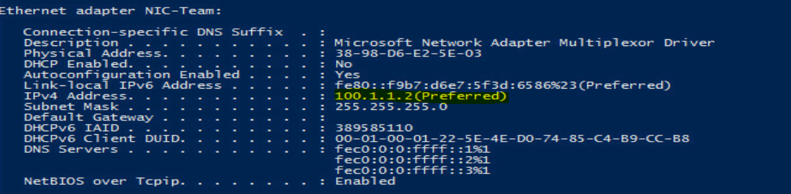

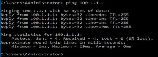

g. As shown in Figure 17, run the cmd command, and execute the ipconfig -all command in the Windows PowerShell screen. You can see that the IP has been configured.
Figure 17 Confirming the IP address of the port

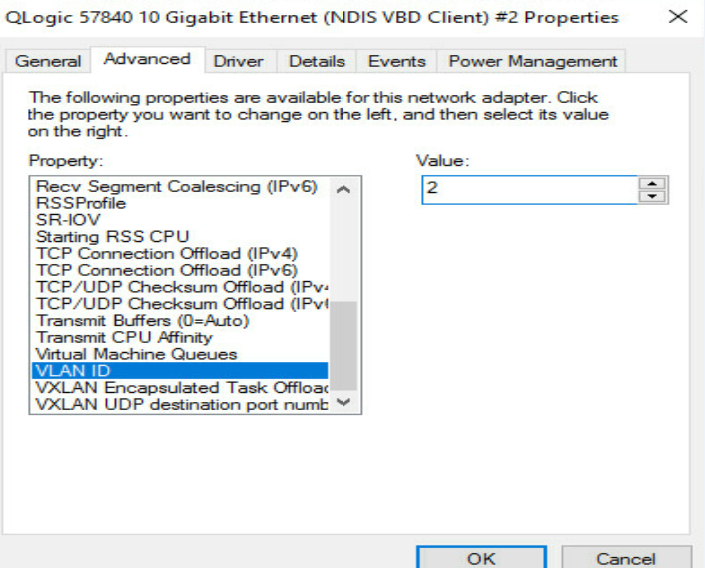

h. VLAN separation exists in this example. You need to configure VLAN ID for all physical ports (Ethernet4 and Ethernet6) joined the team. Here we use the configuration of Ethernet4 as an example to describe the configuration process. In the Network Connections screen, right-click the network port named Ethernet4 and select Properties, as shown in Figure 18.
Figure 18 Setting the physical port in the team
i. As shown in Figure 19, in the pop-up dialog box, select Configure, enter the Advanced tab, select VLAN ID in the Property drop-down menu, and fill in the added VLAN tag in the Value box. In this example, the value of 2 is used.
j. Configure the Ethernet6 port according to the above methods.

Interconnecting interconnect modules and aggregation switches
# Create a layer-2 aggregation port, add the physical ports to the aggregation group, and allow VLAN 2 to pass.
[H3C] interface Bridge-Aggregation 10
[H3C-Bridge-Aggregation10]
[H3C] interface Ten-GigabitEthernet 1/1/9
[H3C-Ten-GigabitEthernet1/1/9] port link-aggregation group 10
[H3C-Ten-GigabitEthernet1/1/9] quit
[H3C] interface Ten-GigabitEthernet 2/1/9
[H3C-Ten-GigabitEthernet2/1/9] port link-aggregation group 10
[H3C-Ten-GigabitEthernet2/1/9] quit
[H3C] int Bridge-Aggregation 10
[H3C-Bridge-Aggregation10] port link-type trunk
[H3C-Bridge-Aggregation10] port trunk permit vlan 2
[H3C-Bridge-Aggregation10] undo port trunk permit vlan 1
[H3C-Bridge-Aggregation10] quit
# Save the configuration.
[H3C] save
The current configuration will be written to the device. Are you sure? [Y/N]:y
Please input the file name(*.cfg)[flash:/startup.cfg]
(To leave the existing filename unchanged, press the enter key):

As shown in Figure 20, the blade server and Ethernet pass-through modules are installed in the H3C B16000 blade server chassis. The blade server is installed in slot 3, two Ethernet pass-through modules are installed in slot 1 and slot 4, and the mezzanine card is installed in the mezzanine card slot 1 of the blade server. The XGE 1/1/3 port of each of the two Ethernet pass-through modules is connected to the XGE 1/0/1 or XGE 1/0/2 port of the Ethernet switch.
In this example, the following devices and modules are used: blade server (H3C UniServer B5700 G3), mezzanine card (NIC-ETH522i-Mb-2*10G, "ETH522i"), Ethernet pass-through module (H3C UniServer BT616E), and Ethernet switch (H3C S6800).
In this example, the Red Hat Enterprise Linux 7.5 is installed on the blade server.
The following requirements are expected to be met:
The OS on the blade server can access the external H3C switch, and can still communicate correctly when any pass-through module fails.
Figure 20 Example: Configuring Ethernet service (Ethernet pass-through module)
Analysis
· Before configuration, you need to query the correspondence between the mezzanine card, the external port of the pass-through module, and the mezzanine card port displayed under the OS, to ensure that the correct ports are configured and facilitate the verification after configuration.
· To improve the reliability of internal links of the blade server, you need to configure the bonding function (adopting the active/standby mode) on the mezzanine card ports to bind Port 1 and Port 2 of the mezzanine card to a logic port, so that the blade server can access external networks through the other pass-through module when a pass-through module fails.
· In this example, the bonding function adopts the active/standby mode, indicating that either Port 1 or Port 2 on the mezzanine card receives and sends the traffic, while the other serves as the backup. Therefore, you do not need to aggregate the two links on the switch used to connect the blade server. If the bonding function uses other modes, you need to configure the settings related to the bond mode on the two links.
· In this example, the service traffic between the blade server and the switch is transmitted through the VLAN port. Therefore, you need to configure relevant settings related to VLAN and VLAN ports on the blade server and the switch.

1. In the OS, execute the nmtui command to start the network adapter configuration tool that comes with the system.
[root@localhost]# nmtui
2. Select Edit a connection to edit the network connection, as shown in Figure 21.
Figure 21 Selecting Edit a connection
3. Select Add to add a new network connection, select the type of connection as Bond, and click Create, as shown in Figure 22.
Figure 22 Adding a "bond" connection
4. As shown in Figure 23, set Profile name and Device, where Profile name is the name of the configuration file and can be set as required. Device must be configured as the device name. In this example, both are configured as Bond1.
Figure 23 Setting the bond connection
5. Under the BOND Slaves option, select Add and add the ens5f0 slave port, as shown in Figure 24. Then, select OK to save the configuration. Add the ens5f1 slave port in the same way.
6. Set Mode to Active Backup and set the IP address according to the service environment. In this example, the service traffic is transmitted through the VLAN port connected to the bond port. Therefore, you do not need to configure the IP address for the bond port. Set IPv4 CONFIGURATION to Manual, and set the static IP address of the bond port to 0.0.0.0/0, as shown in Figure 25. After the configuration, select OK to save the configuration.
Figure 25 Setting network parameters
7. Press Esc to return to the homepage of the nmtui tool, select Add to add a new network connection, select the type of connection as VLAN, and click Create, as shown in Figure 26.
8. As shown in Figure 27, set Profile name, Device and VLAN id, set IPv4 CONFIGURATION to Manual, and set the static IP address of the service network. Then, select OK to save the configuration. This example uses the VLAN ID of 2 and the address100.1.1.2/24.
Figure 27 Setting the IP address of the VLAN slave port connected to the bond port
Execute the ifconfig command to view the Bond1 and Bond1.2 configurations, as shown in Figure 28. Note that the physical addresses of the aggregation port and the two physical network adapters are the same in the active/standby mode, as shown in Figure 29.
Figure 28 Viewing the network adapter configuration (I)
Figure 29 Viewing the network adapter configuration (II)

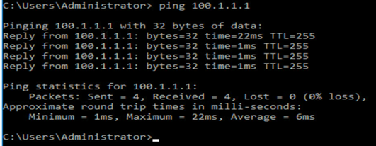

Ping the IP address of VLAN 2 port on the blade server on the switch. Verify that the address can be pinged successfully.
[H3C] ping 100.1.1.2
PING 100.1.1.2(100.1.1.2) 56(84) bytes of data.
64bytes from 100.1.1.2: icmp_seq=1 ttl=255 time=0.808 ms
64bytes from 100.1.1.2: icmp_seq=2 ttl=255 time=0.691 ms
64bytes from 100.1.1.2: icmp_seq=3 ttl=255 time=0.732 ms
64bytes from 100.1.1.2: icmp_seq=4 ttl=255 time=0.679 ms
64bytes from 100.1.1.2: icmp_seq=5 ttl=255 time=0.710 ms
Example: Configuring Ethernet services (monitor link)
Network requirement
As shown in Figure 30, the blade server and interconnect modules are installed in the H3C B16000 blade server chassis. The blade server is installed in slot 12, two interconnect modules are installed in slot 1 and slot 4, and the mezzanine card is installed in the mezzanine card slot 1 of the blade server. The XGE 1/1/9 port of each of the two interconnect modules is connected to the XGE 1/0/49 and XGE 1/0/50 ports of the Ethernet switch.
In this example, the following devices and modules are used: mezzanine card (NIC-ETH561i-Mb-4*10G, "ETH561i"), interconnect module (BX720E), and Ethernet switch (H3C switch).
It is required that the OS on the blade server can access the external Ethernet network through the switch (in this example, accessing VLAN 2 port on the switch is used as an example). In addition, the following is required to be implemented through the Monitor Link technology: When the uplink device of any interconnect module fails, the uplink port (XGE 1/1/9) is down, and the downlink port (XGE 1/0/24) of the same interconnect module is down as well, so that the system can sense the uplink status changes and implement link switching.
Figure 30 Example: Configuring Ethernet services
Analysis
· When the uplink port of the interconnect module is down, the downlink port need to be down as well. To achieve this, you need to create a monitor link group and specify its uplink and downlink ports.

c. Select Add to add a new network connection, select the type of connection as Bond, and click Create, as shown in Figure 32.
Figure 32 Adding a "bond" connection
d. As shown in Figure 33, set Profile name and Device.
Figure 33 Setting the bond connection

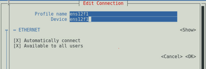

e. Under the BOND Slaves option, select Add and add ens12f0 and ens12f1 slave ports, as shown in Figure 34.
f. Set Mode to Active Backup and set the IP address according to the service environment. In this example, the service traffic is transmitted through the VLAN port connected to the bond port. Therefore, set the static IP address of the bond master port to 0.0.0.0/0, as shown in Figure 35.
Figure 35 Setting network parameters

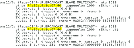

3. Execute the ifconfig command to view the Bond1 and Bond1.2 configurations as shown in Figure 38 and Figure 39. Note that the physical addresses of the aggregation port and the two physical network adapters are the same in the active/standby mode.
Figure 38 Viewing the network adapter configuration (I)
Figure 39 Viewing the network adapter configuration (II)

a. As shown in Figure 40, click Disabled in Server Manager > Local Server > NIC Teaming to open the configuration screen of NIC Teaming.
Figure 40 Opening the configuration screen of NIC Teaming
b. As shown in Figure 41, click TASKS > NEW Team to create a team.
c. As shown in Figure 42, set the team name and select the network adapter that you want to add to the team, set the appropriate properties in Additional properties, and click OK to create the team.
Figure 42 Setting the new team
d. As shown in Figure 43, you can see that the state has changed to Enabled. You can also see a new network port named NIC-Team. Click this port to enter the network connection configuration screen.
Figure 43 Viewing the NIC teaming
e. As shown in Figure 44, right-click the network port named NIC-Team and select Properties.
Figure 44 Setting the NIC-Team
f. As shown in Figure 45, set the IP address of the port named NIC-Team. The IP address of 100.1.1.2/24 is used in this example.
Figure 45 Setting the IP address
g. As shown in Figure 46, run the cmd command, and execute the ipconfig -all command in the Windows PowerShell screen. You can see that the IP has been configured.
Figure 46 Confirming the IP address of the port
h. VLAN separation exists in this example. You need to configure VLAN ID for all physical ports (Ethernet4 and Ethernet6) joined the team. Here we use the configuration of Ethernet4 as an example to describe the configuration process. In the Network Connections screen, right-click the network port named Ethernet4 and select Properties, as shown in Figure 47.
Figure 47 Setting the physical port in the team
i. As shown in Figure 48, in the pop-up dialog box, select Configure, enter the Advanced tab, select VLAN ID in the Property drop-down menu, and fill in the added VLAN tag in the Value box. In this example, the value of 2 is used.

Verifying the configuration under the Linux system

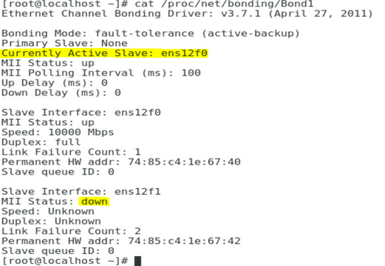

1. As shown in Figure 49, execute the cat/proc/net/bonding/Bond1 command on the Linux system to view the current bond information and the currently active slave port displayed is ens12f1.
Figure 49 Viewing the bond information
2. Ping the VLAN 2 port on the aggregation switch. Verify that the port can be pinged successfully.
[root@localhost]# ping 100.1.1.1
PING 100.1.1.1(100.1.1.1) 56(84) bytes of data.
64bytes from 100.1.1.1: icmp_seq=1 ttl=255 time=0.606 ms
64bytes from 100.1.1.1: icmp_seq=2 ttl=255 time=0.658 ms
64bytes from 100.1.1.1: icmp_seq=3 ttl=255 time=0.567 ms
64bytes from 100.1.1.1: icmp_seq=4 ttl=255 time=0.942 ms
64bytes from 100.1.1.1: icmp_seq=5 ttl=255 time=0.743 ms
3. As shown in Figure 50, shut down the XGE 1/0/49 port of the aggregation switch to simulate the case where the uplink of interconnect module 1 corresponding to the ens12f1 is down. View the bond information in Linux again, and the currently active slave port displayed is ens12f0.
Figure 50 Viewing the bond information
4. Ping the VLAN 2 port on the aggregation switch in Linux. Verify that the port can be pinged successfully, indicating that the link has been switched without affecting service communication.
64bytes from 100.1.1.1: icmp_seq=1 ttl=255 time=1.606 ms
64bytes from 100.1.1.1: icmp_seq=2 ttl=255 time=0.896 ms
64bytes from 100.1.1.1: icmp_seq=3 ttl=255 time=0.542 ms
64bytes from 100.1.1.1: icmp_seq=4 ttl=255 time=0.672 ms
64bytes from 100.1.1.1: icmp_seq=5 ttl=255 time=0.920 ms
Verifying the configuration under the Windows system
1. As shown in Figure 51, click Disabled in Server Manager > Local Server > NIC Teaming in the OS to open the configuration screen of NIC Teaming. Select NIC-Team in Team name to view the current team information. The active port is Ethernet 4.
Figure 51 Viewing the team information
2. As shown in Figure 52, ping the VLAN 2 port on the aggregation switch in Windows. Verify that the port can be pinged successfully.
Figure 52 Verifying link connectivity
3. As shown in Figure 53, shut down the XGE 1/0/49 port of the aggregation switch to simulate the case where the uplink of interconnect module 1 corresponding to the Ethernet 4 is down. View the team information in Windows again, and the active port displayed is Ethernet 6.
Figure 53 Viewing the team information
4. As shown in Figure 54, ping the VLAN 2 port on the aggregation switch in Windows again. Verify that the port can be pinged successfully. indicating that the link has been switched without affecting service communication.
Figure 54 Verifying link connectivity
