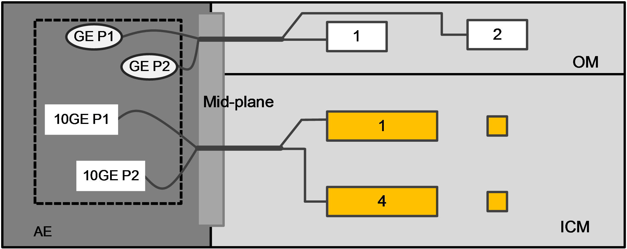

To manage blade servers of B16000 blade chassis in batches through the FIST management software, such as configuring HDM in batches in several blade servers, configuring RAID, and managing OS, you need to set up FIST networking in AE modules in the B16000 blade chassis. FIST management networking of the B16000 blade chassis is divided into two types according to link connection modes of FIST service network, including the management through OM module links and the management through ICM module links.

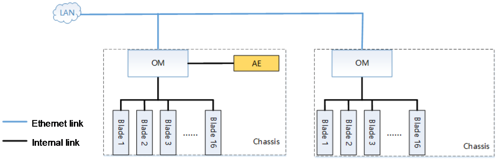

Networking modes
As the FIST management software is installed in the AE modules, service traffic is transmitted through links connected to the AE modules.
As shown in Figure 1, four onboard Ethernet ports of the AE modules inside the B16000 blade chassis are connected to OM modules and ICM modules through a midplane, two GE interfaces are connected to the primary and backup OM modules, and two 10 GE interfaces are connected to ICM modules in slots 1 and 4. Users may access the FIST management software in the AE modules by connecting to a management port of an OM module or a front-panel Ethernet port of an ICM module.
Figure 1 Connection of AE module in chassis

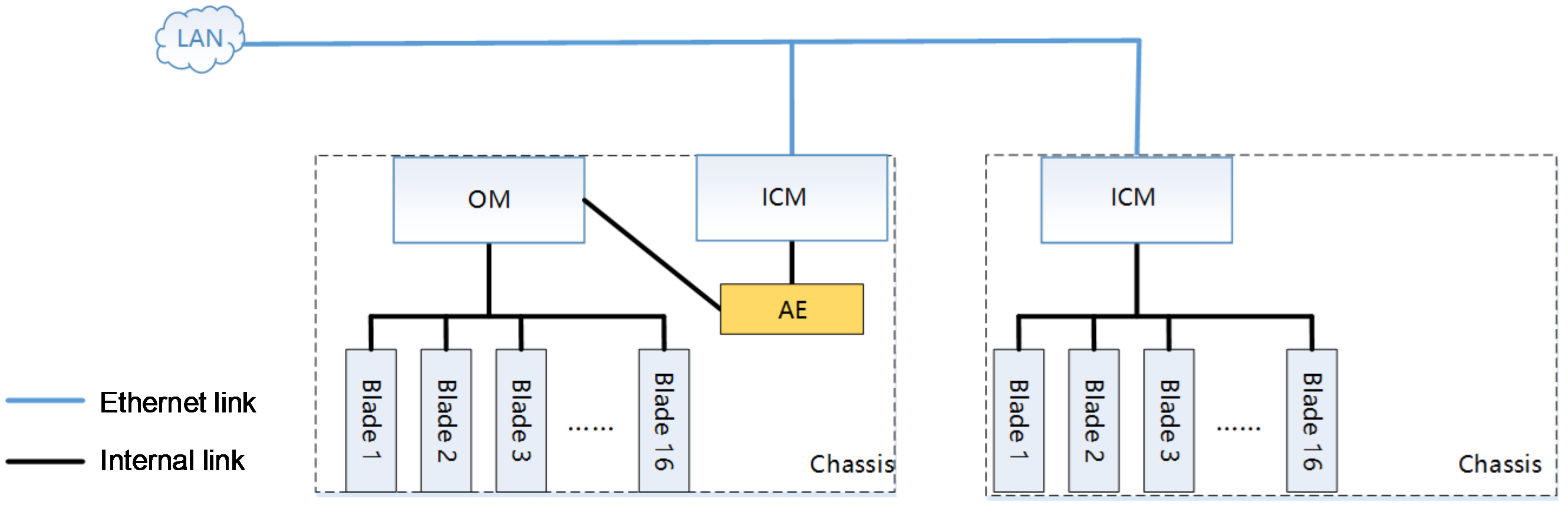

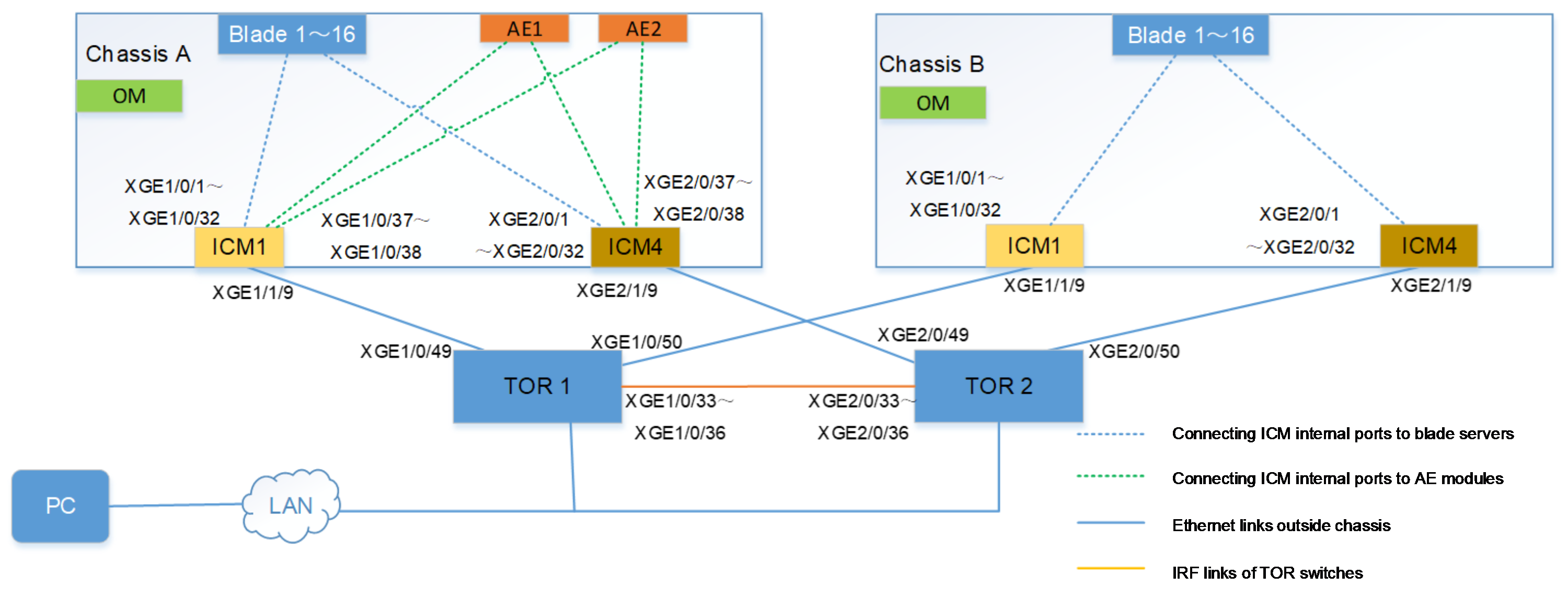

Based on link connection methods of the FIST service network, there are two networking modes:
· As shown in Figure 2, the FIST service links are connected through the OM module.
· As shown in Figure 3, the FIST service links are connected through the ICM module.
Figure 2 Connecting FIST service links through OM module
Figure 3 Connecting FIST service links through ICM module
Comparison between two networking modes is shown in Table 1.

The following information mainly describes link connection methods of FIST service network in the AE modules of the B16000 blade chassis. As a best practice, configure ICM module settings as needed, such as VLAN configuration.

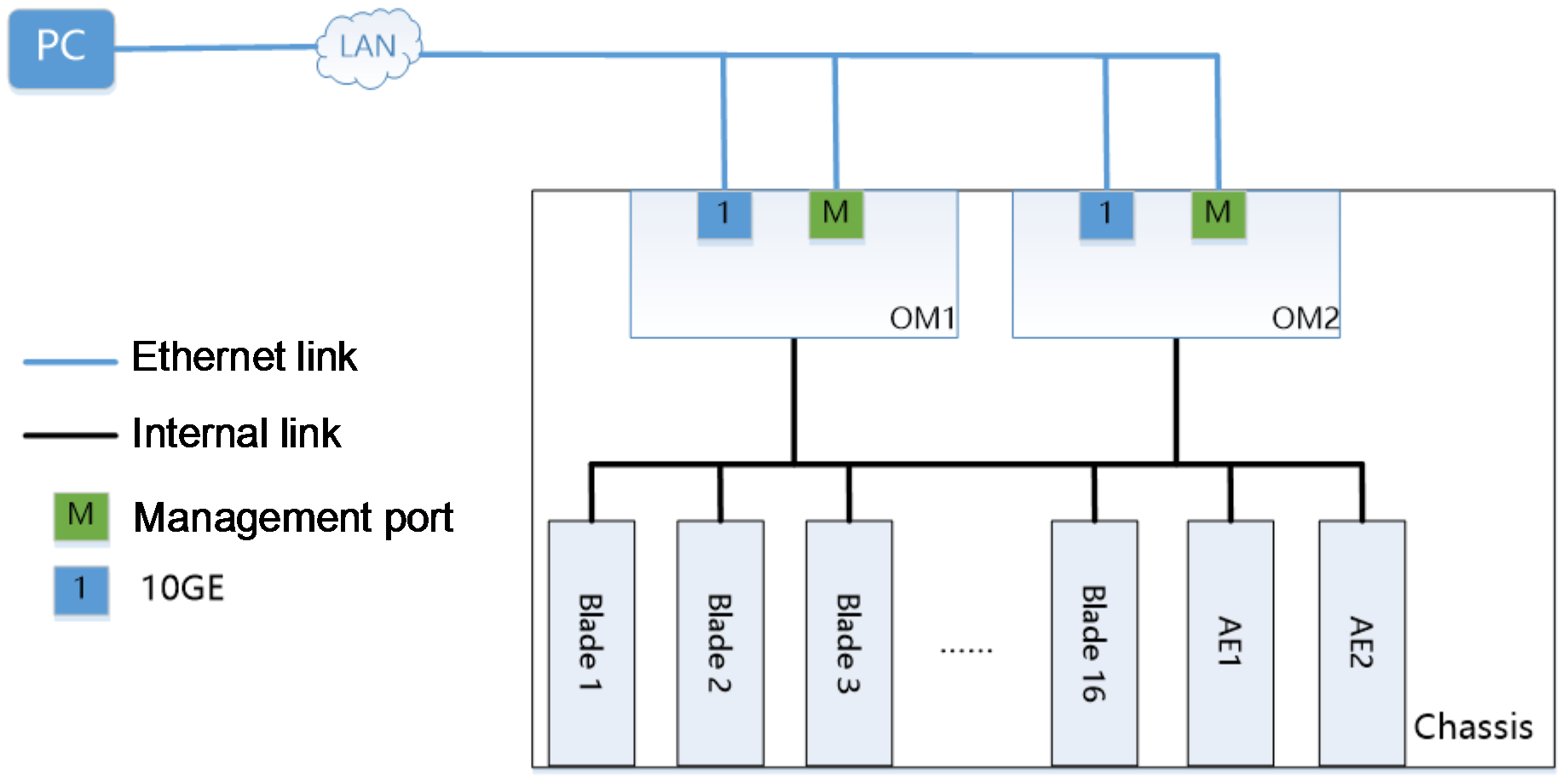

Example: Configuring single-chassis management through OM module links
Network requirement
As shown in Figure 4, the following components are installed in one H3C Uniserver B16000 blade chassis:
· One AE module, with the pre-installed FIST management software, is respectively installed in the slots E1 and E2 in the chassis.
· Blade servers are installed in slots Blade 1 to 16 of the chassis. In this example, the blade server is H3C UniServer B5700 G3.
· OM modules are installed for slot 1 and slot 2 in the chassis.
The current requirement is to manage all blade servers in the chassis in batches with the FIST management software, for example, install operating systems in batches. FIST service traffic is transmitted through the OM module links, and link redundancy is ensured through the primary/backup OM module and AE primary/backup cluster.
Figure 4 Networking for single-chassis management through OM module
Table 3 Description for network information configuration
Device |
IP address |
Username/Password |
OM management software |
· Management IP addresses: 192.168.100.101/24 · Gateway: 192.168.100.254/24 |
· Username (default): admin · Password (default): Password@_ |
FIST management software |
· Management IP addresses (default): 192.168.0.100/24 · Gateway: 192.168.0.254/24 |
PC |
IP addresses: 192.168.100.1/24 |
N/A |
AE module |
· IP address of primary AE module: 192.168.17.100/24 · IP address of backup AE module: 192.168.17.101/24 · Virtual IP address for iSCSI: 172.16.20.222/24 |
N/A |
Analysis
· To transmit management traffic, connect the B16000 blade chassis to the network through a management port of the OM module.
· To transmit FIST service traffic, connect the 10GE fiber interface 1 of the OM module to the network.
· To improve the networking availability and ensure link redundancy, measures below are taken in this example:
¡ Set up an AE primary/backup cluster with two AE modules.
¡Configure two OM modules, and run them in the primary/backup mode.

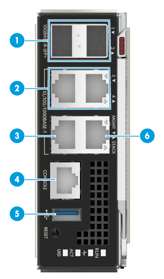

Connecting OM module cables
1. Connect management ports of the two OM modules and the 10GE optical interface in the chassis to the network. The external interface of the OM module is shown in Figure 5, and the interface description is shown in Table 4.
Figure 5 External interface of OM module
Table 4 Description of external interfaces
SN |
Interface name |
Type |
Quantity |
Remarks |
1 |
10 GE optical interface |
SFP+ |
2 |
Interfaces of OM module service plane |
2 |
GE copper port |
RJ-45 |
2 |
3 |
Management interface (MGMT) |
RJ-45 |
1 |
For chassis management |
4 |
Console port |
RJ-45 |
1 |
For OM module commissioning system or remote management |
5 |
USB3.0 interface |
Standard USB 3.0 |
1 |
For connecting USB device |
6 |
Cascading interface STACK |
RJ-45 |
1 |
For chassis cascading |

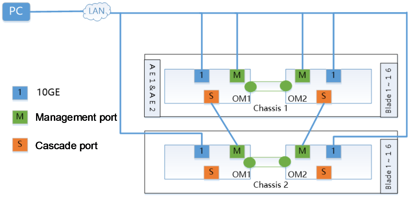

Example: Configuring multi-chassis management through OM module links
Network requirement
As shown in Figure 6, two H3C Uniserver B16000 blade chassis (Chassis 1 and Chassis 2) are connected with external cables, with the following components installed:
· One AE module, with the pre-installed FIST management software, is respectively installed in the slots E1 and E2 in Chassis 1.
· Blade servers are installed in slots Blade 1 to 16 of the two chassis. In this example, the blade server is H3C UniServer B5700 G3.
· OM modules are installed for the slot 1 and slot 2 in the two chassis.
The current requirement is to manage all blade servers in the two chassis in batches with FIST, for example, install operating systems in batches. FIST service traffic is transmitted through the OM module links, and link redundancy is ensured through the primary/backup OM module and AE primary/backup cluster.
Figure 6 Networking for multi-chassis management through OM module
Table 6 Description for network information configuration
Device |
IP address |
Username/password |
OM management software for Chassis 1 |
· Management IP addresses: 192.168.100.100/24 · Gateway: 192.168.100.254/24 |
OM management software for Chassis 2 |
PC |
N/A |
AE module |
N/A |
Analysis
· To simultaneously manage two chassis and all blade servers with the FIST management software, dual-channel cascading is used.
¡Configure two OM modules, and run them with the primary/backup mode.
¡To recommended cascading failure due to a single point of failure, dual-channel cascading is recommended for use.
Software versions used
The following information was created and verified on FIST-2.00.24 of FIST management software.
Configuration procedure
Configuring dual-channel cascading
In this example, Chassis 1 acts as the primary chassis, and Chassis 2 serves as the backup chassis. By taking the dual-channel cascading of the two chassis for example, the procedures are as follows:
1. Connect management ports of the two OM modules and the 10GE optical interface in the chassis to the network. The external interface of the OM module is shown in Figure 7, and the interface description is shown in Table 7.
Figure 7 External OM module interfaces
Table 7 Description of external interfaces
SN |
Interface name |
Type |
Quantity |
Remarks |
1 |
SFP+ |
2 |
2 |
GE copper port |
RJ-45 |
2 |
3 |
RJ-45 |
1 |
4 |
Console port |
RJ-45 |
1 |
5 |
USB3.0 interface |
Standard USB 3.0 |
1 |
6 |
RJ-45 |
1 |
2. Connect the cascading interface in Chassis 1 OM 1 to the management interface in Chassis 2 OM 1, and connect the cascading interface in Chassis 1 OM 2 to the management interface in Chassis 2 OM 2 to finish cascading of the two chassis.

Example: Configuring multi-chassis management through ICM module links
Network requirement
As shown in Figure 8, the following components are installed in two H3C Uniserver B16000 chassis (Chassis A and Chassis B):
· One AE module, with the pre-installed FIST management software, is respectively installed in the slots E1 and E2 in Chassis A.
· One ICM module is respectively installed in each of slots ICM 1 and ICM 4 in Chassis A and Chassis B.
· Blade servers are respectively installed in slots Blade 1 to 16 of Chassis A and Chassis B.
· An Ethernet Mezz network adapter is installed in the slot Mezz1 in each blade server.
· The two ICM modules are respectively connected to XGE1/0/49 and XGE1/0/50 of TOR switches through their respective XGE1/1/9 interfaces.
In this example, the blade server is H3C UniServer B5700 G3, the Mezz network adapter is NIC-ETH521i-Mb-4*10G (hereinafter referred to as ETH521i), the ICM module is the BX720E switch module, and the TOR switch is the H3C S6800-32Q Ethernet switch.
The current requirement is to manage all blade servers in Chassis A and Chassis B can be managed with the FIST management software in the AE module of Chassis A, transmit FIST service traffic only through the ICM module links, isolate traffic to avert interference to other service traffic, set up IRF and AE primary/backup clusters through switches to ensure link redundancy, and install operating systems in batches for all blade servers in a network through the FIST service network.
Figure 8 Networking for multi-chassis management through ICM module

· To ensure all blade servers in Chassis A and Chassis B can be managed through the FIST management software in the AE module in Chassis B and the FIST service traffic is transmitted through the ICM module links, connect ICM modules of Chassis A and Chassis B to the same network, that is, both connected to the same TOR switch in this example. Moreover, the communication is in good condition.
· To ensure the FIST service traffic is transmitted only through ICM module links rather than OM links, isolate the OM module from the FIST service network, that is, the OM service ports in two chassis cannot be connected to the FIST service network.
· To ensure the FIST service network bandwidth is adequate, the TOR switch must support a rate of 10 Gbps or more. Therefore, the H3C S6800-32Q Ethernet switch is used in this example.
· To ensure the FIST service traffic is isolated from other service traffic, create VLAN 2 in the network, and add the ICM modules and switch in the network to VLAN 2.
¡ Creating AE primary/backup cluster
¡ Two ICM modules, configured in each chassis, are connected to TOR switches
¡ IRF is configured between two TOR switches.

Connecting ICM modules to TOR switches
To improve networking availability, ensure link redundancy. Respectively connect ICM modules in each chassis to different TOR switches:
· Respectively connect ICM 1 in each of Chassis A and Chassis B, through their respective XGE 1/1/9 interfaces, to XGE 1/0/49 and XGE 1/0/50 of TOR switch A.
· Respectively connect ICM 4 in each of Chassis A and Chassis B, through their respective XGE 2/1/9 interfaces, to XGE 2/0/49 and XGE 1/0/50 of TOR switch B.

Managing multi-chassis node through OM module links
Actual verification data of each networking mode is shown in Table 11.
