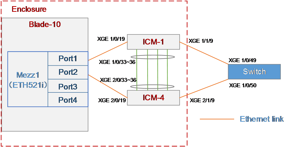

As shown in Figure 1, in the H3C B16000 blade server chassis, the blade server is installed in slot 10, and two interconnect modules are installed in slot 1 and slot 4. A mezzanine card is installed in the mezzanine card slot 1 of the blade server. The two interconnect modules are directly connected to the same aggregation switch through external ports.
In this example, the following devices and modules are used: blade server (H3C UniServer B5700 G3), mezzanine card (NIC-ETH521i-Mb-4*10G, "ETH521i"), interconnect module (BX720E), and operating system (CAS0526).
The following requirements are expected to be met:
Through the interconnect modules, users can log in to the virtual management network under the CAS operating system of the blade server, and the network is redundant.
Analysis
To improve the reliability of links over ports on the mezzanine card, you need to aggregate Port 1 and Port 2 in the active/standby mode in the OS.
Software versions used
This example was created and verified on SWITCH_SYS-1.00.11 and OM-1.00.11 versions.

Query the correspondence among mezzanine cards, internal ports of interconnect modules, and network adapters of the OS according to "Querying port relations."
It can be learned that:
· In this example, Port 1 and Port 2 of mezzanine card 1 are used and are named eth2 and eth3 under the OS, respectively.
· Ten-gigabitethernet 1/0/19 ports of interconnect modules 1 and 4 are used in this example.

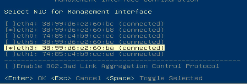

1. As shown in Figure 2, log in to the CAS operating system of the blade server through the KVM through the remote control function on the OM Web page.
Figure 2 Logging in to the CAS operating system through the KVM

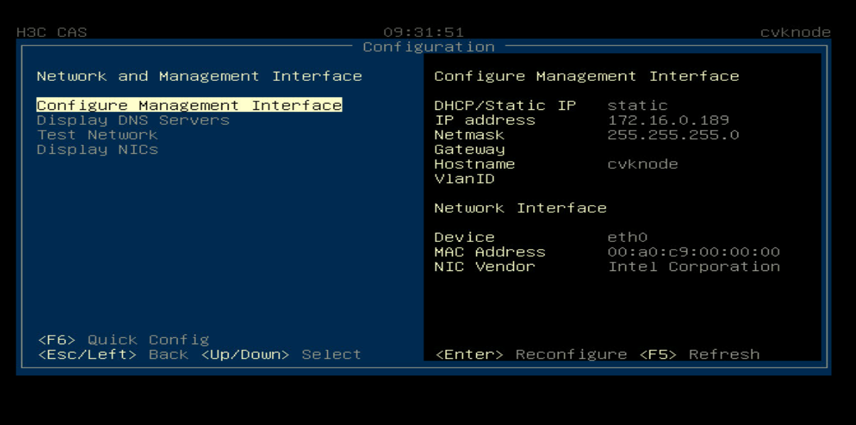

2. As shown in Figure 3, on the main page of the CAS OS, select Network and Management Interface to enter the network adapter selection page and bind the OS to the two selected ports on the mezzanine card.
Figure 3 Binding the CAS OS to the selected ports

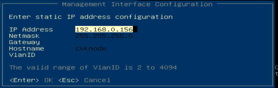

3. As shown in Figure 4, configure the IP address of the CAS OS on the bound ports.
Figure 4 Configuring the IP address of the CAS OS
NOTE: In this example, Gateway and VlanID are not configured. If necessary, please configure them according to the actual situation. |

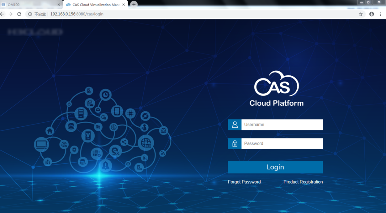

1. Set the IP address of the local PC to and address with the same network segment as the IP address of the CAS OS. As shown in Figure 5, the IP address of the CAS OS can be successfully pinged through the local PC.
Figure 5 Pinging the IP address of the CAS OS through the local PC
2. As shown in Figure 6, you can log in to the management web page by entering 192.168.0.156: 8080/CAS in the local PC browser.
Figure 6 Web page of the CAS OS

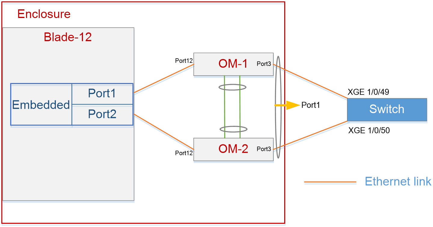

As shown in Figure 7, in the H3C B16000 blade server chassis, the blade server is installed in slot 12, and two OM modules are installed in place. The OS is installed in the blade server. The two OM modules are directly connected to the same aggregation switch through external service ports.
In this example, the blade server (H3C UniServer B5700 G3) and the operating system (VMware ESXI6.7U1) are used.
Through the external service ports of OM modules, users can log in to the virtual management network under the ESXi operating system of the blade server, and the network is redundant.
Analysis
· By default, the two OM modules form an active/standby relation automatically through internal ports, thus ensuring the redundancy of the OM modules.
· When no special VLAN configuration is required, you must configure the VLAN policy of the OM modules and set the PVID of internal and external ports to VLAN1, to ensure layer-2 link communication.
· To improve the downlink reliability of the OM modules, you must add the external ports of the two OM modules to the aggregation port.

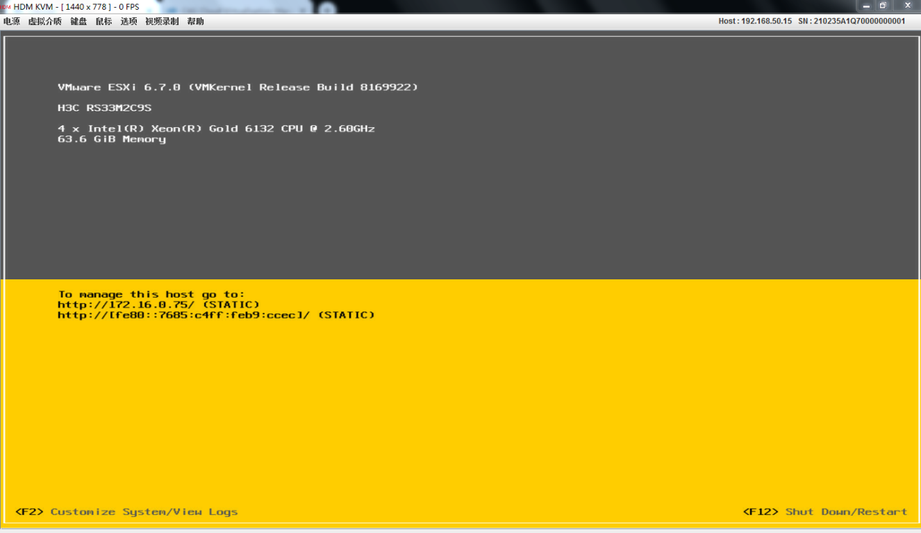

1. As shown in Figure 8, log in to the VMware ESXi operating system of the blade server through the KVM through the remote control function on the OM Web page.
Figure 8 Logging in to the VMware ESXi operating system through the KVM

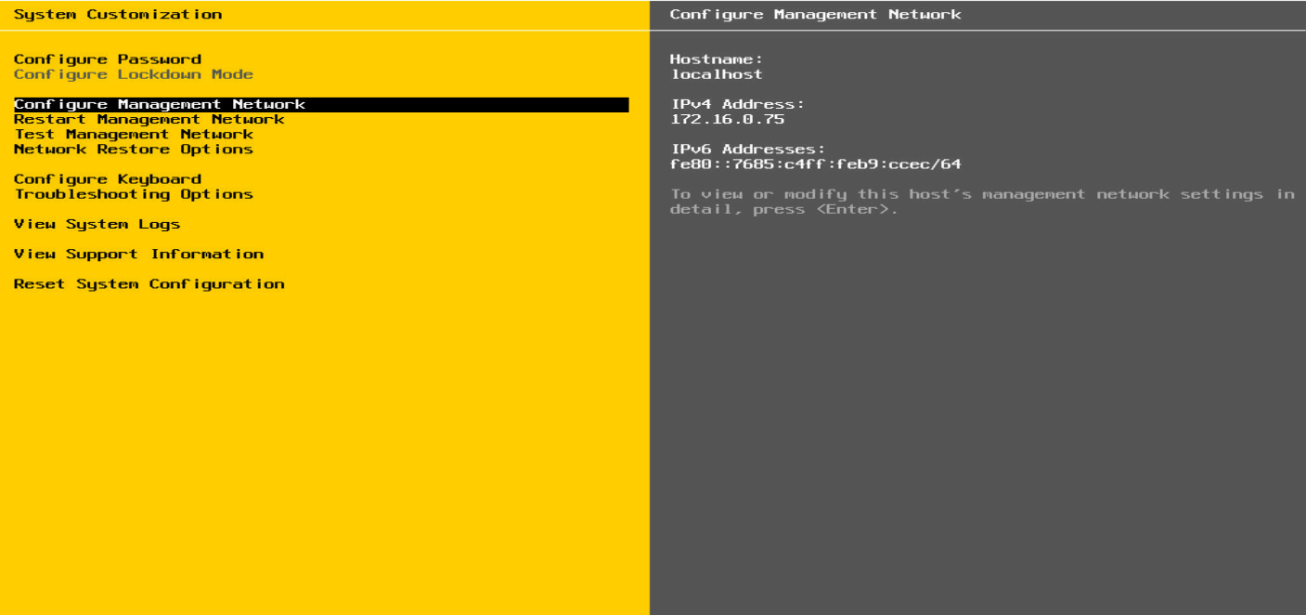

2. As shown in Figure 9, press F2 on the main page, enter the account name and password to enter the operating system configuration page, and select Configure Management Network.
Figure 9 Configuring the VMware ESXi operating system
3. On the operating system configuration page, select Configure Management Network. As shown in Figure 10, enter the management network configuration page.
Figure 10 Configuring the management network under the VMware ESXi operating system

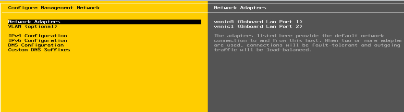

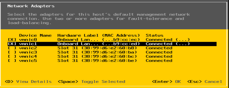

4. On the management network configuration page, select Network Adapters. As shown in Figure 11, enter the network adapter port configuration page, and select vmnic0 and vmnic1 to bind the ports.
NOTE: When selecting the ports on the port configuration page, select onboard ports in the Hardware Label column. Here we use vmnic0 and vmnic1 as an example. |
Figure 11 Configuring the ports on the network adapter under the VMware ESXi operating system

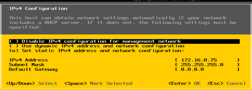

5. As shown in Figure 12, configure the IP address of the management network.

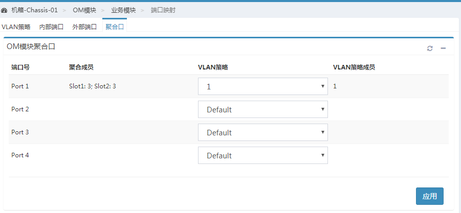

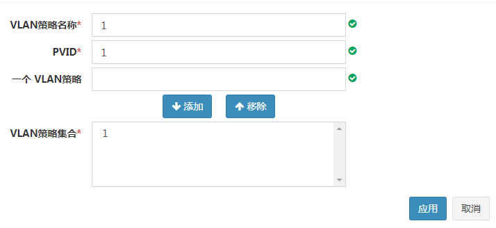

1. As shown in Figure 13, on the OM Web page, click OM Module > Service Module > Port Mapping > VLAN Policy > Add, enter relevant parameters, and apply the VLAN policy.
Figure 13 Configuring a VLAN policy

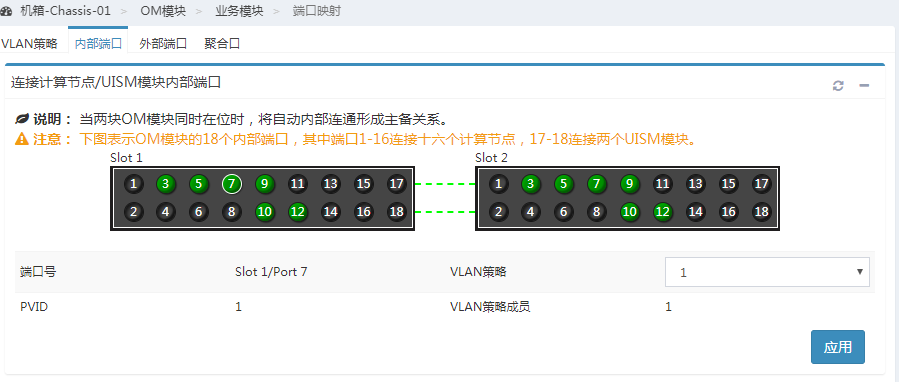

2. As shown in Figure 14, click Internal Ports, select the internal port 12 of OM module 1 and the same port of OM module 2 in the view, and apply the VLAN policy you just created.
Figure 14 Applying the VLAN policy to internal ports

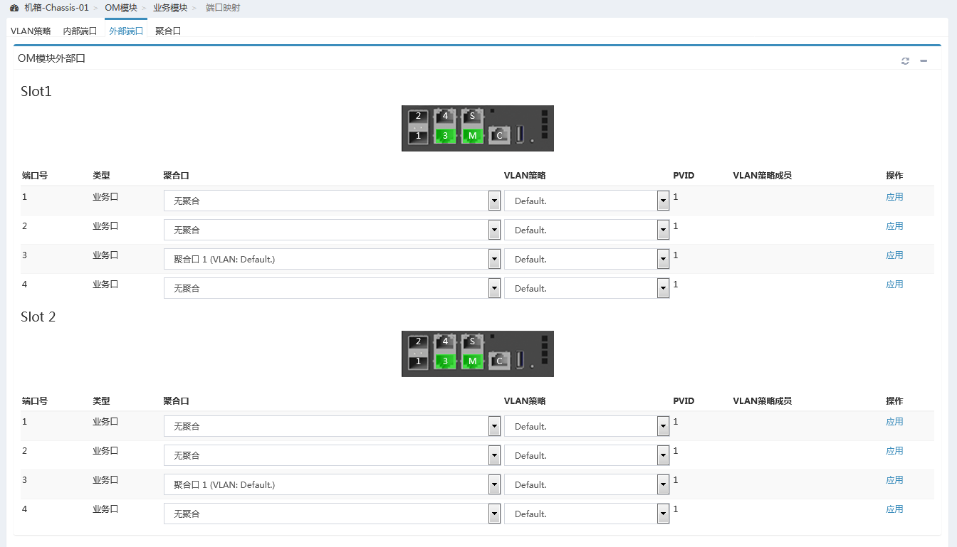

3. As shown in Figure 15, click External Ports, and add the external port 3 of OM module 1 and the same port of OM module 2 to aggregation port 1.
Figure 15 Adding the external ports to the aggregation port
4. As shown in Figure 16, click Aggregation Port to apply the VLAN policy you just created on aggregation port 1.
Figure 16 Applying the VLAN policy to the aggregation port

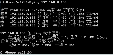

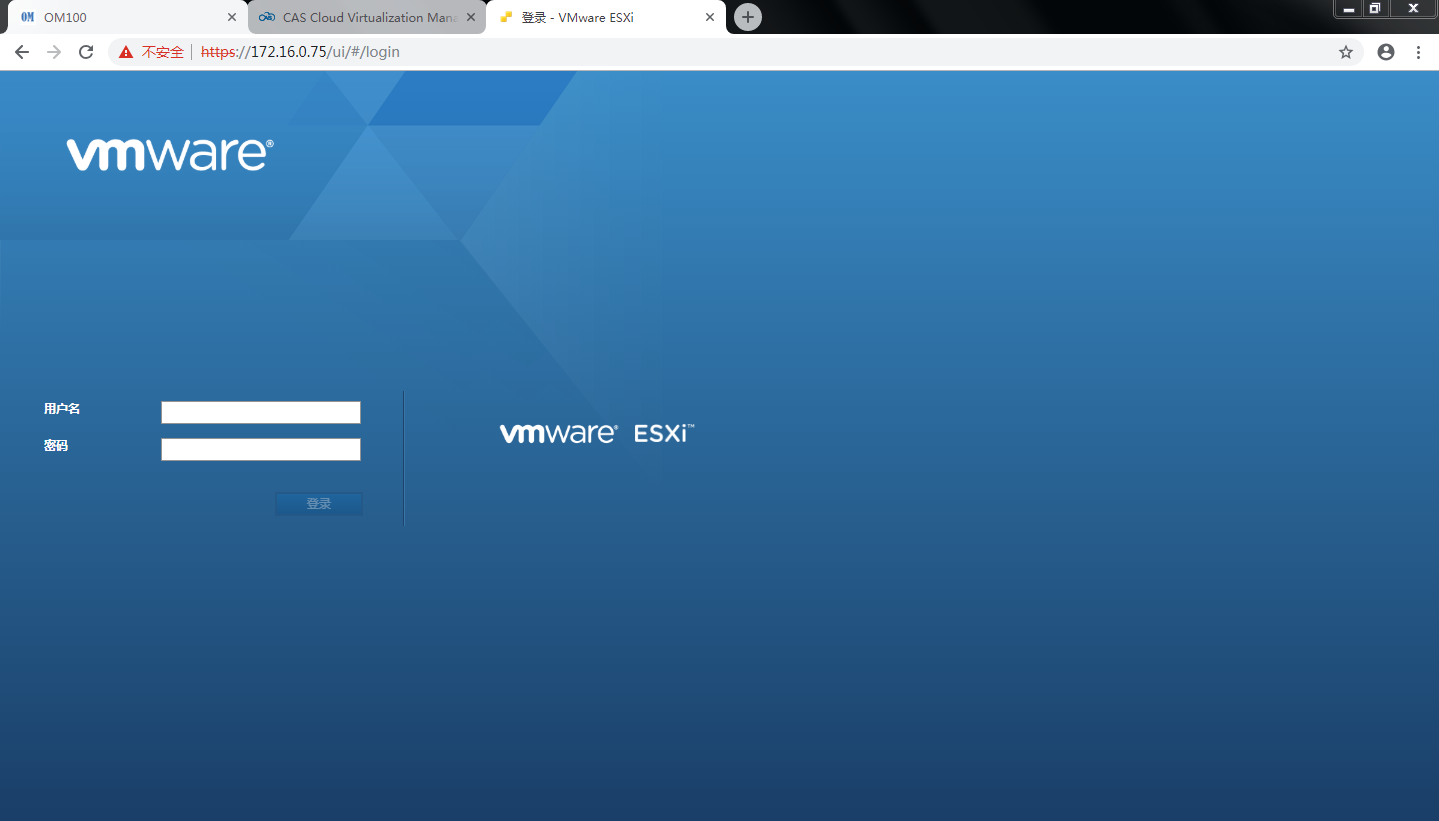

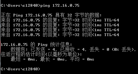

1. Set the IP address of the local PC to an address with the same network segment as the IP address of the VMware ESXi operating system. As shown in Figure 17, the IP address of the VMware ESXi operating system can be successfully pinged through the local PC.
Figure 17 Pinging the IP address of the VMware ESXi operating system through the local PC
2. As shown in Figure 18, you can log in to the management web page by the IP address of the VMware ESXi operating system in the local PC browser.
Figure 18 Logging in to the VMware ESXi web page
