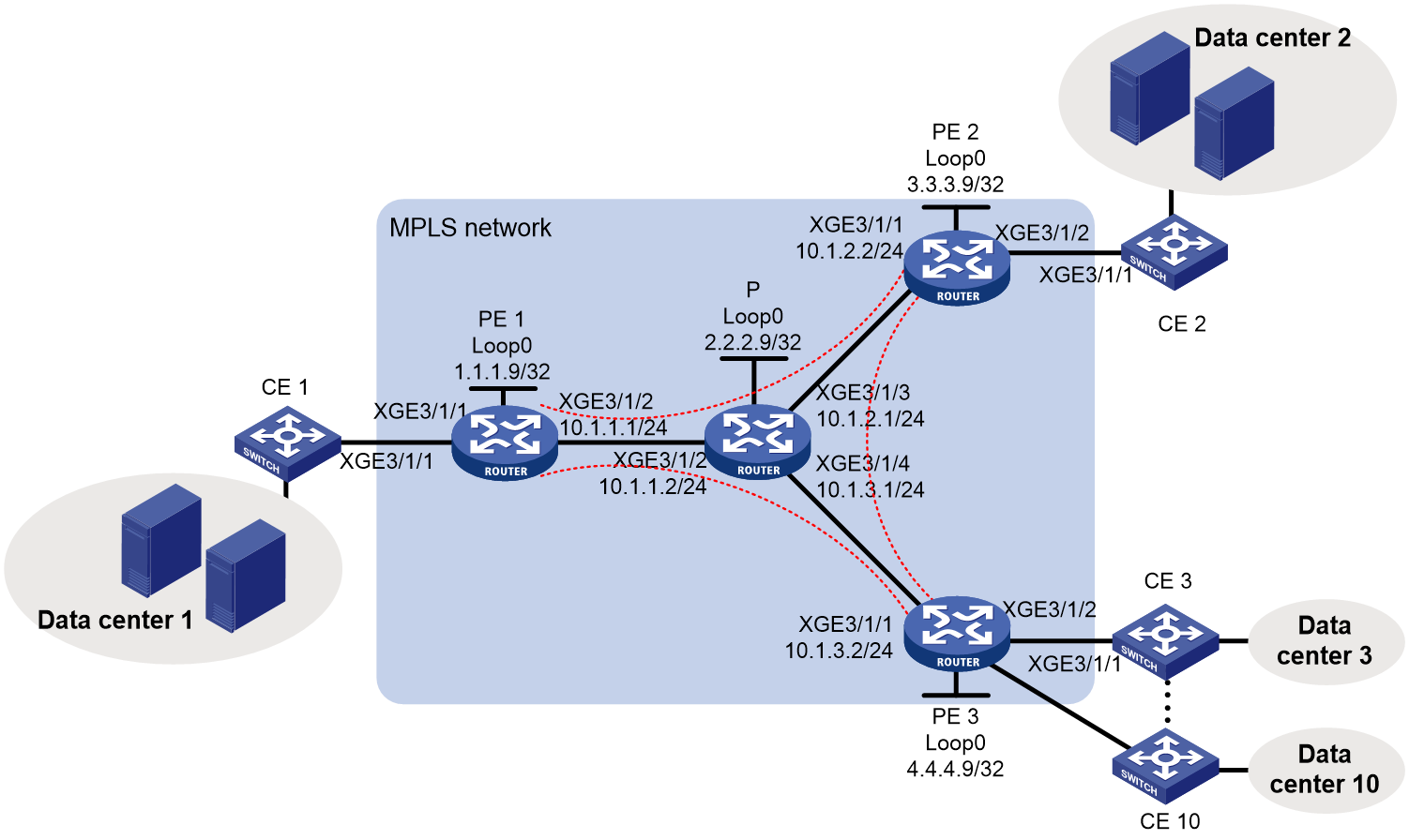

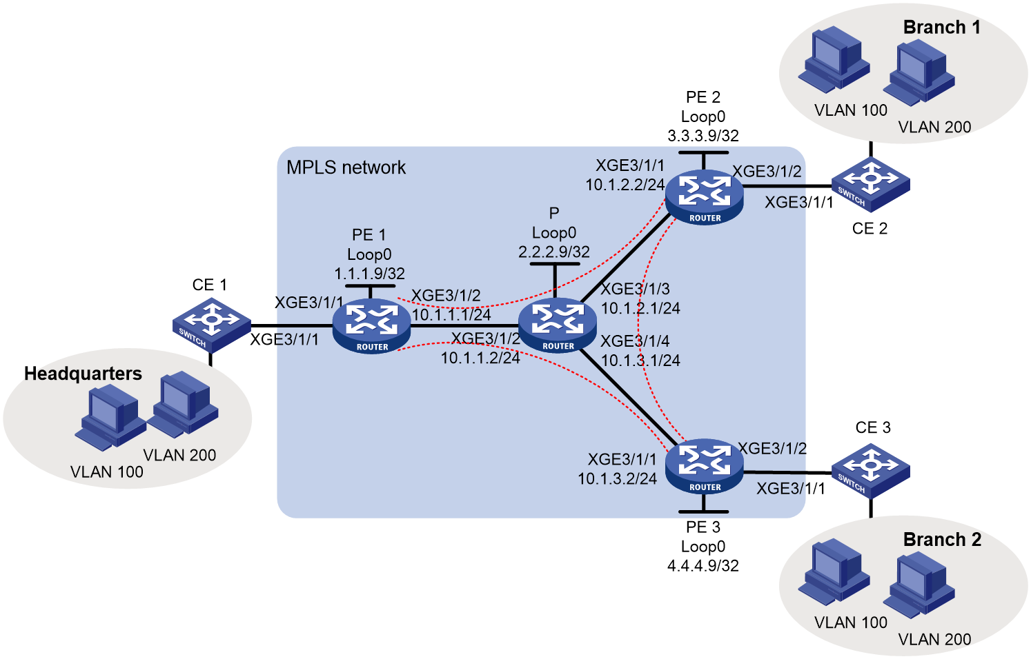

Example: Configuring full-mesh LDP VPLS
As shown in Figure 1, the MPLS network provides L2VPN services for a company. The company has a headquarters and two branches, and it will not add sites in the future.
Configure full-mesh VPLS using LDP signaling to allow communication among the three sites at Layer 2.
Figure 1 Network diagram

Procedures
1.     Configure an IGP on the MPLS backbone to ensure IP connectivity within the backbone:
# On PE 1, configure an IP address for Loopback 0.
<PE1> system-view
[PE1] interface loopback 0
[PE1-LoopBack0] ip address 1.1.1.9 32
[PE1-LoopBack0] quit
# Configure an IP address for Ten-GigabitEthernet 3/1/2.
[PE1] interface ten-gigabitethernet 3/1/2
[PE1-Ten-GigabitEthernet3/1/2] ip address 10.1.1.1 24
[PE1-Ten-GigabitEthernet3/1/2] quit
# On PE 1, configure OSPF.
[PE1] ospf
[PE1-ospf-1] area 0
[PE1-ospf-1-area-0.0.0.0] network 10.1.1.0 0.0.0.255
[PE1-ospf-1-area-0.0.0.0] network 1.1.1.9 0.0.0.0
[PE1-ospf-1-area-0.0.0.0] quit
[PE1-ospf-1] quit
# On PE 2, configure an IP address for Loopback 0.
<PE2> system-view
[PE2] interface loopback 0
[PE2-LoopBack0] ip address 3.3.3.9 32
[PE2-LoopBack0] quit
# Configure an IP address for Ten-GigabitEthernet 3/1/1.
[PE2] interface ten-gigabitethernet 3/1/1
[PE2-Ten-GigabitEthernet3/1/1] ip address 10.1.2.2 24
[PE2-Ten-GigabitEthernet3/1/1] quit
# On PE 2, configure OSPF.
[PE2] ospf
[PE2-ospf-1] area 0
[PE2-ospf-1-area-0.0.0.0] network 10.1.2.0 0.0.0.255
[PE2-ospf-1-area-0.0.0.0] network 3.3.3.9 0.0.0.0
[PE2-ospf-1-area-0.0.0.0] quit
[PE2-ospf-1] quit
# On PE 3, configure an IP address for Loopback 0.
<PE3> system-view
[PE3] interface loopback 0
[PE3-LoopBack0] ip address 4.4.4.9 32
[PE3-LoopBack0] quit
[PE3] interface ten-gigabitethernet 3/1/1
[PE3-Ten-GigabitEthernet3/1/1] ip address 10.1.3.2 24
[PE3-Ten-GigabitEthernet3/1/1] quit
# On PE 3, configure OSPF.
[PE3] ospf
[PE3-ospf-1] area 0
[PE3-ospf-1-area-0.0.0.0] network 10.1.3.0 0.0.0.255
[PE3-ospf-1-area-0.0.0.0] network 4.4.4.9 0.0.0.0
[PE3-ospf-1-area-0.0.0.0] quit
[PE3-ospf-1] quit
# On P, configure an IP address for Loopback 0.
<P> system-view
[P] interface loopback 0
[P-LoopBack0] ip address 2.2.2.9 32
[P-LoopBack0] quit
[P] interface ten-gigabitethernet 3/1/2
[P-Ten-GigabitEthernet3/1/2] ip address 10.1.1.2 24
[P-Ten-GigabitEthernet3/1/2] quit
# Configure an IP address for Ten-GigabitEthernet 3/1/3.
[P] interface ten-gigabitethernet 3/1/3
[P-Ten-GigabitEthernet3/1/3] ip address 10.1.2.1 24
[P-Ten-GigabitEthernet3/1/3] quit
# Configure an IP address for Ten-GigabitEthernet 3/1/4.
[P] interface ten-gigabitethernet 3/1/4
[P-Ten-GigabitEthernet3/1/4] ip address 10.1.3.1 24
[P-Ten-GigabitEthernet3/1/4] quit
# On P, configure OSPF.
[P] ospf
[P-ospf-1] area 0
[P-ospf-1-area-0.0.0.0] network 10.1.1.0 0.0.0.255
[P-ospf-1-area-0.0.0.0] network 10.1.2.0 0.0.0.255
[P-ospf-1-area-0.0.0.0] network 10.1.3.0 0.0.0.255
[P-ospf-1-area-0.0.0.0] network 2.2.2.9 0.0.0.0
[P-ospf-1-area-0.0.0.0] quit
[P-ospf-1] quit
2.     Configure basic MPLS and MPLS LDP on the MPLS backbone to establish LDP LSPs:
# On PE 1, configure an LSR ID.
[PE1] mpls lsr-id 1.1.1.9
# On PE 1, enable LDP globally.
[PE1] mpls ldp
[PE1-ldp] quit
# On PE 1, enable MPLS and LDP on Ten-GigabitEthernet 3/1/2.
[PE1-Ten-GigabitEthernet3/1/2] mpls enable
[PE1-Ten-GigabitEthernet3/1/2] mpls ldp enable
# On PE 2, configure an LSR ID.
[PE2] mpls lsr-id 3.3.3.9
# On PE 2, enable LDP globally.
[PE2] mpls ldp
[PE2-ldp] quit
# On PE 2, enable MPLS and LDP on Ten-GigabitEthernet 3/1/1.
[PE2-Ten-GigabitEthernet3/1/1] mpls enable
[PE2-Ten-GigabitEthernet3/1/1] mpls ldp enable
# On PE 3, configure an LSR ID.
[PE3] mpls lsr-id 4.4.4.9
# On PE 3, enable LDP globally.
[PE3] mpls ldp
[PE3-ldp] quit
# On PE 3, enable MPLS and LDP on Ten-GigabitEthernet 3/1/1.
[PE3-Ten-GigabitEthernet3/1/1] mpls enable
[PE3-Ten-GigabitEthernet3/1/1] mpls ldp enable
# On P, configure an LSR ID.
[P] mpls lsr-id 2.2.2.9
# On P, enable LDP globally.
[P] mpls ldp
[P-ldp] quit
# On P, enable MPLS and LDP on Ten-GigabitEthernet 3/1/2.
[P-Ten-GigabitEthernet3/1/2] mpls enable
[P-Ten-GigabitEthernet3/1/2] mpls ldp enable
# On P, enable MPLS and LDP on Ten-GigabitEthernet 3/1/3.
[P-Ten-GigabitEthernet3/1/3] mpls enable
[P-Ten-GigabitEthernet3/1/3] mpls ldp enable
# On P, enable MPLS and LDP on Ten-GigabitEthernet 3/1/4.
[P-Ten-GigabitEthernet3/1/4] mpls enable
[P-Ten-GigabitEthernet3/1/4] mpls ldp enable
3.     Configure VSIs and LDP PWs:
# On PE 1, enable MPLS L2VPN globally.
[PE1] l2vpn enable
# On PE 1, create VSI user_a and configure the VSI to use LDP as the PW signaling protocol.
[PE1] vsi user_a
[PE1-vsi-user_a] pwsignaling ldp
# On PE 1, specify PE 2 and PE 3 as the peer PEs, and set the PW ID to 500.
[PE1-vsi-user_a-ldp] peer 3.3.3.9 pw-id 500
[PE1-vsi-user_a-ldp-3.3.3.9-500] quit
[PE1-vsi-user_a-ldp] peer 4.4.4.9 pw-id 500
[PE1-vsi-user_a-ldp-4.4.4.9-500] quit
[PE1-vsi-user_a-ldp] quit
[PE1-vsi-user_a] quit
# On PE 1, create VSI user_b and configure the VSI to use LDP as the PW signaling protocol.
[PE1] vsi user_b
[PE1-vsi-user_b] pwsignaling ldp
# On PE 1, specify PE 2 and PE 3 as the peer PEs, and set the PW ID to 600.
[PE1-vsi-user_b-ldp] peer 3.3.3.9 pw-id 600
[PE1-vsi-user_b-ldp-3.3.3.9-600] quit
[PE1-vsi-user_b-ldp] peer 4.4.4.9 pw-id 600
[PE1-vsi-user_b-ldp-4.4.4.9-600] quit
[PE1-vsi-user_b-ldp] quit
[PE1-vsi-user_b] quit
# On PE 2, enable MPLS L2VPN globally.
[PE2] l2vpn enable
# On PE 2, create VSI user_a and configure the VSI to use LDP as the PW signaling protocol.
[PE2] vsi user_a
[PE2-vsi-user_a] pwsignaling ldp
# On PE 2, specify PE 1 and PE 3 as the peer PEs, and set the PW ID to 500.
[PE2-vsi-user_a-ldp] peer 1.1.1.9 pw-id 500
[PE2-vsi-user_a-ldp-1.1.1.9-500] quit
[PE2-vsi-user_a-ldp] peer 4.4.4.9 pw-id 500
[PE2-vsi-user_a-ldp-4.4.4.9-500] quit
[PE2-vsi-user_a-ldp] quit
[PE2-vsi-user_a] quit
# On PE 2, create VSI user_b and configure the VSI to use LDP as the PW signaling protocol.
[PE2] vsi user_b
[PE2-vsi-user_b] pwsignaling ldp
# On PE 2, specify PE 1 and PE 3 as the peer PEs, and set the PW ID to 600.
[PE2-vsi-user_b-ldp] peer 1.1.1.9 pw-id 600
[PE2-vsi-user_b-ldp-1.1.1.9-600] quit
[PE2-vsi-user_b-ldp] peer 4.4.4.9 pw-id 600
[PE2-vsi-user_b-ldp-4.4.4.9-600] quit
[PE2-vsi-user_b-ldp] quit
[PE2-vsi-user_b] quit
# On PE 3, enable MPLS L2VPN globally.
[PE3] l2vpn enable
# On PE 3, create VSI user_a and configure the VSI to use LDP as the PW signaling protocol.
[PE3] vsi user_a
[PE3-vsi-user_a] pwsignaling ldp
# On PE 3, specify PE 1 and PE 2 as the peer PEs, and set the PW ID to 500.
[PE3-vsi-user_a-ldp] peer 1.1.1.9 pw-id 500
[PE3-vsi-user_a-ldp-1.1.1.9-500] quit
[PE3-vsi-user_a-ldp] peer 3.3.3.9 pw-id 500
[PE3-vsi-user_a-ldp-3.3.3.9-500] quit
[PE3-vsi-user_a-ldp] quit
[PE3-vsi-user_a] quit
# On PE 3, create VSI user_b and configure the VSI to use LDP as the PW signaling protocol.
[PE3] vsi user_b
[PE3-vsi-user_b] pwsignaling ldp
# On PE 3, specify PE 1 and PE 2 as the peer PEs, and set the PW ID to 600.
[PE3-vsi-user_b-ldp] peer 1.1.1.9 pw-id 600
[PE3-vsi-user_b-ldp-1.1.1.9-600] quit
[PE3-vsi-user_b-ldp] peer 3.3.3.9 pw-id 600
[PE3-vsi-user_b-ldp-3.3.3.9-600] quit
[PE3-vsi-user_b-ldp] quit
[PE3-vsi-user_b] quit
4.     Configure Layer 3 subinterfaces for different VLANs and bind the subinterfaces to VSIs:
# On PE 1, create subinterface Ten-GigabitEthernet3/1/1.100, configure the subinterface to terminate packets whose outermost VLAN ID is 100, and bind the subinterface to VSI user_a.
[PE1] interface ten-gigabitethernet 3/1/1.100
[PE1-Ten-GigabitEthernet3/1/1.100] vlan-type dot1q vid 100
[PE1-Ten-GigabitEthernet3/1/1.100] xconnect vsi user_a
[PE1-Ten-GigabitEthernet3/1/1.100] quit
# On PE 1, create subinterface Ten-GigabitEthernet3/1/1.200, configure the subinterface to terminate packets whose outermost VLAN ID is 200, and bind the subinterface to VSI user_b.
[PE1] interface ten-gigabitethernet 3/1/1.200
[PE1-Ten-GigabitEthernet3/1/1.200] vlan-type dot1q vid 200
[PE1-Ten-GigabitEthernet3/1/1.200] xconnect vsi user_b
[PE1-Ten-GigabitEthernet3/1/1.200] quit
# On PE 2, create subinterface Ten-GigabitEthernet3/1/2.100, configure the subinterface to terminate packets whose outermost VLAN ID is 100, and bind the subinterface to VSI user_a.
[PE2] interface ten-gigabitethernet 3/1/2.100
[PE2-Ten-GigabitEthernet3/1/2.100] vlan-type dot1q vid 100
[PE2-Ten-GigabitEthernet3/1/2.100] xconnect vsi user_a
[PE2-Ten-GigabitEthernet3/1/2.100] quit
# On PE 2, create subinterface Ten-GigabitEthernet 3/1/2.200, configure the subinterface to terminate packets whose outermost VLAN ID is 200, and bind the subinterface to VSI user_b.
[PE2] interface ten-gigabitethernet 3/1/2.200
[PE2-Ten-GigabitEthernet3/1/1.200] vlan-type dot1q vid 200
[PE2-Ten-GigabitEthernet3/1/2.200] xconnect vsi user_b
[PE2-Ten-GigabitEthernet3/1/2.200] quit
# On PE 3, create subinterface Ten-GigabitEthernet3/1/2.100, configure the subinterface to terminate packets whose outermost VLAN ID is 100, and bind the subinterface to VSI user_a.
[PE3] interface ten-gigabitethernet 3/1/2.100
[PE3-Ten-GigabitEthernet3/1/2.100] vlan-type dot1q vid 100
[PE3-Ten-GigabitEthernet3/1/2.100] xconnect vsi user_a
[PE3-Ten-GigabitEthernet3/1/2.100] quit
# On PE 3, create subinterface Ten-GigabitEthernet3/1/2.200, configure the subinterface to terminate packets whose outermost VLAN ID is 200, and bind the subinterface to VSI user_b.
[PE3] interface ten-gigabitethernet 3/1/2.200
[PE3-Ten-GigabitEthernet3/1/2.200] vlan-type dot1q vid 200
[PE3-Ten-GigabitEthernet3/1/2.200] xconnect vsi user_b
[PE3-Ten-GigabitEthernet3/1/2.200] quit

# Verify that LDP LSPs have been established on each switch in the MPLS network. This example uses PE 1.
[PE1] display mpls ldp lsp
VPN instance: public instance
Status Flags: * - stale, L - liberal, B - backup, N/A – unavailable
FECs: 4           Ingress: 3           Transit: 3           Egress: 1
FEC                In/Out Label        Nexthop         OutInterface/LSINDEX
1.1.1.9/32         3/-
                   -/1151(L)
                   -/1151(L)
                   -/1151(L)
2.2.2.9/32         -/3             10.1.1.2        XGE3/1/2
                   1151/3          10.1.1.2        XGE3/1/2
                   -/1150(L)
                   -/1150(L)
3.3.3.9/32         -/1150          10.1.1.2        XGE3/1/2
                   1150/1150       10.1.1.2        XGE3/1/2
                   -/3(L)
                   -/1149(L)
4.4.4.9/32         -/1149          10.1.1.2        XGE3/1/2
                   1149/1149       10.1.1.2        XGE3/1/2
                   -/1149(L)
                   -/3(L)
# Verify that LDP PWs in up state have been established on each PE. This example uses PE 1.
[PE1] display l2vpn pw
Flags: M - main, B - backup, E - ecmp, BY - bypass, H - hub link, S - spoke link
       N - no split horizon, A – administration, ABY – ac-bypass
       PBY – pw-bypass
Total number of PWs: 4
4 up, 0 blocked, 0 down, 0 defect, 0 idle, 0 duplicate
VSI Name: user_a
Peer            PWID/RmtSite/SrvID In/Out Label   Proto  Flag Link ID  State
3.3.3.9         500                131198/13119   LDP    M    64       Up
4.4.4.9         500                131199/1150    LDP    M    65       Up
VSI Name: user_b
3.3.3.9         600                131196/131196  LDP    M    64       Up
4.4.4.9         600                131197/1147    LDP    M    65       Up
# Verify that hosts in the same VLAN but different sites can ping each other. (Details not shown.)

Example: Configuring full-mesh LDP VPLS using BGP auto-discovery
As shown in Figure 2, the MPLS network provides L2VPN services for a company. The company has a headquarters and a large number of branches, and it will not add sites in the future.
Configure full-mesh VPLS using BGP auto-discovery and LDP signaling to allow communication among all the sites at Layer 2.
Figure 2 Network diagram
Analysis
To meet the network requirements, you must perform the following tasks:
·     To implement LDP VPLS using BGP auto-discovery over the MPLS backbone, you must perform the following tasks:
¡     Establish LDP LSPs on the MPLS backbone as public tunnels to deliver the private data over the MPLS network.
¡     Configure a BGP auto-discovery LDP PW between any two PEs to forward data among the branches.
¡     Configure Layer 3 subinterfaces of the CE-facing interfaces on PEs to identify packets to be transported by VPLS.
·     To implement VLAN isolation among the sites, create VSIs user_a and user_b. Bind VSI user_a to the subinterface that matches packets of VLAN 100, and bind VSI user_b to the subinterface that matches packets of VLAN 200.

Example: Configuring full-mesh BGP VPLS
As shown in Figure 3, the MPLS network provides L2VPN services for a company. The company has 10 data centers and will add 15 data centers in the future.
Configure full-mesh VPLS using BGP signaling to allow communication among the data centers at Layer 2.
Figure 3 Network diagram
Analysis
·     To implement BGP VPLS over the MPLS backbone, you must perform the following tasks:
¡     Configure a BGP PW between any two PEs to forward data among the data centers.
¡     Configure subinterfaces and match criteria of the CE-facing interfaces on PEs to identify packets to be transported by VPLS.
·     For future expansion of the customer network, set the maximum number of sites in the VPN to 25.
Procedures
<PE1> system-view
[PE1] ospf
[PE1-ospf-1] area 0
[PE1-ospf-1] quit
<PE2> system-view
[PE2] ospf
[PE2-ospf-1] area 0
[PE2-ospf-1] quit
<PE3> system-view
[PE3] ospf
[PE3-ospf-1] area 0
[PE3-ospf-1] quit
<P> system-view
[P-LoopBack0] quit
[P] ospf
[P-ospf-1] area 0
[P-ospf-1] quit
[PE1] mpls ldp
[PE1-ldp] quit
[PE2] mpls ldp
[PE2-ldp] quit
[PE3] mpls ldp
[PE3-ldp] quit
[P] mpls ldp
[P-ldp] quit
3.     Configure VSIs and BGP PWs:
# On PE 1, establish IBGP connections to PE 2 and PE 3.
[PE1] bgp 100
[PE1-bgp] peer 3.3.3.9 as-number 100
[PE1-bgp] peer 3.3.3.9 connect-interface loopback 0
[PE1-bgp] peer 4.4.4.9 as-number 100
[PE1-bgp] peer 4.4.4.9 connect-interface loopback 0
# On PE 1, enable BGP to exchange L2VPN information with the peers.
[PE1-bgp] address-family l2vpn
[PE1-bgp-l2vpn] peer 3.3.3.9 enable
[PE1-bgp-l2vpn] peer 4.4.4.9 enable
[PE1-bgp-l2vpn] quit
[PE1-bgp] quit
[PE1] l2vpn enable
# On PE 1, create VSI user_a and enable the VSI to automatically discover neighbors through BGP.
[PE1] vsi user_a
[PE1-vsi-user_a] auto-discovery bgp
# On PE 1, configure an RD and route targets for the VSI.
[PE1-vsi-user_a-auto] route-distinguisher 100:1
[PE1-vsi-user_a-auto] vpn-target 111:1
# On PE 1, use BGP to establish a PW to a remote PE discovered by BGP.
[PE1-vsi-user_a-auto] signaling-protocol bgp
# On PE 1, set the site number in the VSI to 1 and the maximum number of sites in the VSI to 25.
[PE1-vsi-user_a-auto-bgp] site 1 range 25
[PE1-vsi-user_a-auto-bgp] quit
[PE1-vsi-user_a-auto] quit
# On PE 1, create VSI user_b and enable the VSI to automatically discover neighbors through BGP.
[PE1] vsi user_b
[PE1-vsi-user_b] auto-discovery bgp
[PE1-vsi-user_b-auto] route-distinguisher 100:1
[PE1-vsi-user_b-auto] vpn-target 111:1
[PE1-vsi-user_b-auto] signaling-protocol bgp
[PE1-vsi-user_b-auto-bgp] site 1 range 25
[PE1-vsi-user_b-auto-bgp] quit
[PE1-vsi-user_b-auto] quit
# On PE 2, establish IBGP connections to PE 1 and PE 3.
[PE2] bgp 100
[PE2-bgp] peer 1.1.1.9 as-number 100
[PE2-bgp] peer 1.1.1.9 connect-interface loopback 0
[PE2-bgp] peer 4.4.4.9 as-number 100
[PE2-bgp] peer 4.4.4.9 connect-interface loopback 0
# On PE 2, enable BGP to exchange L2VPN information with the peers.
[PE2-bgp] address-family l2vpn
[PE2-bgp-l2vpn] peer 1.1.1.9 enable
[PE2-bgp-l2vpn] peer 4.4.4.9 enable
[PE2-bgp-l2vpn] quit
[PE2-bgp] quit
[PE2] l2vpn enable
# On PE 2, create VSI user_a and enable the VSI to automatically discover neighbors through BGP.
[PE2] vsi user_a
[PE2-vsi-user_a] auto-discovery bgp
# On PE 2, configure an RD and route targets for the VSI.
[PE2-vsi-user_a-auto] route-distinguisher 100:1
[PE2-vsi-user_a-auto] vpn-target 111:1
# On PE 2, use BGP to establish a PW to a remote PE discovered by BGP.
[PE2-vsi-user_a-auto] signaling-protocol bgp
# On PE 2, set the site number in the VSI to 2 and the maximum number of sites in the VSI to 25.
[PE2-vsi-user_a-auto-bgp] site 2 range 25
[PE2-vsi-user_a-auto-bgp] quit
[PE2-vsi-user_a-auto] quit
# On PE 2, create VSI user_b and enable the VSI to automatically discover neighbors through BGP.
[PE2] vsi user_b
[PE2-vsi-user_b] auto-discovery bgp
[PE2-vsi-user_b-auto] route-distinguisher 200:1
[PE2-vsi-user_b-auto] vpn-target 222:1
[PE2-vsi-user_b-auto] signaling-protocol bgp
[PE2-vsi-user_b-auto-bgp] site 2 range 25
[PE2-vsi-user_b-auto-bgp] quit
[PE2-vsi-user_b-auto] quit
# On PE 3, establish IBGP connections to PE 1 and PE 2.
[PE3] bgp 100
[PE3-bgp] peer 1.1.1.9 as-number 100
[PE3-bgp] peer 1.1.1.9 connect-interface loopback 0
[PE3-bgp] peer 3.3.3.9 as-number 100
[PE3-bgp] peer 3.3.3.9 connect-interface loopback 0
# On PE 3, enable BGP to exchange L2VPN information with the peers.
[PE3-bgp] address-family l2vpn
[PE3-bgp-l2vpn] peer 1.1.1.9 enable
[PE3-bgp-l2vpn] peer 3.3.3.9 enable
[PE3-bgp-l2vpn] quit
[PE3-bgp] quit
[PE3] l2vpn enable
# On PE 3, create VSI user_a and enable the VSI to automatically discover neighbors through BGP.
[PE3] vsi user_a
[PE3-vsi-user_a] auto-discovery bgp
# On PE 3, configure an RD and route targets for the VSI.
[PE3-vsi-user_a-auto] route-distinguisher 100:1
[PE3-vsi-user_a-auto] vpn-target 111:1
# On PE 3, use BGP to establish a PW to a remote PE discovered by BGP.
[PE3-vsi-user_a-auto] signaling-protocol bgp
# On PE 3, set the site number in the VSI to 3 and the maximum number of sites in the VSI to 25.
[PE3-vsi-user_a-auto-bgp] site 3 range 25
[PE3-vsi-user_a-auto-bgp] quit
[PE3-vsi-user_a-auto] quit
# Enable MPLS L2VPN globally.
[PE3] l2vpn enable
# On PE 3, create VSI user_b and enable the VSI to automatically discover neighbors through BGP.
[PE3] vsi user_b
[PE3-vsi-user_b] auto-discovery bgp
[PE3-vsi-user_b-auto] route-distinguisher 200:1
[PE3-vsi-user_b-auto] vpn-target 222:1
[PE3-vsi-user_b-auto] signaling-protocol bgp
[PE3-vsi-user_b-auto-bgp] site 3 range 25
[PE3-vsi-user_b-auto-bgp] quit
[PE3-vsi-user_b-auto] quit
# On PE 2, create subinterface Ten-GigabitEthernet3/1/2.200, configure the subinterface to terminate packets whose outermost VLAN ID is 200, and bind the subinterface to VSI user_b.
# On PE 3, configure other CE-facing interfaces in the same way that Ten-GigabitEthernet3/1/2 is configured. (Details not shown.)
5.     Allow CE access to PEs:
# On CE 1, configure the interface connected to the PE to permit tagged packets from the customer VLANs.
<CE1> system-view
[CE1] vlan 100
[CE1-vlan100] quit
[CE1] vlan 200
[CE1-vlan200] quit
[CE1] interface ten-gigabitethernet 3/1/1
[CE1-Ten-GigabitEthernet3/1/1] port link-type trunk
[CE1-Ten-GigabitEthernet3/1/1] port trunk permit vlan 100 200
# Configure other CEs in the same way that CE 1 is configured. (Details not shown.)

# Verify BGP PWs in up state have been established on each PE. This example uses PE 1.
       PBY – pw-bypass
VSI Name: user_a
3.3.3.9         2                  131074/131073  BGP    M    257      Up
4.4.4.9         3                  131075/131073  BGP    M    258      Up
VSI Name: user_b
3.3.3.9         2                  131071/131070  BGP    M    257      Up
4.4.4.9         3                  131072/131070  BGP    M    258      Up

Example: Configuring H-VPLS with LSP access
As shown in Figure 4, a customer's branches are connected to the MPLS backbone through UPEs that support MPLS L2VPN.
Configure H-VPLS to allow communication among the branches at Layer 2.
·     Connect the UPEs to the NPEs through LSPs.
·     Configure UPE dual homing to achieve redundancy.
Figure 4 Network diagram
