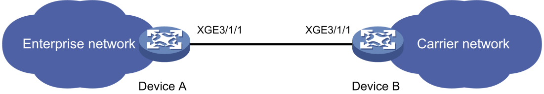

As shown in Figure 1, the edge devices Device A and Device B connect the enterprise network and the carrier network. Configure Ethernet OAM on Device A and Device B to meet the following Service Level Agreement (SLA) requirements:
· Device A and Device B automatically monitor the link between them.
· The administrator can view critical link events on the link between Device A and Device B.
· The administrator can obtain the link status by observing link error event statistics.
