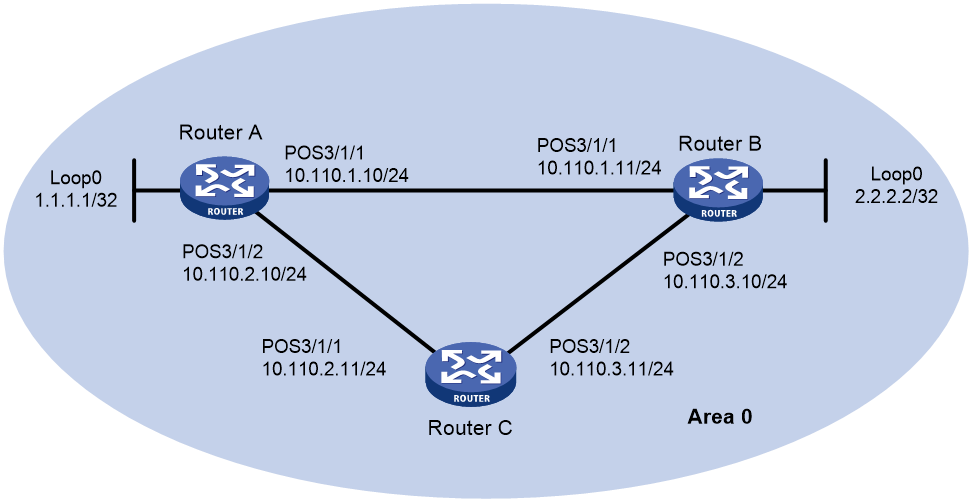

Example: Directly connecting routers through POS interfaces that use PPP
As shown in Figure 1, connect Router A, Router B, and Router C with each other through POS interfaces that use PPP encapsulation. Run OSPF on the routers to implement Layer 3 connectivity. Configure the POS interfaces to meet the following requirements:
· When the link between Router A and Router B is up, the traffic from Router A to Router B is forwarded through the path Router A > Router B.
· Upon receiving MS-RDI signals from Router B, Router A does not immediately shut down POS 3/1/1. Instead, Router A places the POS interface in down state if the signals keeps arriving within 100 milliseconds.
· When POS 3/1/1 on Router A goes down, the traffic from Router A to Router B switches to the path Router A > Router C > Router B.
Analysis
To configure Router A to take an action when an RDI alarm occurs on a POS interface, use the alarm-detect rdi action link-down command.
To configure Router A to place a Pos interface in down state only if DRI alarms keeps occurring on the interface within a period of time, set the physical state change suppression interval.
When two routers are directly connected through POS interfaces, set different clock modes on the two routers.
Procedures
Configuring Router A
1. Configure interfaces:
# Assign an IP address to POS 3/1/1.
<RouterA> system-view
[RouterA] interface pos 3/1/1
[RouterA-Pos3/1/1] ip address 10.110.1.10 255.255.255.0
# Enable PPP encapsulation on POS 3/1/1.
[RouterA-Pos3/1/1] link-protocol ppp
# Set the clock mode to master for POS 3/1/1.
[RouterA-Pos3/1/1] clock master
# Configure POS 3/1/1 to go down when an RDI alarm occurs.
[RouterA-Pos3/1/1] alarm-detect rdi action link-down
# Set the physical state change suppression interval to 100 milliseconds for POS 3/1/1.
[RouterA-Pos3/1/1] link-delay msec 100
[RouterA-Pos3/1/1] quit
# Assign an IP address to POS 3/1/2.
[RouterA] interface pos 3/1/2
# Enable PPP encapsulation on POS 3/1/2.
[RouterA-Pos3/1/2] ip address 10.110.2.10 255.255.255.0
[RouterA-Pos3/1/2] link-protocol ppp
# Set the clock mode to master for POS 3/1/2.
[RouterA-Pos3/1/2] clock master
[RouterA-Pos3/1/2] quit
2. Configure OSPF:
[RouterA] ospf
[RouterA-ospf-1] area 0
[RouterA-ospf-1-area-0.0.0.0] network 10.110.1.0 0.0.0.255
[RouterA-ospf-1-area-0.0.0.0] network 10.110.2.0 0.0.0.255
[RouterA-ospf-1-area-0.0.0.0] network 1.1.1.1 0.0.0.0
[RouterA-ospf-1-area-0.0.0.0] quit
[RouterA-ospf-1] quit
Configuring Router B
# Assign an IP address to POS 3/1/1, and enable PPP encapsulation on the interface.
<RouterB> system-view
[RouterB] interface pos 3/1/1
[RouterB-Pos3/1/1] ip address 10.110.1.11 255.255.255.0
[RouterB-Pos3/1/1] link-protocol ppp
[RouterB-Pos3/1/1] quit
# Assign an IP address to POS 3/1/2, and enable PPP encapsulation on the interface.
[RouterB] interface pos 3/1/2
[RouterB-Pos3/1/2] ip address 10.110.3.10 255.255.255.0
[RouterB-Pos3/1/2] link-protocol ppp
[RouterB-Pos3/1/2] quit
2. Configure OSPF:
[RouterB] ospf
[RouterB-ospf-1] area 0
[RouterB-ospf-1-area-0.0.0.0] network 10.110.1.0 0.0.0.255
[RouterB-ospf-1-area-0.0.0.0] network 10.110.3.0 0.0.0.255
[RouterB-ospf-1-area-0.0.0.0] network 2.2.2.2 0.0.0.0
[RouterB-ospf-1-area-0.0.0.0] quit
[RouterB-ospf-1] quit
Configuring Router C
<RouterC> system-view
[RouterC] interface pos 3/1/1
[RouterC-Pos3/1/1] ip address 10.110.2.11 255.255.255.0
[RouterC-Pos3/1/1] link-protocol ppp
[RouterC-Pos3/1/1] quit
[RouterC] interface pos 3/1/2
[RouterC-Pos3/1/2] ip address 10.110.3.11 255.255.255.0
[RouterC-Pos3/1/2] link-protocol ppp
[RouterC-Pos3/1/2] clock master
[RouterC-Pos3/1/2] quit
2. Configure OSPF:
[RouterC] ospf
[RouterC-ospf-1] area 0
[RouterC-ospf-1-area-0.0.0.0] network 10.110.2.0 0.0.0.255
[RouterC-ospf-1-area-0.0.0.0] network 10.110.3.0 0.0.0.255
[RouterC-ospf-1-area-0.0.0.0] quit
[RouterC-ospf-1] quit

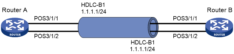

Example: Directly connecting routers through POS interfaces that use HDLC
As shown in Figure 2, configure an HDLC link bundle to increase bandwidth and enhance connection reliability between Router A and Router B.
An interface can belong to only one HDLC link bundle at any point in time. To assign a member interface to another HDLC link bundle, remove the interface from the current HDLC link bundle first.
The link layer protocol of an interface to be assigned to an HDLC link bundle must be HDLC. After the interface is assigned to the HDLC link bundle, its link layer protocol cannot be changed.
Procedures
# Create HDLC link bundle interface 1 and assign an IP address to it.
[RouterA] interface hdlc-bundle 1
[RouterA-HDLC-bundle1] ip address 1.1.1.1 24
[RouterA-HDLC-bundle1] quit
# Set the clock mode to master for POS 3/1/1, and enable HDLC encapsulation on the interface.
[RouterA-Pos3/1/1] link-protocol hdlc
# Assign POS 3/1/1 to HDLC link bundle interface 1.
[RouterA-Pos3/1/1] bundle id 1
# Set the clock mode to master for POS 3/1/2, and enable HDLC encapsulation on the interface.
[RouterA-Pos3/1/2] link-protocol hdlc
# Assign POS 3/1/2 to HDLC link bundle interface 1.
[RouterA-Pos3/1/2] bundle id 1
[RouterB] interface hdlc-bundle 1
[RouterB-HDLC-bundle1] ip address 1.1.1.2 24
[RouterB-HDLC-bundle1] quit
# Enable HDLC encapsulation on the interface.
[RouterB-Pos3/1/1] link-protocol hdlc
[RouterB-Pos3/1/1] bundle id 1
[RouterB-Pos3/1/2] link-protocol hdlc
[RouterB-Pos3/1/2] bundle id 1
# Verify that the bundle interfaces on Router A and Router B can ping each other.
[RouterA] ping –a 1.1.1.1 1.1.1.2
Ping 1.1.1.2 (1.1.1.2) from 1.1.1.1: 56 data bytes, press CTRL_C to break
56 bytes from 1.1.1.2: icmp_seq=0 ttl=255 time=0.000 ms
56 bytes from 1.1.1.2: icmp_seq=1 ttl=255 time=0.000 ms
56 bytes from 1.1.1.2: icmp_seq=2 ttl=255 time=0.000 ms
56 bytes from 1.1.1.2: icmp_seq=3 ttl=255 time=0.000 ms
56 bytes from 1.1.1.2: icmp_seq=4 ttl=255 time=0.000 ms
--- Ping statistics for 1.1.1.2 ---
round-trip min/avg/max/std-dev = 0.000/0.000/0.000/0.000 ms
# Display HDLC link bundle information on Router A and Router B. This example uses Router A.
[RouterA] display bundle hdlc-bundle 1 slot 3
Bundle: HDLC-bundle1
Selected members: 2, Total bandwidth: 1244160 kbps
Member State Bandwidth(kbps) Priority
Pos3/1/1 Selected 622080 32768
Pos3/1/2 Selected 622080 32768
The output shows that HDLC bundle 1 has member interfaces POS 3/1/1 and POS 3/1/2 and both of the member interfaces are in Selected state.
