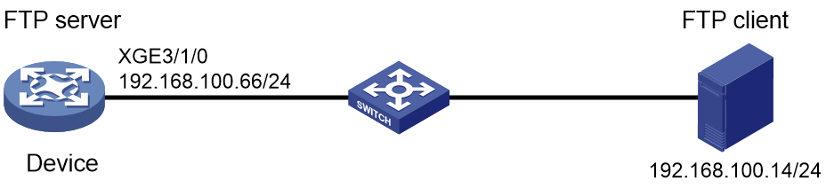

As shown in Figure 1, use TFTP to download a software upgrade file from a TFTP server to upgrade the device.
Figure 1 Network diagram

1.     Configure the TFTP server:
# Assign the IP address 192.168.100.14/24 to the TFTP server. (Details not shown.)
# Start the TFTP server and specify a working directory. (Details not shown.)
2.     Upgrade the device:
# Assign an IP address to Ten-GigabitEthernet 3/1/0. Make sure the device can reach the TFTP server.

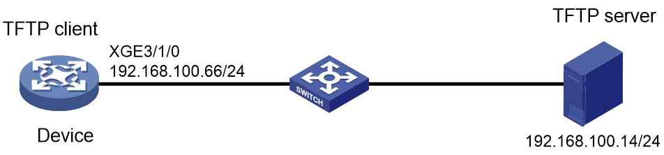

As shown in Figure 2, use FTP to download a software upgrade file from an FTP server to upgrade the device.
Figure 2 Network diagram

1.     Configure the FTP server:
# Assign the IP address 192.168.100.14/24 to the FTP server. (Details not shown.)
# Start the FTP server and specify a working directory. (Details not shown.)
# Add a local user account. (Details not shown.)
# Set the username to 123456 and the password to 123456 for the user account. (Details not shown.)
# Assign an IP address to Ten-GigabitEthernet 3/1/0. Make sure the device can reach the FTP server.

Example: Using the device as an FTP server to upgrade software
As shown in Figure 3, enable the FTP server and configure a local user account on the device to provide FTP service. Use FTP to upload a software upgrade file from an FTP client to upgrade the device.
Figure 3 Network diagram

Procedures
<Device> system-view
[Device] interface ten-gigabitethernet3/1/0
[Device-Ten-GigabitEthernet3/1/0] ip address 192.168.100.66 255.255.255.0
[Device-Ten-GigabitEthernet3/1/0] quit
# Add a local user account. Set the username to abc and the password to 123456TESTuser&!.
[Device] local-user abc
[Device-luser-abc] password simple 123456TESTuser&!
# Assign the network-admin user role to the user account.
[Device-luser-abc] authorization-attribute user-role network-admin
# Remove the default network-operator user role.
[Device-luser-abc] undo authorization-attribute user-role network-operator
# Assign FTP service to the user account.
[Device-luser-abc] service-type ftp
[Device-luser-abc] quit
# Enable the FTP server.
[Device] ftp server enable
[Device] quit
# Save the running configuration.
<Device> save
2.     Configure the FTP client:
# Assign the IP address 192.168.100.14/24 to the FTP client. Make sure the FTP client can reach the device. (Details not shown.)
# Use the username abc and the password 123456 to log in to the FTP server.

Upgrading software from the BootWare menu
Example: Using the device as a TFTP client to upgrade software
As shown in Figure 4, the device cannot start up.
Use TFTP to upgrade the device from the BootWare menu.
Figure 4 Network diagram
When you upgrade software, make sure the device has sufficient storage space for the upgrade file. If the device does not have sufficient storage space, delete unused files by using the delete /unreserved file-url command.
Procedures

2.     Configure the TFTP server:
