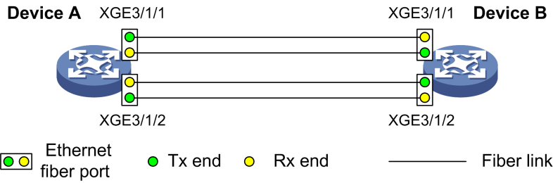

Example: Configuring the auto port shutdown mode
As shown in Figure 1, Device A and Device B are connected through two fiber pairs.
Configure DLDP on the devices so each device performs the following tasks:
· Detects unidirectional links caused by cross-connected fibers or a disconnected fiber.
· Automatically shuts down the faulty interface when detecting a unidirectional link.
· Automatically brings up the interface after the administrator clears the fault.

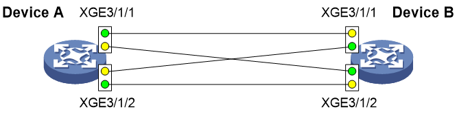

As shown in Figure 2, the two pairs of fibers between Device A and Device B are cross-connected.
Figure 2 Cross-connected fibers
The following log information is displayed on Device A:

The output shows that the physical status of both Ten-GigabitEthernet 3/1/1 and Ten-GigabitEthernet 3/1/2 is down and then up. The link status of both interfaces is down.

As shown in Figure 3, Device A and Device B are connected through two fiber pairs.
Configure DLDP on the devices to meet the following requirements:
· Each device can detect unidirectional links caused by cross-connected fibers or a disconnected fiber.
· When a unidirectional link is detected, the administrator can manually shut down the faulty port based on the connection status of the link.
· The interface recovers from failure after the administrator clears the fault and manually brings up the port.

As shown in Figure 4, the two pairs of fibers between Device A and Device B are cross-connected.
Figure 4 Cross-connected fibers
<DeviceA>%May 3 09:56:57:124 2017 DeviceA IFNET/3/PHY_UPDOWN: -MDC=1; Physical state on the interface Ten-GigabitEthernet3/1/1 changed to down.
%May 3 09:56:57:143 2017 DeviceA IFNET/5/LINK_UPDOWN: -MDC=1; Line protocol state on the interface Ten-GigabitEthernet3/1/1 changed to down.
%May 3 09:56:57:336 2017 DeviceA IFNET/3/PHY_UPDOWN: -MDC=1; Physical state on the interface Ten-GigabitEthernet3/1/2 changed to down.
%May 3 09:56:57:376 2017 DeviceA IFNET/5/LINK_UPDOWN: -MDC=1; Line protocol state on the interface Ten-GigabitEthernet3/1/2 changed to down.
%May 3 09:57:17:365 2017 DeviceA IFNET/3/PHY_UPDOWN: -MDC=1; Physical state on the interface Ten-GigabitEthernet3/1/1 changed to up.
%May 3 09:57:17:365 2017 DeviceA IFNET/5/LINK_UPDOWN: -MDC=1; Line protocol state on the interface Ten-GigabitEthernet3/1/1 changed to up.
%May 3 09:57:18:245 2017 DeviceA IFNET/3/PHY_UPDOWN: -MDC=1; Physical state on the interface Ten-GigabitEthernet3/1/1 changed to up.
%May 3 09:57:18:245 2017 DeviceA IFNET/5/LINK_UPDOWN: -MDC=1; Line protocol state on the interface Ten-GigabitEthernet3/1/1 changed to up.
The output shows that the physical status and link status of both Ten-GigabitEthernet 3/1/1 and Ten-GigabitEthernet 3/1/2 are down and then up.
