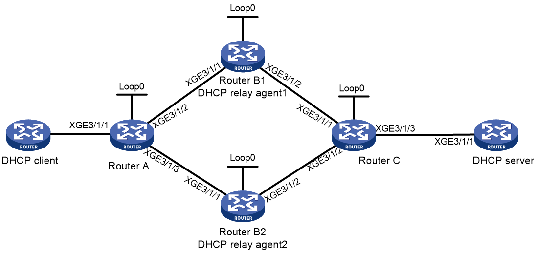

Example: Configuring DHCP relay redundancy on MPLS L2VPN+L3VPN network
Router A and Router B communicate with each other through L2VPN. Router B1 and Router B2 act as DHCP relay agents and communicate with Router C through L3VPN. The DHCP server is deployed on the public network.
Figure 1 Network diagram
Device
Interface
IP address
Device
Interface
IP address
Router A
XGE3/1/1
2.1.1.1/24|10::1/64
Router C
XGE3/1/1
10.1.1.1/24|22::1/64
XGE3/1/2
2.1.1.2/24|11::1/64
XGE3/1/2
20.1.1.3/24|23::1/64
XGE3/1/3
3.1.1.3/24|12::1/64
XGE3/1/3
30.1.1.1/24|33::1/64
Loop0
1.1.1.1/32|1::1/128
Loop0
4.4.4.4/32|5::55/128
Router B1
XGE3/1/1
2.1.1.10/24|11::2/64
DHCP server
XGE3/1/1
30.1.1.2/24|33::2/64
XGE3/1/2
10.1.1.10/24|22::2/64
Loop0
2.2.2.2/32|44::1/128
Router B2
XGE3/1/1
3.1.1.20/24|12::2/64
XGE3/1/2
20.1.1.20/24|23::2/64
Loop0
3.3.3.3/32|66::1/128
Analysis
·     Device A and Device B communicate with each other through L2VPN by establishing LDP PWs. The two-layer label architecture is used. In this example, both the inner and outer labels are generated through LDP.
·     L2VPN uses the VLL technology. Since the network has two DHCP relay agents deployed, the dual receive feature must be enabled for the primary and backup links. After the dual receive feature is enabled, both the primary and backup links can receive packets, but only the primary link sends packets.
·     L3VPN is deployed between Device B and Device C. To have the MPLS network transmit packets, configure IGP on the MPLS backbone network and use LDP to distribute public-network labels. Those distributed labels will be used as the outer labels of VPN packets.
·     Configure the L3VE interfaces of Device B1 and Device B2 as DHCP relay interfaces. Make sure the primary and backup DHCP relay agents use the same relay interface configuration, so users can obtain IP address from the same subnet after primary/backup switchover.
·     For identification purposes, configure different source IPs for packets relayed by the primary and backup DHCP relay agents (Device B1 and Device B2). This configuration ensures that each DHCP request and DHCP reply to that request are processed by the same DHCP relay agent.
When you configure an interface, first bind it to the desired VPN instance, because binding an interface to a VPN instance will clear configurations on that interface, such as IP address.

Router B1
 dhcp enable
interface Ten-GigabitEthernet3/1/1
 port link-mode route
 ip address 2.1.1.10 255.255.255.0
 ospf 1 area 0.0.0.0
 ospfv3 1 area 0.0.0.0
 mpls enable
 mpls ldp enable
 ipv6 address 11::2/64
interface Ten-GigabitEthernet3/1/2
 ip address 10.1.1.10 255.255.255.0
 isis enable 1
 isis ipv6 enable 1
 isis circuit-level level-2
 mpls enable
 mpls ldp enable
 ipv6 address 22::2/64
interface LoopBack0
 ip address 2.2.2.2 255.255.255.255
 ospf 1 area 0.0.0.0
 isis enable 1
 isis ipv6 enable 1
 ipv6 address 44::1/128
interface VE-L3VPN7
 ip binding vpn-instance ipran
 ip address 25.2.0.1 255.255.255.0
 ip address 44.4.0.1 255.255.255.0 sub
 mac-address 586a-b100-0001
 dhcp relay source-address 44.4.0.1
 dhcp select relay
 dhcp relay information enable
 dhcp relay server-address 30.1.1.2
 ipv6 dhcp select relay
 ipv6 dhcp relay source-address 44::1
 ipv6 dhcp relay server-address 33::2
 ipv6 address 6::1/64
 ipv6 nd autoconfig managed-address-flag
 ipv6 nd autoconfig other-flag
 undo ipv6 nd ra halt
interface LoopBack7
interface VE-L2VPN7.1
 qos trust exp
 vlan-type dot1q vid 1
xconnect-group ipran
 connection 1
  ac interface VE-L2VPN7.1
  peer 1.1.1.1 pw-id 4396
ospf 1 router-id 2.2.2.2
 area 0.0.0.0
ospfv3 1
 router-id 2.2.2.2
 area 0.0.0.0
isis 1
 is-level level-2
 network-entity 10.0000.0000.0002.00
 address-family ipv4 unicast
 address-family ipv6 unicast
bgp 100
 peer 4.4.4.4 as-number 100
 peer 4.4.4.4 connect-interface LoopBack0
 address-family vpnv4
  peer 4.4.4.4 enable
 address-family vpnv6
  peer 4.4.4.4 enable
 ip vpn-instance ipran
   import-route direct
   import-route direct
Router B2
 dhcp enable
 ip address 3.1.1.20 255.255.255.0
 ospf 1 area 0.0.0.0
 mpls enable
 mpls ldp enable
 ipv6 address 12::2/64
 ip address 20.1.1.20 255.255.255.0
 isis enable 1
 isis ipv6 enable 1
 mpls enable
 mpls ldp enable
 ipv6 address 23::2/64
interface LoopBack0
 ip address 3.3.3.3 255.255.255.255
 ospf 1 area 0.0.0.0
 isis enable 1
 isis ipv6 enable 1
 ipv6 address 66::1/128
interface VE-L3VPN7
 shutdown
 ip address 25.2.0.1 255.255.0.0
 ip address 45.4.0.1 255.255.255.0 sub
 dhcp relay source-address 45.4.0.1
 dhcp select relay
 ipv6 dhcp relay source-address 45::1
interface LoopBack7
 ipv6 address 45::1/128
 qos trust exp
 connection 1
ospf 1
 non-stop-routing
 area 0.0.0.0
ospfv3 1
 router-id 3.3.3.3
 non-stop-routing
 import-route static
 area 0.0.0.0
isis 1
 is-level level-2
 network-entity 10.0000.0000.0012.00
bgp 100
  import-route direct
  peer 4.4.4.4 enable
  import-route direct
  peer 4.4.4.4 enable
   import-route direct
   import-route direct
Router C
 ip address 20.1.1.3 255.255.255.0
 isis enable 1
 isis ipv6 enable 1
 mpls enable
 mpls ldp enable
 ipv6 address 23::1/64
 isis enable 1
 isis ipv6 enable 1
 mpls enable
 mpls ldp enable
 ipv6 address 22::1/64
interface Ten-GigabitEthernet3/1/3
 ip address 30.1.1.1 255.255.255.0
 ipv6 address 33::1/64
interface LoopBack0
 ip address 4.4.4.4 255.255.255.255
 isis enable 1
 isis ipv6 enable 1
 ipv6 address 5::55/128
bgp 100
 peer 3.3.3.3 as-number 100
 peer 3.3.3.3 connect-interface LoopBack0
peer 2.2.2.2 as-number 100
 peer 2.2.2.2 connect-interface LoopBack0
  peer 3.3.3.3 enable
  peer 2.2.2.2 enable
  peer 3.3.3.3 enable
  peer 2.2.2.2 enable
   import-route direct
   import-route direct
Server
 dhcp enable
ip pool pool3
 gateway-list 25.2.0.1
 network 25.2.0.0 mask 255.255.0.0
 forbidden-ip 25.2.0.1
ipv6 pool poolv6
 network 6::/64
 gateway-list 6::1
 ip address 30.1.1.2 255.255.255.0
 ipv6 dhcp select server
 ipv6 address 33::2/64
