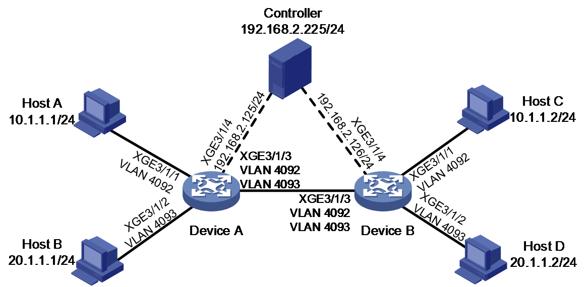

As shown in Figure 1, configure OpenFlow to meet the following requirements:
· The controller can deploy dynamic flow entries.
· Host A and Host C can communicate with each other based on the flow entries deployed by the controller.
· Host B and Host D can communicate with each other based on the flow entries deployed by the controller.

Configuring Device A
# Create VLAN 4092 and VLAN 4093.
<DeviceA> system-view
[DeviceA] vlan 4092
[DeviceA-vlan4092] quit
[DeviceA] vlan 4093
[DeviceA-vlan4093] quit
# Configure Ten-GigabitEthernet 3/1/1, Ten-GigabitEthernet 3/1/2, and Ten-GigabitEthernet 3/1/3.
[DeviceA] interface Ten-GigabitEthernet 3/1/1
[DeviceA-Ten-GigabitEthernet3/1/1] port link-mode bridge
[DeviceA-Ten-GigabitEthernet3/1/1] port access vlan 4092
[DeviceA-Ten-GigabitEthernet3/1/1] quit
[DeviceA] interface Ten-GigabitEthernet 3/1/2
[DeviceA-Ten-GigabitEthernet3/1/2] port link-mode bridge
[DeviceA-Ten-GigabitEthernet3/1/2] port access vlan 4093
[DeviceA-Ten-GigabitEthernet3/1/2] quit
[DeviceA] interface Ten-GigabitEthernet 3/1/3
[DeviceA-Ten-GigabitEthernet3/1/3] port link-mode bridge
[DeviceA-Ten-GigabitEthernet3/1/3] port link-type trunk
[DeviceA-Ten-GigabitEthernet3/1/3] port trunk permit vlan 4092 4093
[DeviceA-Ten-GigabitEthernet3/1/3] quit
# Enable LLDP globally.
[DeviceA] lldp global enable
# Configure Ten-GigabitEthernet 3/1/4 on Switch A for communicating with the controller.
[DeviceA] interface Ten-GigabitEthernet 3/1/4
[DeviceA-Ten-GigabitEthernet3/1/4] ip address 192.168.2.125 255.255.255.0
[DeviceA-Ten-GigabitEthernet3/1/4] quit
# Create OpenFlow instance 1. Associate VLAN 4092 and VLAN 4093 with it in loosen mode.
[DeviceA] openflow instance 1
[DeviceA-of-inst-1] classification vlan 4092 mask 4092 loosen
# Configure the default action of table-miss flow entries to forward packets to the normal pipeline
[DeviceA-of-inst-1] default table-miss permit
# Specify controller 0 with IP address 192.168.2.225 for OpenFlow instance 1 and activate the instance..
[DeviceA-of-inst-1] controller 0 address ip 192.168.2.225
[DeviceA-of-inst-1] active instance
[DeviceA-of-inst-1] quit
Configuring Device B
<DeviceB> system-view
[DeviceB] vlan 4092
[DeviceB-vlan4092] quit
[DeviceB] vlan 4093
[DeviceB-vlan4093] quit
[DeviceB] interface Ten-GigabitEthernet 3/1/1
[DeviceB-Ten-GigabitEthernet3/1/1] port link-mode bridge
[DeviceB-Ten-GigabitEthernet3/1/1] port access vlan 4092
[DeviceB-Ten-GigabitEthernet3/1/1] quit
[DeviceB] interface Ten-GigabitEthernet 3/1/2
[DeviceB-Ten-GigabitEthernet3/1/2] port link-mode bridge
[DeviceB-Ten-GigabitEthernet3/1/2] port access vlan 4093
[DeviceB-Ten-GigabitEthernet3/1/2] quit
[DeviceB] interface Ten-GigabitEthernet 3/1/3
[DeviceB-Ten-GigabitEthernet3/1/3] port link-mode bridge
[DeviceB-Ten-GigabitEthernet3/1/3] port link-type trunk
[DeviceB-Ten-GigabitEthernet3/1/3] port trunk permit vlan 4092 4093
[DeviceB-Ten-GigabitEthernet3/1/3] quit
[DeviceB] lldp global enable
# Configure Ten-GigabitEthernet 3/1/4 on Switch B for communicating with the controller.
[DeviceB] interface Ten-GigabitEthernet 3/1/4
[DeviceB-Ten-GigabitEthernet3/1/4] ip address 192.168.2.126 255.255.255.0
[DeviceB-Ten-GigabitEthernet3/1/4] quit
[DeviceB] openflow instance 1
[DeviceB-of-inst-1] classification vlan 4092 mask 4092 loosen
[DeviceB-of-inst-1] default table-miss permit
# Specify the IP address for controller 0 as 192.168.2.225 for OpenFlow instance 1 and activate the instance.
[DeviceB-of-inst-1] controller 0 address ip 192.168.2.225
[DeviceB-of-inst-1] active instance
[DeviceB-of-inst-1] quit
# Display details for OpenFlow instance 1 on devices, for example, Device A.
[DeviceA] display openflow instance 1
Instance 1 information:
Configuration information:
Description : --
Active status : Active
Inactive configuration:
None
Active configuration:
Classification: VLAN, loosen mode, total VLANs(2)
4092-4094
In-band management VLAN, total VLANs(0)
Empty VLAN
Connect mode: Multiple
MAC address learning: Enabled
TCP DSCP value: 10
Flow table:
Table ID(type): 0(Extensibility), count: 0
Flow-entry max-limit: 64000
Datapath ID: 0x0001123456789000
Default table-miss: Permit
Forbidden port: None
Qinq Network: Disabled
TCP connection backup: Enabled
User-plane: Disabled
Port information:
Active channel information:
Controller 0 IP address: 192.168.2.225 port: 6633
The output shows that Ten-GigabitEthernet 3/1/1, Ten-GigabitEthernet 3/1/2, and Ten-GigabitEthernet 3/1/3 belong to OpenFlow instance 1 and can be used to forward packets in the OpenFlow forwarding process.
# Display controller information for OpenFlow instance 1 on devices, for example, Device A.
[DeviceA] display openflow instance 1 controller
Instance 1 controller information:
Reconnect interval: 60 (s)
Echo interval : 5 (s)
Controller ID : 0
Controller IP address : 192.168.2.225
Controller port : 6633
Controller role : Equal
Connect type : TCP
Connect state : Established
Packets sent : 132
Packets received : 434
The output shows that Device A has established a connection with the controller.
# Ping Host C from Host A.
Ping 10.1.1.2 (10.1.1.2): 56 data bytes, press CTRL_C to break
56 bytes from 10.1.1.2: icmp_seq=0 ttl=255 time=4.582 ms
56 bytes from 10.1.1.2: icmp_seq=1 ttl=255 time=1.299 ms
56 bytes from 10.1.1.2: icmp_seq=2 ttl=255 time=1.389 ms
56 bytes from 10.1.1.2: icmp_seq=3 ttl=255 time=6.688 ms
56 bytes from 10.1.1.2: icmp_seq=4 ttl=255 time=1.294 ms
--- Ping statistics for 10.1.1.2 ---
round-trip min/avg/max/std-dev = 1.294/3.050/6.688/2.213 ms
The output shows that Host A and Host C can reach each other.
