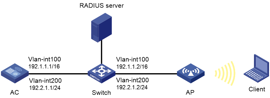

As shown in Figure 1, the switch acts as the DHCP server to assign IP addresses to the AP and the client. Configure EAD authentication on the AC to authenticate the client.
Figure 1 Network diagram
Use the actual serial ID of an AP to uniquely identify that AP.

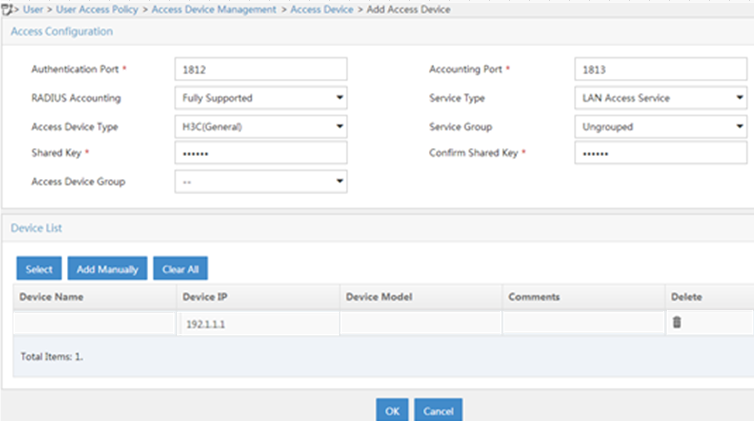

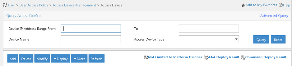

Adding an access device
1.     Log in to IMC.
2.     Click the User tab.
3.     From the navigation tree, select User Access Policy > Access Device Management > Access Device.
The Access Device page opens, as shown in Figure 2.
Figure 2 Access Device page
4.     Click Add.
The Add Access Device page opens.
5.     Configure access device parameters, as shown in Figure 3:
a.     In the Shared Key field, enter example.
b.     Use the default settings of other parameters in the Access Configuration area.
c.     In the Device List area, manually add an access device with the IP address of 192.1.1.1. (Details not shown.)
d.     Click OK.
Figure 3 Adding an access device

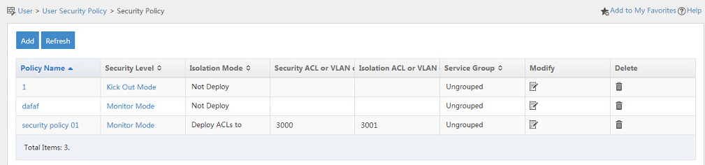

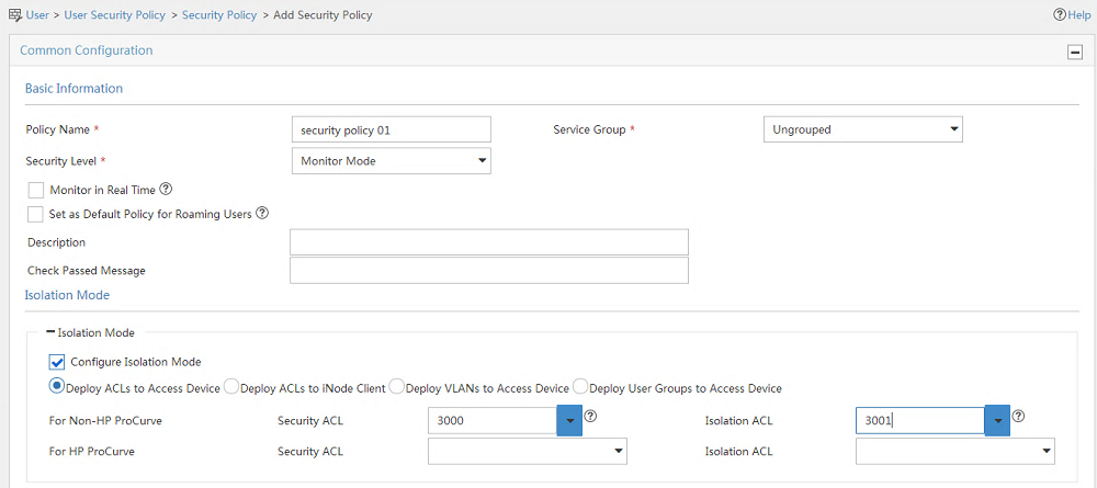

Configuring a security policy
1.     Click the User tab.
2.     From the navigation tree, select User Security Policy > Security Policy.
The security policy page opens, as shown in Figure 4.
Figure 4 Security Policy page
3.     Click Add.
The Add Security Policy page opens.
4.     Configure security policy parameters, as shown in Figure 5:
a.     In the Policy Name field, enter security policy 01.
b.     Select Monitor Mode from the Security Level list.
c.     Select Configure Isolation Mode.
d.     Select Deploy ACLs to Access Device.
e.     Configure 3000 and 3001 for the Security ACL and Isolation ACL fields, respectively.
f.     Use the default settings of other parameters.
g.     Click OK.
Figure 5 Adding an security policy

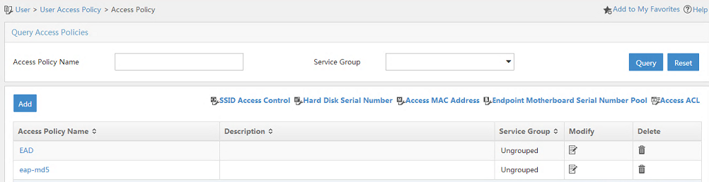

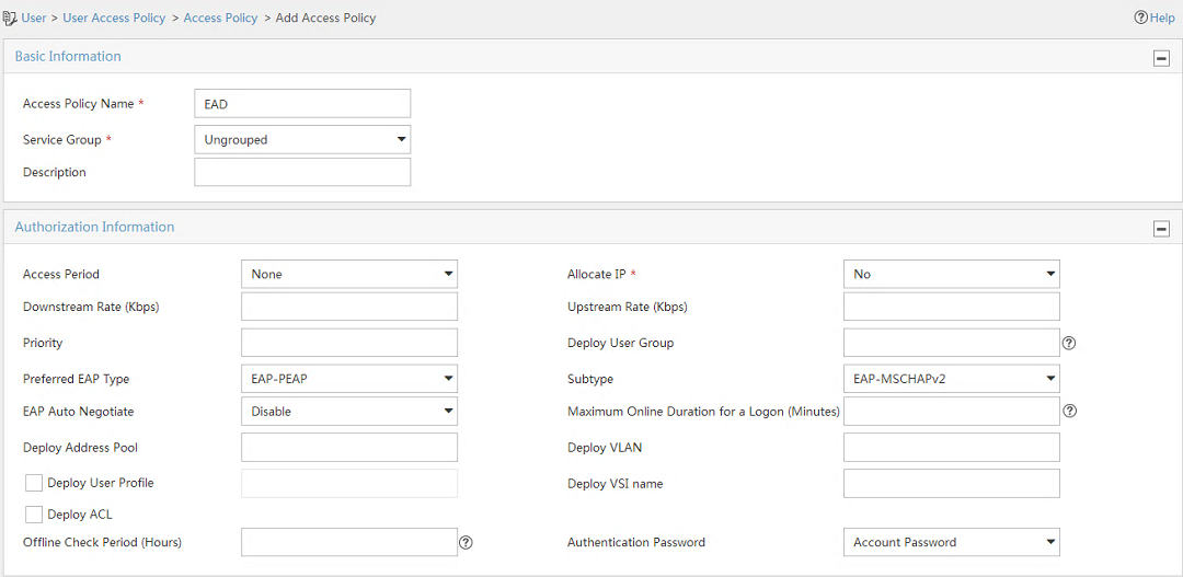

Configuring an access policy
2.     From the navigation tree, select User Access Policy > Access Policy.
The Access Policy page opens, as shown in Figure 6.
Figure 6 Access Policy page
3.     Click Add.
The Add Access Policy page opens.
4.     Configure access policy parameters, as shown in Figure 7:
a.     In the Access Policy Name field, enter EAD.
b.     Select EAP-PEAP from the Preferred EAP Type list, and select EAP-MSCHAPv2 from the Subtype list.
c.     Use the default settings of other parameters.
d.     Click OK.
Figure 7 Adding an access policy

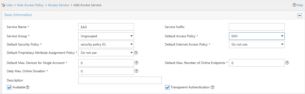

Adding an access service
2.     From the navigation tree, select User Access Policy > Access Service.
3.     Click Add.
The Add Access Service page opens.
4.     Configure access service parameters, as shown in Figure 8:
a.     Enter EAD in the Service Name field.
b.     Select security policy 01 from the Default Security Policy list.
c.     Select EAD from the Default Access Policy list.
d.     Use the default settings of other parameters.
e.     Click OK.
Figure 8 Adding an access service

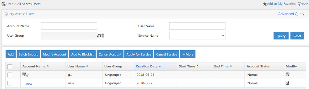

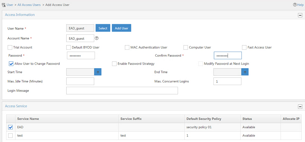

Adding an access user account
2.     From the navigation tree, select Access User > All Access Users.
The Access User page opens, as shown in Figure 9.
Figure 9 Access User page
3.     Click Add.
The Add Access User page opens.

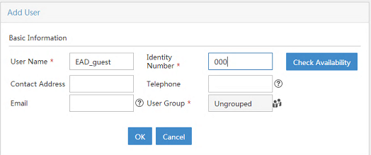

4.     Configure access user parameters, as shown in Figure 10:
a.     Click Add User next to the User Name field. On the Add User page that opens, enter EAD_guest in the User Name field, enter an ID number in the Identity Number field, and then click OK, as shown in Figure 11.
b.     Enter EAD_guest in the Account Name field.
c.     Enter 12345678 in the Password and Confirm Password fields.
d.     In the access service list, select EAD.
e.     Use the default settings of other parameters.
f.     Click OK.
Figure 10 Adding a user
Figure 11 Adding an access user account

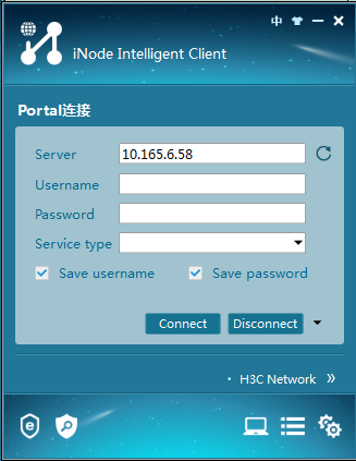

Configuring the iNode client
1.     Run the iNode client, as shown in Figure 12.
Figure 12 iNode Client
2.     Change the connection from portal connection to wireless connection.
The wireless connection page opens, as shown in Figure 13.
Figure 13 Wireless connection

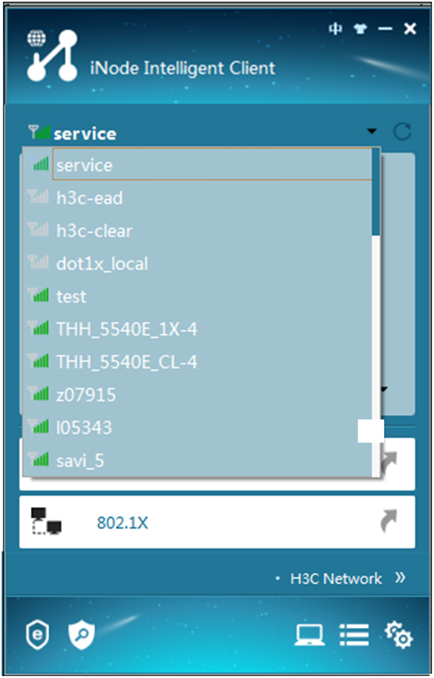

3.     Click the inverted triangle icon at the upper right corner of the page, and select the wireless service with the SSID of service, as shown in Figure 14.
Figure 14 Selecting an wireless service

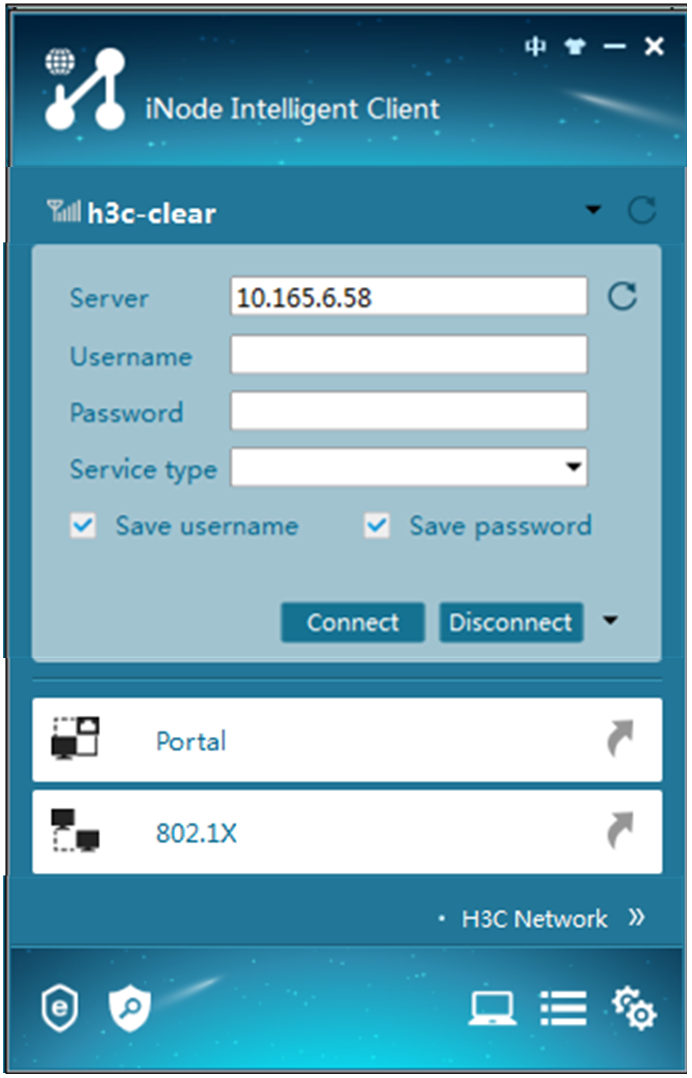

4.     Click the inverted triangle icon next to Disconnect and select Properties.
5.     In the dialog box that opens, configure WAP2 and AES as the security type and encryption type, respectively, and then configure 802.1X properties. In this example, set the packet type to multicast for 802.1X packets and specify PEAP as the authentication method.
6.     Return to the iNode wireless connection page, enter EAD_guest in the Username field and 12345678 in the Password field.
7.     Click Connect.
After the connection is established, the iNode client displays the security type and encryption type.
