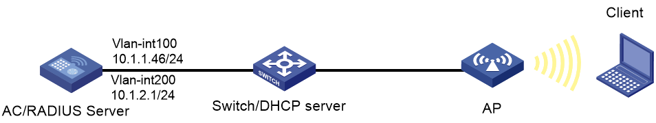

As shown in Figure 1:
·     The switch acts as a DHCP server to assign IP addresses to the AP and the client.
·     The AC acts as both the access device and RADIUS server for the client.
·     When the client accesses a wireless service, it must pass 802.1X EAP-PEAP authentication and obtain the required authorization information.
Configure the AC to meet the following requirements:
·     Use the local RADIUS server to perform authentication and authorization for wireless 802.1X users.
·     Use open system authentication to authenticate the client at the data link layer. This is the default authentication method.
·     Use the 802.1X AKM mode to secure data transmission between the client and the AP.
·     Use CCMP as the cipher suite.
Figure 1 Network diagram
Use the actual serial ID of an AP to uniquely identify that AP.
