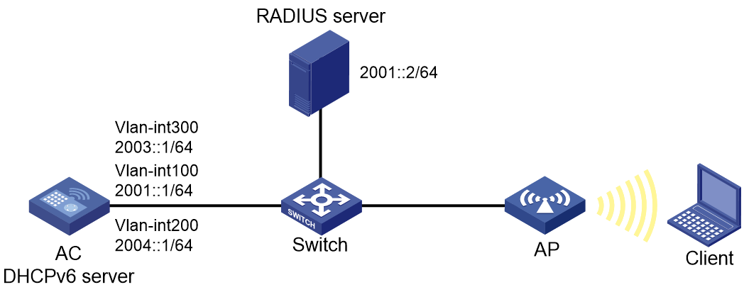

Example: Configuring MAC authentication with guest VLAN assignment (IPv6)
As shown in Figure 1, the AC acts as a DHCPv6 server to provide IPv6 addresses for the AP and its attached clients. The AC centrally forwards client traffic.
To control the access of clients to network resources:
· Configure VLAN 200 as the access VLAN of the clients.
· Use the AC with a RADIUS server to perform MAC authentication for the clients.
· Configure VLAN 300 as the guest VLAN in the service template for the clients. A client is moved to the guest VLAN if it fails authentication and will stay in the guest VLAN until it passes re-authentication, which is performed every 30 seconds.

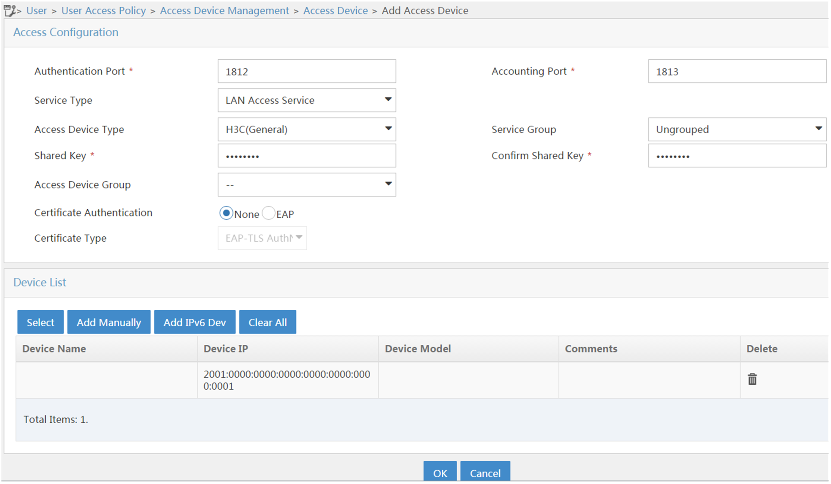

3. Configure RADIUS-based MAC authentication:
# Create a RADIUS scheme named office and enter its view.
[AC] radius scheme office
# Specify the IP addresses of the primary authentication and accounting RADIUS servers.
[AC-radius-office] primary authentication ipv6 2001::2 64
[AC-radius-office] primary accounting ipv6 2001::2 64
# Specify the shared keys for RADIUS authentication and accounting.
[AC-radius-office] key authentication simple 123456789
[AC-radius-office] key accounting simple 123456789
# Exclude ISP domain names from usernames sent to the RADIUS servers.
[AC-radius-office] user-name-format without-domain
# Specify IPv6 address 2001::1 as the source IPv6 address of outgoing RADIUS packets.
[AC-radius-office] nas-ip ipv6 2001::1
[AC-radius-office] quit

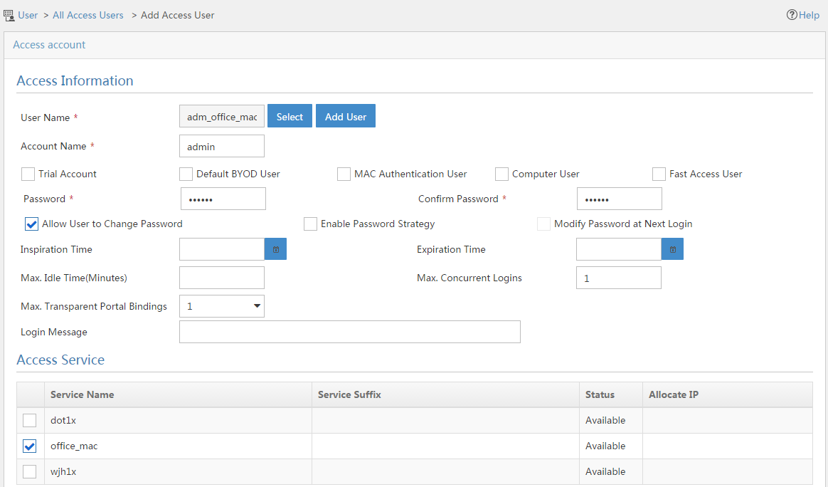

# Configure the AC to use the MAC address of each user as both the username and password for MAC authentication. The MAC addresses are in hexadecimal notation without hyphens, and letters are in lower case. (The configuration in this step is the default configuration. This step is optional.)
[AC] mac-authentication user-name-format mac-address without-hyphen lowercase

Configuring the switch
# Create VLAN 100. The switch will use this VLAN to forward the traffic on the CAPWAP tunnels between the AC and AP.
<Switch> system-view
[Switch] vlan 100
[Switch-vlan100] quit
# Create VLAN 200. The switch will use this VLAN to forward packets for wireless clients.
[Switch] vlan 200
[Switch-vlan200] quit
# Create VLAN 300. The switch will use this VLAN to forward packets in the guest VLAN.
[Switch] vlan 300
[Switch-vlan300] quit
# Configure GigabitEthernet 1/0/1 (the port connected to the AC) as a trunk port, remove the port from VLAN 1, and assign the trunk port to VLAN 100.
[Switch] interface gigabitEthernet1/0/1
[Switch-GigabitEthernet1/0/1] port link-type trunk
[Switch-GigabitEthernet1/0/1] undo port trunk permit vlan 1
[Switch-GigabitEthernet1/0/1] port trunk permit vlan 100
[Switch-GigabitEthernet1/0/1] quit
# Configure GigabitEthernet 1/0/2 (the port connected to the AP) as an access port. Assign the access port to VLAN 100.
[Switch] interface gigabitEthernet1/0/2
[Switch-GigabitEthernet1/0/2] port link-type access
[Switch-GigabitEthernet1/0/2] port access vlan 100
# Enable PoE on GigabitEthernet 1/0/2.
[Switch-GigabitEthernet1/0/2] poe enable
[Switch-GigabitEthernet1/0/2] quit

1. Add an access device:
a. Log in to IMC.
b. Click the User tab.
c. From the navigation tree, select User Access Policy > Access Device Management > Access Device.
d. Click Add.
The Add Access Device page opens.
e. In the Device List area, click Add IPv6 Dev.
f. Enter 2001::1 as the start IPv6 address, and then click OK.
This IPv6 address is the source IPv6 address specified on the AC for outgoing RADIUS packets.
g. In the Access Configuration area, configure the following parameters, as shown in Figure 2:
- Enter 123456789 in the Shared Key and Confirm Shared Key fields.
The key is consistent with the shared key configured on the AC.
- Use the default values for other parameters.
h. Click OK.
Figure 2 Adding an access device

4. Add an access user:
a. Click the User tab.
b. From the navigation tree, select Access User > Access User.
The access user list opens.
c. Click Add.
The Add Access User page opens.
d. In the Access Information area, add a user, as shown in Figure 5:
- Click Add User.
- On the dialog box that opens, enter adm_office_mac in the User Name and Identity Number fields.
- Click Check Availability to verify the validity of the username and identity number.
- Click OK.
e. In the Access Information area, configure the MAC authentication user account, as shown in Figure 6:
- Enter admin in the Account Name field.
- Enter 123456 in the Password and Confirm Password fields.
NOTE: To test the guest VLAN functionality, the user account settings in this example are inconsistent with the MAC authentication username and password format configured on the AC. On a live network, you must make sure the usernames and passwords for the clients are their MAC addresses in the format specified on the AC. |
f. In the Access Service area, select office_mac from the list.
g. Click OK.
Figure 6 Adding an access user account
