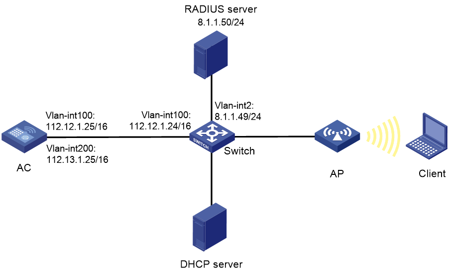

Example: Configuring remote MAC authentication
As shown in Figure 1, the DHCP server allocates IP addresses to the AP and the client. The AC centrally forwards the client traffic.
To control the client's access to network resources, complete the following tasks:
· Configure VLAN 200 as the access VLAN of the client.
· Configure the AC to use the RADIUS server to perform MAC authentication for the client.
· Set the AKM mode to PSK to secure data transmission between the client and the AP.
When you configure MAC authentication with the PSK AKM mode for wireless clients, follow these restrictions and guidelines:
· On the AC, specify the user account format for MAC authentication. In this example, the MAC address of the client is used as the username and password. Make sure the username and password configuration on the RADIUS server are consistent with the configuration on the AC.
· Use the actual serial ID of an AP to uniquely identify that AP.
· Remove the ports that connect the AC to the AP from VLAN 1 in case there are too many packets in VLAN 1.
· Some endpoints by default use random MAC addresses. To ensure successful MAC authentication for such an endpoint, disable the endpoint from using a random MAC address.

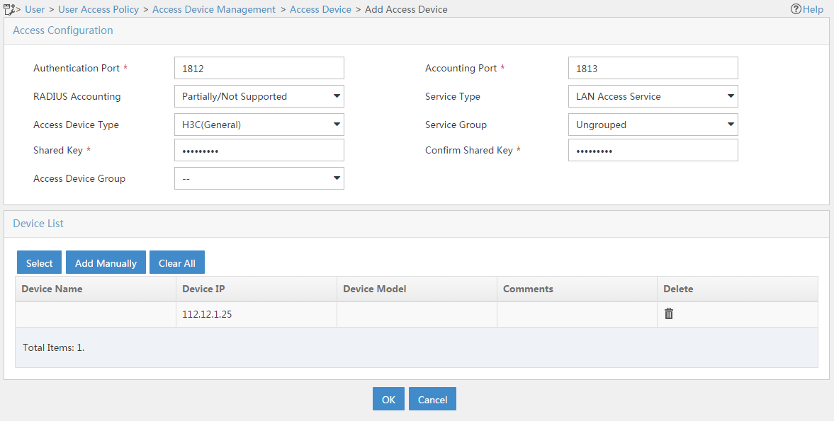

Configuring the RADIUS server
In this example, the RADIUS server runs IMC PLAT 7.1(E0303P10) and IMC UAM 7.1(E0303P10).
1. Add an access device:
a. Log in to IMC and click the User tab.
b. From the navigation tree, select User Access Policy > Access Device Management > Access Device.
c. Click Add.
The Add Access Device page opens.
d. In the Device List area, click Add Manually to add the device at 112.12.1.25 as an access device.
This IP address is the source IP address specified on the AC for outgoing RADIUS packets.
e. In the Access Configuration area, configure the following parameters, as shown in Figure 2:
- Enter 123456789 in the Shared Key and Confirm Shared Key fields.
The key is consistent with the shared key configured on the AC.
- Use the default values for other parameters.
f. Click OK.

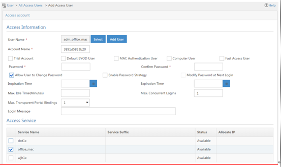

4. Add an access user:
a. Click the User tab.
b. From the navigation tree, select Access User > Access User.
The access user list opens.
c. Click Add.
The Add Access User page opens.
d. In the Access Information area, add a user, as shown in Figure 5:
- Click Add User.
- On the dialog box that opens, enter adm_office_mac in the User Name and Identity Number fields.
- Click Check Availability to verify the validity of the username and identity number.
- Click OK.
e. In the Access Information area, configure the following parameters, as shown in Figure 6:
- Enter 3891d5833b20 in the Account Name field.
- Enter 3891d5833b20 in the Password and Confirm Password fields.
f. In the Access Service area, select office_mac from the list.
g. Click OK.
Figure 6 Adding an access user account
